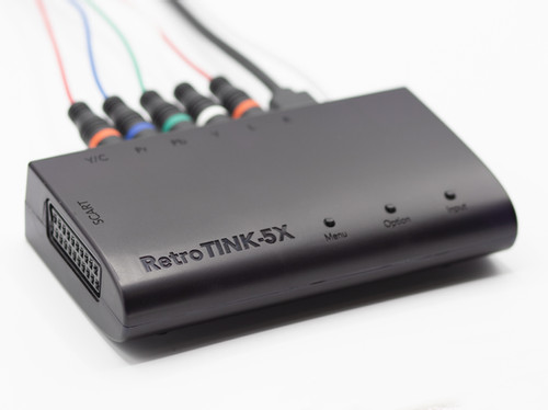

What are people’s thoughts on the new Retrotink 5X?
Motion adaptive deinterlacing and 1080P upscaling sounds pretty sweet.
RetroTINK
https://www.retrotink.com/product-page/5x-proSOLD OUT! Please follow us on Twitter: https://twitter.com/retrotink2 for updates. Next batch expected June/July with hopefully stable production and inventory. We will begin taking orders on May 1, 2021 at 9am PST. Units will start shipping on the...
Price: USD 275
Link: 5X-Pro | RetroTINK
RetroTINK 5X - The First Next-Generation Classic Gaming Scaler :: RGB322 / MY LIFE IN GAMING - YouTube My Life in Gaming’s coverage With a timestamp to the 480i deinterlacing coverage.
#10 — Genlok · 2021-05-18
Interesting, I’d like to compare that to BMIS+OBS. That being said, at $275 it’s a tough sell if it doesn’t out perform software, unless you just absolutely can not use a computer.

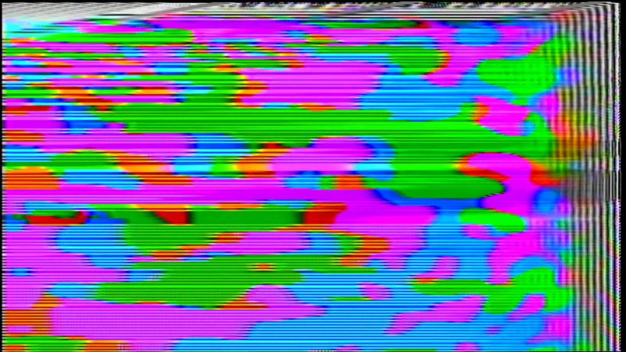

Here’s an example of upscaling S-Video to 2160p with OBS, using BMIS for capture.
https://www.youtube.com/watch?v=VXiqAhxt4yg

I’m definitely more interested in Retrotink for real-time performance, monitoring and the ability to integrate with HD hardware switchers.
I have the RT2X for live but never actually tried to capture with it. I go straight to BMIS via composite or S-Video.
