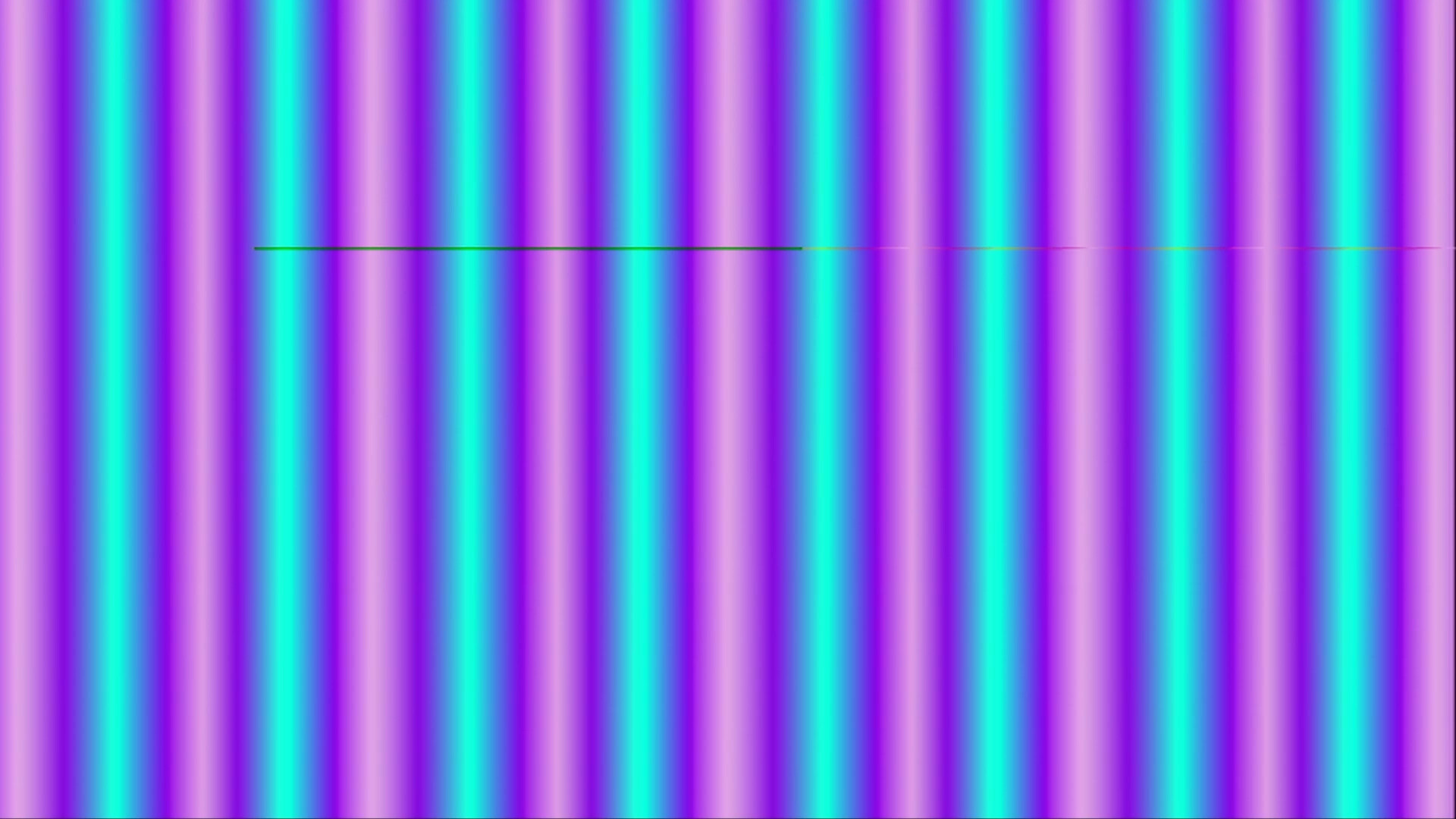

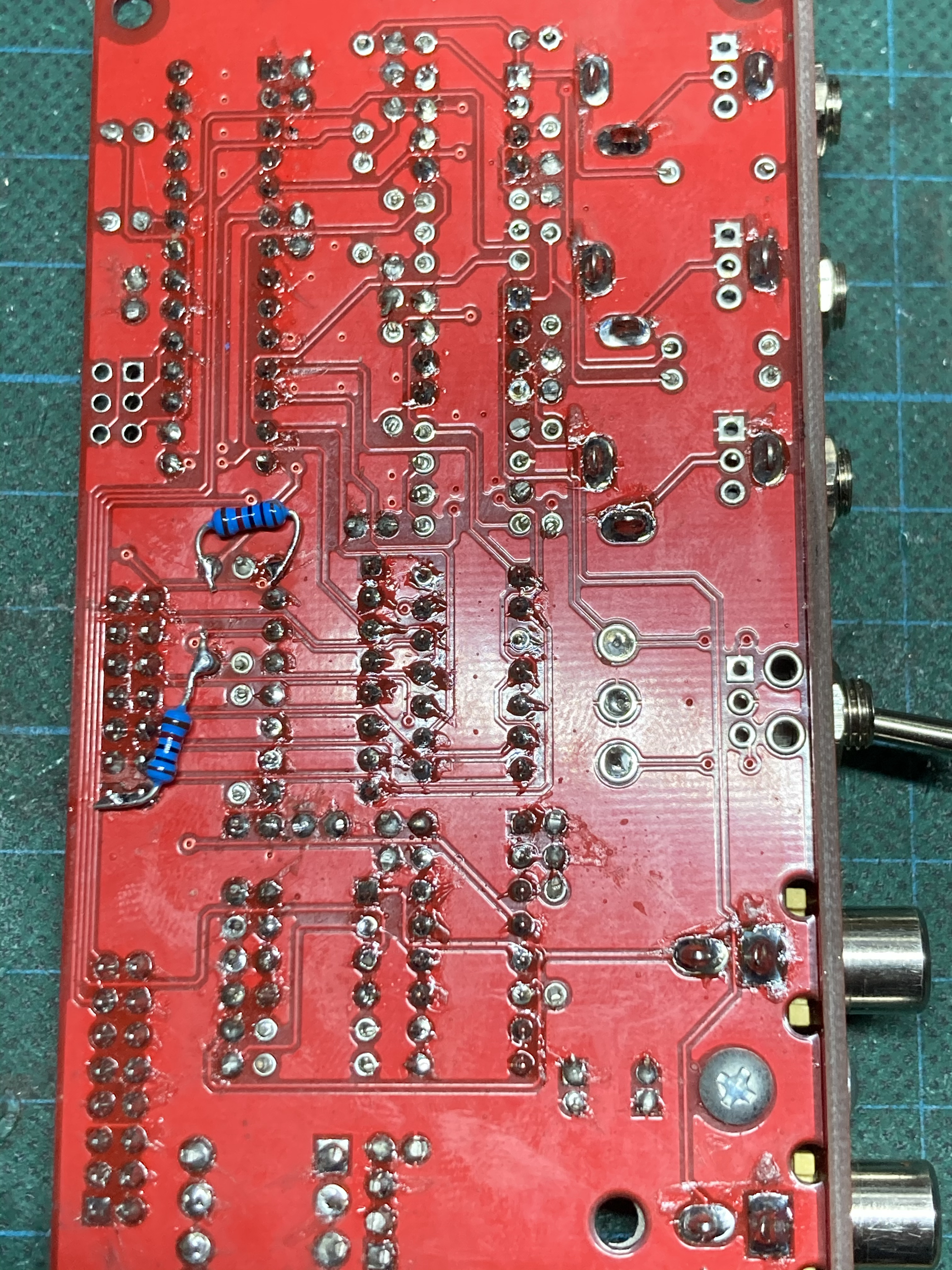

I had really minor issues with Cadet I and BM Analog to SDI, mainly a little colored line as shown on the picture, and rarely some drop, which didn’t happen when Cadet I was synced to an external source as mentioned here.
BM Analog to SDI Cadet I
I can confirm adding 10k pull-up/pull-down resistors to the VCXO CV input get rid of the artefacts on BM Analog to SDI, thanks for the tip!

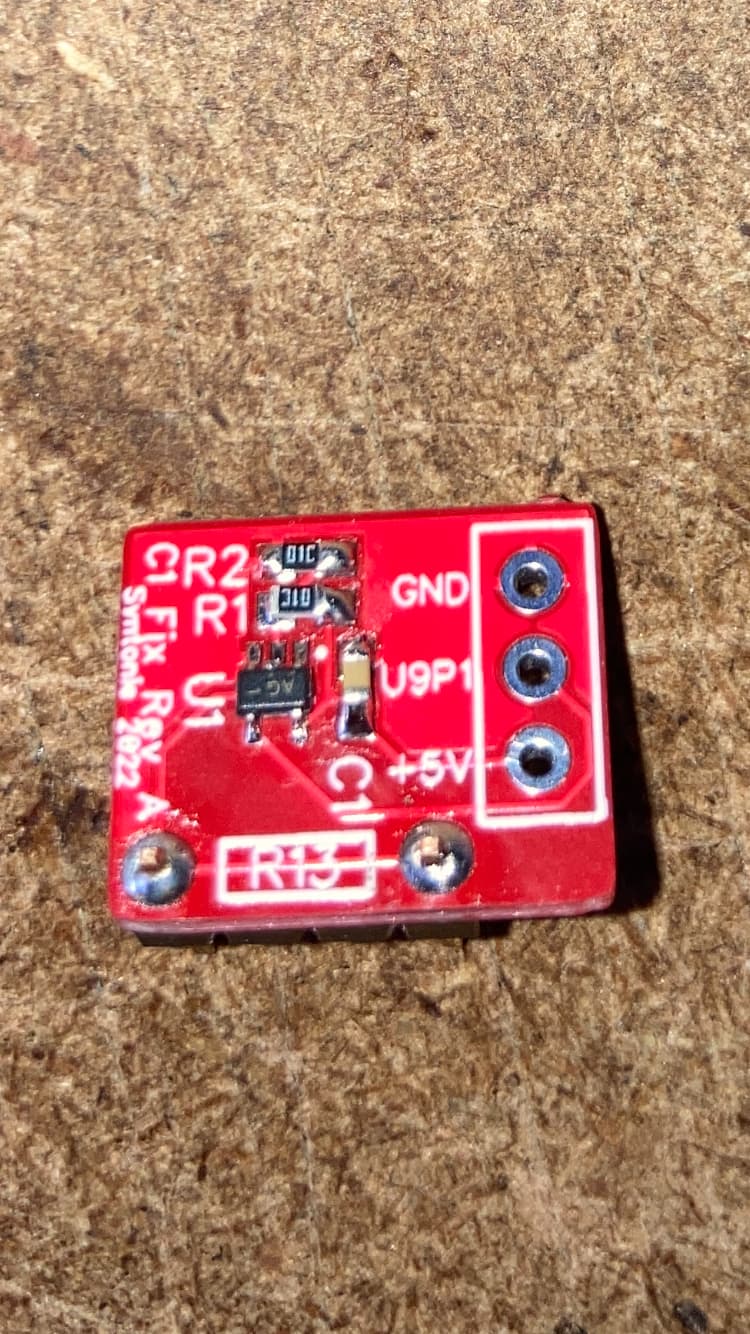

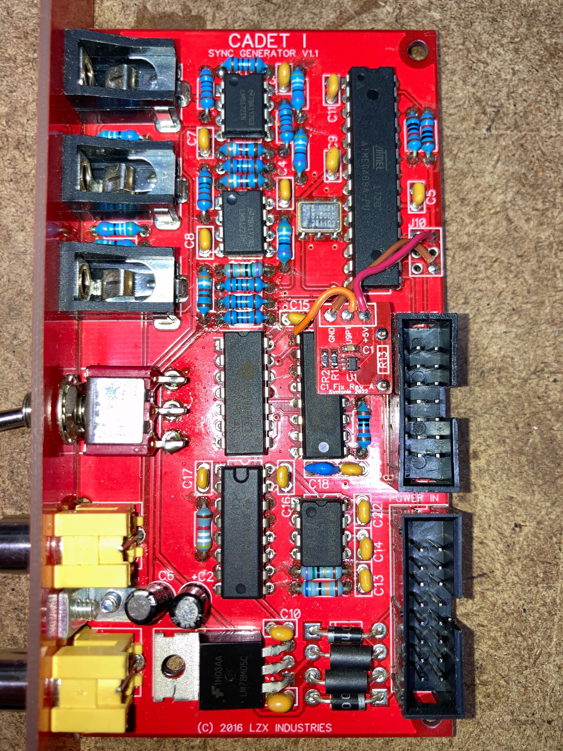

Made a tiny add-on board that can be soldered in place of R13, it requires to be wired to 5V/GND (I used the pads from the ISP connector) and also U9 pin 1.
Not sure if it is of any interest as it is mostly an issue with BM Analog to SDI and it’s easily fixed by plugging the sync gen to an external source, then got a few extra boards that I’ll happily give away as I only have one Cadet I. The CMOS switch is a little tiny but fairly easy to solder with a thin tip iron, passive components are 0806 and a 4pin 2.54mm header with the 2 middle pins removed is used to solder it to the Cadet board. Also happy to put the gerbers/BOM on GitHub if it is useful to anyone (else than me lol).

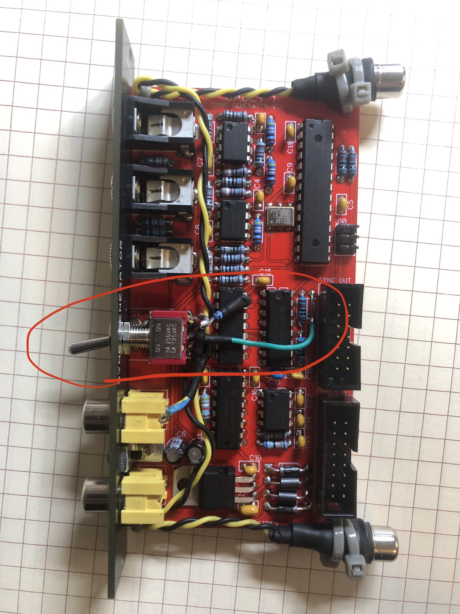

This is a way cleaner way of correcting the issue than my current hack, hah!
IMG_2786
I’d love to rework mine with your board since the physical switch is really more of a liability during patching. I’ll PM you.
#12 — syntonie · 2022-03-05
Ah we were kind of on the same track, switching those resistors out when not used! And I guess you hardwired the NTSC/PAL switch to the desired format, as there is not many reasons to switch from one to another often.
