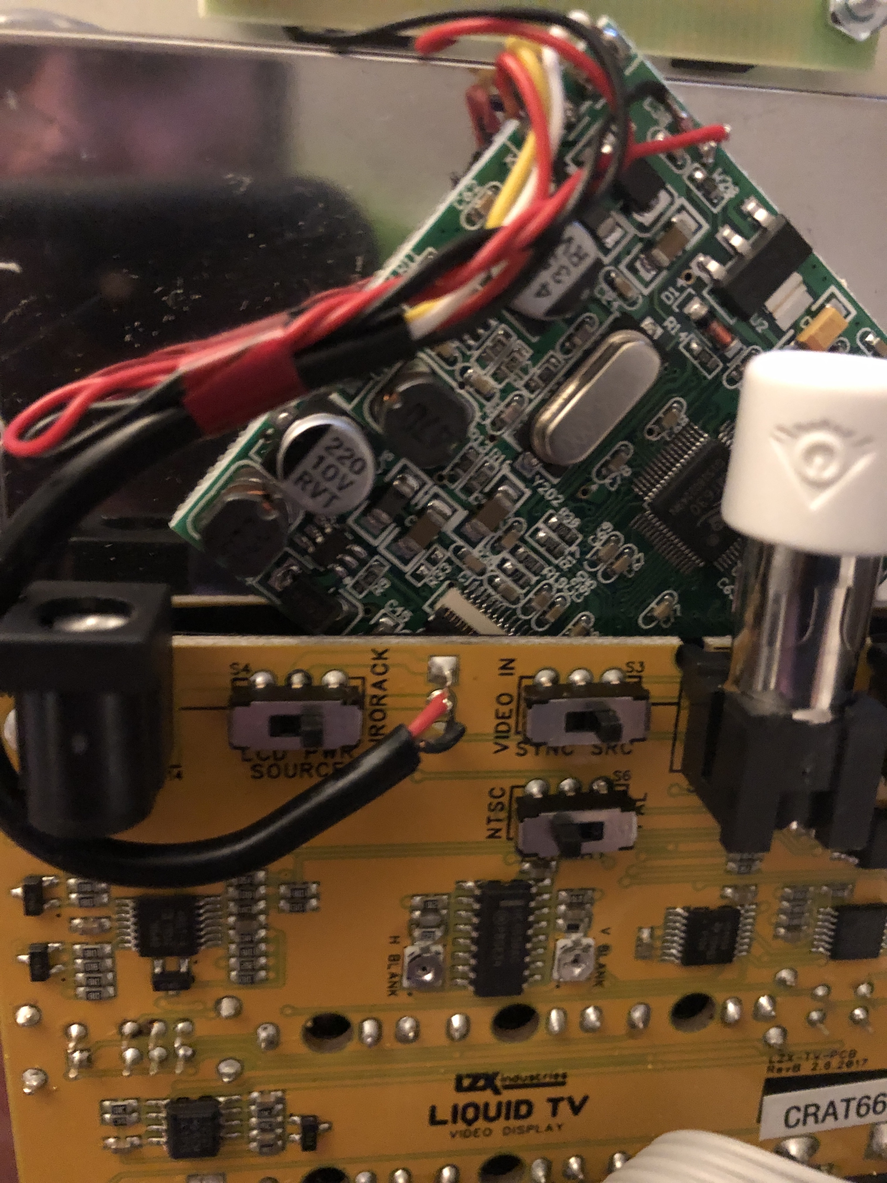

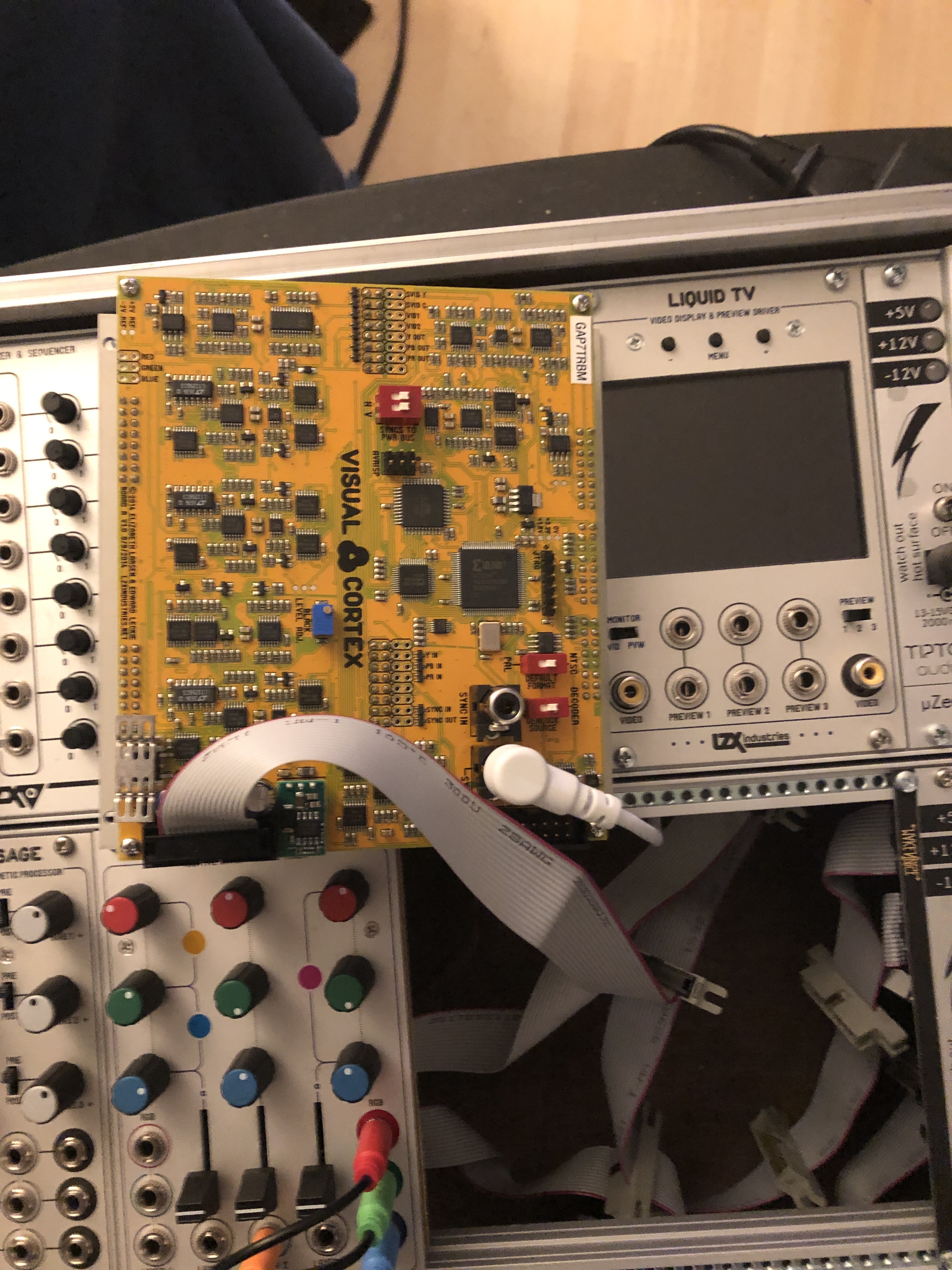

I bought a Liquid TV from Perfect Circuit recently, and I’m having trouble getting the Preview function to work. The VID function works perfectly, and I’m able to monitor video on the composite input , but none of the Preview slots work when the switch on the top left is set to PVW and I’ve chosen one of the three slots
I’m syncing it to the Visual Cortex - see the screenshots. I’ve double checked, and swapped cables, but the Preview still eludes me. I tried the Reset in the Menu when in VID mode, but same thing.
I’ve tried patching all sorts of things into the Preview inputs - shapes and ramps from the VC, straight and through Color Chords, output from a Prismatic Ray, luma out from a Vidiot, but no dice.
When on one of the Preview slots, the screen will flash blue briefly with some text that I don’t have time to read - a microsecond and it’s gone.
Hopefully I’m missing something simple. Thoughts?

#11 — creatorlars · 2019-01-28
Looks like you have everything set correctly to me.
If you switch the sync src to “video in”, send the video in (via front) a video signal from cortex, do the preview inputs work now? In either case, best to arrange an RMA with us.
#12 — northerntao · 2019-01-29
When I have the sync switch set to video in, and the composite from the Cortex going to the front of the Liquid TV, everything works, including the preview.
Is having the Liquid TV syncing in the back to the Cortex a problem when also having the Cortex coming into the front via composite for color monitoring?
