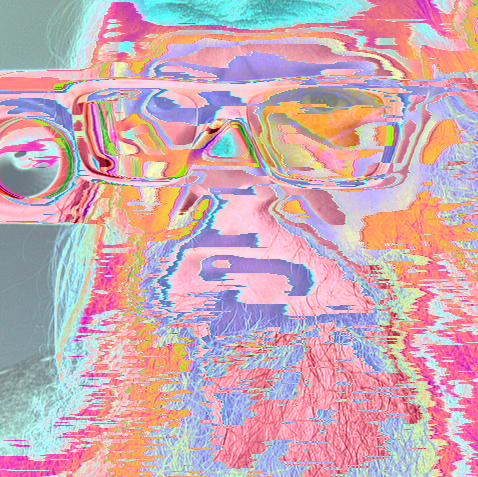

Awesome post, thank you! Here’s my take on the patch with an additional trip through Staircase after coming out of the DAC.
Untitled%2001%204
