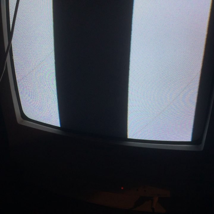

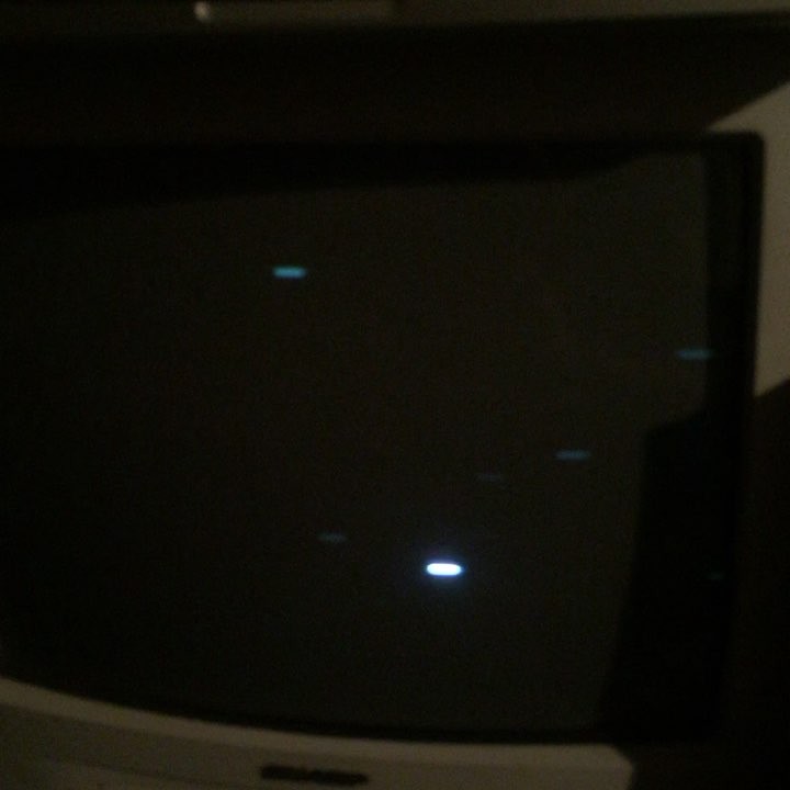

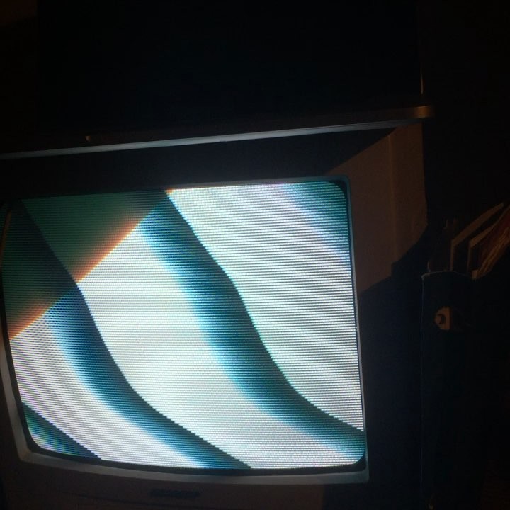

) because I needed to make room and already have a tiny studio spaceone of my favorite little tid bits is making an extra filter (curtain) into an oscillator
also if you modulate that self oscillating curtain you can get things from star fields to stable bars
instagram.comhttps://www.instagram.com/p/BbscA6sFrvE/
https://www.instagram.com/p/BbscA6sFrvE/3 Likes, 0 Comments - Nichole Pichon (@nicholepichon) on Instagram: “Star field #lzxindustries #lzxcurtain #lzxvisualcortex there is a little nest of noise that can be…”Link: Nichole Pichon
instagram.comhttps://www.instagram.com/p/Bbscjj0Fqrz/
https://www.instagram.com/p/Bbscjj0Fqrz/6 Likes, 0 Comments - Nichole Pichon (@nicholepichon) on Instagram: “#lzxindustries #lzxcurtain #lzxvisualcortex when the frame output from the visual cortex is…”Link: Nichole Pichon
instagram.comhttps://www.instagram.com/p/Bbsc5BDF7Ev/
https://www.instagram.com/p/Bbsc5BDF7Ev/10 Likes, 0 Comments - Nichole Pichon (@nicholepichon) on Instagram: “#lzxindustries #lzxcurtain #lzxvisualcortex self oscillating curtain modulated by horizontal sync…”Link: Nichole Pichon
