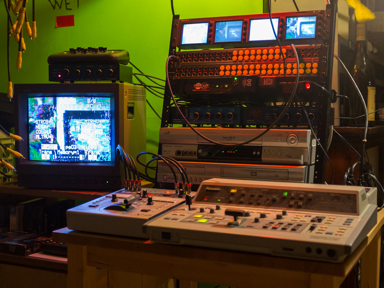

Audio-reactive visuals for live music using camera/video-based source material (rather than pattern generation) is probably the most concise answer to what I plan to do with this. But I do a lot of different kind of stuff (motion graphics, photography using video, etc.), so that is kind of the tip of the iceberg.
Plan to integrate this into a workflow that includes a laptop as well as an ever-growing SD video rig:
Rack_6137
But also thinking about mobility and what could perhaps be useful with just the Vidiot, a laptop, and a camera. Hence using up a lot of space on inputs & mixing within the small system. Relying on an external mixer and thinking of this as primarily a single-channel device could seem more logical (I’ve been debating that myself; it certainly would be nice to be able to fit a Staircase and/or an Arch in there!), but I think allowing multiple feeds to interact within it should allow for much more complex and dynamic audio-reactivity.
Anyway, if other strategies for creating maximal patching options within a minimal system spring to mind, would love to hear 'em! Thanks!
(I mean, I know a lot of this sort of flies in the face of received wisdom, but maybe that is kind of my personality.)
…Also, interesting to hear that you find the LBZ54 noisy. I haven’t noticed that thus far, but I am not running many modules in it yet… And also tend to use naturally noisy feedbacking patches anyway, so maybe it just blends in with all that.
