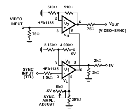

I found this sync insertion circuit (below). It appears to be using an op-amp like a switch by powering it on and off with a sync pulse, allowing the sync signal to pass during the blanking interval. Then it occurred to me the signal is blanked already in the C2 circuit.
So far my circuit is one channel from the C2 schematic, up to the blanking switch. Is this Rube Goldberg circuit here what I want, or can I just use a 2x gain summing amp to sum CSYNC with the output of the blanking switch from C2?

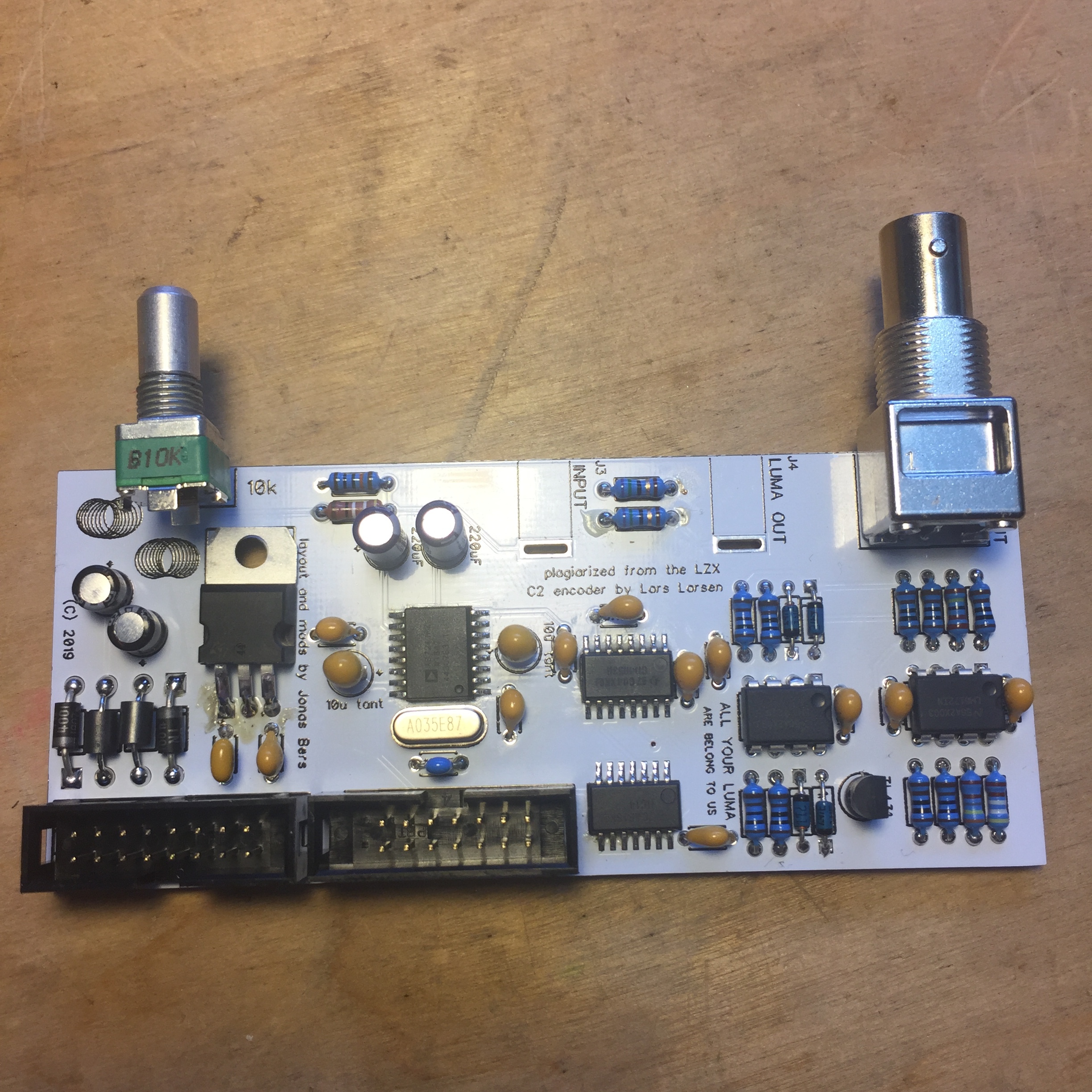

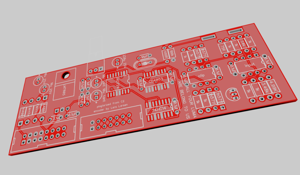

Ay yi yi, I got some protos fabbed and there were a couple fatal errors I missed. Ordering some new things soon though, so the revisions of these will be in that batch. Luckily I caught the mistakes before wasting an encoder IC.

@creatorlars, would you mind taking look at this? Before I start tracing the signal or troubleshooting my layout, I just want to verify that there aren’t any glaring errors in my circuit. I omitted the AD724 NTSC/PAL switch circuitry, and I think I have the correct circuit for NTSC?
The goal is to have a simplified, monochrome version of C2 with an attenuator and luma output. My C2 is a little deep for my travel case, I never use RGB anyway, and my wired-up banana and BNC jacks were starting to bother me.
I’m getting a composite signal out, but it’s unstable. Ramps display correctly, but get torn weirdly when they’re processed. Oscillators seem to display properly when they’re h-synced at high frequency, but they freeze and stutter when v-synced at audio rate. My working theory is that my clock circuit is wonky somehow.
The “14-pin header” is correct on my PCB even though it looks wrong – my way of avoiding 14-conductors is using 16-pin headers and installing the key backwards, but the cable/signals are connected where they need to go.
Power to the ICs is all correct/measured/verified.
No hot chips.
The crystal cap is a 1% 10pF MLCC.
The crystal reads “3.58 mHz” on the schematic, but it is in fact a [ABRACON +/-20ppm 3.579545MHZ].
Also, as this is basically a direct clone of the C2 – I have no intention to distribute it. Just for personal use, and will send one to the OP if I can get it working.
#18 — JonasBers · 2019-11-02
duh. my clipping circuit output is on the wrong side of the last diode. kludged. fixed. working. @LauLindqvist – DM me if you want a board. I’ll gladly send you one for inspiring this thread. you’ll just have to cut a trace and put in a kludge wire. also, the format is banana/BNC, but it can be adapted for 3.5mm jacks with a few wires.

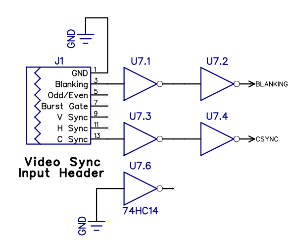

Looking at the C2 schematic (see relevant bit below), the C2 only uses the csync and blanking signals from the 14-pin sync. Csync is definitely one of the outputs of a lm1881 (and I think it’s what an RCA sync signal is in general, right?). But blanking will need to be derived somehow. I’m not sure but I think it’s the kind of thing you can get by rigging up a one-shot of a particular length (tuned via trimmer?).
C2’s 14-pin sync input:
#23 — vhsdestroyer · 2021-06-05
yeah I found this reference about using the cd4638 but I’m not exactly sure. I think a lot of the schematic I have drawn up is overkill.
