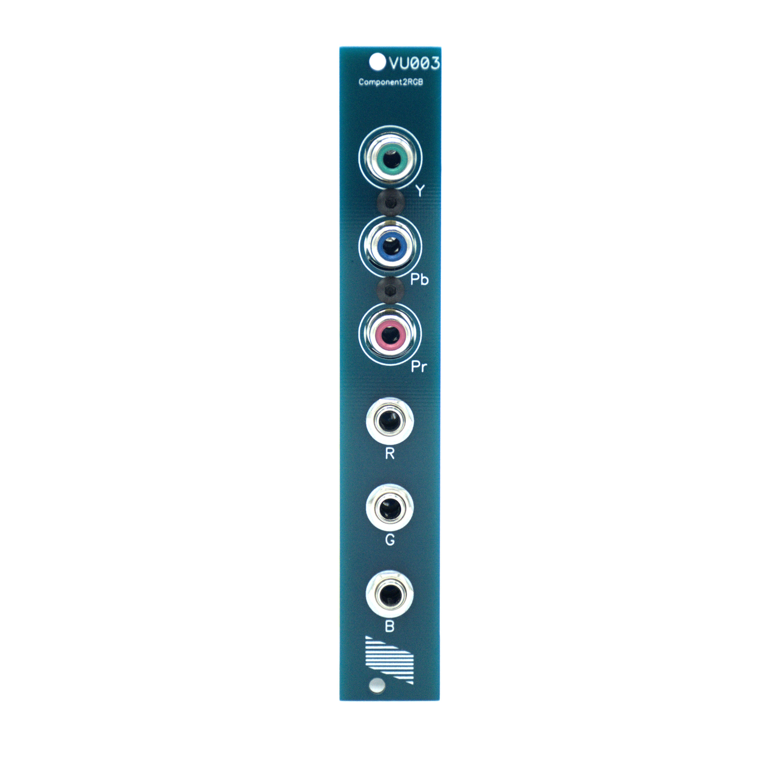

#11 — Z0NK0UT · 2022-08-18
It isn’t composite to RGB, but if you have a composite to component box, you can build this Syntonie kit:
Syntonie
https://syntonie.fr/produit/vu003-component2rgb/Component/YPbPr to 1V RGB colorspace converter, to process a component video source into a video…
Link: Syntonie - Video DIY
There are some Memory Palace owners who are using it to bring in external video.
