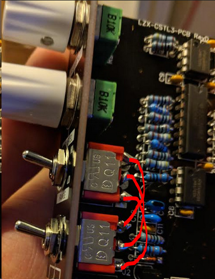

Building the clock VCOs I got a little confused with the switches. The BOM says that S1 is the on-on switch, which makes sense for the range switch and I can confirm with a multimeter that pin 6 of the 74HC4046 is connected to the center pin for S1. However the panel says that S1, the switch further from the knobs, is the sync switch. So the switch placement is correct on the PCB and both modules work fine, but I was thrown for a loop for a bit.

The Castle VCO and Flip Flops had some errors that have since been fixed, but might you may have gotten an older PCB. First, the Clock VCO. The original at launch BOM called for 74HC4046 but there were some troubles syncing with that IC so it was switched to CD4046. The Sync and Range switches were swapped on the PCB, I suggested using short wires to connect the switches so the places could be swapped back to the original location. Use the short wires to take the switch closest to the jacks to the hole closest to the pots, and vice versa.

The Sync Switch (On-Off-On) won’t do anything if you’re not on the same power buss as your sync source since the Clock VCO gets it’s sync signal over the power header. If you plug a sync signal in to the Sync jack it will override the power buss sync.

The currently uploaded BOM and schematic have the correct listings for S1 and S2 that match these refdeses on the (RevD, currently shipping as of 2019/01/22) PCB, but have opposite positions relative to the labels on the panel. This means that if you place sync = S2 (on-off-on) on the spot for S2 so it comes out the hole in the panel labeled “range”, and place S1 in the spot for range = S1 (on-on) so it comes out the hole in the panel labeled “sync”, the circuit is functionally correct, but the labels are backwards.
If the on-on switch is placed in in the hole on the panel labeled “sync” and the on-off-on switch in the hole on the panel labeled “range”, I would expect the sync switch (labeled RANGE in this case) to let you switch between vertical and horizontal sync, but the intended behavior is that the oscillator doesn’t sync to either the horizontal or the vertical pulse when the on-off-on switch is in the center position and that the range switch just has two settings - HI or LO for horizontal-ish and vertical-ish frequency ranges. In this case I guess placing the on-off-on switch (labeled RANGE) winds up floating pin 6 so the PLL/VCO has no external capacitor, I don’t recall what behavior this caused on the display other than that it seemed weird. If the on-off-on switch has no effect in this case then yeah I would expect that the module doesn’t have sync over the CV/gate lines from the power bus (my understanding is that Cadet I and Visual Cortex both generate this, I’m using Cadet I) or something else is wrong.
The fix I think Phil is talking about would be to put the switches in the positions that match the panel labels and wire all 3 pins on each switch to the 3 PCB pads in the opposite position, so that it remains electrically correct while swapping the positions of the switches, like so:
Personally I think I’m just gonna remember that I have em swapped for now
