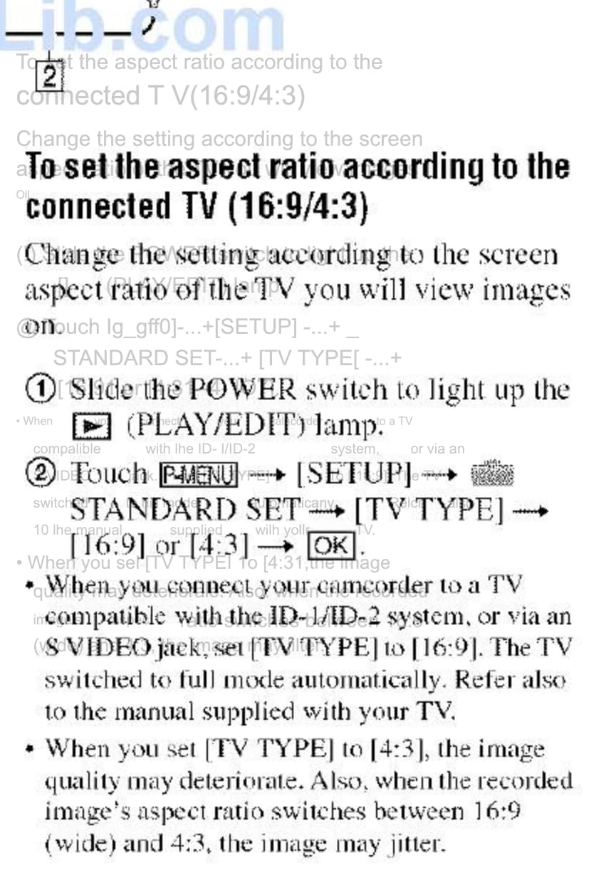

EDIT: You may also need to make sure you’re outputting the correct 4:3 aspect ratio:
Screen Shot 2021-11-02 at 5.44.20 PM

Yes, that is exactly the setup. I suppose I could post a picture but it would just show that patch. Thanks for the 4:3 tip, changed that but behaviour is the same.

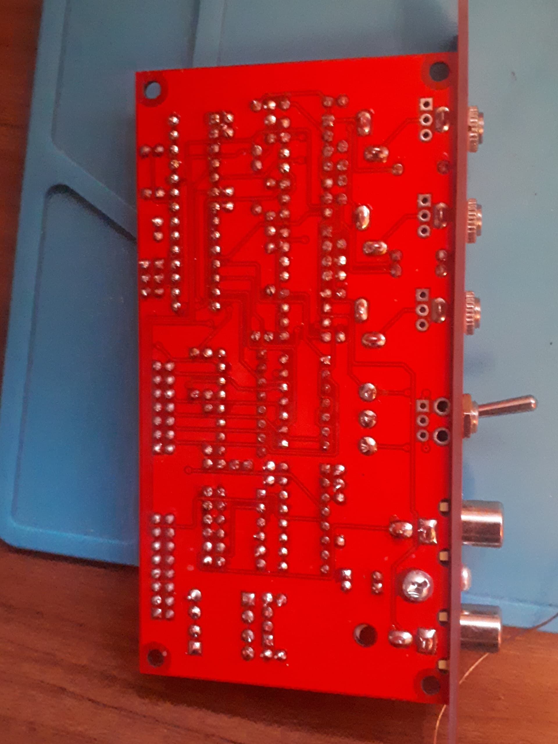

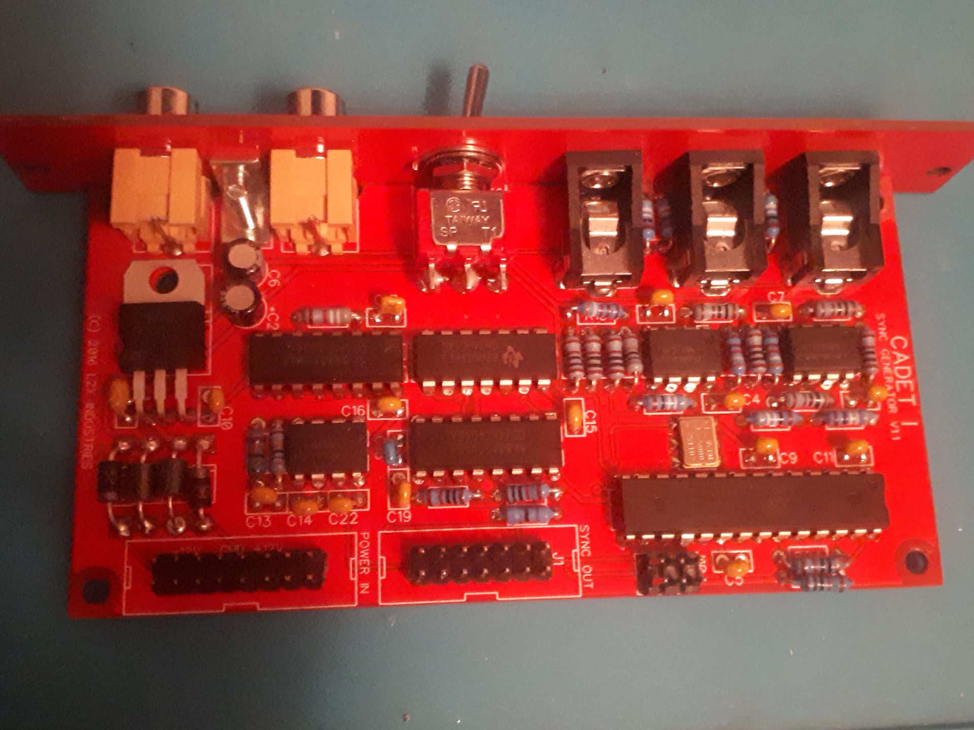

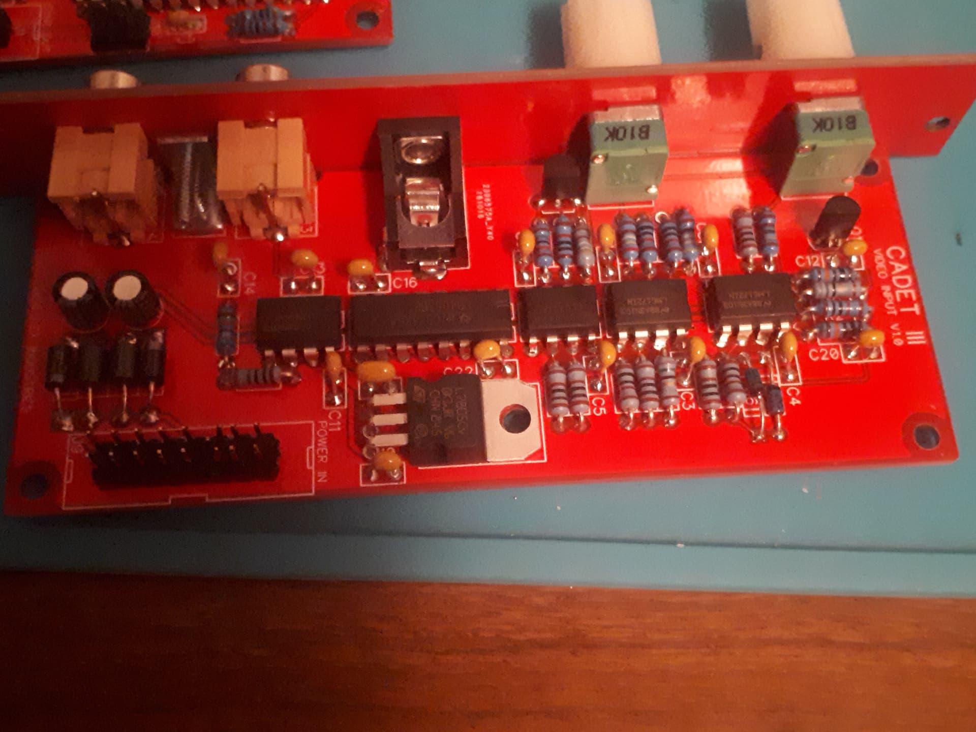

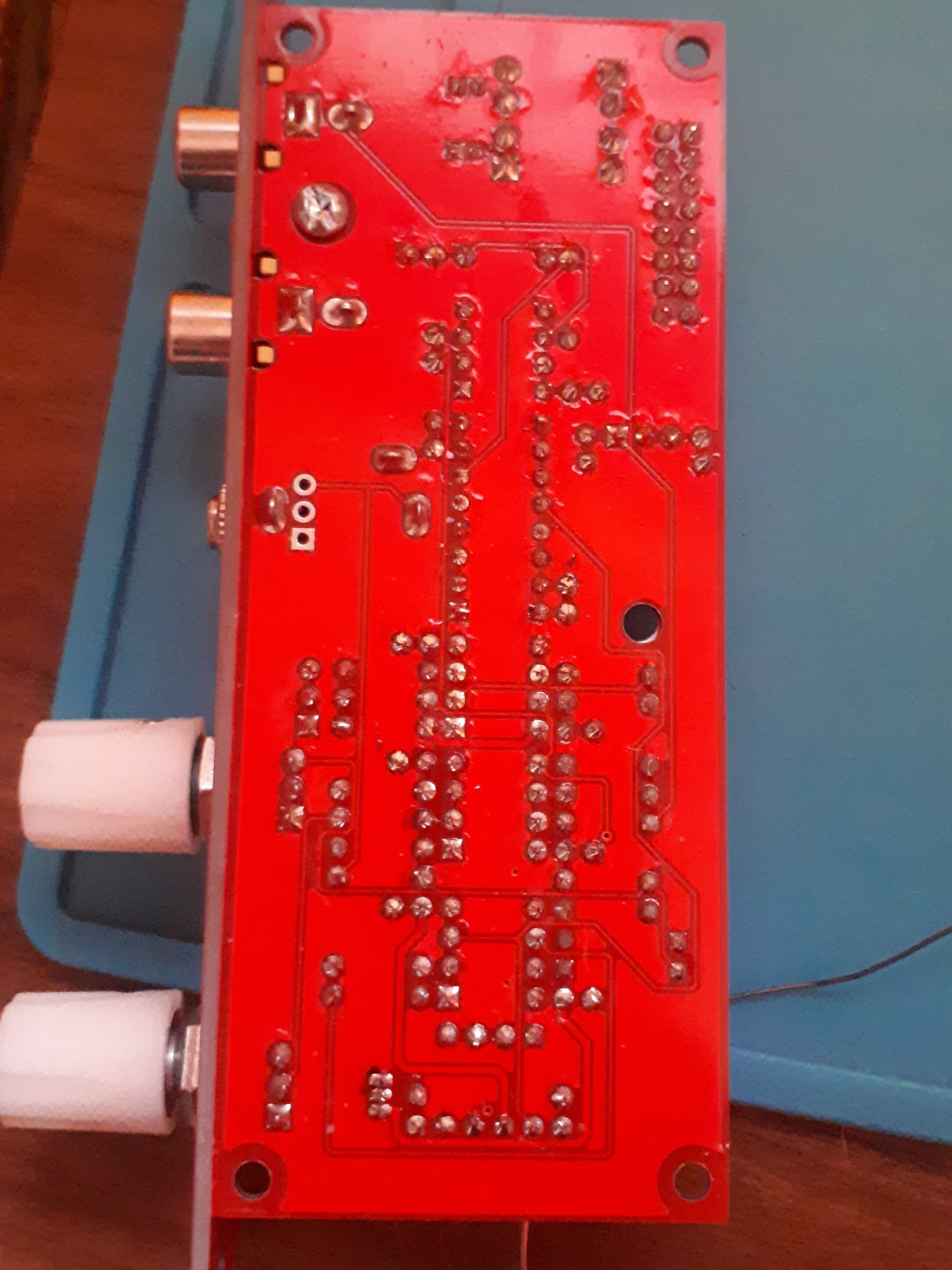

Can you post some hi-res, in-focus shots of the front and back of your Cadet I board? We might be able to help you spot an issue before you start replacing chips.

Sure, here’s the Cadet I Sync Gen:
IMG_20211103_140153
(looks like there’s a bit of solder mess around pin 1 of the atmegga, just cleaned that up)
And here’s the Cadet III Video Input: IMG_20211103_135638

Can we see the top-side as well? As sharp of focus as you can manage is really helpful here. The above photos are just a touch blurry so it’s difficult to visually inspect them.

Unfortunately my phone doesn’t take very good pictures.
IMG_20211103_174921
IMG_20211103_174939
But anyhow I don’t have a bad eye for solder joints, these boards aren’t my best work but I have been going over them and addressing joints that look iffy. Which is why I’m concerned it’s a blown chip.
