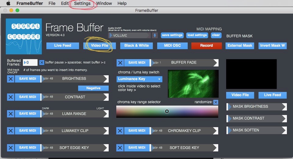

Signal Culture Frame Buffer (version 4.0) to open and playback video file (This can be done numerous ways, with any app that can output to Syphon [Max/MSP/Jitter, etc], Frame Buffer is just what I happened to be using at this time).
- Select video file for playback by clicking on Video File and navigating to your existing video file
- Select Settings, Video Input/Output:

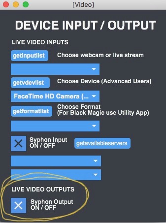

Under LIVE VIDEO OUTPUTS turn on Syphon Output:

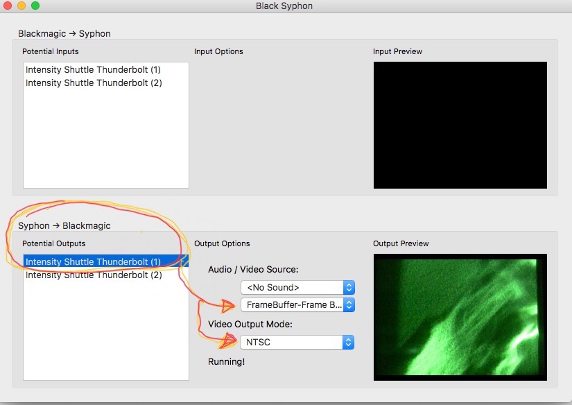

Black Syphon (version 4):
- Under Syphon -> Blackmagic
- Audio/Video Source, select FrameBuffer from dropdown
- Video Output Mode, set to desired output, in my case NTSC:

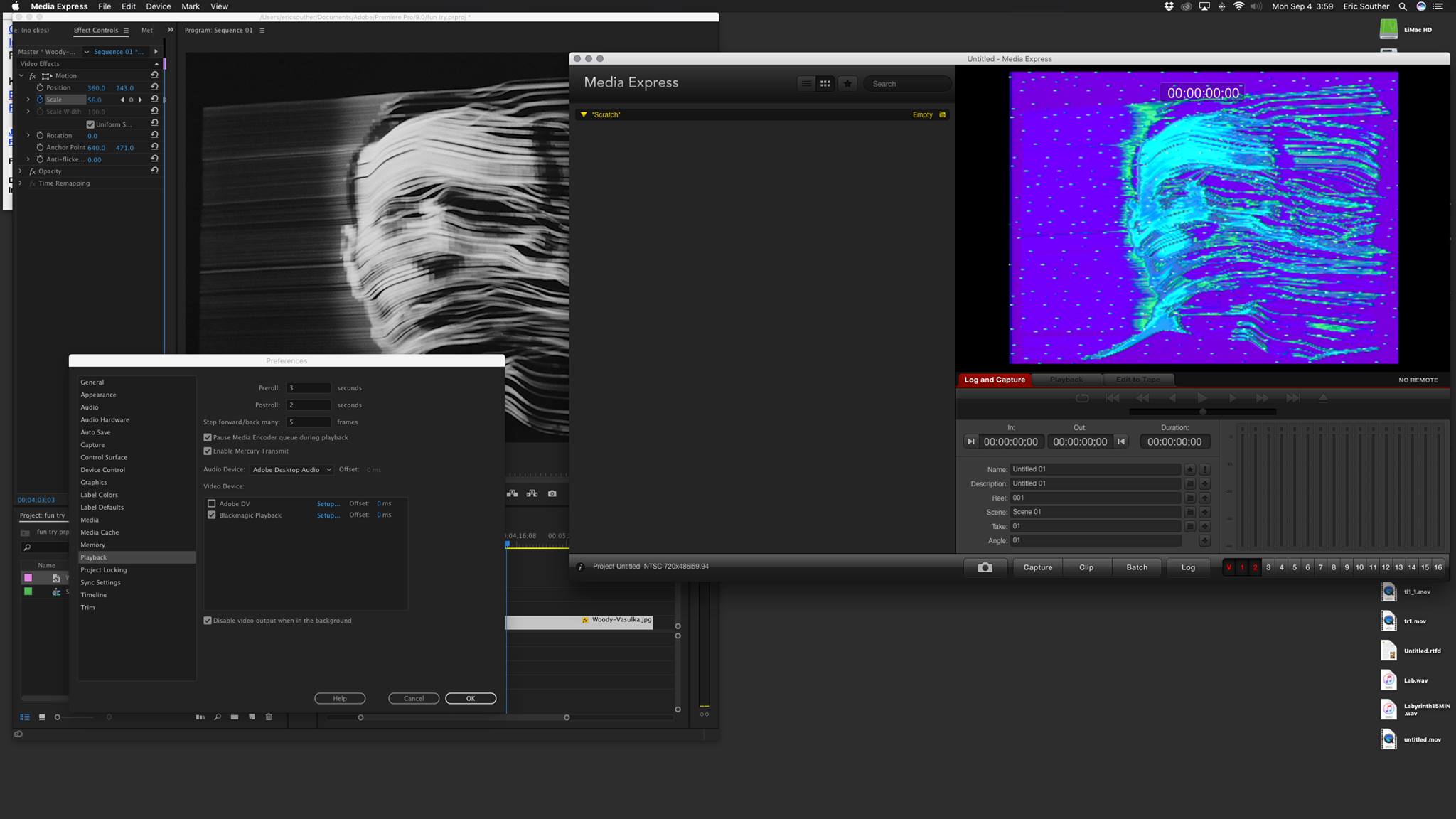

For additional information about running a dual setup, see this thread from Eric Souther here:
https://www.facebook.com/groups/lzxindustries/permalink/814631635374825/Leslie Rollins and I got two Blackmagic shuttles to output from CPU into LZX and back to CPU for capture. You can do it all in MAX/MSP or Premiere and Blackmagic Media Express combo. The patch...
Link: Eric Souther
Leslie Rollins and I got two Blackmagic shuttles to output from CPU into LZX and back to CPU for capture. You can do it all in MAX/MSP or Premiere and Blackmagic Media Express combo. The patch includes an xfade for feedback. (photo credit to Woody Vasulka)
You can play with the max patch here (granted 2 Blackmagic shuttles are needed):
App: https://www.dropbox.com/s/0pzuinwb1j42n1k/BM_BM.app.zip?dl=0
Patch: https://www.dropbox.com/s/a1vqqh4ic9tr3u9/EightEYES.maxpat.zip?dl=0
