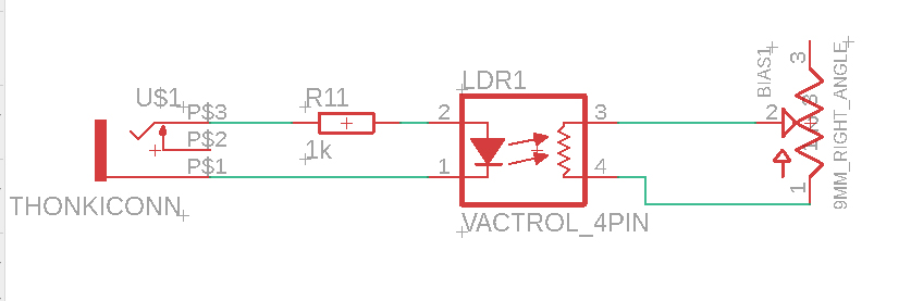

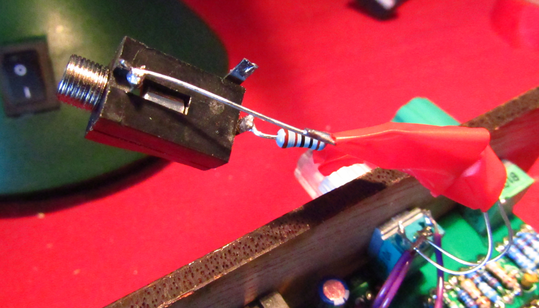

a little picture
klein vactrol
and a simple schematic schema copy
notes:
you can probably also use pin 2 & 3 of the pot. then It works inverted(not tested)
experiment with led types and resistor values
I used a clear yellow led and 1k
the LDR has no polarity, the LED does
black tape probably works better. or use a heatshrink . or a real vactrol

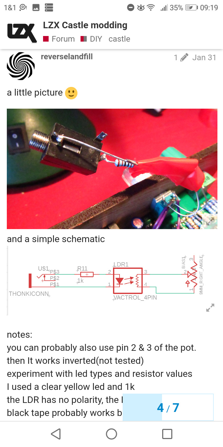

Do you still have the two photos you posted in January stored away for easy finding to reupload here? I hope so & if it’s not too much trouble, could you please upload them again :+1:t3:
I’m really curious to see this.
#7 — reverselandfill · 2020-09-09
what photos do you mean?
#8 — Robbertunist · 2020-09-10
This one. It wouldn’t load up last night (I figured it was deleted because of age), maybe my connection was low as my friend was streaming some TV content.
Screenshot_20200910-091918
