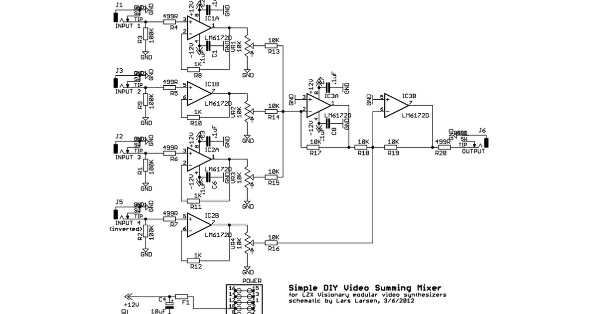

you could use my Video Matrix Mixer.
Most audio rate mixers will blur the videorate signals. It depends on the slew rate of the used opamps.
This can be a cool effect though.
Interesting functions are things like an inverted input and offset
In the past I’ve build the Summing mixer, based a schematic by L. Larsen
drive.google.com
https://drive.google.com/file/d/0B_gD4TorwvAdSjNCNVBkU3pIRDg/view?usp=sharingGoogle Drive file.
Link: Simple DIY Video Summing Mixer.pdf

If you’re looking for someone who can build a Cadet or Castle module for you, reply to this thread or contact one of the individuals in the list below. > Here’s a list of electronics builders willing to build Cadet and Castle modules on commission.  These fine folks are available to contact for building services if you are not an electronics hobbyist and want an assembled version of these DIY projects. >>>> [@JunkRhythm](/u/junkrhythm)>   Los Angeles, California, USA>>> [@sigdigits](/u/sigdigits)>   Southern California, USA>>> [@reverselan…](/u/reverselandfill)
As a sidenote:
I am busy with a simple videomixer project
Ok. I had a layout based on the LZX / L.Larsen design of the Summing mixer. > The basic design of the Summing mixer already has a place in my custom video synth, but > I want to add some features, and make it suitable for the Eurorack format > Maybe a simple filter . I don’t know yet. I was looking at an Allpass filter for phase shifting and possible interesting feedback effect… > Suggestions are welcome! > current layout & schematic features: > 4 channel mixer > 3 normal inputs with attenuators > 1 inv…>
