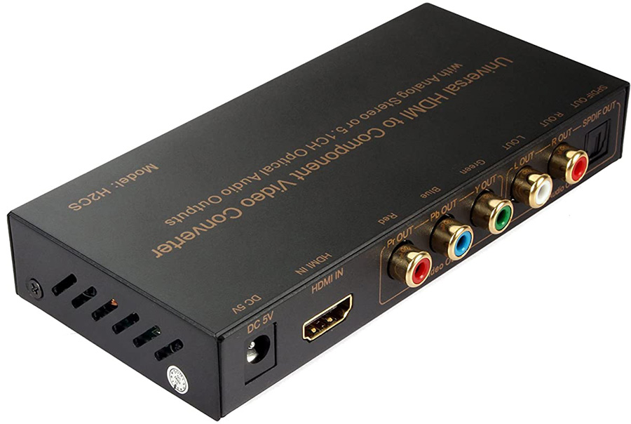

Don’t have one yet (it’s in the mail to me now), but one could in theory use the HDMI > Component converter others have confirmed works for them with a Visual Cortex and use only the Y out — since that carries the luma info and sync — to a Vidiot. (Right?)
Still more expensive and less feature-rich than either of the Extron boxes mentioned above, but does go straight from HDMI and also a lot smaller of a device.
I can test this once mine arrives.

Sadly, that device is not sold by Amazon UK. I tested a load of devices like it that I found on ebay, but they all failed with the VC. All the cheap HDMI to composite converters I tried also failed. Maybe they’ll work with a Vidiot, but I can’t test that as I don’t have one. My solution was to send the signal thru a V4 and then into the video synth.

HDMI-Component

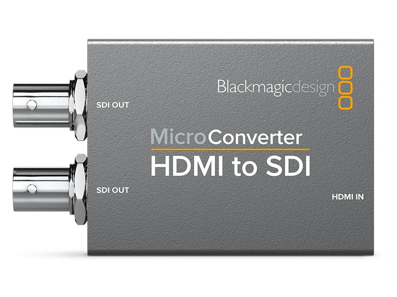

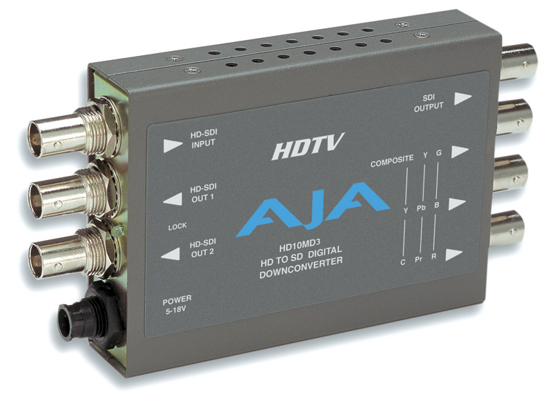

Following up on this, so that HDMI > Component converter that others had recommended (above) turned out to be a bit of a bummer for me as a principal intended use was to feed digital cameras with 16:9 HDMI output into my system. But that box only seems to squish 16:9 to 4:3 and offer no option for cropping.
Decided to try another solution and ended up with something that is working for me thus far, a Blackmagic HDMI to SDI micro converter paired with an AJA HD10MD3. The AJA box outputs component or composite and will crop or letterbox. Bought those both on Ebay and I think it was a little more than $80 total, incl. all taxes and shipping (had to wait a bit to find decent deals on each).
BM_HDMI-SDI
AJA-HD10MD3
Anyway, don’t hear folks talking about AJA stuff too often — and this is my first time actually getting one of their devices — but have had my eyes on a few and it does seem that, despite generally much higher retail pricing, the secondhand prices for them are much lower compared to similar devices from Blackmagic.
