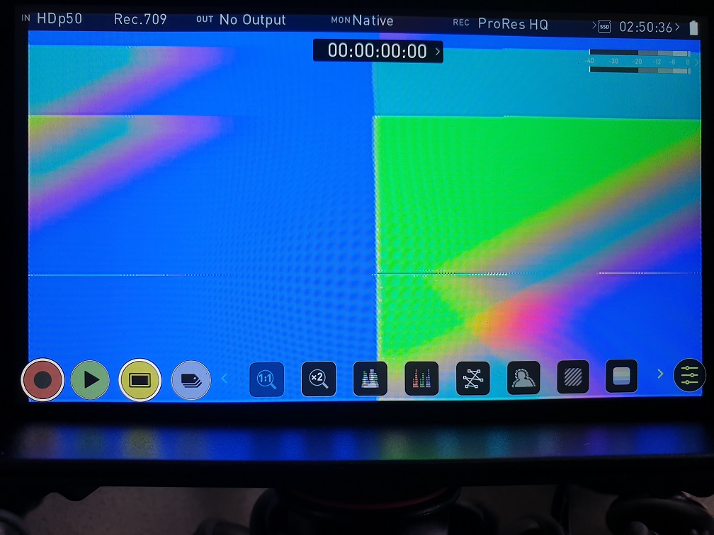

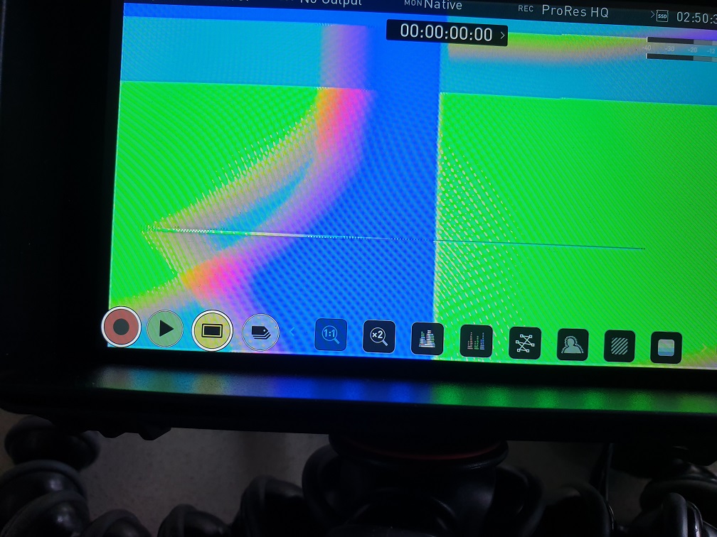

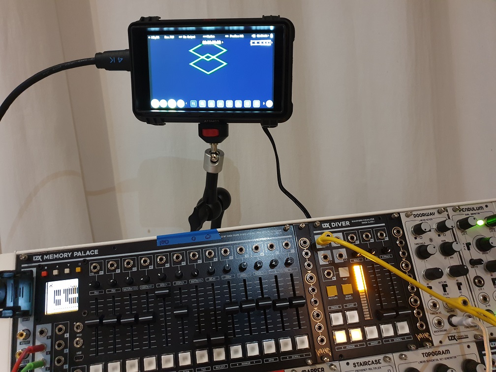

My Diver arrived today, just in time for a party tonight. The unit is working fine except that it’s outputting one glitched line - see attached. The line changes colours as the screen changes, but not in line with what’s around in.
Sync is running Memory Palace > Diver > Fortress > ET Structure > LZX case connector > Cadet I > (via cable at the back) Cadet II. The Cadet I and II are in a separate case and the glitch is still there when I don’t power up that case (ie when only MP, Diver, Fortress and Structure are powered).
The glitch line doesn’t show when I take outputs from Memory Palace or Fortress.
I’ve tried reinstalling the firmware and change the socket the power is going into, but without luck.
Any ideas of what the problem could be?

I tried changing the sync chain (now MP > Fortress > Diver > ET Structure > Cadet I > Cadet II), but no improvement.

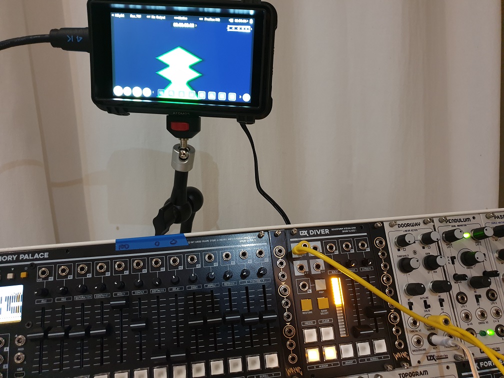

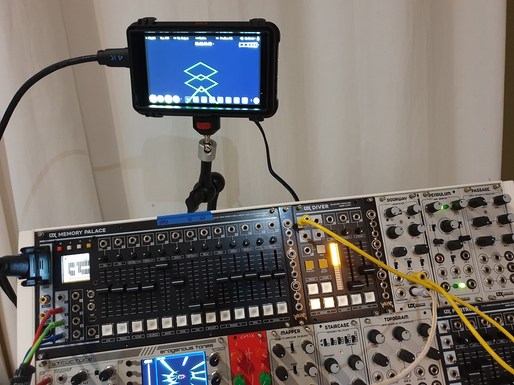

An issue seems to be the vertical ramp is not a clean ramp. When I put the H+V through Doorway then straight to one channel on the RGB output, I’m getting reflections. I’m newbie to this, so happy to be told I’m missing something important.
Update - I get both the glitch and image doubling/reflecting problem described when outputting to the MP or direct to the Cadet II (which both output to my Roland v-4ex). But when I take RGB output from the MP to the Structure RBG ins, the Structure shows a clean image (despite the MP outputting the doubled/reflected image to both its HDMI and CVBS). Similarly, when outputting from the Diver into the Structure RBG ins, I get a clean ramp, no glitch. So feels like perhaps the Diver is working fine, perhaps this is a sync problem?

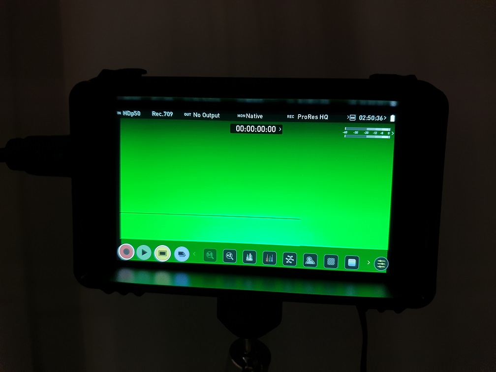

V ramp with slider set to 0, Diver > Cadet II green channel.

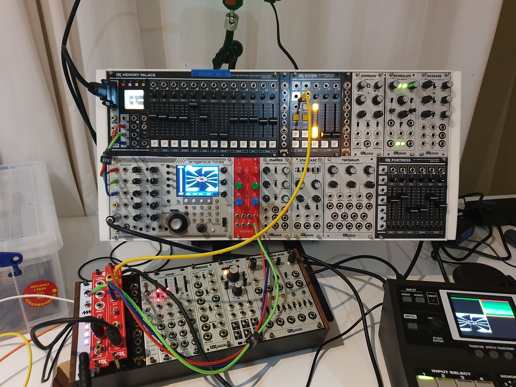

Image of the unit and signal flow from the last image
H+V, both reflections on, vertical position adjusted so the image is centered. Doorway is on solid and outputting straight to an output on the Cadet II. I think it should just be one diamond shape, but I’m getting multiples.
As above, but Doorway on outline.
Same as before, with vertical position slide set to 0.

- I followed @csboling’s suggestion and ran sync from the Cadet I via Cadet II RGB out. The path is Cadet I > Cadet II > Structure > Fortress > Diver > MP. That fixed the Diver issues. Many thanks for the suggestion
- The MP is now an unhappy syncer, so I’m going to experiment with the order of the chain to see if I can all modules happily synced
I’d update the topic title to show this is resolved and add a note to my OP, but edit is not letting me do that.
Extra update: This sync signal flow is working, with some minor noise in the detail that I can live with (ie noise around hard lines). Signal flow is:
Cadet I > (via back of panel sync cable) Cadet II > MP > Diver > Fortress > Structure
