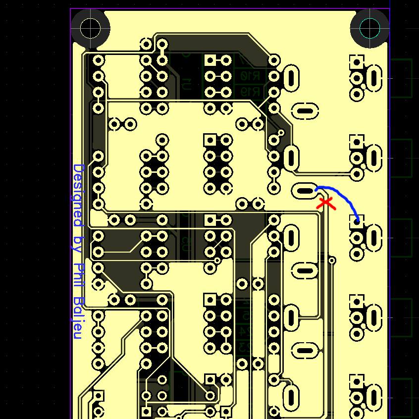

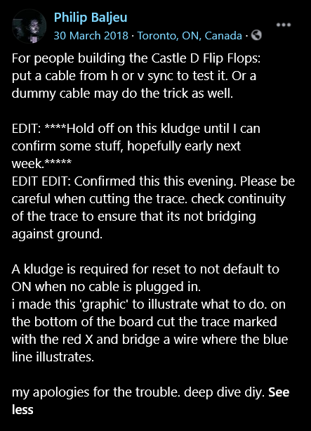

There is an issue regarding the Castle module, a cut in the PCB has to be made & a connecting wire soldered, its documented on here somewhere. Maybe the one you’ve been offered @Fallinggirl has been correctly modified.
#7 — pbalj · 2021-02-16
The issue is only present on Castle Flip Flops RevC

I’ll also attach a screenshot of the page to include the instructions but here’s the image file.
LZX Castle 111 Flip Flops RevC PCB issue, wire fix
LZX Castle 111 Flip Flops RevC PCB issue, wire fix instructions screenshot
