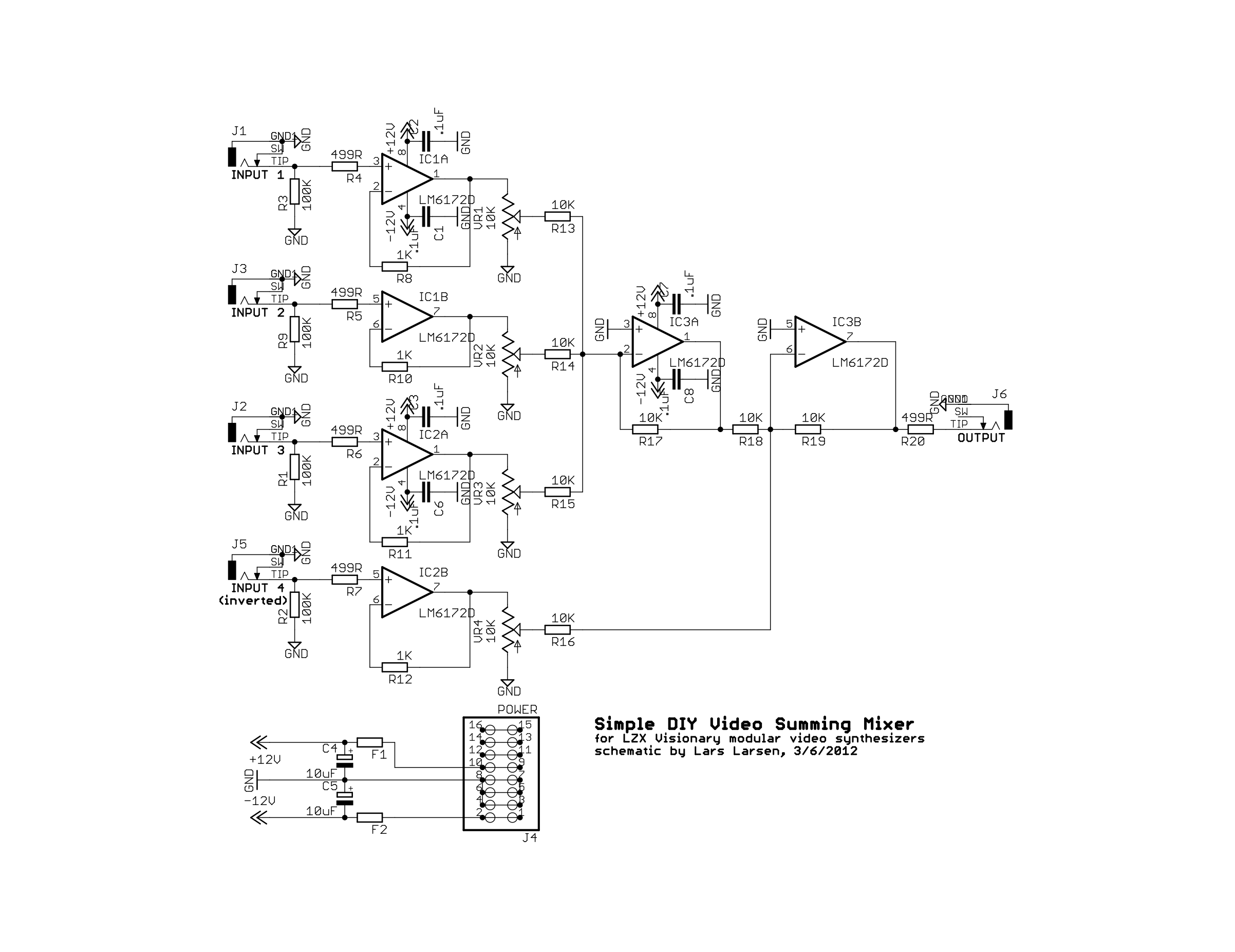

There’s the MHzxER, which is a quad summing video mixer: MHzxER DIY mixer
I believe it’s based on this old schematic LZX released:
Simple DIY Video Summing Mixer

I think that summing mixer might be exactly what I am looking for! However my plan is not to use this in a modular setup but rather a stand alone device for use with composite signals.
I imagine I may need to change the 100k resistors at the inputs to 75ohm. To be honest I am not all that familiar with the LM6172’s so I’ll have to take a look at the data sheet. Since its not going to be used with modular level signals I’d like to be able to configure them for single supply operation.
Does anyone have any other suggestions for amps? Would the AD8013 or similar be an appropriate substitute for the LM6172?
#7 — joem · 2021-04-11
MAX4392 is a video rate op amp that can be used single supply.
Edit to add: I just realized that if you’re planning on using it with composite signals, I think you’re going to need to add some extra circuitry if using a single supply opamp. Composite signals are AC-coupled, I think, so there’s a positive and negative component to the signal. So you’ll need circuitry to offset it back into the only-positive range before putting it through a single-supply opamp mixer, I think. (I think this is called “DC restoration” in the video circuits world.)
You might want to go with a dual supply opamp that can run on +/-5V or even +/-3.3V and convert what I presume will be a DC power source into dual supply power with a 7805 & 7905 voltage regulator pair (or something like that). Then you don’t need to deal with offsetting the input signal.

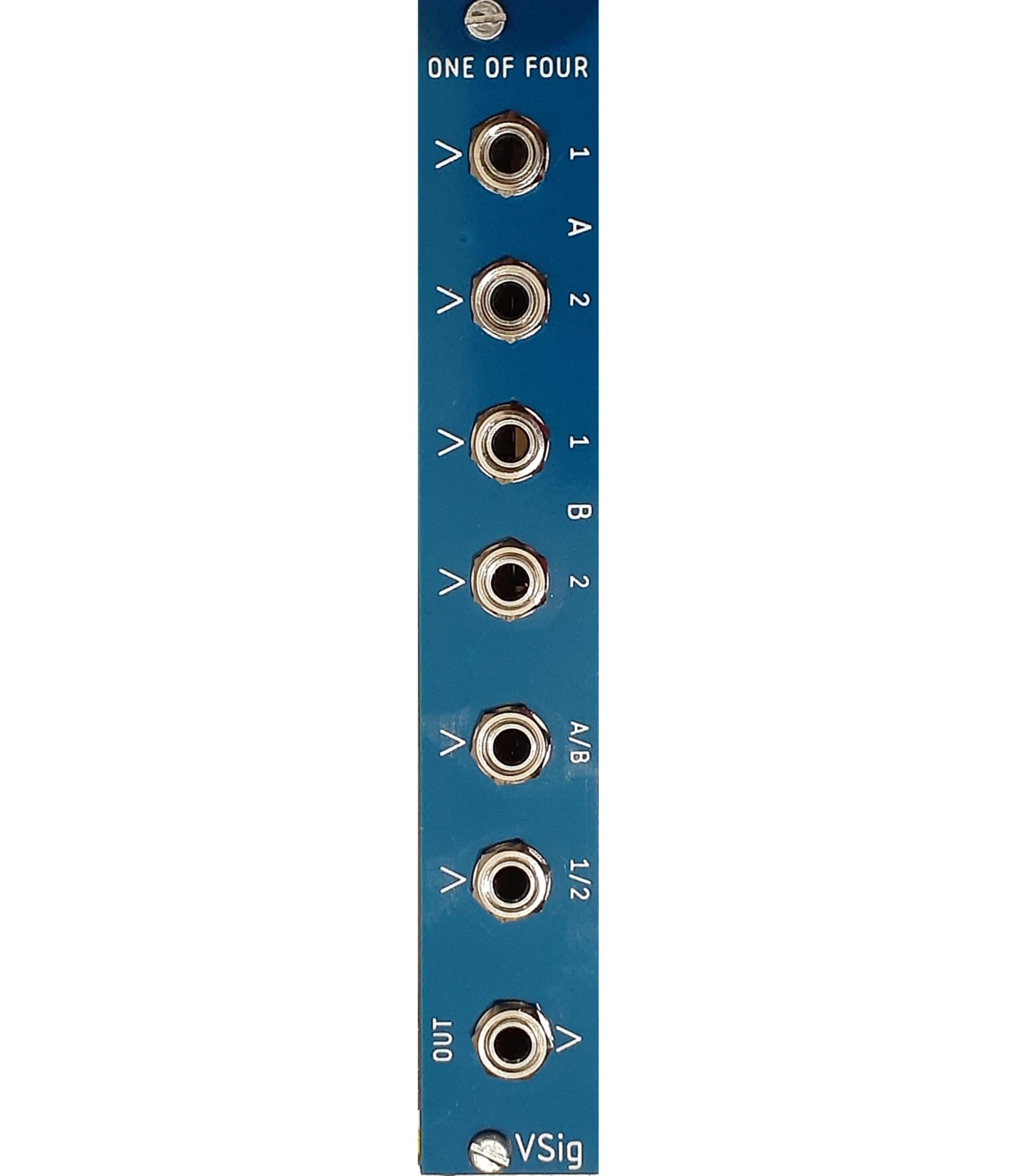

@x1qt, Adrian built this exact module but only now have I read that you want this for stand alone use & composite signals. If your OK with SMT, the ADA4851-4 is a cheap and cheerful quad op-amp that has been recommended by Lars on here in other posts. https://eu.mouser.com/ProductDetail/Analog-Devices/ADA4851-4YRUZ?qs=BpaRKvA4VqGU%2Fu%2FGddZJ%2Fg%3D%3D
For anyone else looking for a module, hit the Visible Signals site, it’s called the ONE Of Four.
visiblesignals.net
https://www.visiblesignals.net/product/one-of-four/Link: One Of Four – Visible Signals

#13 — VisibleSignals · 2021-04-12
Thanks for the free promotion Robin
but the One Of Four is a 4-input switcher (not a crossfader) for LZX/euro signals, so a bit different to what the OP is looking for I’m afraid.
