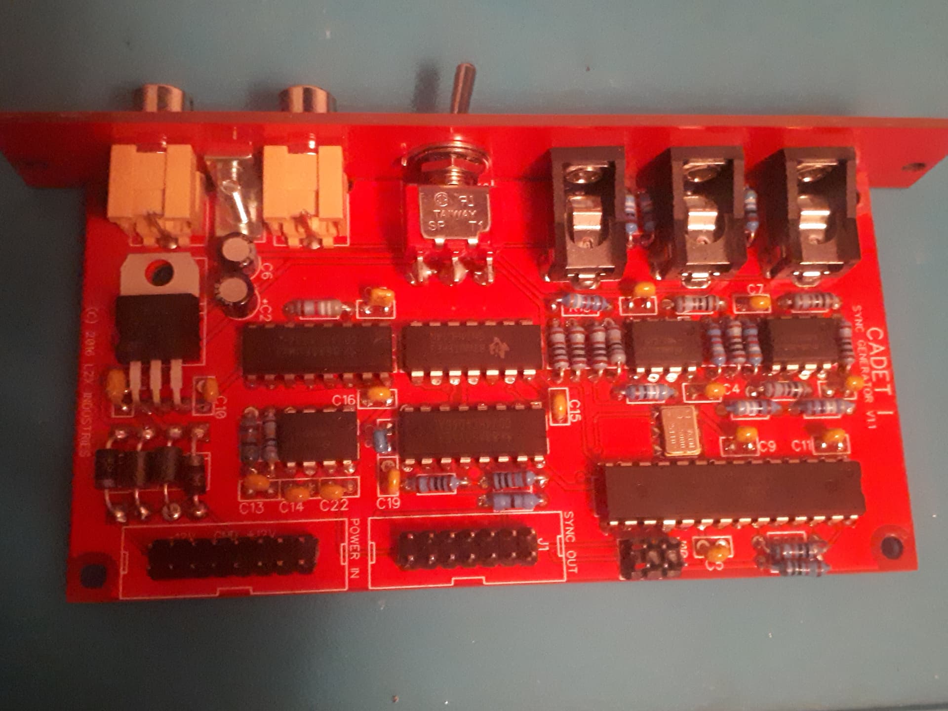

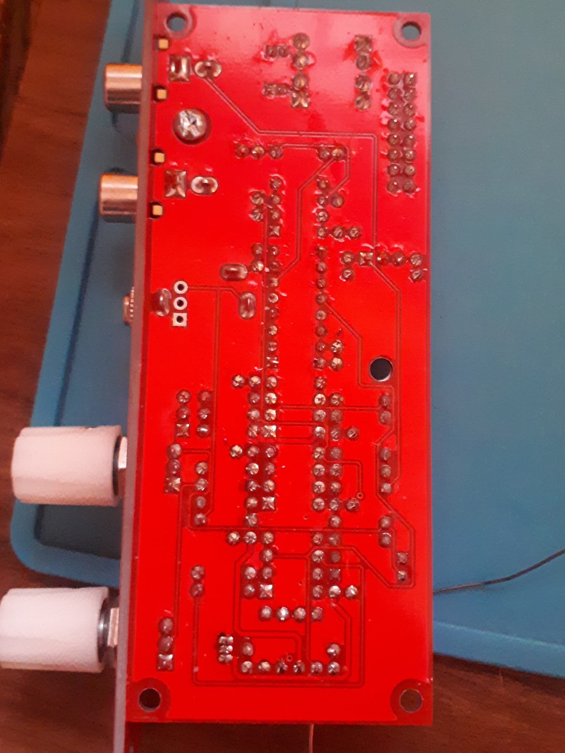

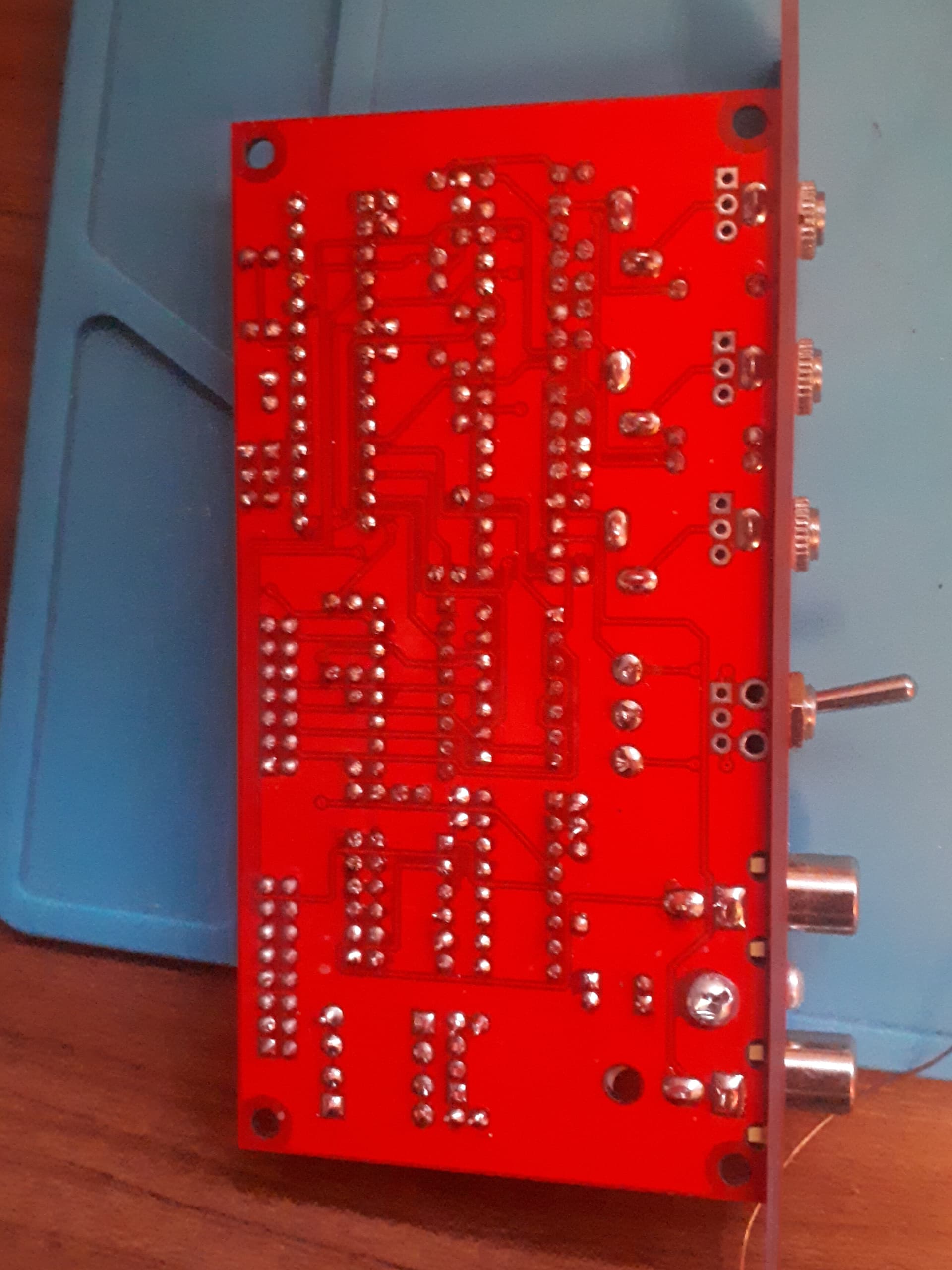

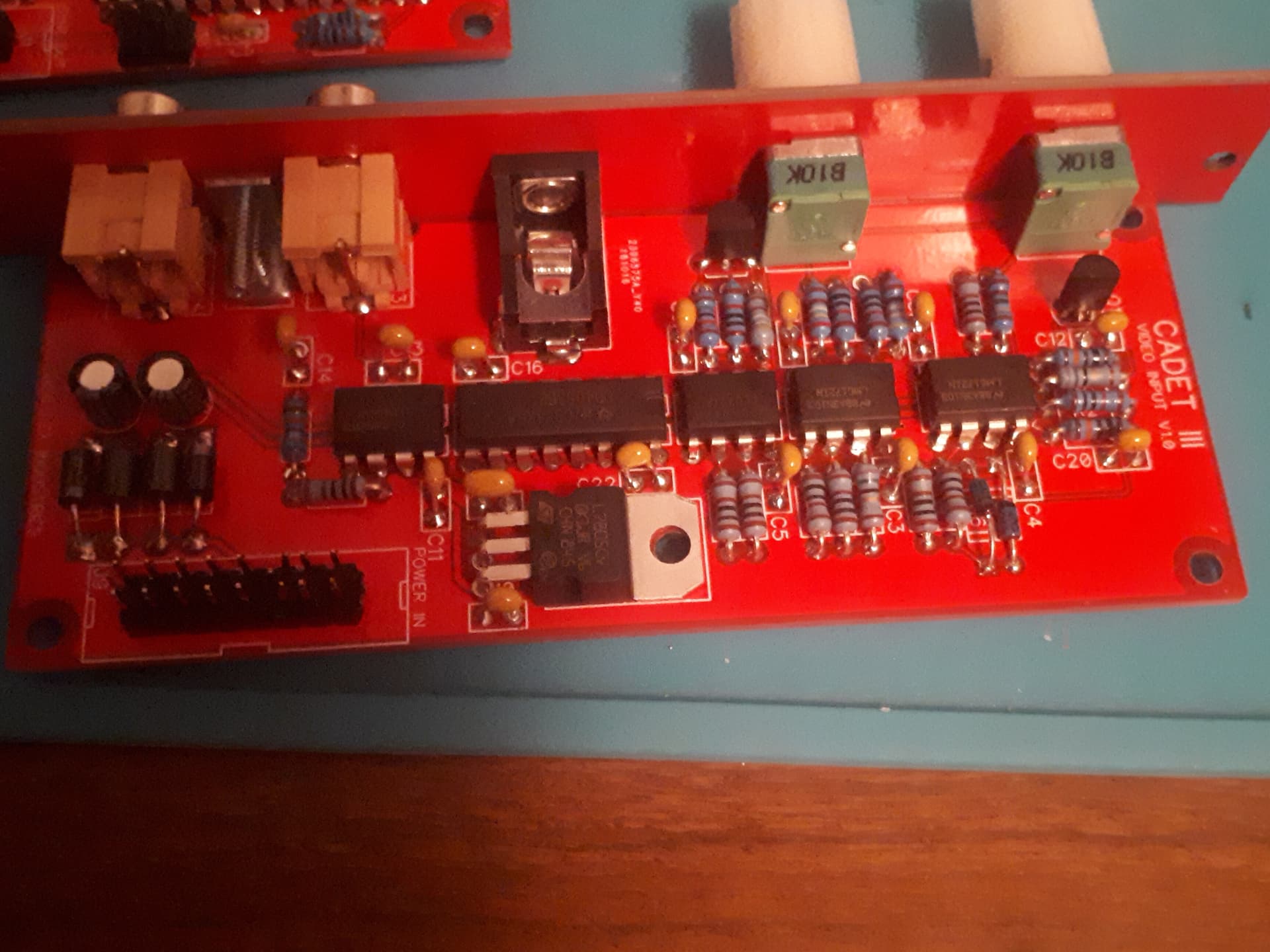

Here’s some images of the Sync Generator and Video Input boards.

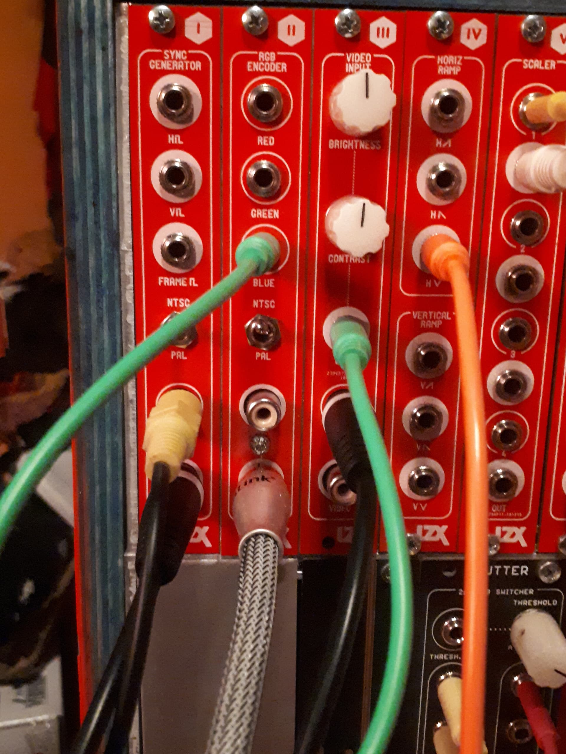

Sure, here’s how it’s patched:
IMG_20211104_233216
So the Yellow RCA is the Composite Out from my camera, the White-stripe RCA is going Cadet I Out to Cadet III In, Luma Out from III to the encoder. While I have your attention, I love your work thanks so much for releasing these designs!

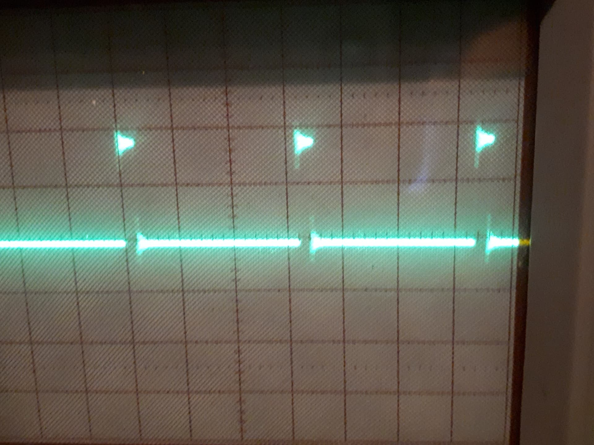

Anyhow here are the pictures:

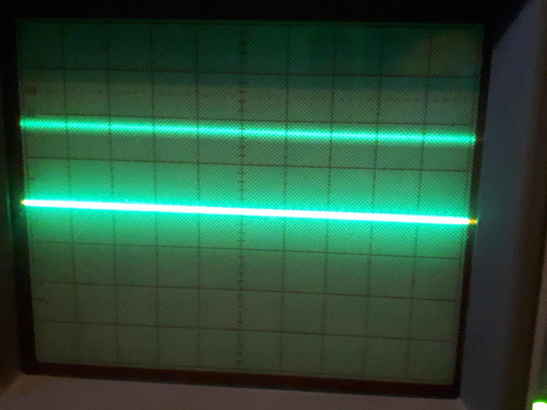

IMG_20211105_172440
This is Pin 3, each square on that screen is set to 2.5V so that upper line is at about 5V. This is 1ms. IMG_20211105_174515
This is 20 micro seconds IMG_20211105_174548
And 1 micro second. That’s so cool, I didn’t get why it was two parallel lines but now it makes more sense, thanks for accidentally teaching me about the importance of the time constant.

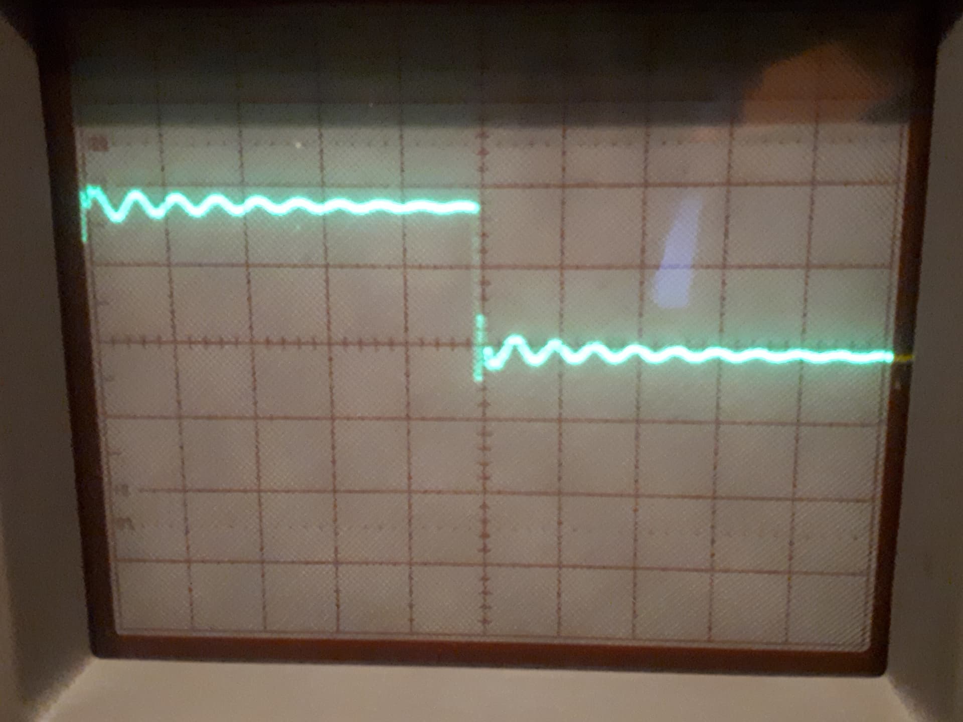

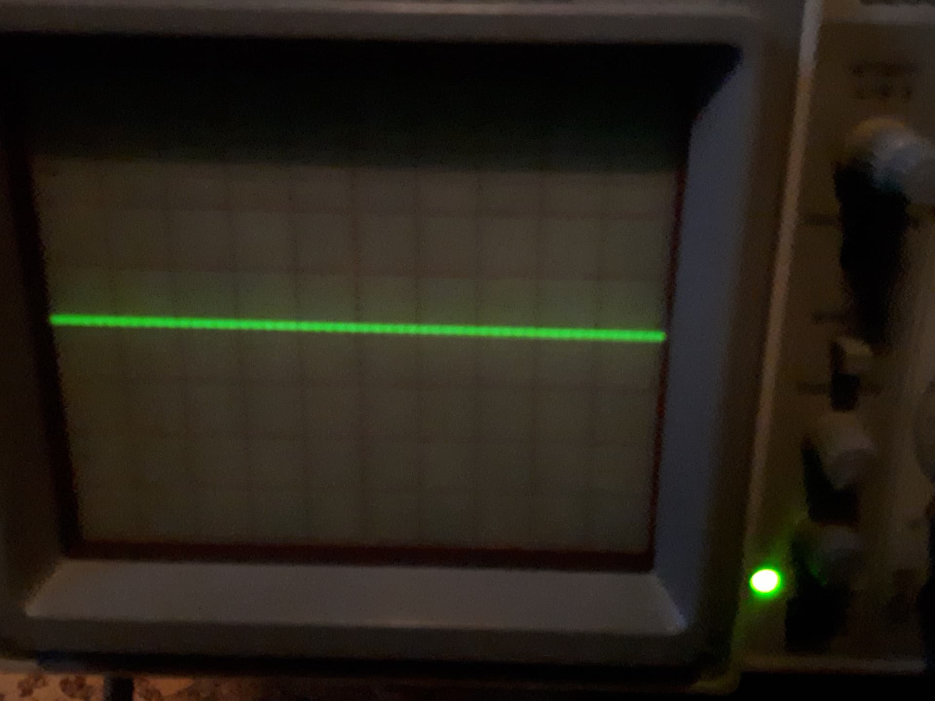

IMG_20211105_172627
And here is mysterious Pin 13. Reads 0V on the MM, just seems to be dead on the scope, doesn’t do anything fun when I change the timing.
