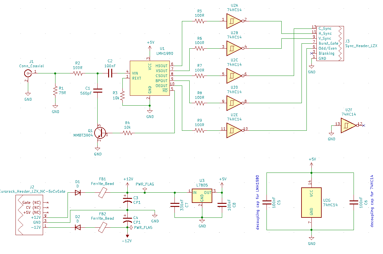

rca-to-14pin-1
I think the single inverter per output is right since according to my notes the 14-pin sync format is positive-going signals, but the sync output by the lmh1980 is negative going, right?
This should let you sync the Cadet 4 Ramp Generator and Cadet 9 VCO in an RCA-sync system. Also, I think I’m going to tack on some jumpers that when closed will also send H and V sync to the CV and Gate lines on the power header, so that it could also (optionally) be used to sync Castle VCOs.
I’m also thinking of maybe making it be a module (instead of just a PCB that you need to mount (or leave dangerously dangling) in your case. Then it should be easy to also add some H, V, and Frame sync output jacks like the Cadet 1. But maybe that’s a bit too much feature creep. I also haven’t decided on whether it should be through-hole or SMD. The LMH1980 is SMD, so maybe the whole thing should be, since I already have to deal with that one part? It could make for a nice small board if SMD, probably.
Technically, since it uses an LMH1980, this should also convert from HD RCA sync to 14-pin sync, but I’m not sure how useful that’ll be… The Cadet 4 Ramps definitely would need to be recalibrated (and maybe have some parts swapped) to be useful for HD rates, and the Cadet 9 VCO might need to be recalibrated too (I can’t remember what its trimpot is for).
So, what do you think? Would this be useful to you? And if so, any requests/suggestions? And from an electrical standpoint, do I have it right?

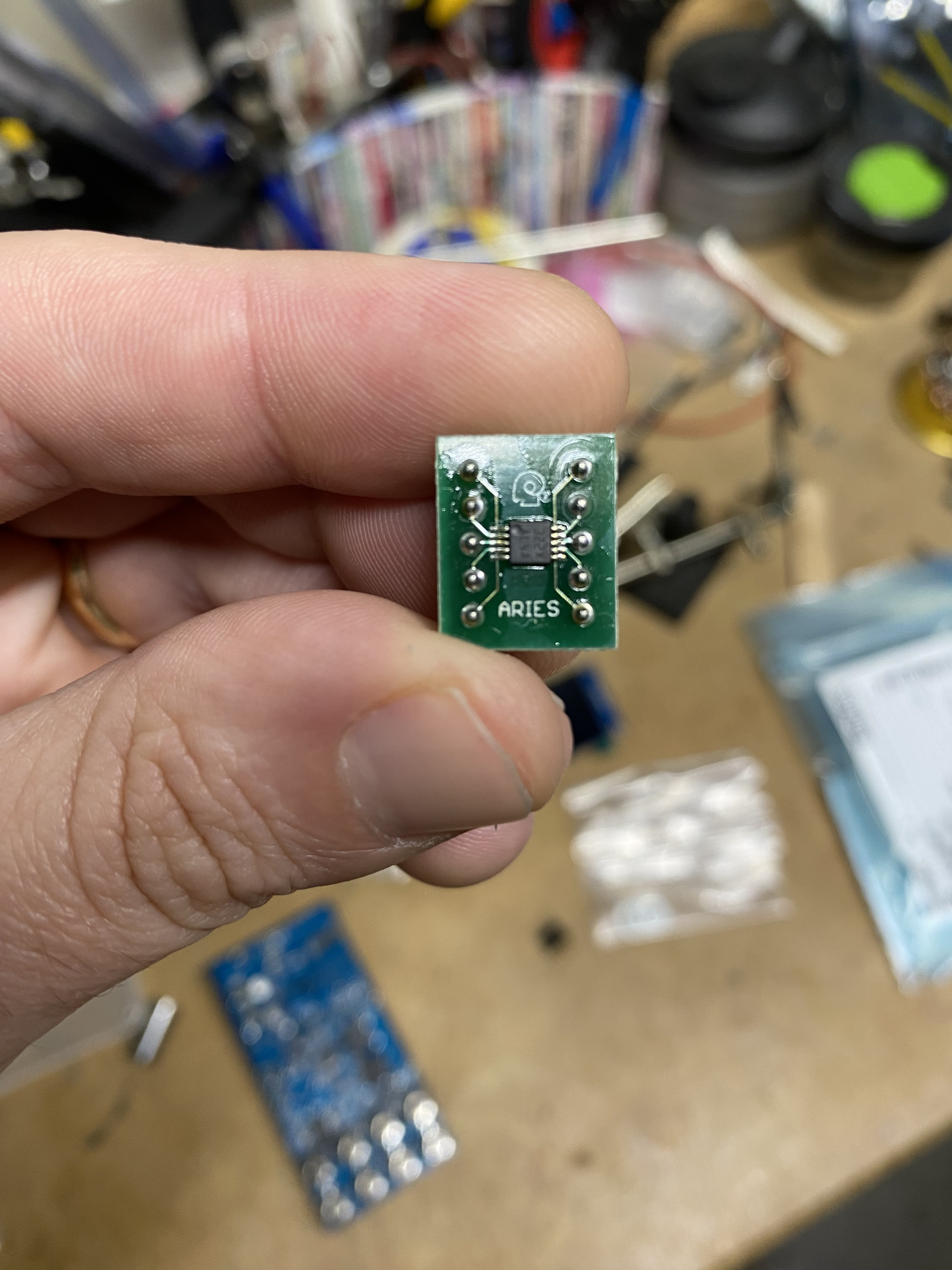

The only snafu I’m encountering is finding vssop to dip adapter to actually get this built up on a one off perf board.

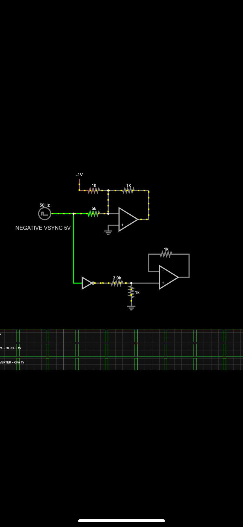

IMG_6261
Top circuit is an opamp and -1V reference to invert and the bottom is a 74HC14 and opamp buffer to invert. I’ve got an LMH1980 on a breakout board looking like this:
IMG_6626
I need to finish up the board. I figured I could use a 16 pin header and connect the horizontal/vertical sync hooked up to cv/gate on the 16 pin header and supply sync to one busboard.
I just need to get inspired again. The power supply situation in my case is garbage and was giving me artifacts in my output. Just so many things to get right and I’m writing this while holding my newly 2 year old daughter.

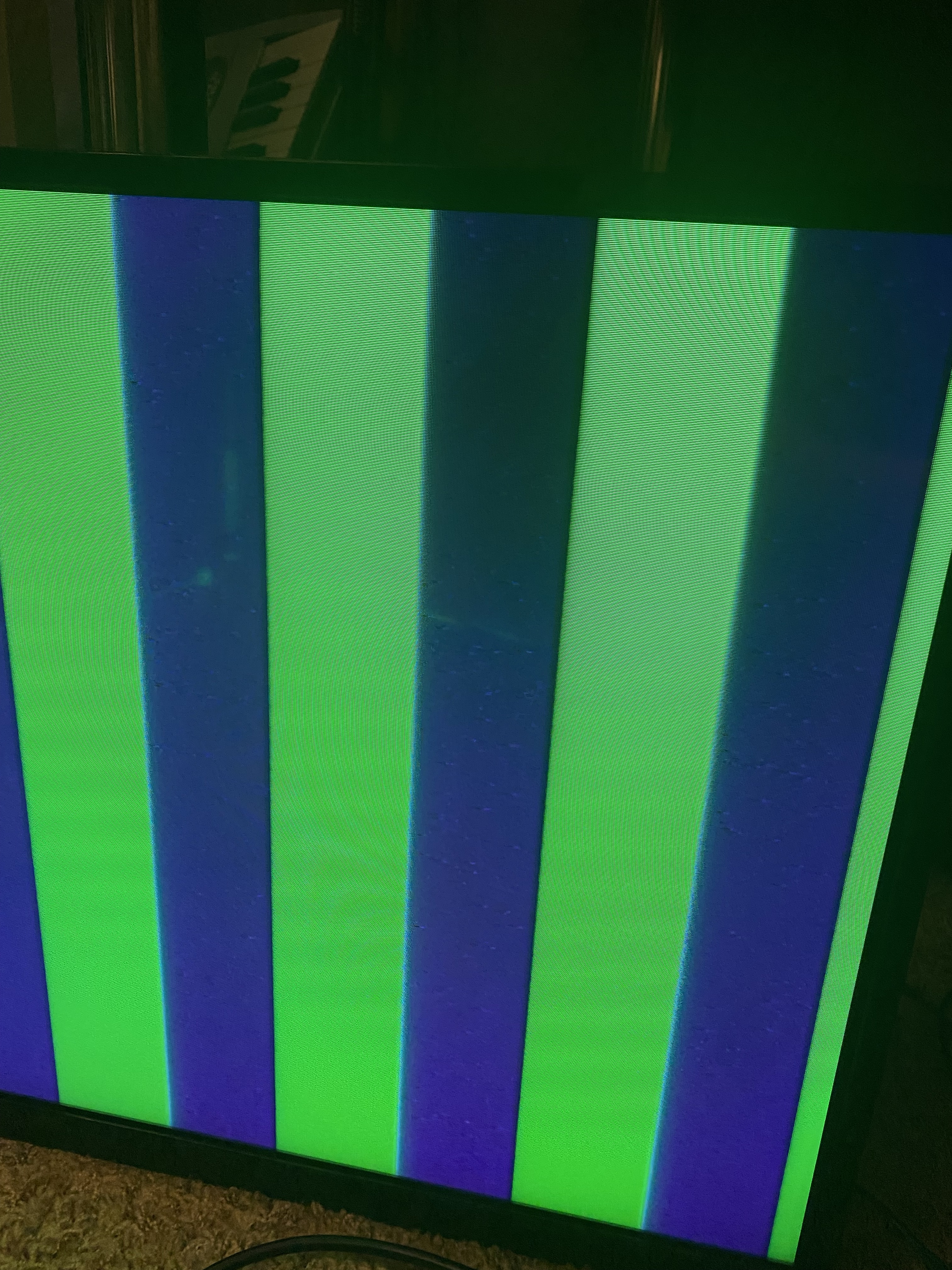

#19 — jmsiener · 2024-10-07

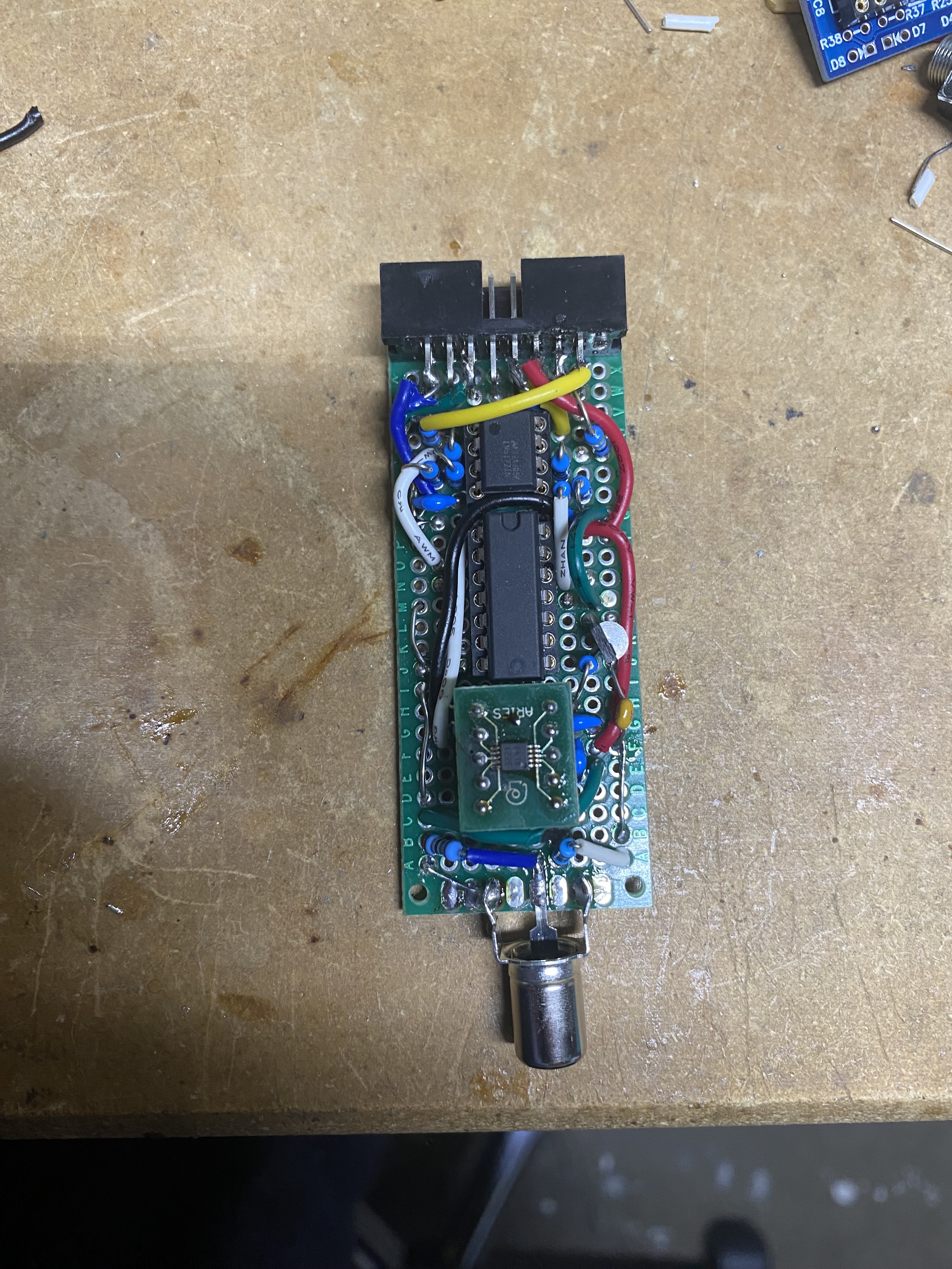

Hey y’all, I figured I’d share this little abomination I made on some protoboard to get my castle modules vibing in my case:
IMG_6963
It takes the RCA sync from my VU007b and goes into an LMH1980 to extract sync, a 74HC14 to invert the signal, then into an LM6172 for buffering, and finally the CV/Gate pins on the 16 pin power header. Here’s a shot with the sync generator at 720p:
IMG_6964
I’ve built somewhere in the neighborhood of 100+ eurorack modules, primarily panel/PCB combos, and this is the first project I’ve completely DIY’d with success, other than adding a summed output to my AteOhAte Toms. I had the idea initially almost a year ago and finally got around to executing it. I’m rather positive this idea could be shrunk down to something the size of a 5V PSU busboard adapter but I think this thing wrapped in plastic and gaff tape can be chucked into my case without remorse.
For the LMH1980 I used the example schematic in the data sheet and then @syntonie, who without his help this wouldn’t exist, helped me figure out the inverter and opamp buffer.
I think there’s room for improvement. I’m going to try swapping out the output resistors on my Castle VCOs to 75r 1/2W and see if that helps. I might try the same on my protoboard if that doesn’t clean up the output some more. There’s a little bit of fuzz/distortion/noise/idfk-how-to-describe-it on my falling edge of each bar, right side, (maybe it’s noticeable in the picture I shared) whereas the opposite, or left, side seems much sharper. I used 499r resistors between the opamp output and V/H sync power header connections.
PS-Sorry for derailing this thread with this post. It doesn’t exactly solve RCA to 14pin sync but it is good enough for a castle VCO, if anyone finds themselves in a similar situation.
#20 — rempesm · 2024-10-12
Not a derail, nice work!
I bet you could do the same thing to get RCA to 14 pin sync, just adjust the levels to match what that bus is expecting. H/V gate/CV sync is 1V, 14 pin sync is 5V. You probably only need to adjust the op amp buffer.
720p is a pretty demanding resolution for bandwidth, especially for sharp edges on instantaneous black/white square waves. I’m sure you’ll get some edge improvement by swapping to 75R 1/2W series output. This adjusts the inherent RC low pass filter created between the output resistor and the capacitance of the cable. There’s no inherent need to do that for your H/V sync pulses using 499R, they are relatively much slower than what a Castle Clock VCO can spit out.
I wouldn’t expect a pixel perfect edge with no noise as hard transitions are the most likely spot you’ll see the fuzzy bits of your power supply and any other interference in your setup.
#21 — jmsiener · 2024-10-13
Thanks for all of this extra background info. I really only kind of, somewhat know what I’m doing. My assembly skills are far superior than my EE skills.
I’ve got a second Castle VCO that I’ve done the resistor swap on and will be able to compare them side by side. I’ve got a lot of moves to make on this case and honestly, the power supply is hot garbage. I should replace it but that’s a whole other can of worms.

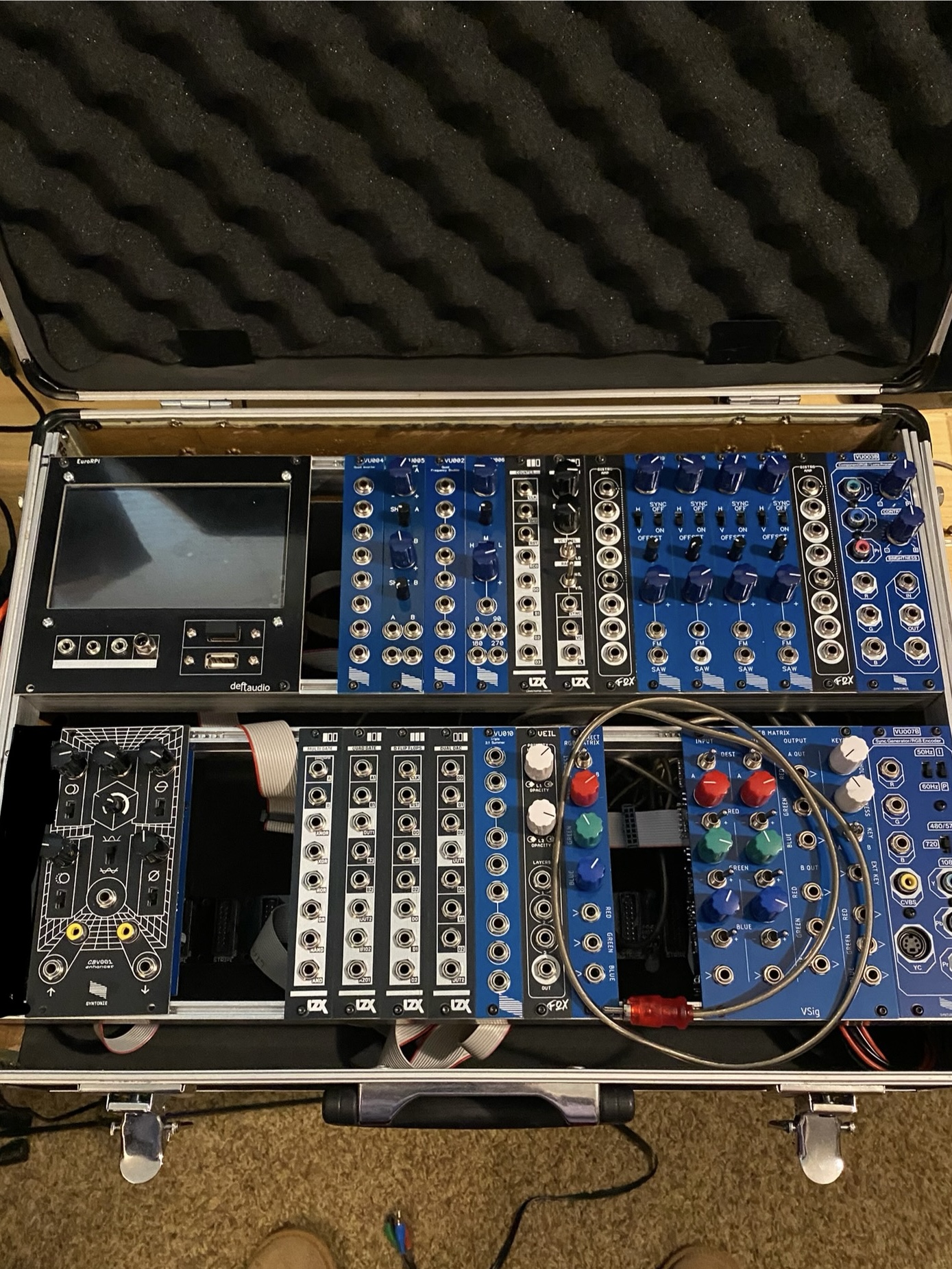

Either way, after a year+ of building this system it’s finally starting to come together.
IMG_6940
