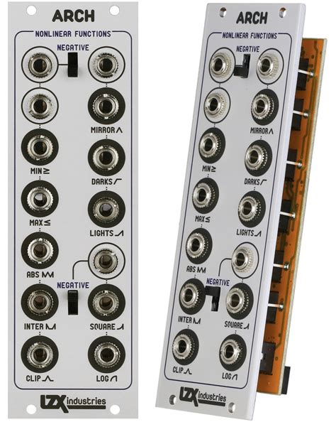

I love the instant complexity of the DSG3 when one ramp ‘feeds back’ to modify the shape of the other ramp - I think what is happening is that one H or V is being replaced with a different one? I’m wondering what is the most efficient way to do this in Expedition. So far I have:
VC HV to VC red input
VC H to Bridge (mixer section)+ a V ramp from a cadet VCO, out to green input.
Is that the same thing that’s going on under the hood in DSG3?
#2 — sean · 2022-10-31
th-457782698
#3 — Gavin · 2022-10-31
Damn - the only one I never picked up. Yeah, I can see it clearly as a logic function just from those inputs, thank you. Looks like I have to get a DSG3 if I want the Arch function - can’t see there’s any other modules planned for that, though a new DIY Arch without the ramps of DSG3 would open up lots of possibilities.
#4 — sean · 2022-10-31
Not sure whatever became of this project: [WIP] Analog Logic
Hopefully will come to fruition at some point!

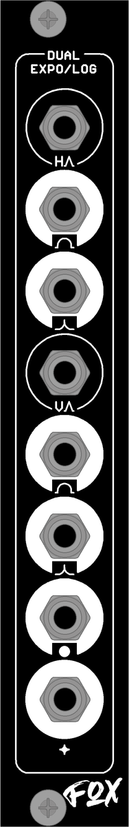

#5 — joem · 2022-11-01
I think this might be a relevant module too:
Foxing Hour
https://foxinghour.com/products/gamma-dual-square-and-logarithmGAMMA features dual squaring and logarithm functions to adjust the light/dark distribution of provided luma signals. Also featured are two summed outputs which mix both of the above square and log results to easily create circles and four-point...
Price: USD 26.00
Link: GAMMA - Dual Square and Logarithm

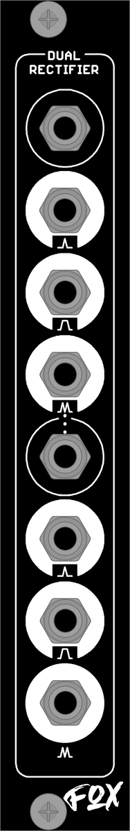

#7 — rempesm · 2022-11-01
GAMMA covers the lower right hand section of Arch.
There’s also RECT which covers the upper right hand section of Arch.
Foxing Hour
https://foxinghour.com/products/dual-rectifierDual RECTIFIER offers two clipping and frequency doubling sections. The first output clips inputs below mid-grey and accentuates the bright portions of the signal. The second output clips signals above mid-grey and accentuates the darker portions of...
Price: USD 22.00
Link: RECT - Dual Rectifier and Frequency Doubler

Ah! Yes, I thought there was another one, but forgot which it was.
