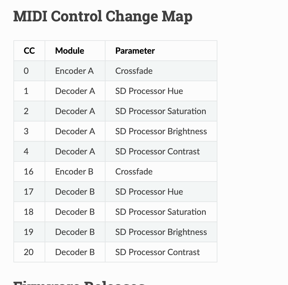

also from what I’m seeing via the TBC2 panel the proc amp controls are only showing up when using SD inputs (hue,saturation,brightness,contrast) is that going to be extended to the other inputs at some point?
extending that thought the MIDI map specifies SD processor saturation so I’m assuming if the midi is working the only the crossfade will do anything if you are running anything other than SD rates.
it also looks like encoder a crossfade is mapped to CC0 which can be problematic for different controllers. For instance the 16n can’t send midi out via CC0.

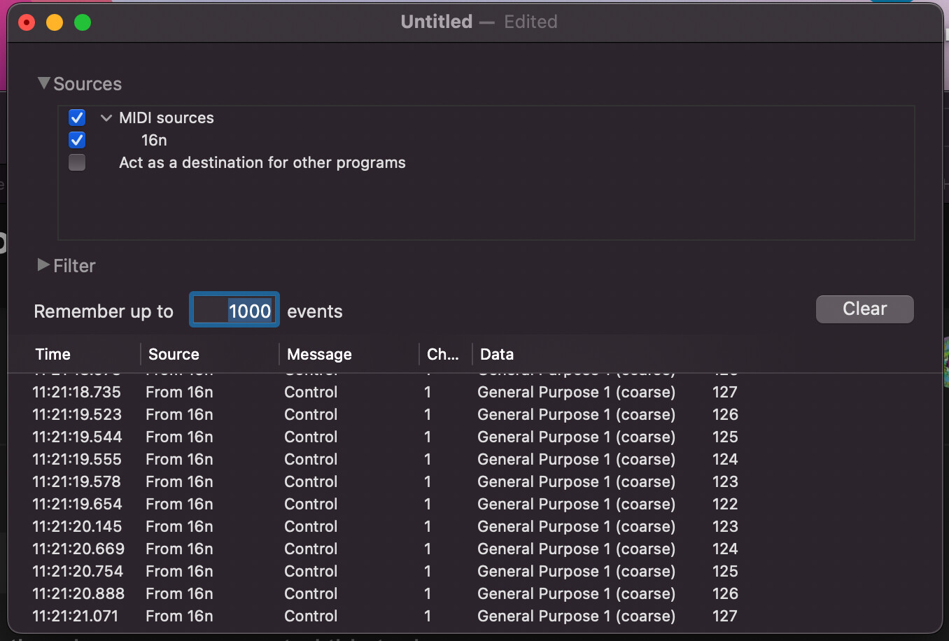

ok next up… now that I’m using the midi for cross fade

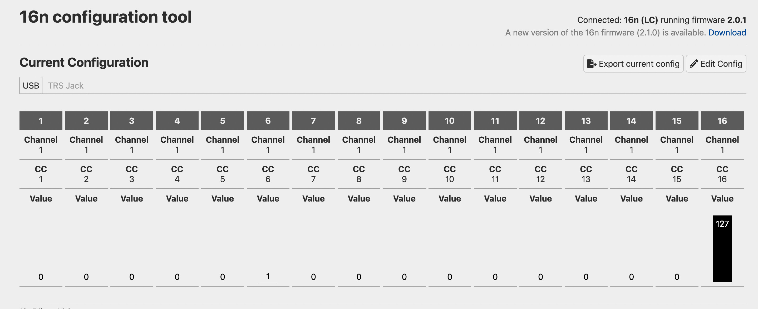

I can confirm via the 16n online editor that I’m putting out 127 on CC16 for the encoder B crossfade
Screen Shot 2023-01-23 at 11.21.47 AM
I can also confirm via MIDI monitor that 16n is putting out 127 on CC16 for the encoder B crossfade
Screen Shot 2023-01-23 at 11.21.38 AM

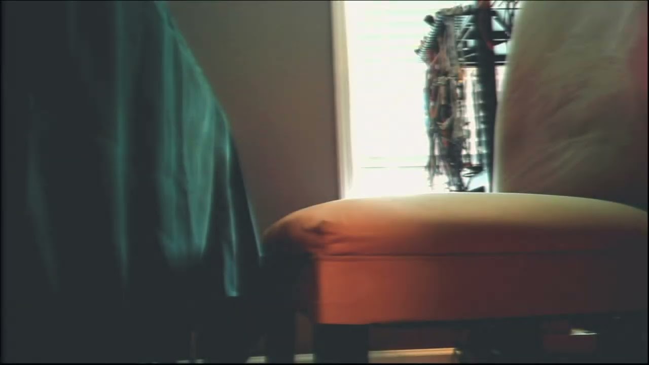

however on TBC2 it seems like the MIDI control is not fully fading between the two sources
the setup in the video is 16n going into TBC2 and the crossfade on TBC2 is also selected. This problem persists even if the crossfade isn’t currently selected.
What I do in the video is fade with midi first and then you can see what is still showing up from the other video. Then I press the button on TBC2 to move the crossfade one time and then it looks right to me.
https://www.youtube.com/watch?v=QNdwESU8_nUthe 0 state of the initial camera feed looks like it should to me. I don’t see any of the media loader bird picture showing through
I just tried with the second input as a source instead of the media loader with the same behavior.
You can pretty clearly tell When controlled the crossfader with MIDI and it not being selected on the TBC2 that the slider itself doesn’t go all the way to 100%
I love that the crossfader on the TBC2 display shows where it is at when being controlled by MIDI!
#4 — creatorlars · 2023-01-23
Thanks! I’ve logged the MIDI scaling issue and a fix for that will be in the next firmware revision. We are working on 1.0.1 (bugfixes) and 1.1.0 (remaining features) for the past couple of weeks. How do you think we should handle assignable MIDI? Should we update the CC map to start at a different number or add a MIDI assignment page to the GUI? We could do a MIDI learn mode, I just worry about everything on the display being too cramped. Another option is storing MIDI map as easily editable JSON data on the SD card.

Using CC 0 is perfectly legal, all of the CC purposes are suggestions rather than laws, but since CC 0-11 and 120-127 have behaviors that are a little bit more widely honored than the other suggestions, it seems more common for the default values of arbitrary controllers to be in the 12-119 range.
I think putting default assignments into the range CC 32-63 (as the 16n does) makes a lot of sense, in part because you can easily use those controllers in 14-bit mode!
#9 — creatorlars · 2023-01-24
I think a user defined transpose/offset of the starting CC# is probably the least intrusive way to handle it for now. I can add that as a setting next to MIDI channel in the system menu. The map will start at CC#0 + user defined offset. So with an offset of 32 you can have it match the 16n range.

dewb and I were talking about this on the discord and we got it sorted at least initially. 16n can absolutely use CC0 however the web editor up/down ticker was bounded to 1-127. I entered 0 directly into the number box rather than using the interface and it worked fine. Dewb submitted a PR on their GitHub for the issue.

I have a 16n and have noticed in other circumstances that the sliders often don’t reach 0 or 127.
#15 — wednesdayayay · 2023-03-28
yeah I ended up going into the configuration tool and setting the upper resolution limit a bit lower and it has been fine since.

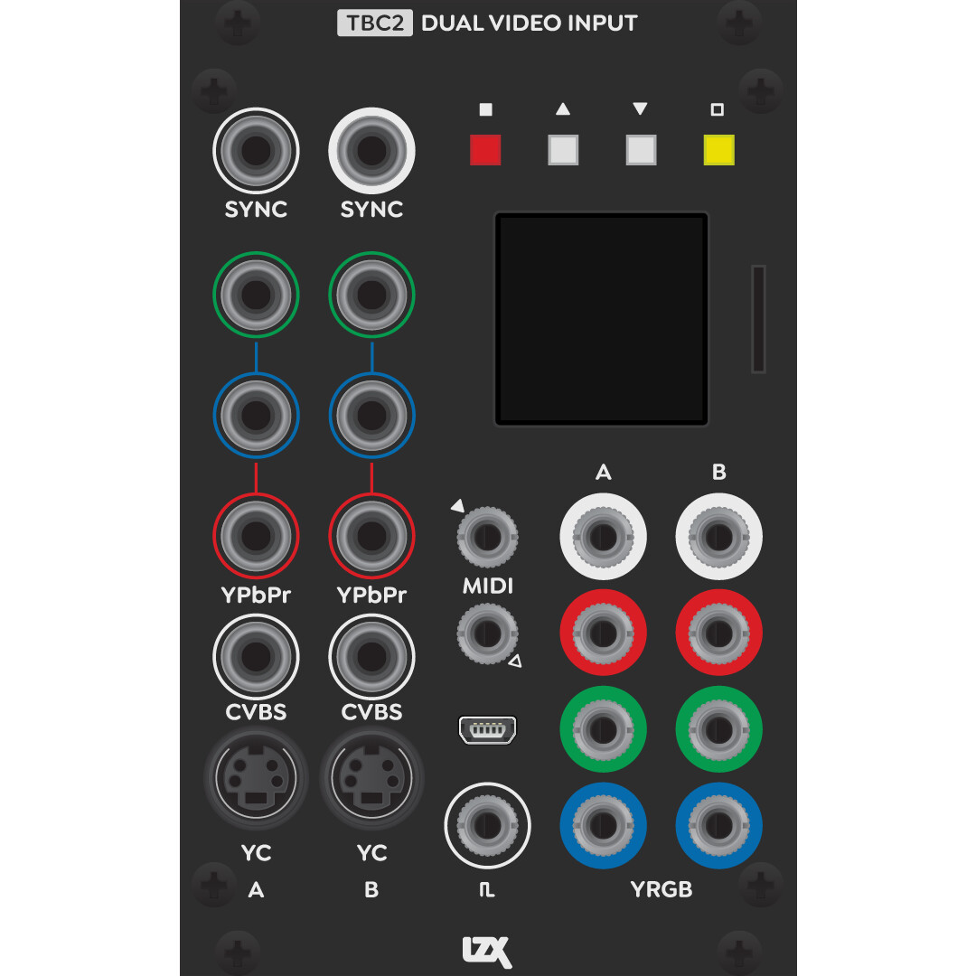

Which 3.5mm jack is midi in and which is out? I guess it is top in, bottom out, but looking at the gen3 modules, the inputs are the unfilled circles, and the outputs are the filled circles. Is it the opposite on TBC2 with the small arrows?

yes the top MIDI jack is the input

For frontpanel questions, I’ve added the legend to the site here:
