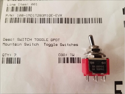

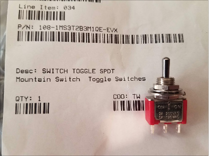

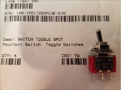

#5 — JunkRhythm · 2018-10-11
Save the clipped legs from the diodes and beads. Solder those to the legs of the switch. Works perfect and is a lot easier than tracking down the exact match in reasonable MOQ from the BOM. You’ll need to go through the datasheets to make sure the lever bat is the same on all switches if you want them all to match.
I’ve used these on all of my builds so far without any issues. The lever bats are all shorties which to me looks quite slick.
JunkRhythm wrote:
Here’s a few alternate toggle switches with shorter bat style levers. All of these will require hand wiring.
108-1MD1T2B3M1QE-EVX > DPDT ON-ON>>> 108-1MS1T2B3M1QE-EVX > SPDT ON-ON>>> 108-1MS3T2B3M1QE-EVX > SPDT ON-OFF-ON
108-1MD1T2B3M1QE-EVX%20LZX-Community>>>
108-1MS1T2B3M1QE-EVX%20LZX-Community>>>
108-1MS3T2B3M1QE-EVX%20LZX-Community>>>
