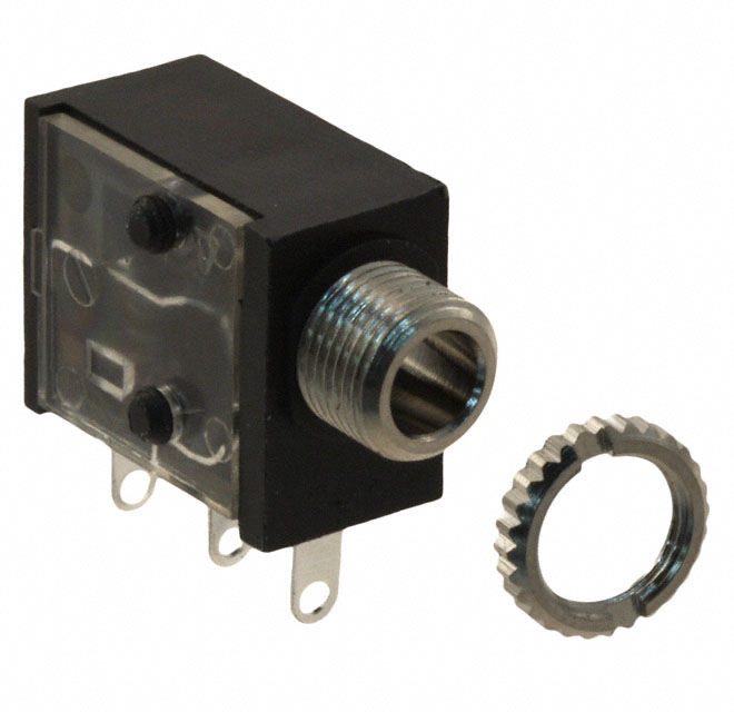

Does anyone have a part number for the 3.5 mm jacks on the Differentiator? I do not see any obvious matches at digikey or mouser.
#34 — jnoble · 2018-09-11
These seem to be the ones. I have some on hand but have not yet soldered them in to be 100.00% sure:
Digi-Key Electronics
https://www.digikey.com/en/products/detail/35RAPC2AV/SC1457-ND/772080Order today, ships today. 35RAPC2AV – 3.50mm (0.141", 1/8", Mini Plug) - Headphone Phone Jack Mono Connector Solder Eyelet(s) from Switchcraft Inc.. Pricing and Availability on millions of electronic components from Digi-Key Electronics.
Link: 35RAPC2AV | Digi-Key Electronics

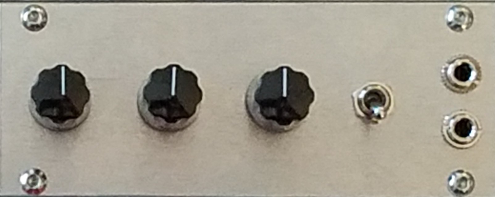

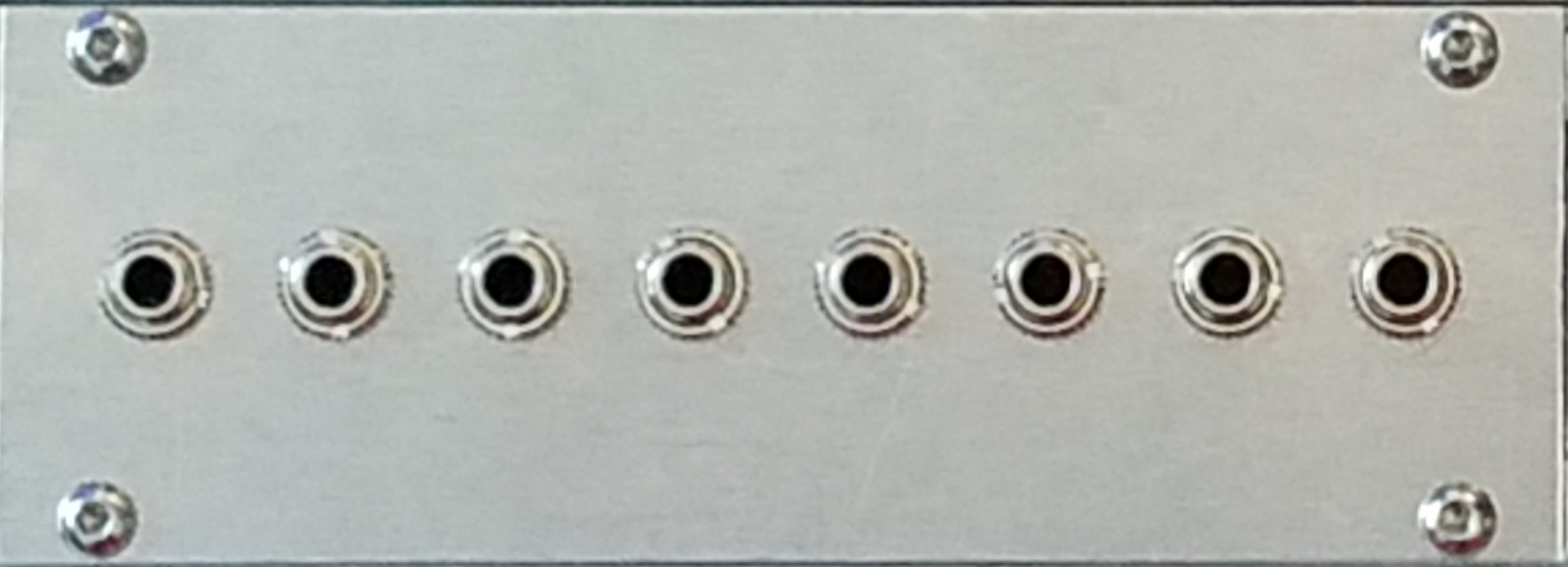

I finally received a pack of .125" end mills today and was able to cut a panel for my own Intellijel tile format IP Function Generator:
20180913_133530
I’ll complete the Euro format drawings in the next day or two and start cutting panels. I’m holding off on the electronic parts order through tomorrow (Friday) to accommodate any additional assembled module requests; the order will have enough parts for 2-3 extra modules, so if anyone misses the cutoff they will still have a chance.

Further update: I cut a panel for my Differentiator (Intellijel tile format again), and tested everything: it’s a really cool module, and the jacks fit perfectly. Next up: Euro panels!

UPDATE:
I cut a couple of test panels today and tested them with partial builds of both modules. Everything fits! Drawings for the Euro panels have been added to the top post. “X” marks the spot for center punching, and you can probably get away with a .25" drill for everything. A 6mm drill will be a little small for some toggle switches, maybe, but should otherwise work OK.
This is more or less what the assembled units will look like (many components are missing from the PCBs on these and the knobs are Small Bear Davies clones, not the nicer Erthenvar Davies clones I’ll be using):

I haven’t built mine yet (waiting on parts), but I did label the panels. I really didn’t want to sharpie mine, so I used a cheapo label maker and based it mostly on the labels from the LZX panels. I’m pretty pleased with the results, they still look quite DIY but the labels are more legible than my sharpie-ing would have been. I might end up using a sharpie to make the outputs stand out more… We’ll see. Big thanks to @jnoble and @creatorlars (and anyone else who might have been involved)!!
my-panels2
