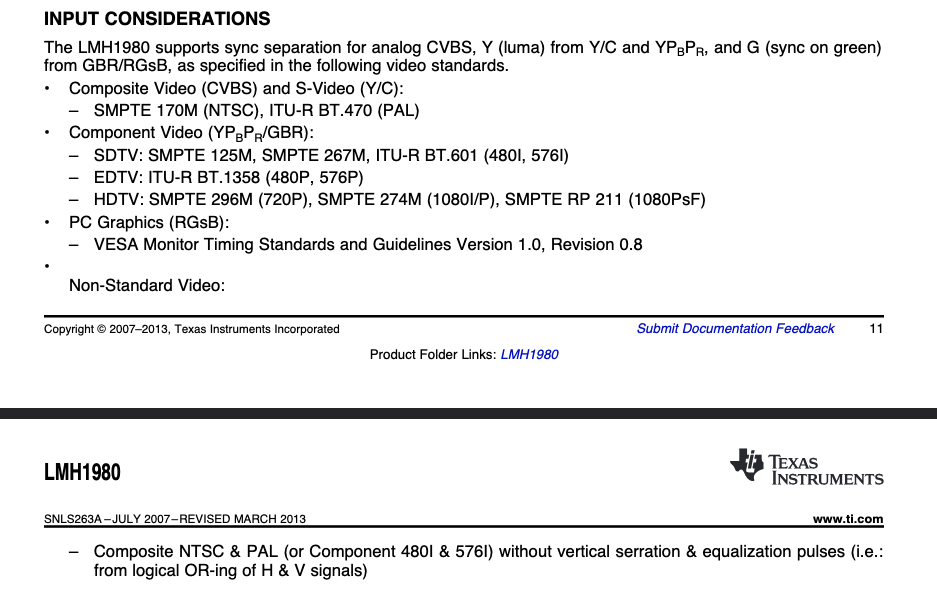

A better hint was finding LMH1980 in both VU003B and VU009 BOM/schematics, but also mentioned in someDIYthreads.
Here’s the part of its datasheet I found most relevant:
So if I put it all together, my guess at what sync signal the LZX Gen3 / new Syntonie modules expect would be:
One channel of a regular Composite / S-Video / Component (the one that carries the sync signal) video signal, as long as LMH1980 handles it

To resume, LZX RCA sync standard follows the ITU/SMPTE specifications for Composite/Component/S-video, so you can find all those specs in those documentations:
BT.1700 : Characteristics of composite video signals for conventional analogue television systems (PAL 576i Composite) https://pub.smpte.org/doc/st170/20041130-pub/st0170-2004_stable2010.pdf (NTSC 480i Composite) BT.601 : Studio encoding parameters of digital television for standard 4:3 and wide screen 16:9 aspect ratios (Component 576i/480i) BT.1358 : Studio parameters of 625 and 525 line progressive television systems (Component 576p/480p) BT.1847 : 1 280 × 720, 16:9 progressively-captured image format for production and international programme exchange in the 50 Hz environment (Component 720p50) BT.1543 : 1 280 × 720, 16:9 progressively-captured image format for production and international programme exchange in the 60 Hz environment (Component 720p60) BT.709 : Parameter values for the HDTV standards for production and international programme exchange (Component 1080p/1080i)
