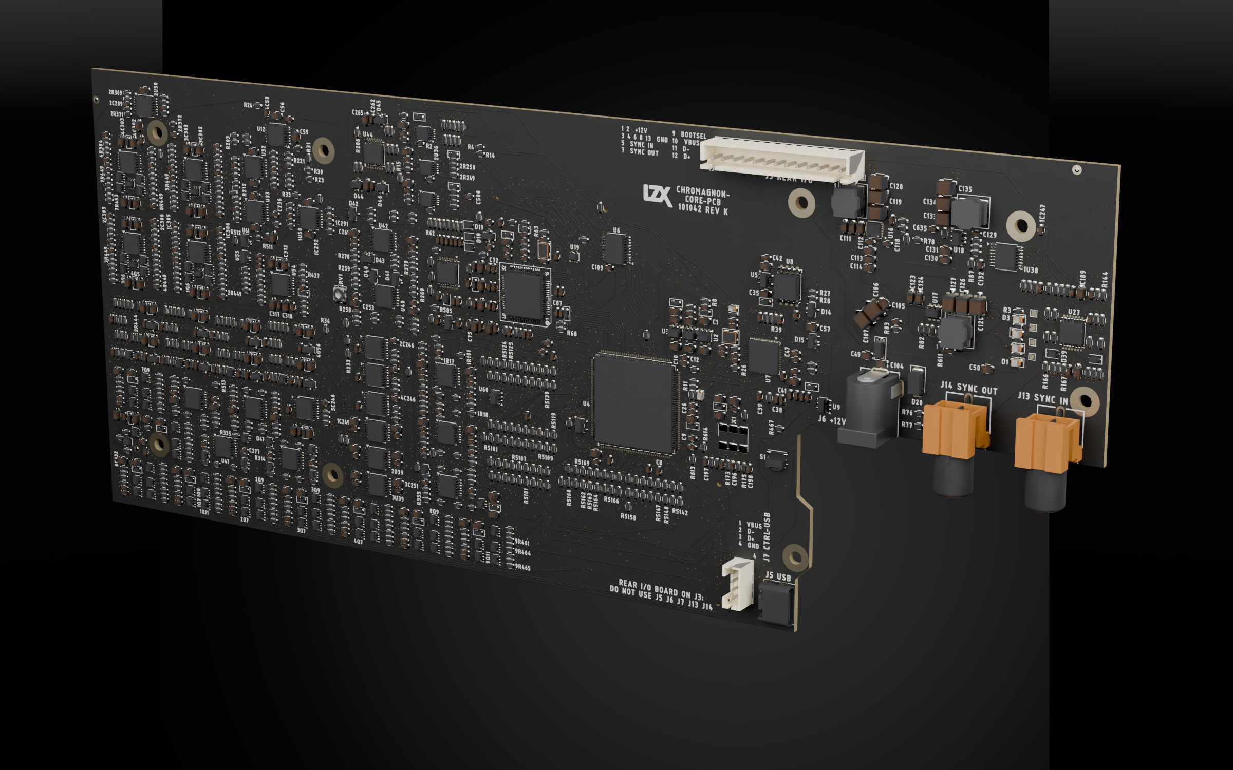

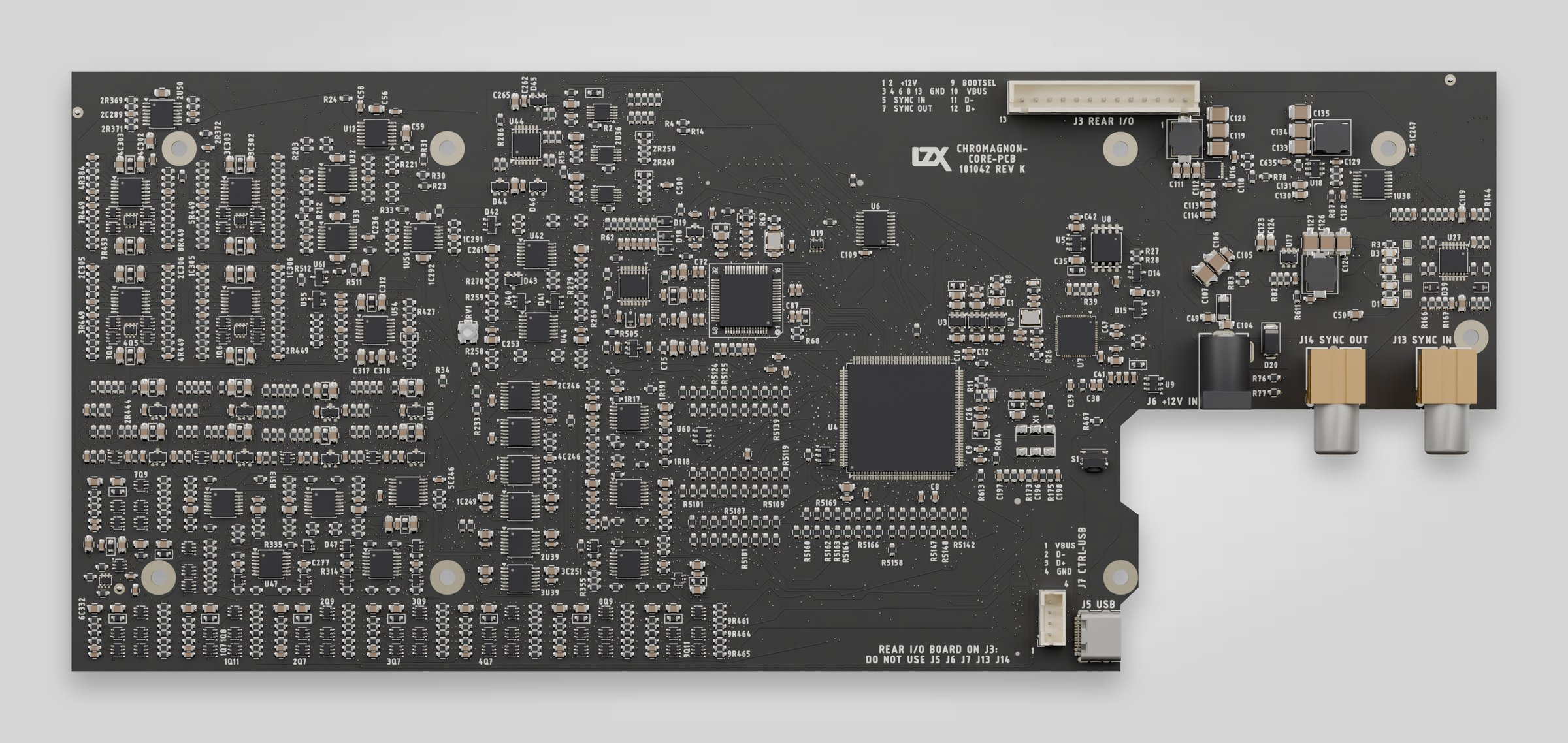

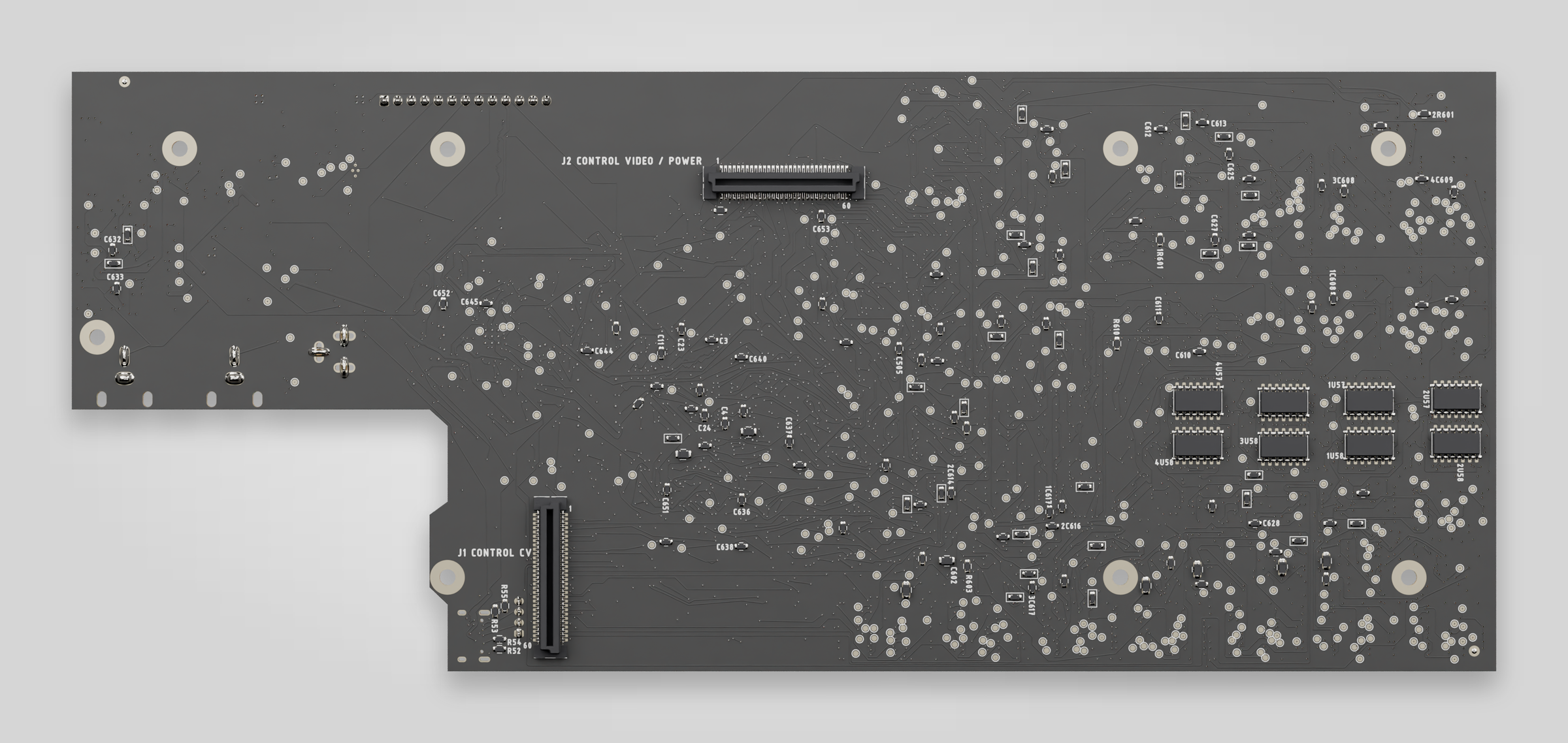

Chromagnon RevK main board The RevK main board. Rendered from the design files.
Chromagnon RevK main board, top side RevK, top side.
Chromagnon RevK main board, bottom side RevK, bottom side.

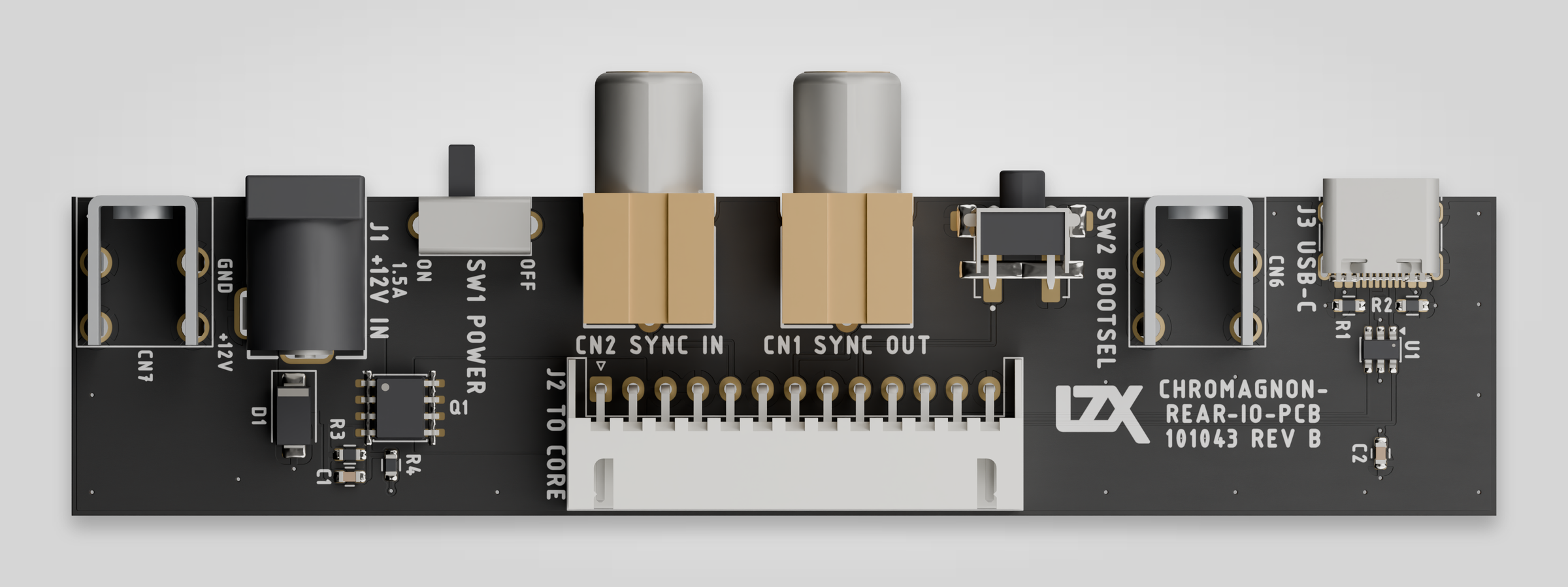

Rear IO board, RevB
The rear IO board carries the connections on the back of the enclosure: 12V power in with the power switch, Sync In and Sync Out, USB-C for firmware updates, and a BOOTSEL button. One 13-pin cable joins it to the main board.
Chromagnon rear IO board RevB, top side Rear IO board, RevB, top side. Rendered from the design files.

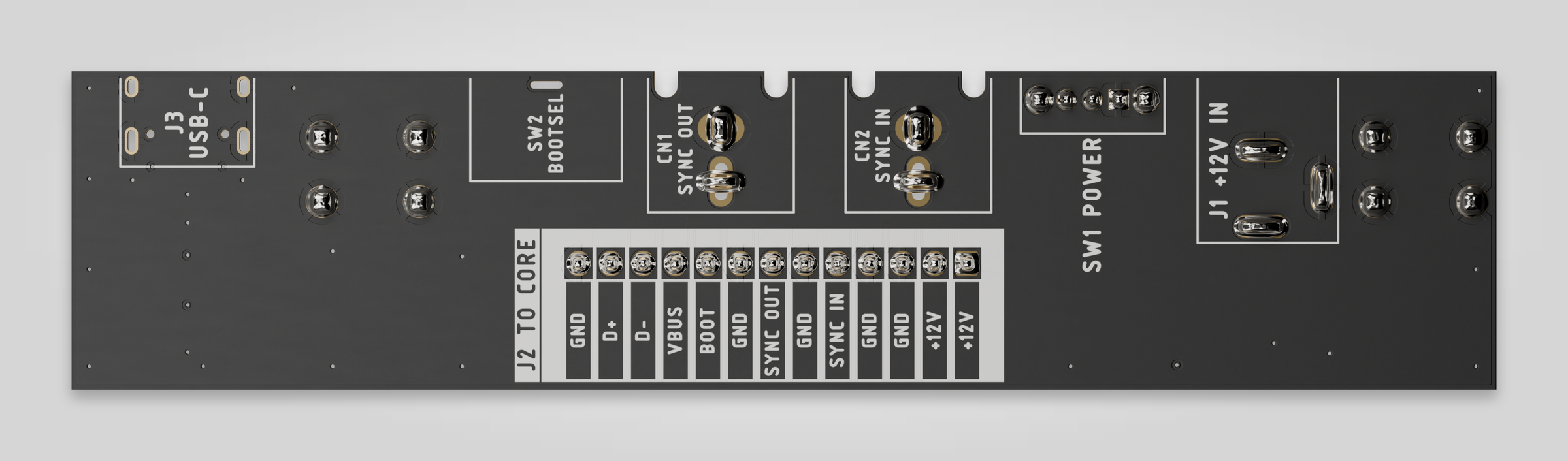

Chromagnon rear IO board RevB, bottom side RevB, bottom side, with the pin legend for the main board cable.

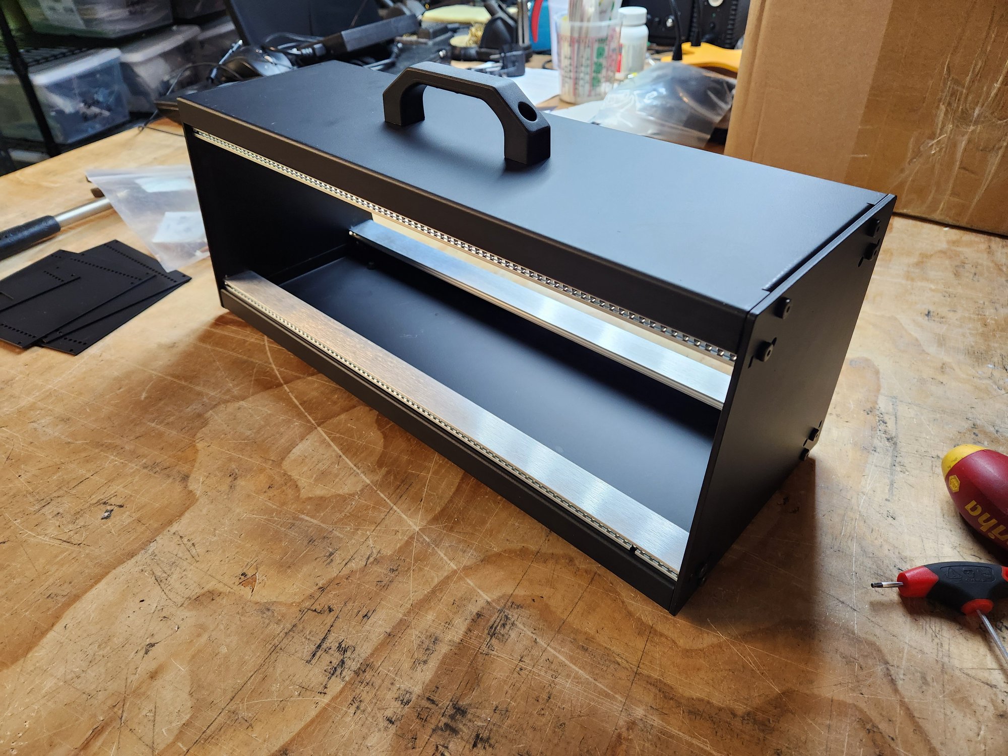

Something else has been taking shape on the bench: a new case design. I'm not ready to say more about it yet, but we'll have some new power infrastructure and cases to make available soon.
A black prototype case with a carry handle on top and an open front showing two rows of mounting rails A new case design, on the bench.
