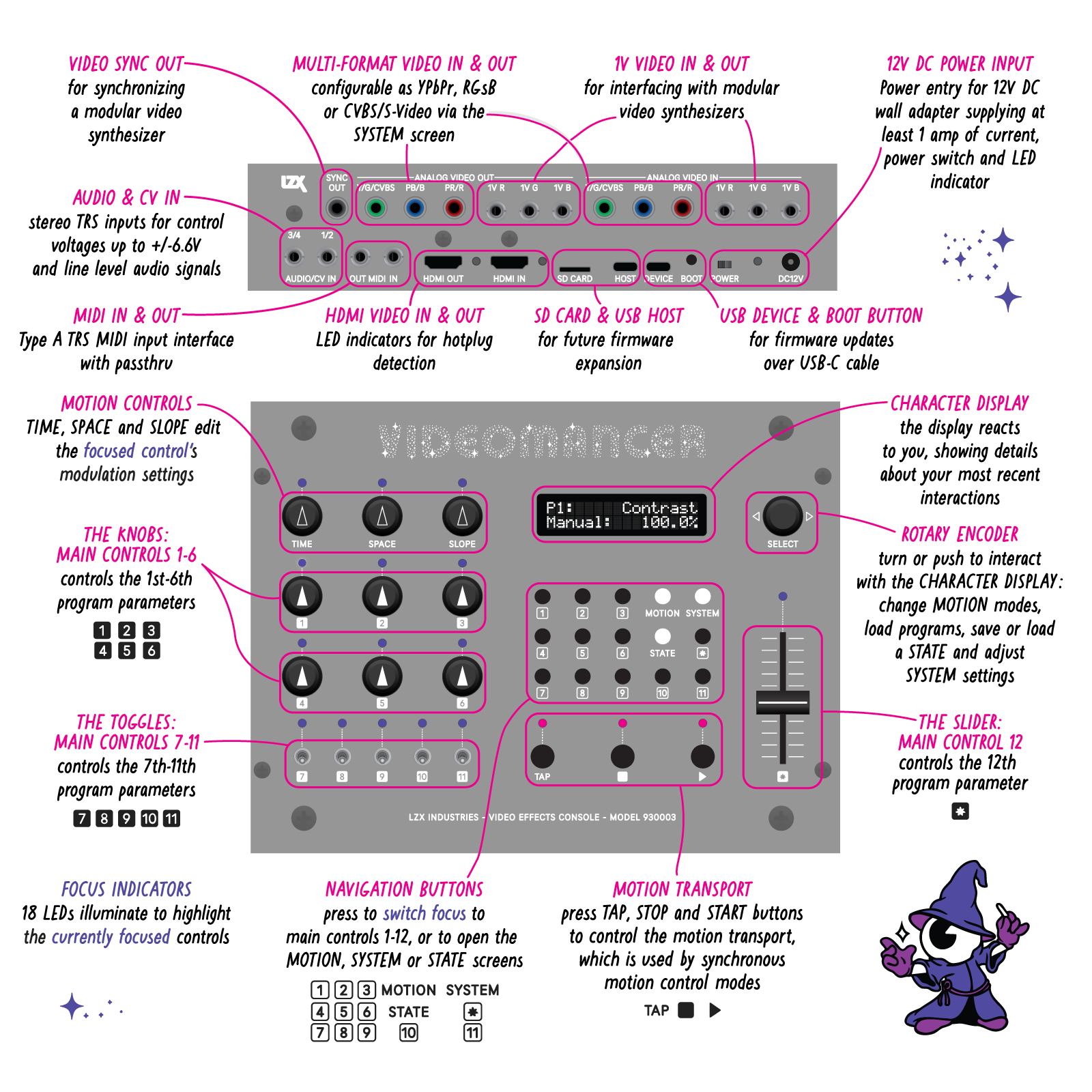

Videomancer front panel
Videomancer rear connections

Connectors, Controls, and Indicators
Videomancer connectors and controls
Connectors
  • HDMI digital video/audio in and out
  • Full-size HDMI jacks
  • Supporting a wide range of digital video formats
  • Output configurable as HDMI YCbCr or DVI RGB
  • Multi-format Analog video in and out
  • Triple RCA jacks configurable as:
  • CVBS composite
  • S-Video (Y/C) component
  • YPbPr component
  • RGB component with sync on green (RGsB / SoG)
  • Video Sync out
  • RCA jack
  • Genlock a modular system or other devices to Videomancer
  • 1v RGB video in and out
  • Triple TS mini-jacks
  • DC-coupled LZX modular standard
  • Audio/CV inputs
  • Four signal inputs on two TRS stereo mini-jacks
  • Configurable as control voltages or line level audio signals
  • MIDI in and out
  • TRS 3.5 mm (1/8”) mini-jacks
  • MIDI standard Type A
  • USB ports
  • Two USB-C jacks
  • Device port (front panel)
  • Connect to a computer for firmware updates and USB MIDI from a DAW
  • Host port (rear panel)
  • Not supported in current firmware — reserved for future use
  • microSD card slot for additional non-volatile storage
  • Additional Programs from LZX and the community
  • Presets for Programs stored on microSD card
  • Planned: library management with LZX Connect desktop application
  • DC Power
  • Barrel jack
  • 2.1 mm diameter center conductor
  • Power supply requirements:
  • 12 Volts, center positive
  • 500 mA
Controls
Front Panel Controls
  • Rotary Encoder
  • Incremental digital data entry
  • Turn to choose an option from the menu
  • Push to execute
  • Define global SYSTEM settings
  • Choose Modulation Operator per Parameter
  • Load and save STATE presets
  • Navigation buttons
  • Press to access a function on the LCD display
  • White buttons: SYSTEM, MOTION, and STATE
  • Black buttons labeled 1 through \* :
  • Press to switch focus to Parameter 1 through Parameter 12
  • Press repeatedly to cycle through the display of:
  • Modulation Operator menu
  • Current Manual value of Parameter Knobs, Switches, and Fader
  • Values of the Modulation properties controlled by the Time, Space, and Slope knobs
  • Modulation control knobs
  • Adjust modulation for the currently focused Parameter
  • Parameter control knobs
  • Manually adjust continuous Parameters 1 through 6
  • Toggle control switches
  • Manually enable / disable binary Parameters 7 though 11
  • Slider Parameter control
  • Manually adjust continuous Parameter 12
  • Transport buttons
  • Start and Stop modulation
  • Tap to set tempo in beats per minute
Rear Chassis Controls
Indicators
Front Panel Indicators
  • LCD screen
  • User feedback for SYSTEM settings and functions, STATE Presets, Modulation modes, Parameter values, and MOTION Timecode / BPM
  • Front panel LED lights
  • Parameter knob, switch, and fader LEDs indicate the currently focused Parameter: 1 through 12
  • Modulation knob LEDs indicate the focused Modulation control: Time, Space, Slope
  • Start and Stop LEDs indicate transport playback status
  • Tap LED flashes during transport playback to indicate tempo
Rear Chassis Indicators
  • Power LED light
  • HDMI input and output LED lights
  • Illuminate when HDMI status is active and locked
