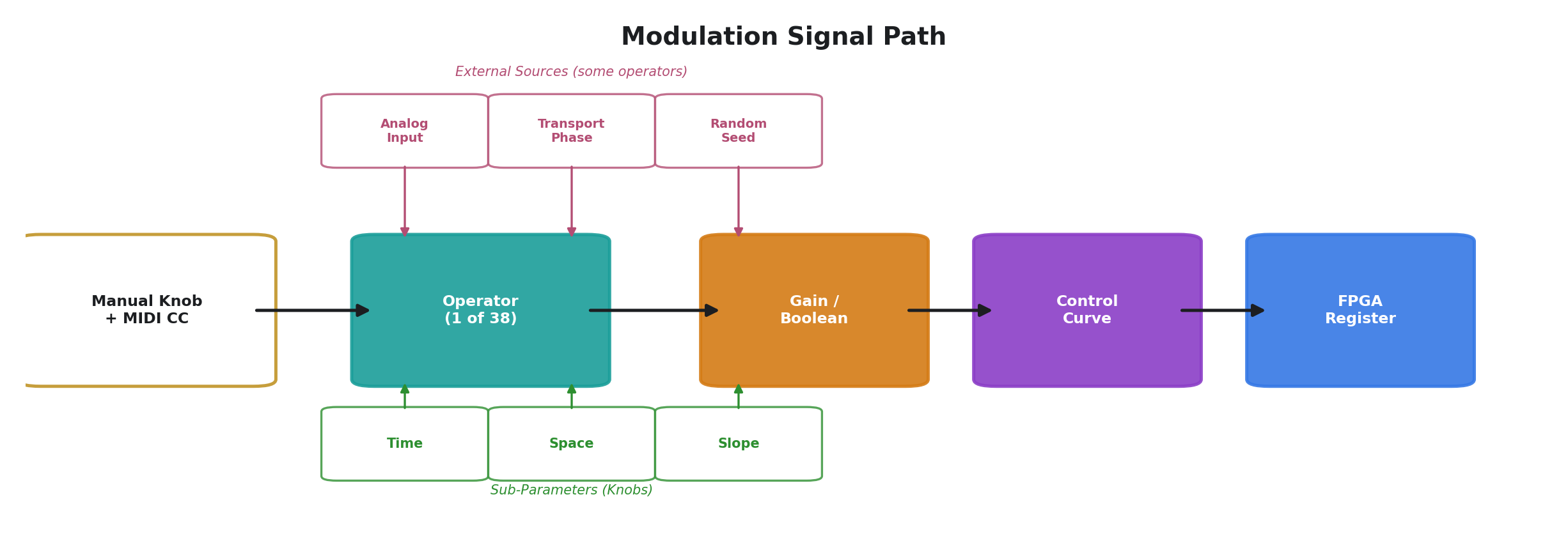

Modulation Signal Path
Each modulator updates once per video field (approximately 50 or 60 times per second depending on the video standard). Four operators that read the rear jacks also produce per-line output on P1–P6 and P12 — a different value for every scanline, built from the samples captured during the last field — so the modulation varies down the frame.
The velocity gate is an optional final stage that applies MIDI note velocity to the output. When a MIDI note-on targeting that modulator is active (note 0 for P1, note 1 for P2, etc.), the note’s velocity value scales the output. In linear mode, velocity is added to the output as an offset. In boolean mode, any active note with non-zero velocity forces the output to maximum (fully on). When no note is active, the velocity gate has no effect.

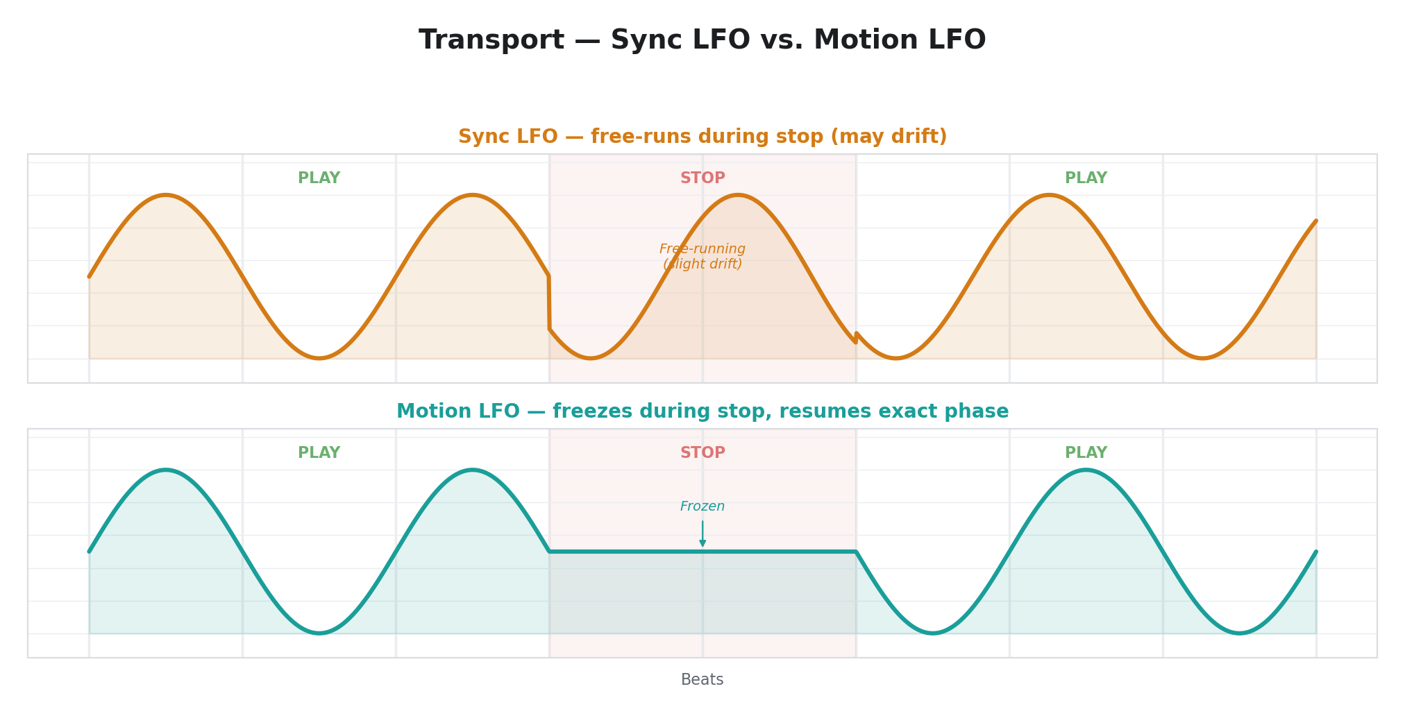

Transport and modulation: The transport starts in the stopped state on power-up. Almost all operators produce modulation regardless of transport state — they free-run at field rate using the video timing clock. The exceptions are Sync LFO and Clock Div, which derive timing from transport tempo/phase and produce manual-only output (no modulation) while stopped or paused. Press Play or send MIDI Start to activate tempo-locked operators.

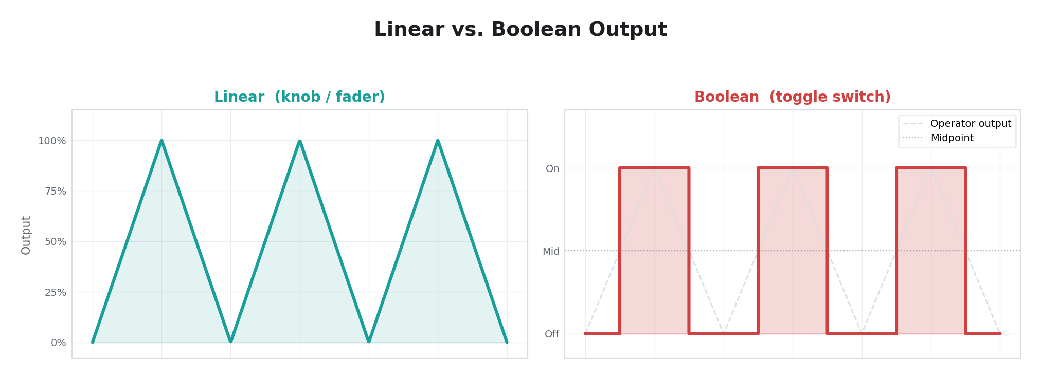

Linear vs. Boolean
Modulators operate in one of two output modes:
  • Linear: Outputs a continuous value across the full range. Used for knobs and faders.
  • Boolean: Outputs 0 or 1. Used for toggle switches. If the combined manual + operator output is at or above the midpoint (512), the toggle is "on." Below the midpoint, it is "off."
Linear vs. Boolean Output

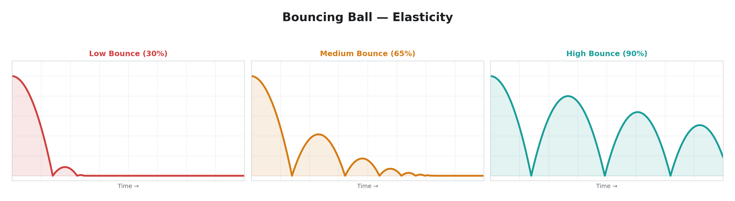

Bouncing Ball
B
Physics
No
Free-run

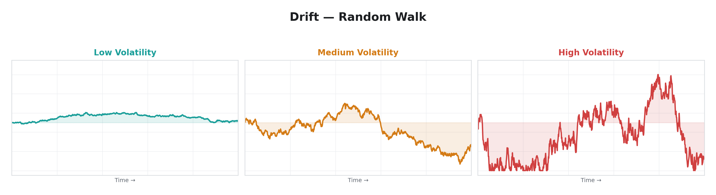

11
Drift
W
Random & Chaos
No
Free-run

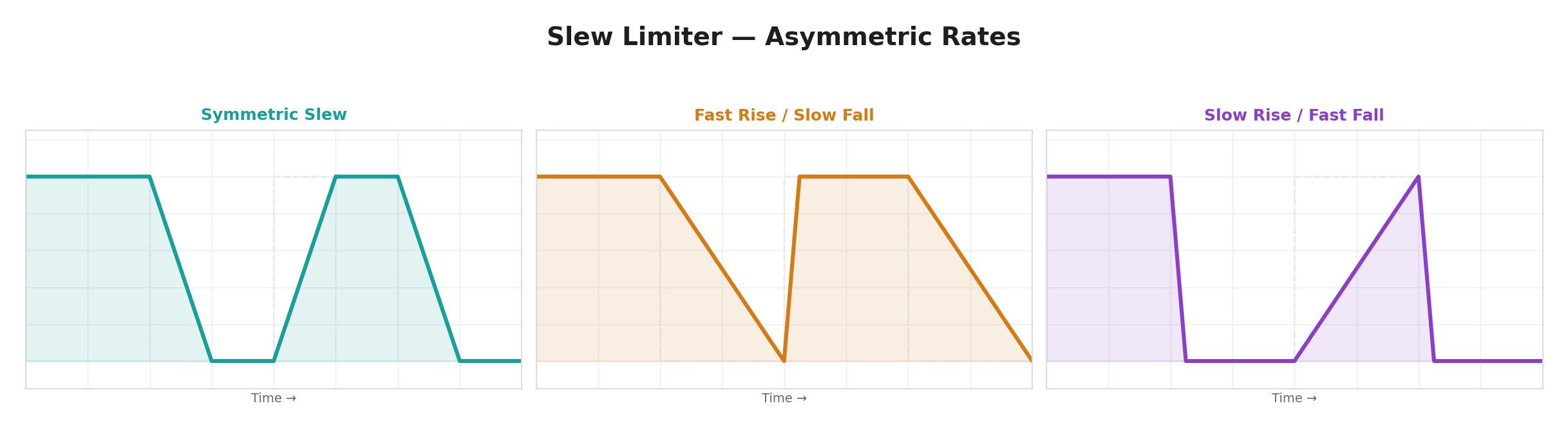

Slew Limiter
External Input
No
Free-run

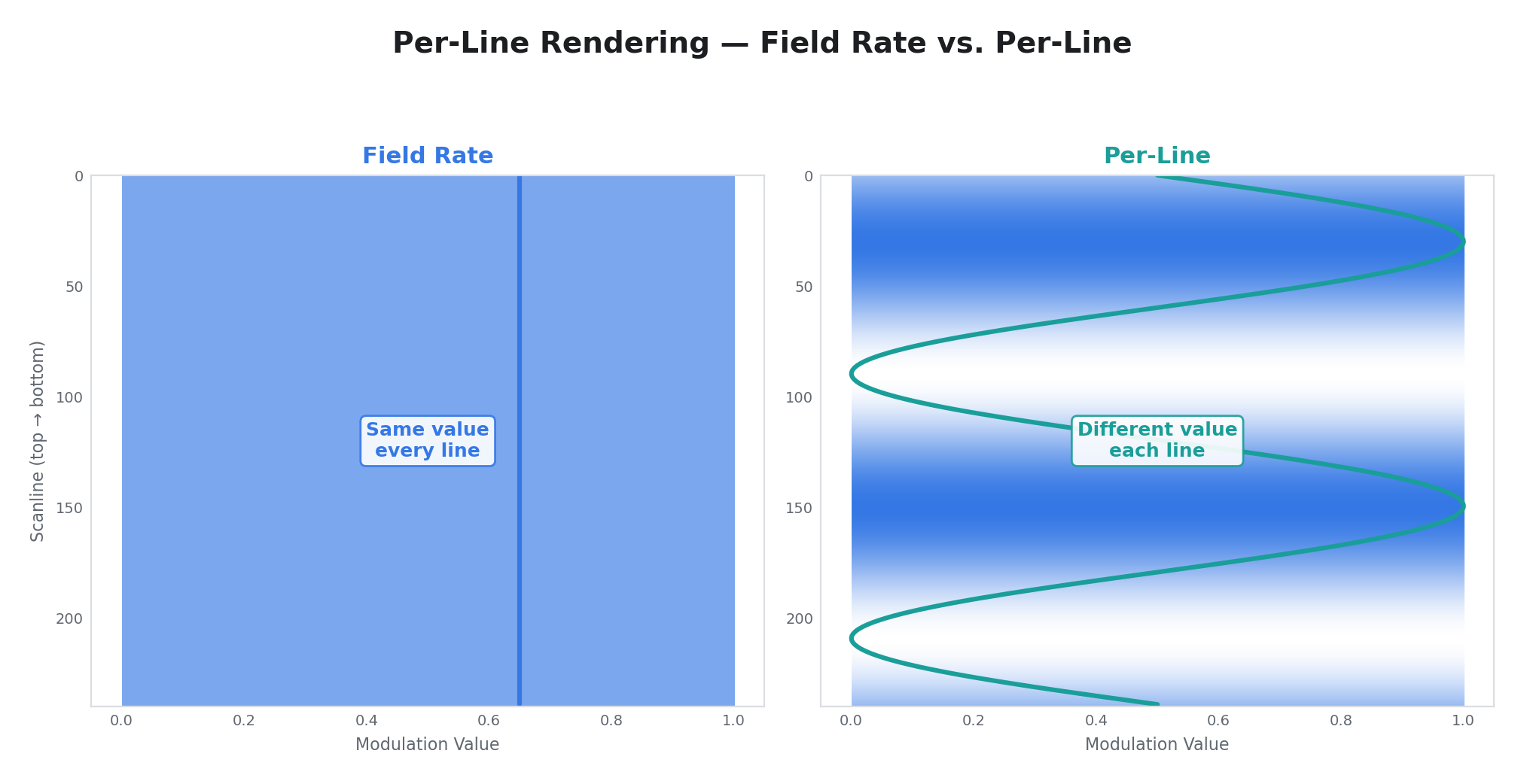

Per-line (Yes*): Comparator, Ring Mod, Peak Hold, and Quantizer deliver per-scanline output on modulator slots P1–P6 and P12 when assigned to those slots. Toggle slots P7–P11 remain field-rate only. CV Input and Audio Input are one value per field on every slot.

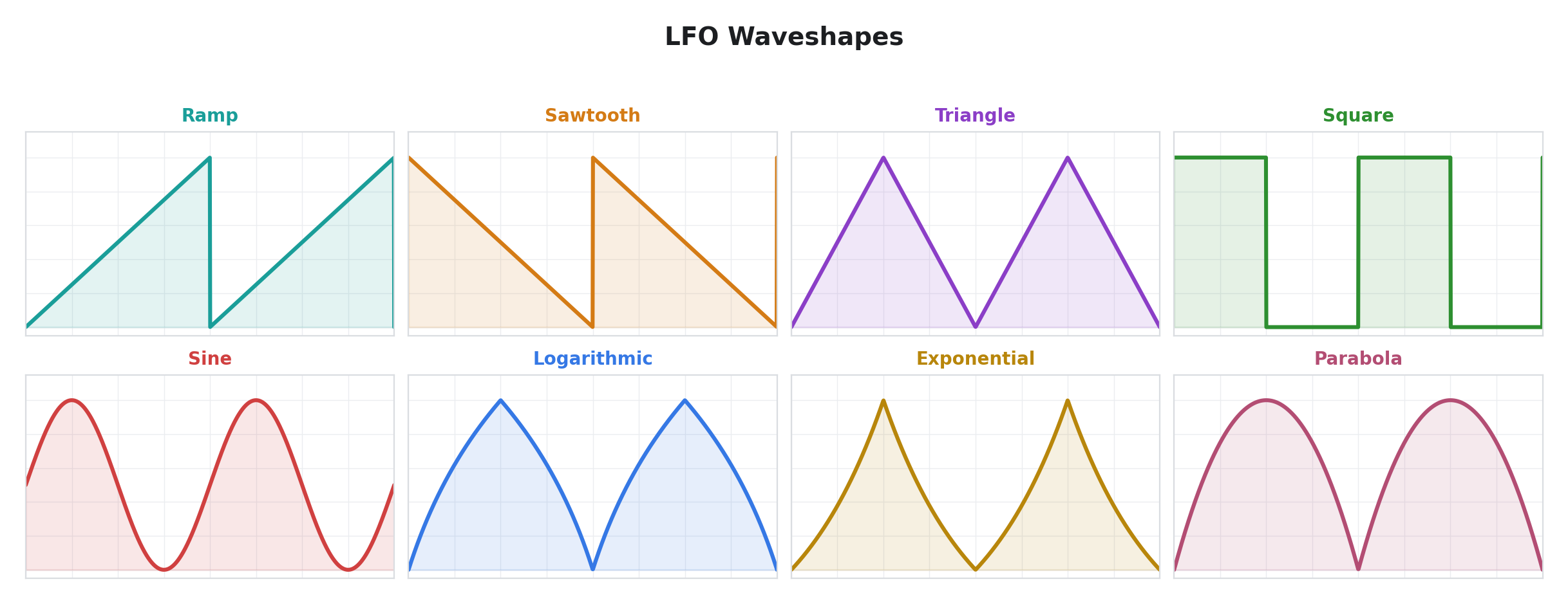

A low-frequency oscillator. This is the most straightforward modulation source — a repeating waveform at a controllable rate. The oscillator is free-running: it advances at field rate regardless of transport state and does not reset phase when transport stops. When you press Play after a stop, phase resets for a fresh start.
The eight waveshapes cover the fundamental periodic functions. Triangle and sine produce smooth, rounded motion. Square produces hard switching between two values (useful for toggling effects on and off rhythmically). Ramp and sawtooth produce asymmetric sweeps — one direction slow, the other instant. Logarithmic and exponential produce curves that spend more time near one extreme than the other. Parabola produces a rounded bounce shape.

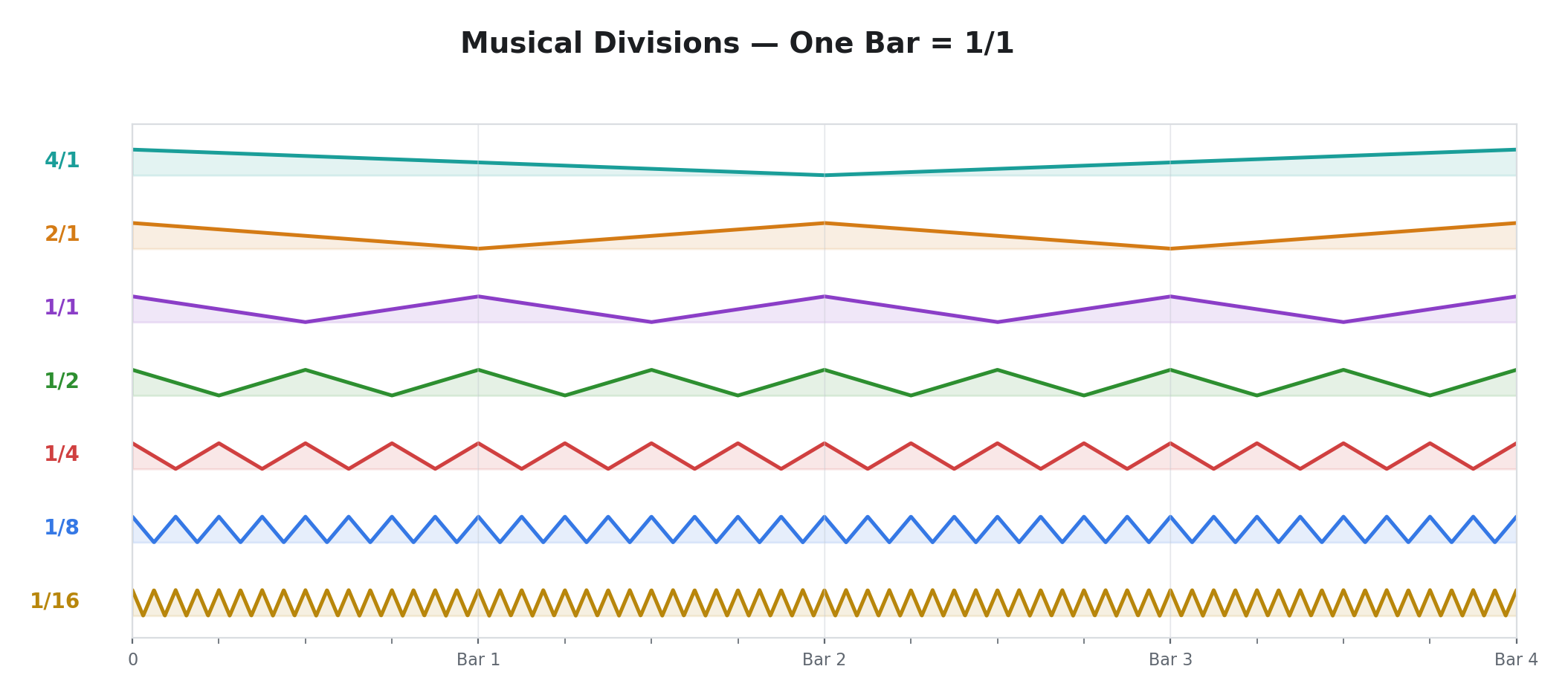

7 — Sync LFO
Parameter Label Function
Time
Division
Musical time division. Sixteen divisions from 32 bars (very slow) down to 1/16 note (fast): 32/1, 16/1, 8/1, 4/1, 3/1, 2/1, 3/2, 1/1, 3/4, 1/2, 3/8, 1/3, 1/4, 1/6, 1/8, 1/16. Dotted and triplet divisions are included.
Space
Depth
Output amplitude.
Slope
Wave
Waveshape select (same eight shapes as Free LFO).
Per-line: No
A transport-locked LFO whose speed is derived from the current BPM. This operator requires transport playback — output is manual-only when stopped and freezes when paused. The waveform stays in rhythmic relationship to the beat when playing.
The musical divisions are multiplicative: at 1/1 division, the oscillator completes one full cycle per bar. At 1/4, it completes four cycles per bar (quarter-note rate). At 4/1, it takes four bars to complete one cycle. Dotted divisions (3/2, 3/4, 3/8) and triplet divisions (1/3, 1/6) provide swing and polyrhythmic relationships.
Musical Divisions

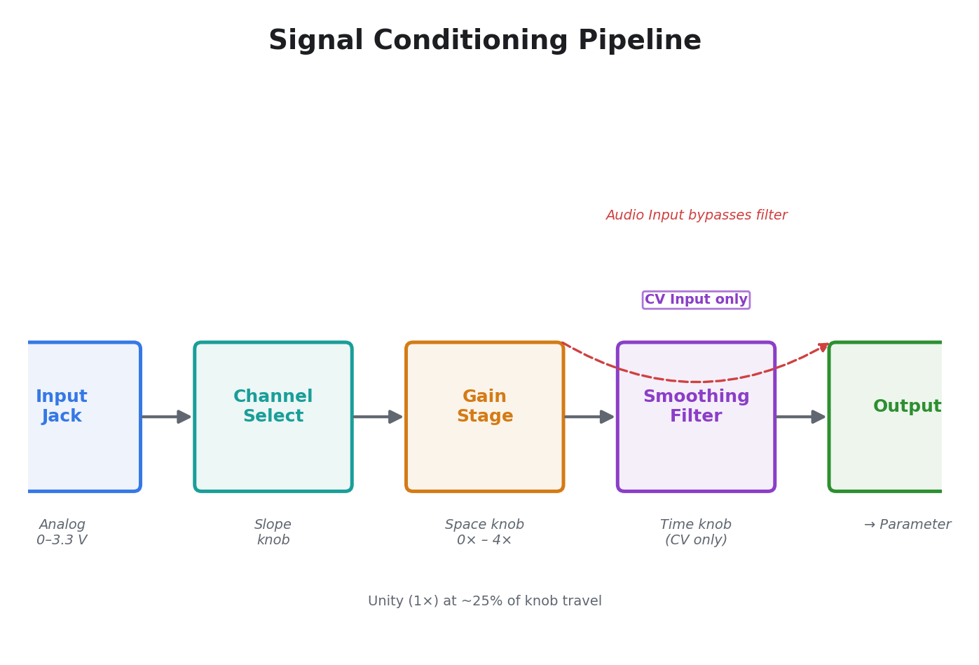

8 — Audio Input
Time
Release
How long the level takes to fall after the audio gets quieter. Off (instant) at fully counter-clockwise, 5 ms to 5 s clockwise. Attack is always instant.
Space
Gain
0.5 V peak reaches the full range at 100%. Hotter signals clip — turn Gain down.
Slope
Channel
Input channel select (six options; see Input Channels).
Per-line: No — one value per field on every slot.
Responds to how loud the audio is, not to its instantaneous voltage. Each field, Videomancer measures the peak level of everything the jack received since the last field (half the peak-to-peak swing, so DC and offset never read as loudness) and subtracts a small noise floor. A louder field raises the output immediately; a quieter one lets it fall at the Release time. Silence adds nothing, so the parameter rests at the Manual knob position.
A consumer line level (−10 dBV, 0.45 V peak) reaches about 85% of the range at Gain 100%. A Eurorack or pro line signal (+4 dBu, 1.7 V peak) needs Gain around 30%.
On Ch1+2 or Ch3+4, the two jacks' levels are averaged, so a stereo pair never cancels out.

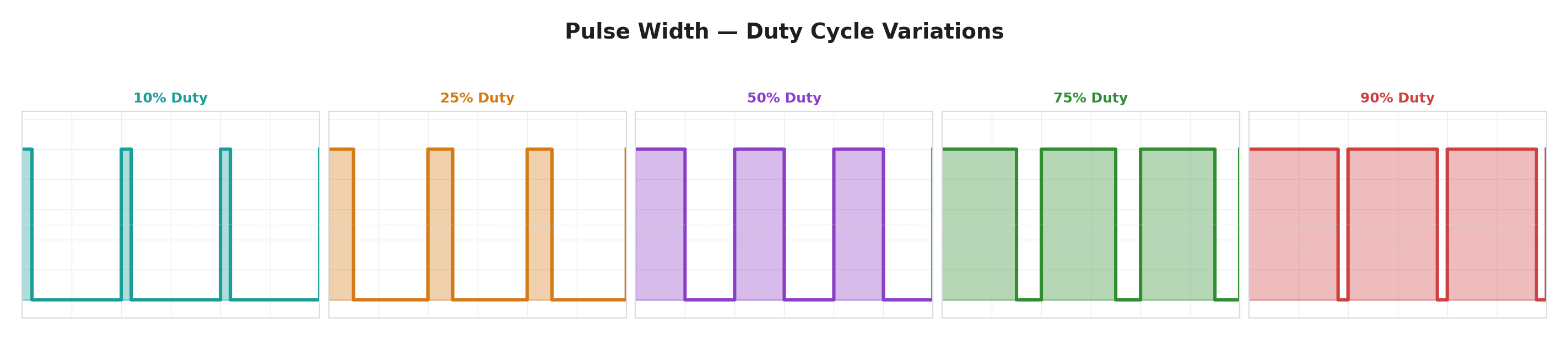

14 — Pulse Width
Time
Rate
Oscillator period (same weighted rate curve as Free LFO, 50 ms–20 s).
Space
Depth
Output amplitude, centered around the midpoint.
Slope
Width
Duty cycle. Fully counter-clockwise = 0% (always low). Center = 50% (symmetric square wave). Fully clockwise = 100% (always high).
Per-line: No
A variable-duty-cycle oscillator. Where a standard square wave spends equal time high and low, Pulse Width lets you skew the ratio. At 50% duty, this produces a standard square wave. As you move toward 0% or 100%, the "on" portion shrinks to a brief pulse or stretches to nearly continuous. The output swings symmetrically above and below the midpoint, with the swing range set by the Depth knob.
Pulse Width is useful for rhythmic gating effects where you want control over how long the "on" portion lasts relative to the cycle — something the square waveshape in Free LFO cannot do.
Pulse Width — Duty Cycle Variations

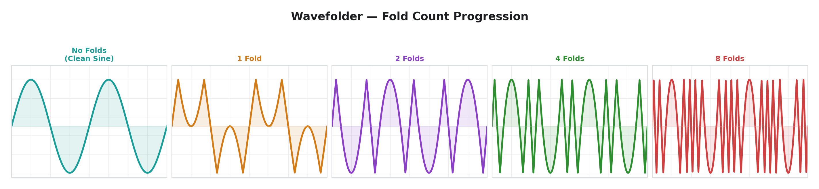

19 — Wavefolder
Time
Rate
Oscillator period (weighted rate curve, 50 ms–20 s).
Space
Folds
Fold count from 1 (minimum fold) to 8 (maximum). Fully counter-clockwise = 1 fold; fully clockwise = 8 folds.
Slope
Symmetry
Fold center offset. Center = symmetric folding. Turning the knob in either direction shifts the fold center, producing asymmetric waveforms.
Per-line: No
An internal sine oscillator whose output is passed through a wavefolder. Wavefolding works by amplifying the signal until it exceeds the normal output range, then reflecting ("folding") the excess back inward — like folding a piece of paper. One fold turns a sine wave into a shape with two peaks per cycle. Two folds produce four peaks. Eight folds produce a dense, complex waveform with sixteen zero-crossings per cycle from a single underlying sine.
The Symmetry control shifts where the fold boundary sits. At center, the folding is symmetric around the midpoint and the waveform is balanced. Offsetting the symmetry makes one half of each fold wider than the other, producing asymmetric harmonics.
Wavefolder is the go-to operator when you want complex, harmonically rich modulation from a single oscillator. At low fold counts, the output retains the smooth character of a sine wave with gentle distortion. At high fold counts, it becomes a dense, textured waveform that sits between periodic and chaotic.
Wavefolder — Fold Count Progression

These operators read external signals — CV (control voltage) or audio — from Videomancer’s analog input jacks. They turn external signals into modulation sources.

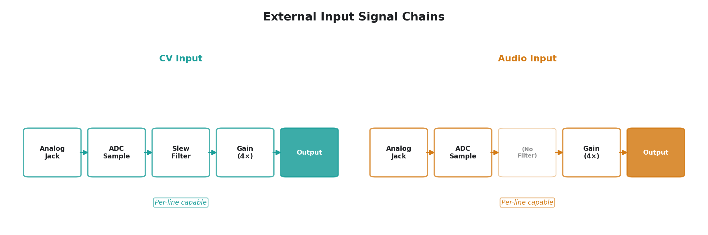

30 — CV Input
Time
Slew
Smoothing time. Off (instant) at fully counter-clockwise, 5 ms to 5 s clockwise.
Space
Gain
1 V at the jack swings the full range at 100%. Larger signals clip.
Slope
Channel
Input channel select. Six options across the knob range (see Input Channels).
Reads a control voltage from one of Videomancer’s analog inputs. CV is bipolar around 0 V: positive voltage moves the parameter up from the Manual knob position, negative voltage moves it down, and 0 V (or nothing patched) adds nothing. At Gain 100%, an LZX-standard 1 V swing covers the whole range. A ±25 mV dead zone around 0 V keeps a small jack offset from moving the parameter; outside it, 1 V still reads as 1 V.
The voltage is sampled at each field boundary (averaged over about 0.4 ms) and smoothed by the Slew knob. A newly selected CV Input starts at the current voltage instead of gliding up from zero. CV Input runs regardless of transport state.

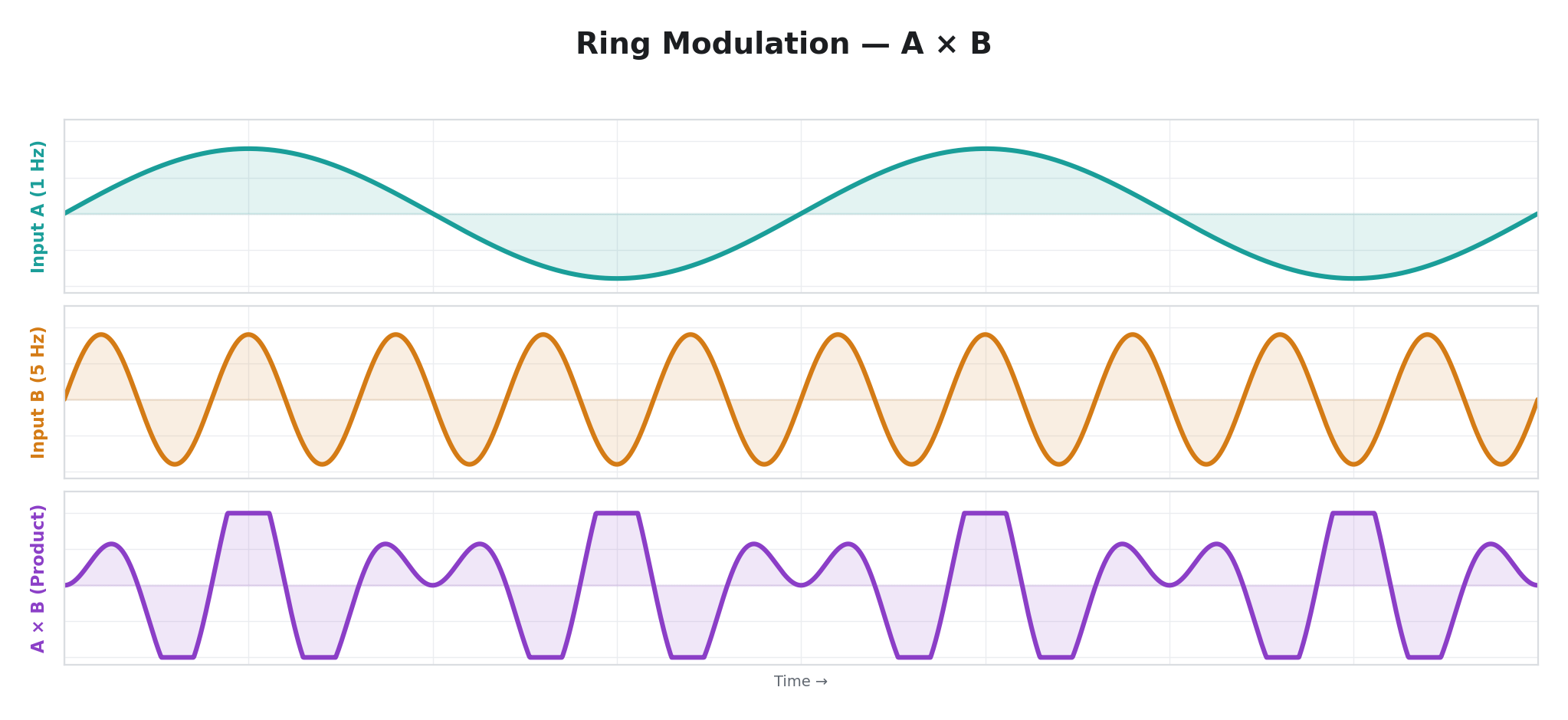

12 — Ring Mod
Time
Slew
Output smoothing. Off (instant) at fully counter-clockwise, 5 ms to 5 s clockwise.
Space
Gain
1 V × 1 V swings the full range at 100%.
Slope
Channel
Channel pair. Lower half of the knob = Ch1 × Ch2. Upper half = Ch3 × Ch4.
Per-line: Yes on P1–P6 and P12.
Multiplies two bipolar input voltages. This is ring modulation — the output follows the interaction of the two inputs, and neither appears on its own. The product is scaled so 1 V × 1 V = 1 V, then added around the Manual knob position: same-sign inputs push the parameter up, opposite-sign inputs push it down, and if either jack is at 0 V (or unpatched) nothing is added.
On per-line slots, each scanline gets the average product over its slice of the field, so two audio-rate signals draw their interference pattern down the frame.
Ring Modulation — A × B

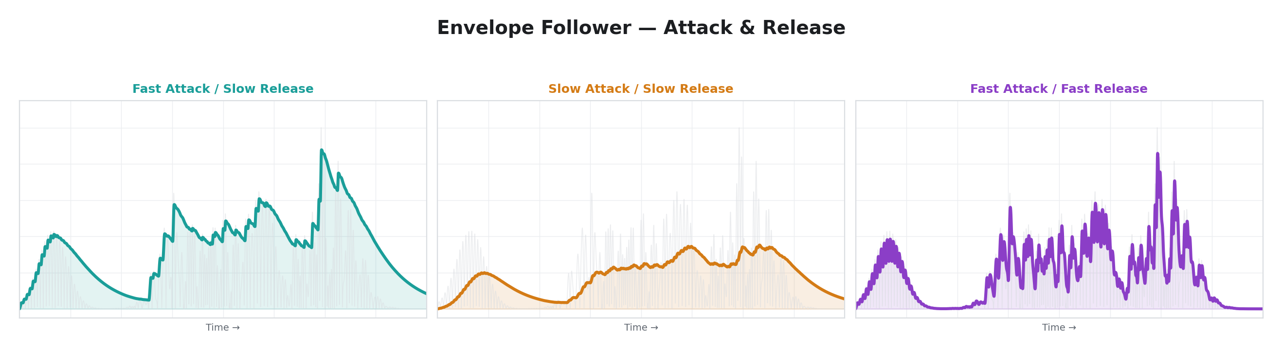

Retired — Envelope
Retired — not in selector. This operator is kept in the guide for historical context only. Current firmware does not offer it; presets that referenced it load as Disabled.
Time
Attack
Attack rate. Fully counter-clockwise = instant (tracks peaks immediately). Fully clockwise = very slow (output rises gradually toward new peaks).
Space
Release
Release rate. Fully counter-clockwise = instant (drops immediately when input falls). Fully clockwise = very slow (output holds peaks and decays gradually).
Slope
Channel
Per-line: No
An envelope follower that tracks the strength of an analog input signal. The input is measured as distance from the midpoint, then processed through a peak detector with independent attack and release rates. When the input exceeds the current output, the output rises at the attack rate. When the input falls below the current output, the output decays at the release rate.
Fast attack and slow release produce a classic "peak hold" envelope that captures transients and releases slowly — ideal for making a parameter respond to the loudness of audio input. Fast attack and fast release produce a signal that closely tracks the input waveform’s amplitude.
Envelope Follower — Attack & Release

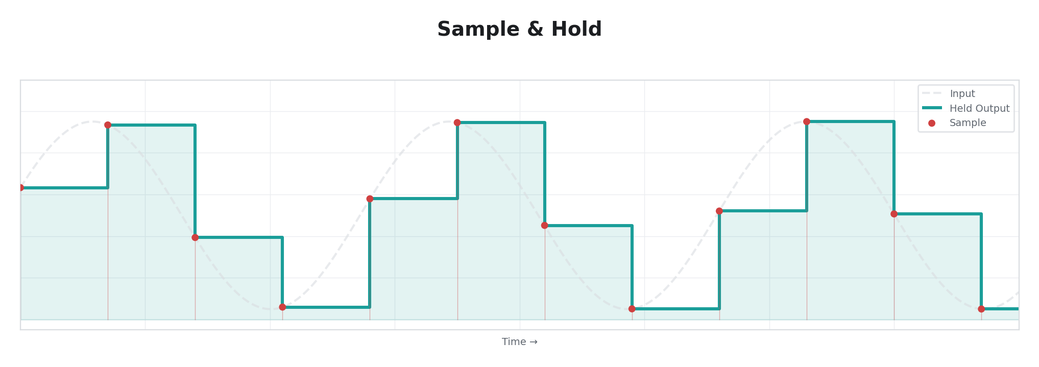

Retired — Sample & Hold
Time
Rate
Clock period (50 ms–20 s).
Space
Gain
Output amplitude.
Slope
Channel
Per-line: No
A classic sample-and-hold circuit. An internal clock runs freely at the rate set by Time. On each clock tick, a new sample is captured from the selected input channel, and that value is held constant until the next tick. The result is a staircase waveform — a series of flat plateaus at random-seeming levels determined by whatever the input signal happened to be at each sample moment.
Sample & Hold is one of the fundamental building blocks of analog synthesizer modulation. It turns a continuous signal into discrete steps, creating unpredictable but input-correlated patterns.
Sample & Hold

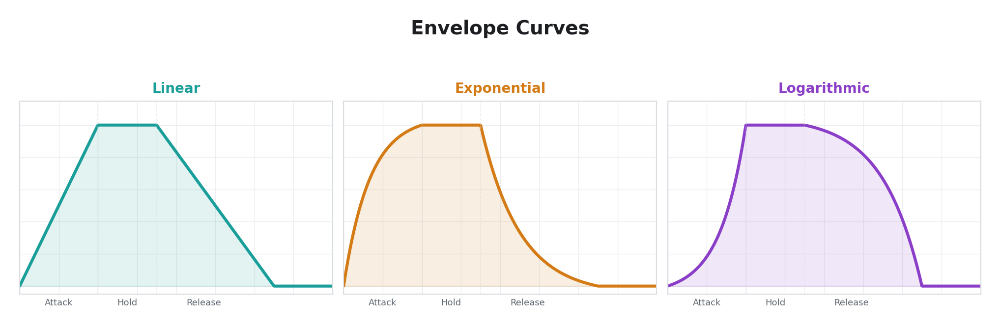

Retired — Trigger Env
Time
Attack
Attack rate. Fully counter-clockwise = instant. Fully clockwise = very slow.
Space
Release
Release rate. Fully counter-clockwise = instant. Fully clockwise = very slow.
Slope
Curve
Envelope shape. Three curves across the knob range: linear, exponential, and logarithmic.
Per-line: No
A MIDI-triggered attack/release envelope. When a MIDI note-on message arrives, the output ramps from zero to maximum at the attack rate. When a note-off arrives, it ramps back to zero at the release rate. Three curve shapes control the contour of the ramp: linear (constant rate), exponential (starts fast, decelerates), and logarithmic (starts slow, accelerates).
This is the operator to use when you want a parameter to respond to MIDI keyboard or sequencer events — press a key and the parameter sweeps up, release it and it sweeps back down.
Envelope Curves

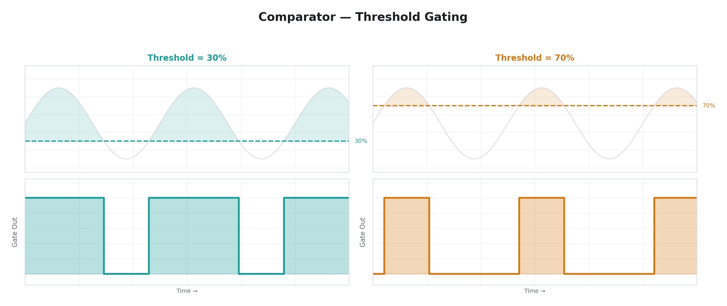

9 — Comparator
Time
Thresh
Comparison threshold, shown as 0.00 V (fully counter-clockwise) to 1.00 V (fully clockwise).

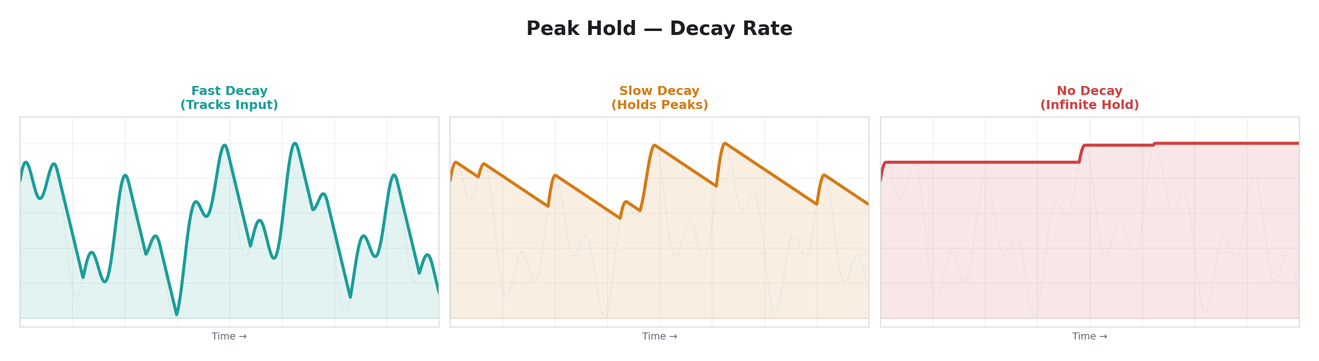

15 — Peak Hold
Time
Decay
Decay time. Off (output follows the input) at fully counter-clockwise, 5 ms to 5 s clockwise, and Hold (peaks never decay) at fully clockwise.
Space
Gain
Slope
Channel
A peak detector for 0–1 V signals (negative voltage counts as 0 V). At field rate it takes the highest voltage the jack reached during the whole field, so short pulses between fields are never missed. New peaks are captured instantly; between peaks, the output decays toward the input at the Decay time. At Hold, peaks are kept indefinitely, creating a ratchet that can only go up until you change the knob or the source.
On per-line slots, each scanline takes the highest voltage in its slice of the field, and decay runs from line to line and carries into the next field, so a single pulse leaves a trail that fades down the frame.
Peak Hold — Decay Rates

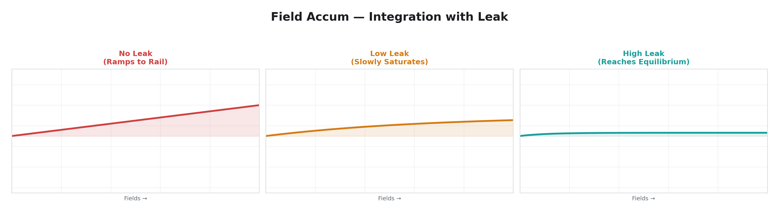

Leak
Leak / drain only (not channel select). Fully counter-clockwise = no leak (pure integrator). Clockwise drains toward 0 V faster, from 5 s down to 5 ms. Input is always Input 1.
Per-line: No
Field Accum operates as an integrator: it adds the bipolar CV on Input 1 to a running total every field. The total climbs while the input is positive and falls while it is negative, and stops at ±1 V. 0 V (or nothing patched) adds nothing. The Leak parameter drains the total back toward 0 V, preventing it from railing at the extremes.
With no leak and a steady input, Field Accum ramps steadily in one direction until it hits the rail — useful for generating slow ramps locked to an input signal. With moderate leak, it produces a smoothed, sluggishly-responding version of the input. With high leak, the output tracks the input loosely, acting as a weighted running average.
Field Accumulator — Leak Settings

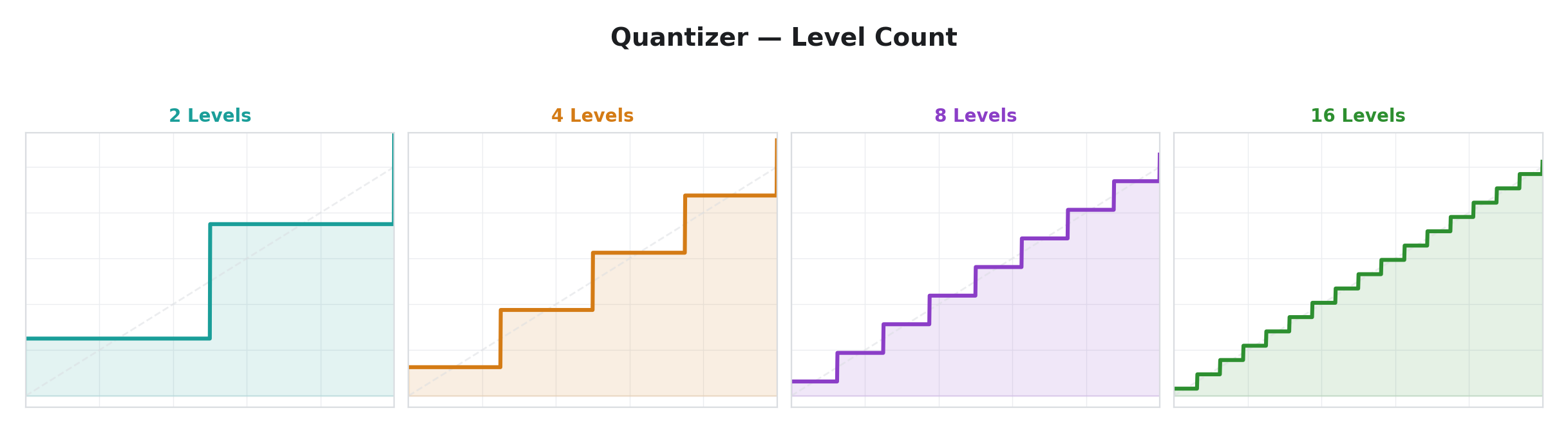

22 — Quantizer
Time
Levels
Number of quantization levels (2 at minimum, 32 at maximum).
Space
Gain
Height of the top step; 1 V reaches the top at 100%.
Slope
Channel
Snaps a 0–1 V input to one of N evenly-spaced levels, producing a staircase output. The input range is divided into N equal bins; the lowest level is 0 (nothing added) and the highest is the full Gain. Negative voltage counts as 0 V, so an unpatched jack leaves the parameter at Manual.
At 2 levels, the output is binary — effectively a comparator at 0.5 V. At 32 levels, the output is a fine staircase that closely tracks the input but with visible quantization steps. The creative sweet spot is often between 4 and 12 levels, where the staircase structure is clearly visible in the modulated parameter.
On per-line slots, each scanline quantizes the average voltage over its slice of the field, so a smooth ramp in the input becomes a series of discrete horizontal bands.
Quantizer — Level Count

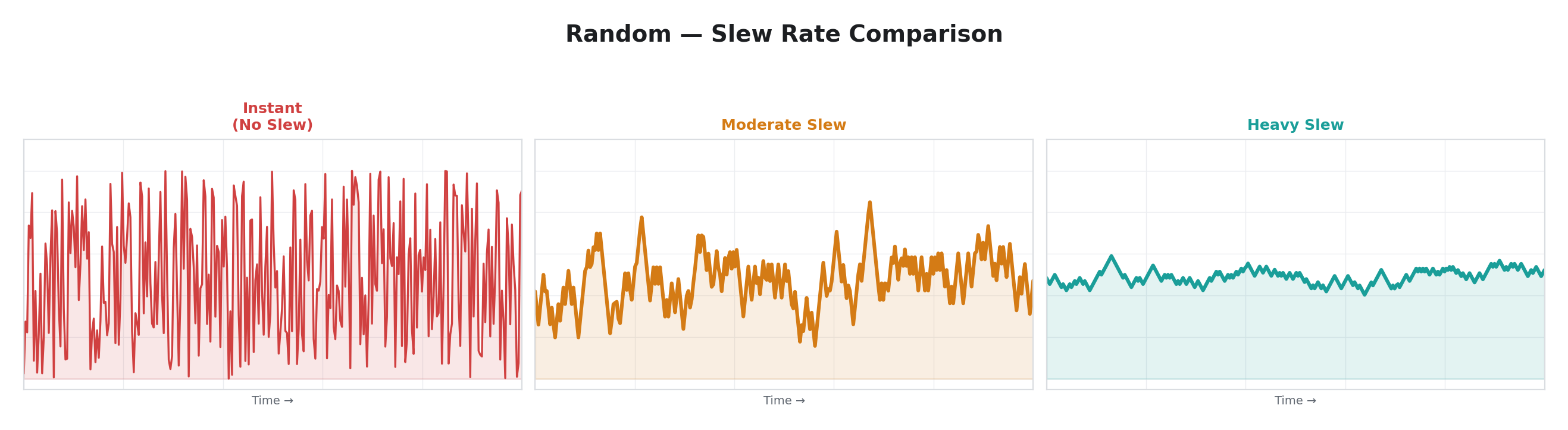

2 — Random
Time
Rise
Rise slew rate. Fully counter-clockwise = instant. Fully clockwise = very slow.
Space
Gain
Output amplitude.
Slope
Fall
Fall slew rate. Fully counter-clockwise = instant. Fully clockwise = very slow.
Per-line: No
Generates a new random target value every video field and slews toward it. The slew has independent rise and fall rates — the output moves toward new targets that are above it at the rise rate, and toward targets below it at the fall rate.
With both slew rates at zero (instant), the output jumps to a new random value every field — pure sample-and-hold noise at the field rate. With moderate slew, the output wanders smoothly between random targets. With high slew, the output becomes a slow, lazy random drift.
Random — Slew Rate Effect
11 — Drift
Time
Rate
Step size / volatility. Fully counter-clockwise = static (no movement). Fully clockwise = large random steps.
Space
Gain
Output amplitude.
Slope
Range
Centering pull. Fully counter-clockwise = free walk (no centering). Fully clockwise = tight centering (output stays near middle).
Per-line: No
Brownian random walk. Each frame, a small random step is added to the current position. A configurable centering force gently pulls the value back toward the midpoint, preventing it from permanently drifting to one extreme.
Drift produces motion that feels organic and aimless — like a leaf blowing in the wind. Unlike Random (which jumps to brand-new targets), Drift moves by small increments from wherever it currently is, so the output is always locally smooth even though its long-term trajectory is unpredictable. The centering force determines whether the walk is bounded (with centering) or truly free-roaming (without).
Drift — Random Walk

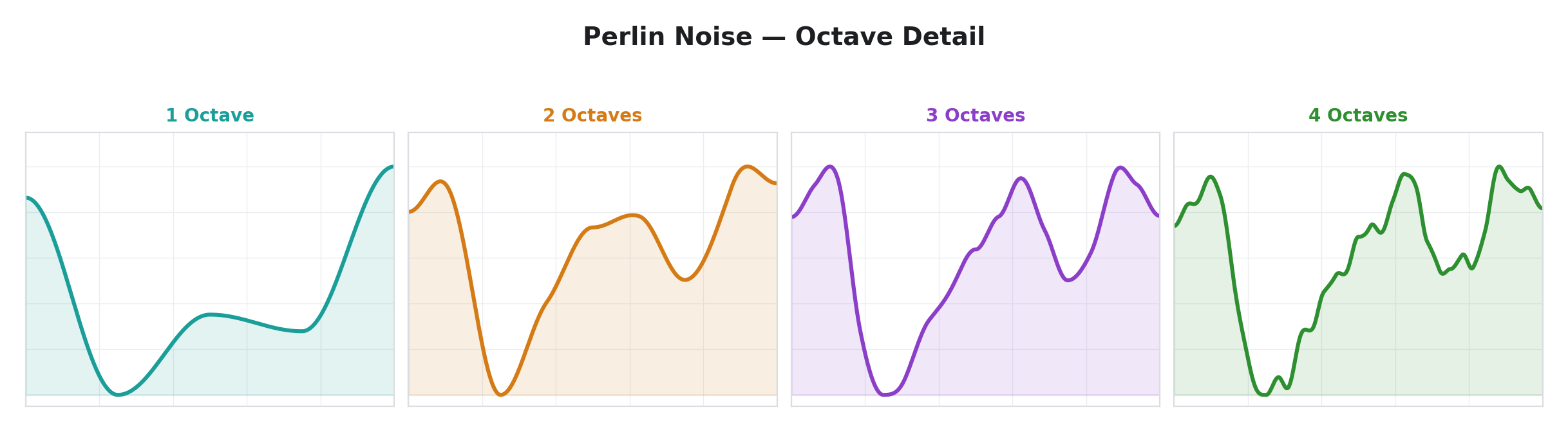

18 — Perlin Noise
Time
Speed
Evolution rate. Fully counter-clockwise = slow, gradual drift. Fully clockwise = fast, rapidly changing texture.
Space
Gain
Output amplitude.
Slope
Detail
Octave count. Fully counter-clockwise = 1 octave (smooth, gentle undulation). Fully clockwise = 4 octaves (rough, detailed texture).
Per-line: No
Smooth, coherent noise inspired by Perlin noise. Unlike Random (which jumps between uncorrelated values) or Drift (which wanders by small steps), Perlin Noise interpolates smoothly between random lattice points, producing motion that is continuous and has no visible "steps" or "jumps."
The Detail parameter adds octave layering — additional noise at higher frequencies is summed with the base noise, creating progressively more complex texture. At one octave, the output is a gentle, wide undulation. At four octaves, it has both slow macro-movement and fast micro-variation, much like natural phenomena such as clouds, terrain, or water surfaces.
Perlin Noise — Octave Detail

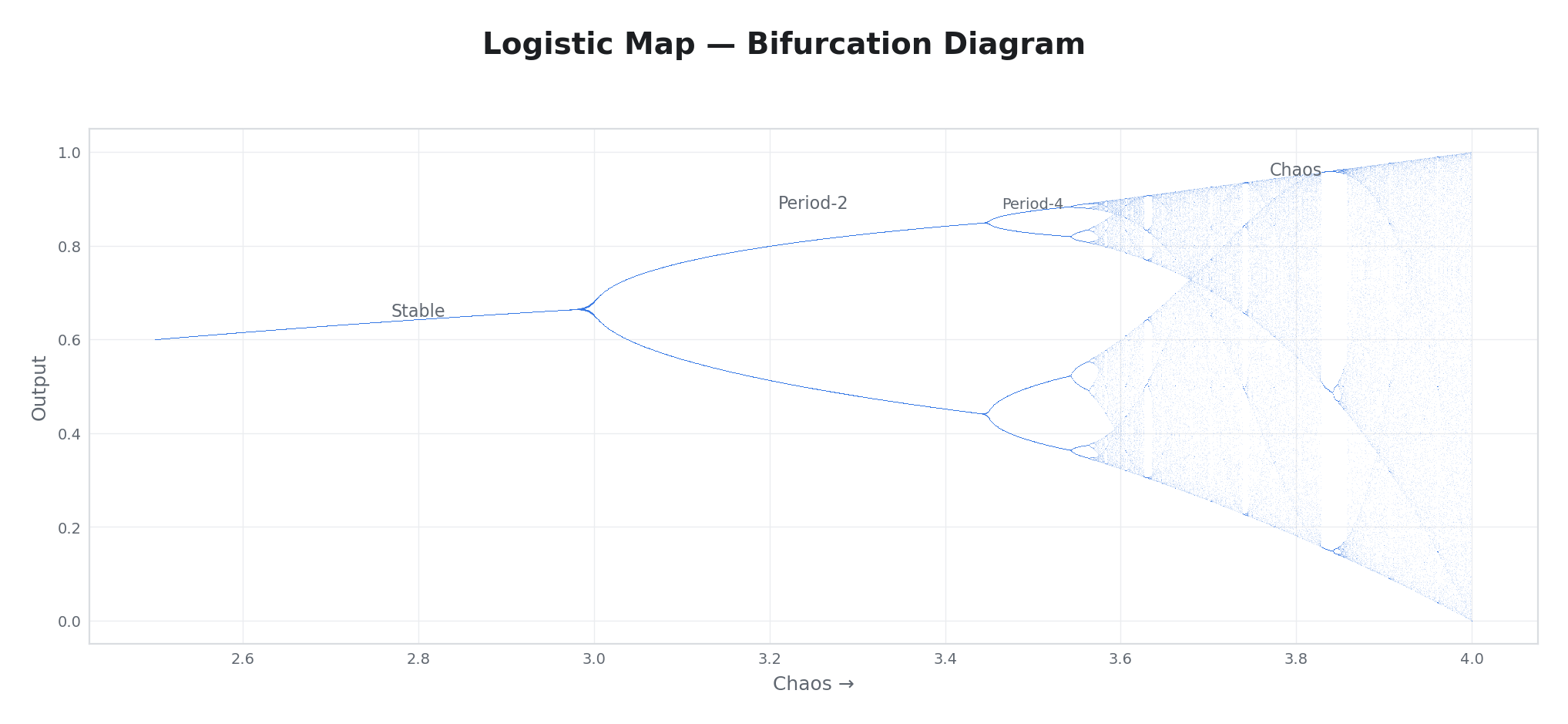

5 — Logistic Map
Time
Rate
Iteration clock (50 ms–20 s).
Space
Gain
Output amplitude.
Slope
Chaos
Controls the balance between order and randomness. Fully counter-clockwise = stable, repeating value. Center = oscillation between a few values. Fully clockwise = full chaos (output never repeats).
Per-line: No
Iterates a simple mathematical equation that produces genuinely chaotic behavior. The Chaos parameter controls whether the system converges to a stable value, oscillates between a few values, or becomes fully unpredictable.
Sweeping Chaos from low to high reveals a characteristic progression: at the low end, the output settles to a single steady value. As you turn the knob further, it begins alternating between two values, then four, then eight. Eventually, the output becomes chaotic — it never repeats, yet it is entirely determined by the equation. At maximum Chaos, the output looks random but follows an underlying mathematical structure.
Logistic Map — Bifurcation Diagram

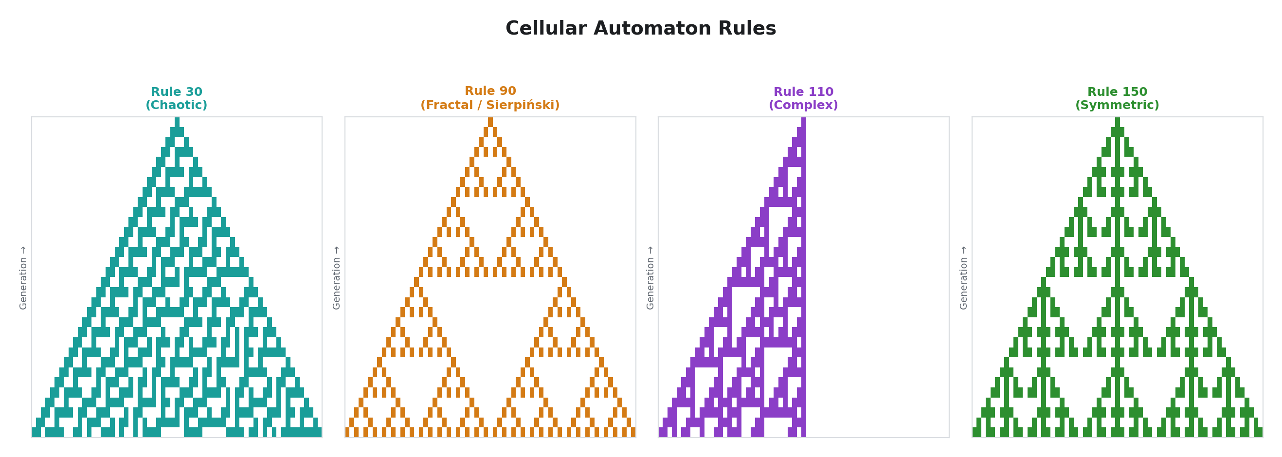

A one-dimensional cellular automaton. Each generation, every cell’s next state is determined by its current state and the states of its two neighbors, according to the selected rule. The output reflects the state of the automaton, scaled to the full modulation range.
These simple rules produce remarkably complex behavior. Rule 30 produces seemingly random output from ordered starting conditions. Rule 90 produces self-similar fractal patterns (the Sierpinski triangle). Rule 110 produces complex patterns with both structured and unpredictable regions. Rule 150 produces complex symmetric structures.
The automaton re-seeds when you change rules (only the center cell starts active), so switching rules initiates a fresh evolution from a known starting condition.
Cellular Automaton Rules

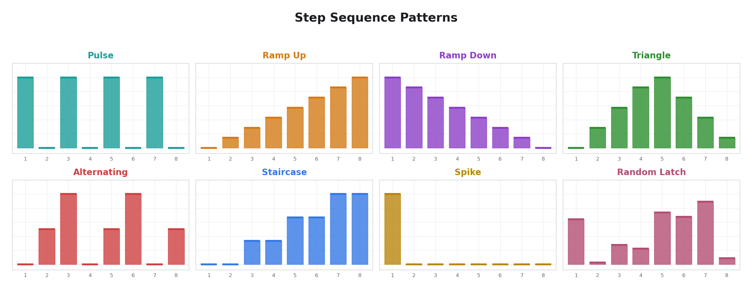

Pattern
Pattern select. Eight preset patterns across the knob: pulse, ramp up, ramp down, triangle, alternating, staircase, spike, and random-latch.
Per-line: No
An 8-step sequencer driven by an internal clock. Each clock tick advances to the next step. Each pattern defines eight fixed output levels that the sequencer cycles through.
The patterns cover common modulation shapes: Pulse alternates between high and low on every step (a regular pulse train at half the sequence rate). Ramp Up and Ramp Down produce ascending and descending staircases. Triangle goes up and back down. Alternating cycles through three levels (low, mid, high) in a shifting pattern. Staircase has four levels, each held for two steps. Spike is a single-step impulse. Random-Latch latches a new random value at each step, producing an 8-step random sequence that changes every cycle.
Step Sequence Patterns

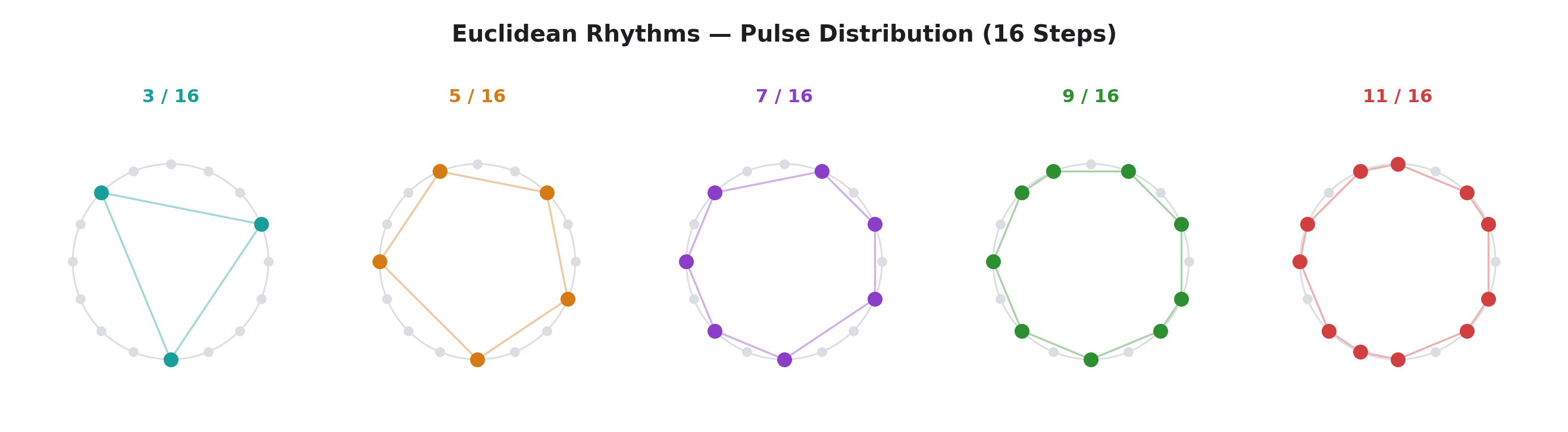

6 — Euclidean Rhythm
Time
Rate
Space
Gain
Output amplitude.
Slope
Density
Pulse count. Fully counter-clockwise = 0 pulses (silent). Fully clockwise = 16 pulses (all steps active).
Per-line: No
Generates Euclidean rhythms — patterns where a given number of pulses are distributed as evenly as possible across 16 steps. The algorithm is equivalent to Bjorklund’s, the same method that produces many traditional world music rhythms (such as the Cuban tresillo and West African bell patterns) at various step counts.
The output is binary per step (high or low), making this operator ideal for boolean modulation of toggle switches. In linear mode, the output alternates between zero and full scale in the Euclidean pattern.
Euclidean Rhythms — Pulse Distribution

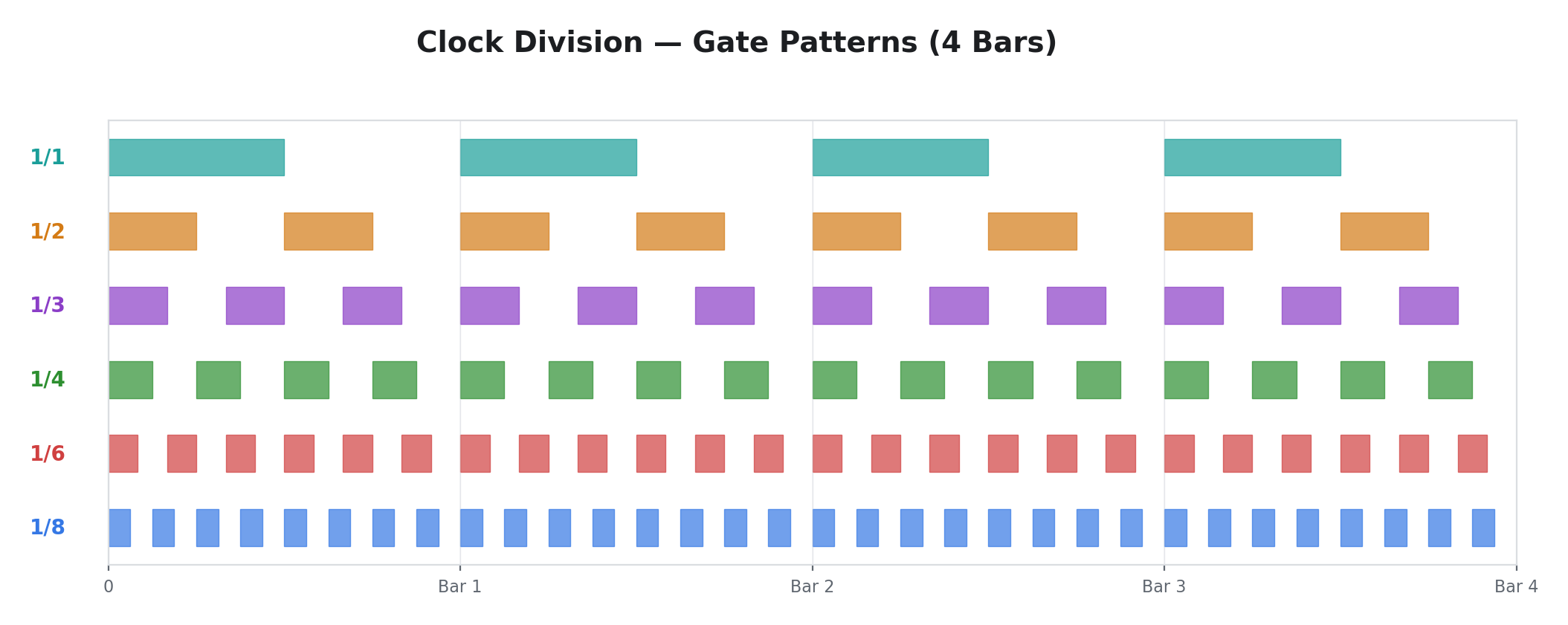

20 — Clock Div
Time
Division
Division ratio. Fully counter-clockwise = ÷1 (follows transport directly). Fully clockwise = ÷16.
Space
Gain
Output amplitude.
Slope
Duty
Gate duty cycle. Fully counter-clockwise = shortest possible pulse. Center = 50% (symmetric square). Fully clockwise = nearly 100% (gate stays open almost the entire divided period).
Per-line: No
An integer clock divider that divides the motion transport phase by a ratio from 1 to 16. The output is a square-wave gate at the divided rate, with a controllable duty cycle. At ÷1, the output toggles at the base transport rate. At ÷4, it toggles at one quarter the rate. At ÷16, it produces one gate cycle for every 16 transport cycles.
Clock Div is the rhythmic complement to Sync LFO. Where Sync LFO produces continuously varying waveforms locked to the transport, Clock Div produces clean, hard-edged gates at related tempos. The Duty parameter controls the gate shape — making it useful for creating rhythmic on/off patterns with precise timing relative to the master clock.
Clock Division — Gate Patterns

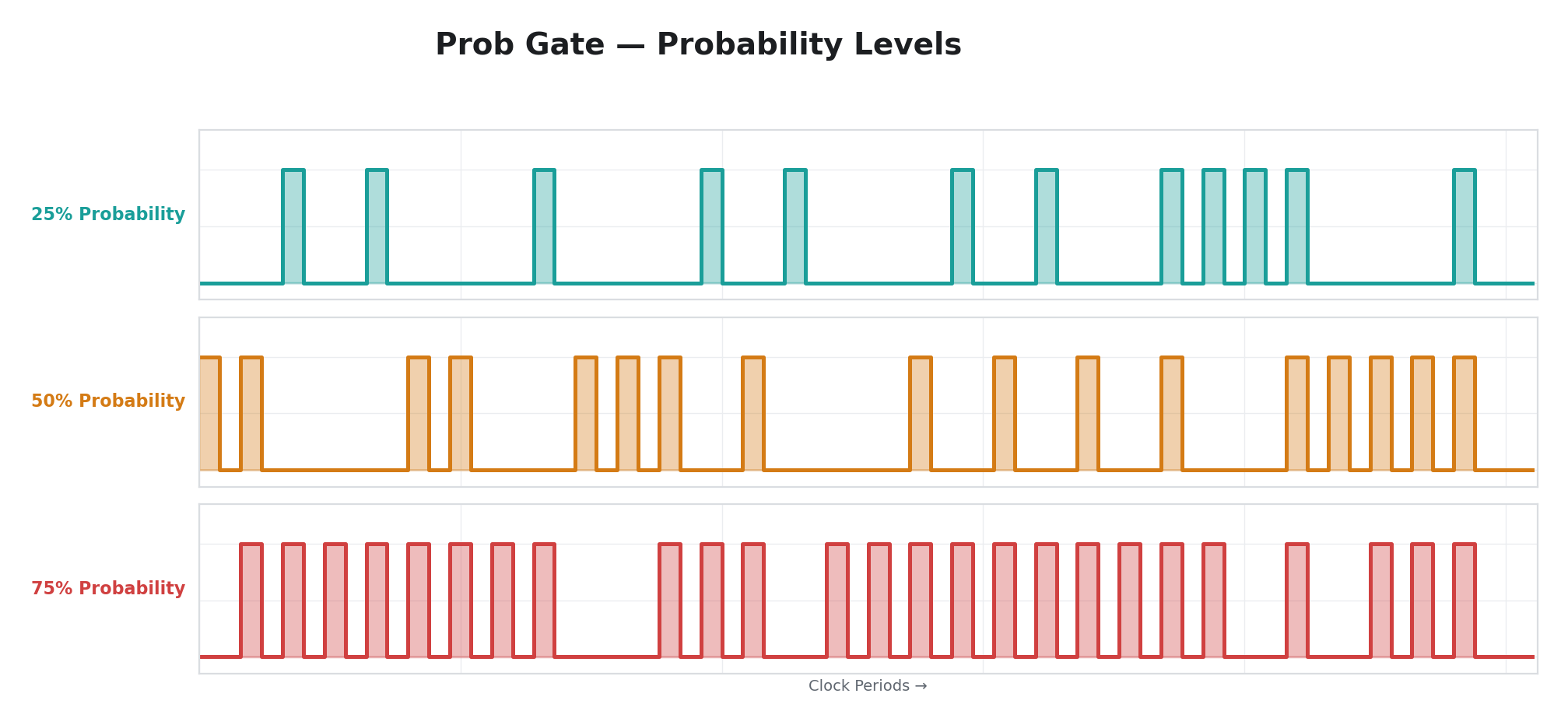

21 — Prob Gate
Time
Rate
Gate period (50 ms–20 s).
Space
Prob
Probability of the gate being "high" on any given period (0% = never, 50% = half the time, 100% = always).
Slope
Length
Gate length within the period. Controls what fraction of the period the gate stays open when it fires.
Per-line: No
A probabilistic binary gate. At each period boundary, a random coin flip determines whether the gate will be high or low for the upcoming period. The Prob parameter sets the probability: at 0%, the gate never opens. At 100%, it always opens. At 50%, it opens roughly half the time. The Length parameter controls how long the gate stays open within each period — at full length, the gate fills the entire period; at short length, it produces a brief pulse near the start.
Prob Gate is designed for generative composition — it produces rhythmic on/off patterns that are statistically predictable but not deterministically repeating. Two Prob Gates with different rates and probabilities, assigned to different parameters, create complex polyrhythmic textures that never exactly repeat.
Probability Gate — Density Levels

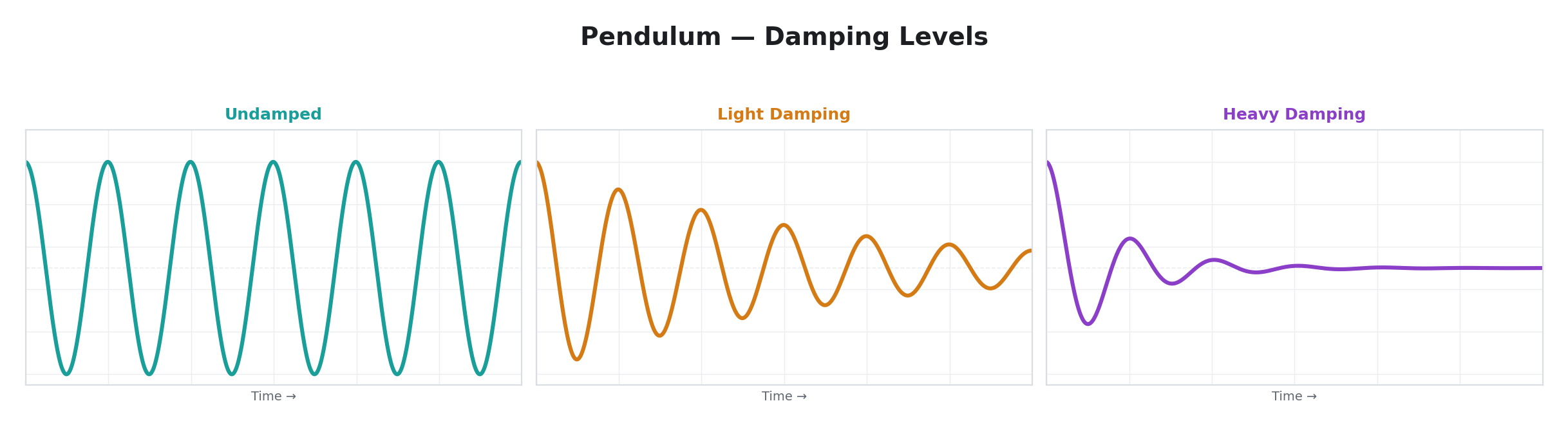

Slope
Damp
Damping coefficient. Fully counter-clockwise = undamped (oscillates forever). Fully clockwise = heavy damping (oscillation dies out quickly).
Per-line: No
Simulates a damped pendulum — a weight on a string swinging back and forth. A restoring force proportional to displacement from center pulls the pendulum back when it swings to one side. Damping gradually reduces the swing amplitude. The result is a decaying sinusoidal oscillation that feels natural and organic — the kind of motion you see when you push a swing and let it settle.
A MIDI note-on displaces the pendulum to its maximum angle when angular velocity is near zero (settled). Note-ons while still swinging hard are ignored. With damping, the swing decays toward center — then firmware auto-re-kicks the pendulum so motion does not stay silent forever. Without damping, it can ring indefinitely.
Pendulum applies a restoring force proportional to displacement and friction proportional to velocity (physics settle), unlike a Free LFO that simply fades amplitude in place.
Pendulum — Damping Levels
Per-Line Rendering
Four operators produce a different value for every scanline when they sit on a rotary or fader slot (P1–P6 and P12): Comparator, Ring Mod, Peak Hold, and Quantizer. On toggle slots P7–P11 they run once per field like every other operator.
Videomancer records the rear jacks continuously. At the start of each field, the samples captured during the previous field are divided into one slice per scanline, top to bottom, and each slice becomes that line’s value. The picture therefore shows the last field’s input drawn down the frame, one field late.
Operator Each scanline uses What you see
Comparator
Average voltage of its slice, against Thresh
On/off bands where the input crossed Thresh
Ring Mod
Average product of the two jacks over its slice
The interference pattern of two signals
Peak Hold
Highest voltage in its slice, decaying line to line
Pulses that leave a fading trail down the frame
Quantizer
Average voltage of its slice, snapped to Levels
A smooth input becomes horizontal steps
Time knobs behave the same on per-line and field-rate slots: a 100 ms Slew or Decay takes 100 ms whether it is applied line by line or field by field. With a steady input, a per-line slot and a field-rate slot give the same value.
CV Input, Audio Input, Slew Limiter, and Field Accum give one value per field on every slot.
Note: V Gradient and H Displace are removed from the operator selector (not disabled passthrough). Older presets that referenced them load as Disabled.
Per-Line Rendering — Field-Rate vs. Per-Line
Audio & CV Inputs
Videomancer has four analog input jacks on the rear panel, labeled Input 1 through Input 4. Each jack accepts control voltages (slow-moving signals used for parameter automation) or audio-rate signals (for waveform-driven and frequency-reactive modulation). There is no hardware distinction between CV and audio — the same jack handles both. The difference is entirely in how the modulation operator processes the signal.
Hardware Overview
Each jack is sampled continuously at 40 kHz, which covers the audio range used for loudness and is far faster than any CV. The inputs are bipolar and handle roughly ±6 V; 0 V is the rest position. At each field boundary, Videomancer reads everything captured since the previous boundary:
  • CV readings (CV Input, Comparator, Quantizer, Ring Mod, Slew Limiter, Field Accum) use the newest samples, averaged over about 0.4 ms.
  • Whole-field readings look at every sample since the last field, so short events are never missed. Audio Input measures loudness as half the peak-to-peak swing, so a DC offset never reads as level; Peak Hold takes the highest voltage.
  • Per-line operators split the field into one slice per scanline (see Per-Line Rendering).
Input Channels
Several modulation operators read from the analog inputs — CV Input, Audio Input, Comparator, Ring Mod, Peak Hold, Field Accum, Slew Limiter, and Quantizer. CV Input, Audio Input, Comparator, Peak Hold, and Quantizer select a channel with the Slope knob (six options). The knob’s center is Ch1, so a freshly zeroed knob reads Input 1:
Slope Position Channel Description
Ch 4
Input jack 4 only
Counter-clockwise
Ch 1+2
Inputs 1 and 2 combined
Just counter-clockwise of center
Ch 3+4
Inputs 3 and 4 combined
Center
Ch 1
Input jack 1 only
Just clockwise of center
Ch 2
Input jack 2 only
Clockwise
Ch 3
Input jack 3 only
Fully clockwise
Ch 4
Input jack 4 only
The display shows the selected channel name as you turn the knob. The pairs are useful for a stereo signal: CV readings average the two voltages, and loudness readings average the two levels, so left and right never cancel.
Ring Mod uses Slope to choose its pair (Ch1 × Ch2 or Ch3 × Ch4). Field Accum and Slew Limiter always read Input 1; their Slope knobs are Leak and Fall.
Signal Conditioning
Every input-reading operator processes the analog signal through the same pipeline:
Rear jack (bipolar, 0 V = rest)
Calibrated voltage
  ├─ CV reading: ±25 mV dead zone around 0 V
  │  or whole-field reading: highest voltage (Peak Hold), or loudness =
  │  half the peak-to-peak swing minus a 20 mV floor (Audio Input)
  ├─ Operator (threshold, product, peak, steps, slew…)
  │    Time knob: Off at fully counter-clockwise, 5 ms to 5 s clockwise
  ├─ Gain (Space knob, −100 to 100, center = none)
  │    100 = full range from 1 V of CV, or 0.5 V peak of audio
  │    −100 = the same swing, inverted
  └─ Added to the Manual knob position, clamped to the parameter range
Rest is Manual. With nothing patched, or 0 V on the jack, every input operator adds nothing and the parameter sits exactly where the Manual knob puts it. Positive CV moves the parameter up, negative CV moves it down.
Gain is linear and bipolar. At center it adds nothing. At 100, 1 V of CV (or 0.5 V peak of audio) moves the parameter across its whole range; at 50, the same signal moves it halfway. Left of center inverts: at −100, +1 V moves the parameter down by the whole range. Larger signals clip at the ends of the range, so overdriving is safe; turn Gain down to keep a hot signal in range.
Time knobs share one curve on every input operator: Slew (CV Input, Ring Mod), Release (Audio Input), Decay (Peak Hold), and Rise/Fall (Slew Limiter). Fully counter-clockwise is Off — the output follows instantly. Clockwise runs from 5 ms to 5 s, and the display shows the time (for example 120ms or 1.50s). Peak Hold’s Decay shows Hold at fully clockwise and never falls.
Signal Conditioning Pipeline

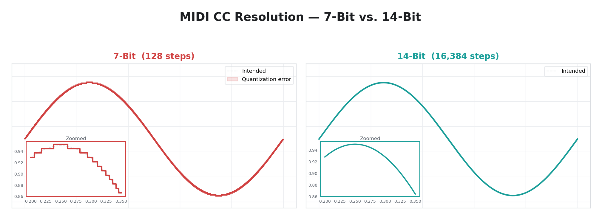

14-Bit Resolution
Each assignment supports optional 14-bit high-resolution CC for smoother control. The MSB CC provides coarse control. If a paired LSB CC is also assigned, it adds fine resolution for smooth, jitter-free transitions across the full range. By default, the LSB is auto-paired at MSB + 32 (the MIDI standard convention for 14-bit CC pairs). Sending only the MSB is fine for most uses — the LSB is optional.
MIDI CC — 7-Bit vs. 14-Bit Resolution

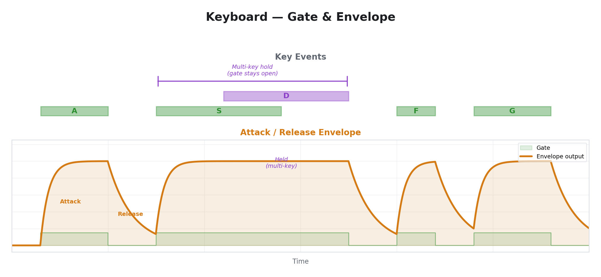

Note On activates the target modulator. Operators that respond to notes — like Trigger Env — begin their attack phase. Bouncing Ball resets to the top and starts a new drop.
Note Off (or Note On with velocity 0) clears the note gate on that modulator (Pendulum / Bouncing Ball use note-on for re-triggers when settled).
Practical tip: Most MIDI keyboards default to middle C (note 60). To trigger Videomancer’s modulators, you need to play in the lowest octave range of your keyboard (notes 0–11), or use your DAW to transpose MIDI data down. Many DAWs allow you to set a MIDI note offset, or you can use a MIDI monitor to verify you are sending the correct note numbers.

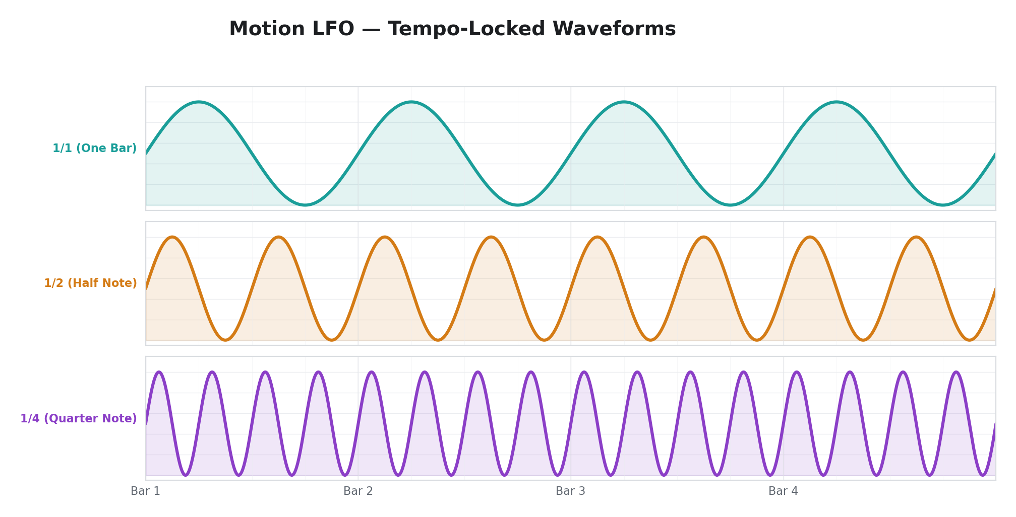

Transport state affects tempo-locked operators differently from free-running ones:
  • Free-running operators (Free LFO, Random, CV Input, Audio Input, physics, and most others) produce modulation output regardless of transport state. They advance at field rate using video timing.
  • Sync LFO advances only while playing. Its output is manual-only when stopped and freezes when paused.
  • Clock Div produces gates derived from transport phase. It is manual-only when stopped and freezes when paused.
  • Free LFO does not reset its phase when transport stops — it continues free-running. Phase resets only when playback starts fresh from stopped.
Transport Timeline — Sync LFO vs Free LFO

  5. Change Wave from triangle to square. The parameter now snaps between two values instead of sweeping.
  6. Try each waveshape. Notice how each produces a different feel of motion from the same rate and depth settings.

Exercise 2: Audio-Reactive Modulation
Objective: Use an external audio signal to drive parameter changes.
  1. Connect an audio source to Videomancer’s Input 1.
  2. Set a modulator to Audio Input. Leave Channel at center (Ch1), set Release to about 200ms, and turn Gain up until loud passages push the parameter near the top of its range. Set the Manual knob low. Play music — the parameter jumps up on every hit and falls back between them. Turn Release toward Off for a twitchier response, or toward 1.00s for a smooth swell.
  3. Set a second modulator on P1–P6 or P12 to Peak Hold on the same channel, with Decay around 100ms. Short hits now leave trails that fade down the frame, because each scanline holds the peak of its slice of the last field.
  4. Press MOTION repeatedly until the input monitor appears (after the USB page) to see each jack’s voltage and level while you adjust Gain.
  5. For multi-band reactivity, filter the audio externally — route each band to a different jack and use a separate Audio Input or Peak Hold on each channel.
Key concepts: Audio Input follows loudness, not voltage — attack is instant and Release sets the fall. Silence adds nothing, so the parameter rests at Manual. Peak Hold on a per-line slot draws the last field’s peaks down the frame. External filtering gives custom multi-band setups.

  2. Set modulator P1 to Euclidean Rhythm. Rate at about 50% (moderate tempo). Density at about 40% (about 6 pulses in 16 steps). This creates a rhythmic gate pattern.
  3. Set modulator P2 to Prob Gate. Rate at about 60%. Prob at 50%. Length at about 40%. This creates a second rhythmic pattern that is similar in rate but randomly varies from cycle to cycle.

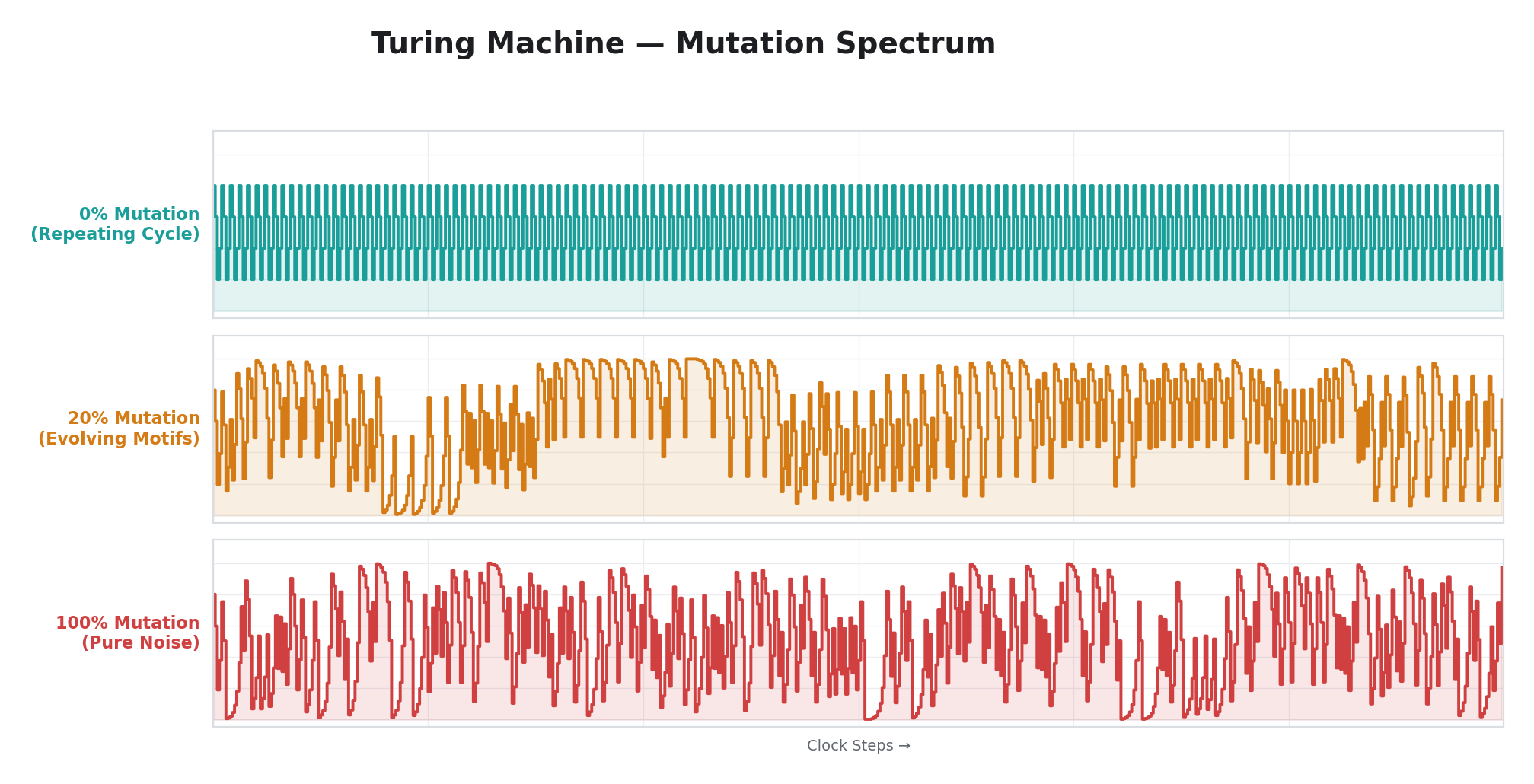

  4. Set modulator P3 to Turing Machine. Rate matching the others. Gain at maximum. Mutate at about 20%. This adds a quasi-periodic melodic contour that slowly evolves.
  5. Let all three run. The Euclidean rhythm provides a steady structural pulse. The Prob Gate adds unpredictable variation. The Turing Machine creates slowly evolving melodic movement. Together, they produce modulation that has rhythmic structure but never exactly repeats.
  6. Slowly increase the Turing Machine’s Mutate parameter. Watch the melodic pattern dissolve from structured repetition into randomness.
Key concepts: Layering different generator types creates complexity, deterministic patterns provide structure, probabilistic elements prevent exact repetition.

  1. Set a modulator to Bouncing Ball. Gravity at about 50%, Bounce at about 80%.
  2. If MIDI is connected, press a key. The ball drops, bounces, and settles. Each key press restarts the drop.
  3. Now switch to Pendulum. Length at 50%, Damp at about 30%. The parameter swings back and forth, decays toward center, then auto-re-kicks so motion continues.
  4. Switch to Logistic Map. Rate at about 40%. Start with Chaos fully counter-clockwise (stable). Slowly turn Chaos clockwise. Watch the output transition from a steady value, to alternating between two values, to four values, and finally to unpredictable chaos.
  5. Switch to Cellular (Rule 30). Set Rate to about 30% so you can see individual generations. Watch the apparently random output emerge from a simple three-neighbor rule.
  6. Change to Rule 90. Notice the more structured, self-similar pattern.

  • Boolean mode for toggles. When modulating a toggle switch, the modulator outputs 0 or 1. Any operator that produces values crossing the midpoint creates rhythmic toggling — a triangle LFO becomes an alternating on/off pattern.

  • Per-line operators for spatial effects. Comparator, Ring Mod, Peak Hold, and Quantizer on P1–P6 or P12 draw the input down the frame. An audio-rate oscillator into Quantizer gives horizontal bands; two oscillators into Ring Mod give moving interference stripes.

  • Wavefolder for complex LFO shapes. If the eight basic waveshapes are not enough, Wavefolder produces complex waveforms from a single sine oscillator. Fold count runs 1–8 — start low and sweep Symmetry to find new shapes.
  • Quantizer for stepped spatial effects. Quantizer with a low level count on a CV input creates visible banding in per-line mode — the frame is divided into discrete horizontal zones.
