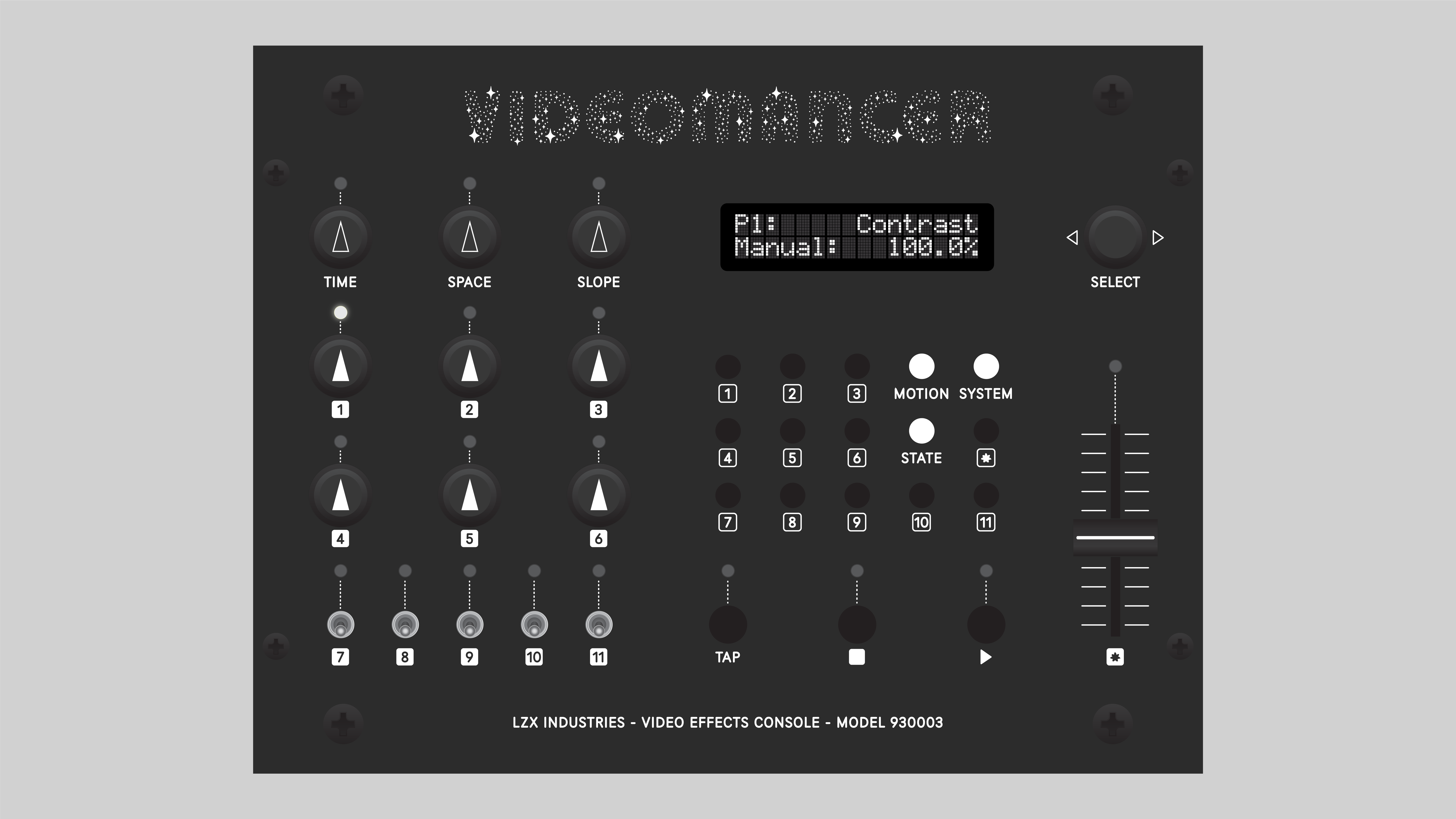

Videomancer front panel

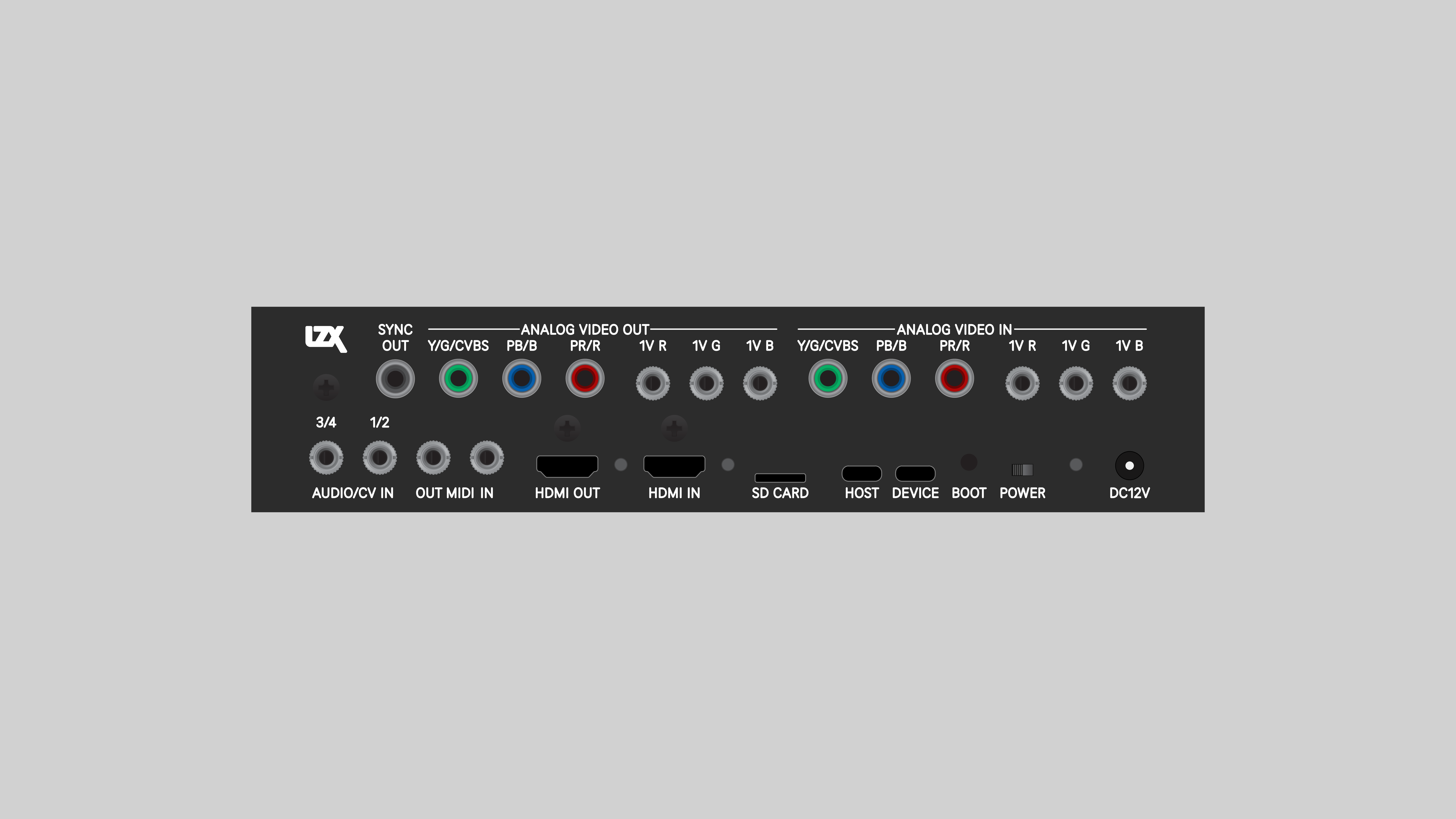

Videomancer rear panel connections
Step 2: Connect HDMI
  1. Connect your HDMI source device to the HDMI IN jack on the rear panel
  2. Connect the HDMI OUT jack on the rear panel to your display
Both HDMI jacks are full-size connectors. No adapters are required for standard HDMI cables.

Step 5: Load a Program
Videomancer’s creative power comes from its Programs — firmware applications that process or generate video in different ways. Each Program transforms the twelve front panel controls into a unique instrument.
To load a Program:
  1. Press the SYSTEM button — the currently loaded Program name appears on the top row of the display
  2. Press the Rotary Encoder — a right-facing bracket ( > ) appears, indicating Program selection mode
  3. Turn the Rotary Encoder to browse the available Programs
  4. Press the Rotary Encoder to load your selection
Suggested first Programs:
  • Passthru YUV — one-clock YUV444 passthrough reference (registers ignored; knobs do not change the picture). Use it to confirm the signal path is clean.
  • Colorbars — generates SMPTE-style color bars with no input required. Set Vid Route Mode to Standalone to use without an HDMI source.
  • YUV Phaser — prismatic channel split and phase-shift effects on input video.
Caution
When Videomancer loads a Program, all outputs are briefly disabled. Your display may show black or "no signal" for a few seconds. This is normal.
Some Programs default to a black output. If your display is black after loading a Program, try moving the ★ Slider (Parameter 12) to its full extents. Many Programs use this slider as a fade or luminance key.
Step 6: Play With the Parameters
Videomancer has twelve Parameters that control the behavior of the loaded Program. Each Program assigns different functions to these controls:
Control Parameters Type
Knobs 1–6
Parameters 1–6
Continuous (turn to adjust)
Switches 7–11
Parameters 7–11
Binary (toggle on/off)
Slider ★
Parameter 12
Continuous (slide to adjust)
Press any Parameter button (labeled 1 through ★) to see that Parameter’s name and current value on the LCD display.
Videomancer LCD showing Parameter name and value
Every Program responds differently. Turn knobs, flip switches, and move the slider to discover what each Parameter does. The LCD display shows you the name and value of whatever you’re adjusting.
