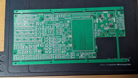

The best news of the week was the early arrival of our Chromagnon Core PCB's latest revision, as well as a test board for its four quadrant multiplier sub-circuit. After scrambling to get a few parts here faster than we expected we'd need them, we began assembly and testing on Wednesday. I was planning to talk about the Chromagnon conceptually this week, but since we reached this early milestone we'll save that topic for the future -- instead let's dig into the hardware itself.
Now begins the long list of tests and measurements involved in verification, the process of making sure every aspect of the new circuit board revision is performing according to Chromagnon's design requirements. Verification of this massive 1300+ placement assembly will take 10-15 work days, and we can hope to be done in early February.
Chromagnon Core RevF power supply testing assembly
The verification process is divided into a few phases: unit testing, regression testing, and integration testing. Unit testing will verify the performance of new features -- in this case the entire digital subsystem and power supplies were moved onto the PCB on this revision, and all of them need to be checked. Regression testing will verify that everything working on the last revision is still working. Integration testing will verify that the core PCB operates as expected when combined with the control PCB's user interface and firmware.

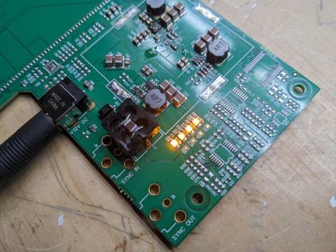

To test the power supplies I asked our SMT assembly technician Andrew to build a variant of the big board with only the power entry and primary power supply components installed. This means that we have removed all of the liabilities from the test that may interfere with power supply performance for issues unrelated to the power supply circuit itself.
All power rail indicator LEDs are go!
To perform these tests I used our Fluke 115 multimeter and Rigol MSO5074 Oscilloscope. After discovering one issue with a missed schematic connection, and altering a few resistor values, the power supplies are fully verified. I'll come back to this assembly in a few days when I get into performance testing, so that I can see how the power supply's noise floor is effected under load.

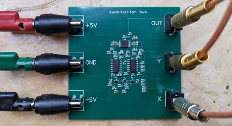

Four quadrant multiplier board under test
The next tests involved the four quadrant multiplier test board. This is such a key circuit in Chromagnon's design, that I knew from experience it would solve problems to have it on an isolated test board. Like the power supply assembly, I may come back to this board later on in the verification process if I need a baseline established between how the circuit performs in isolation vs how it performs with all the other parts on the combined assembly.
