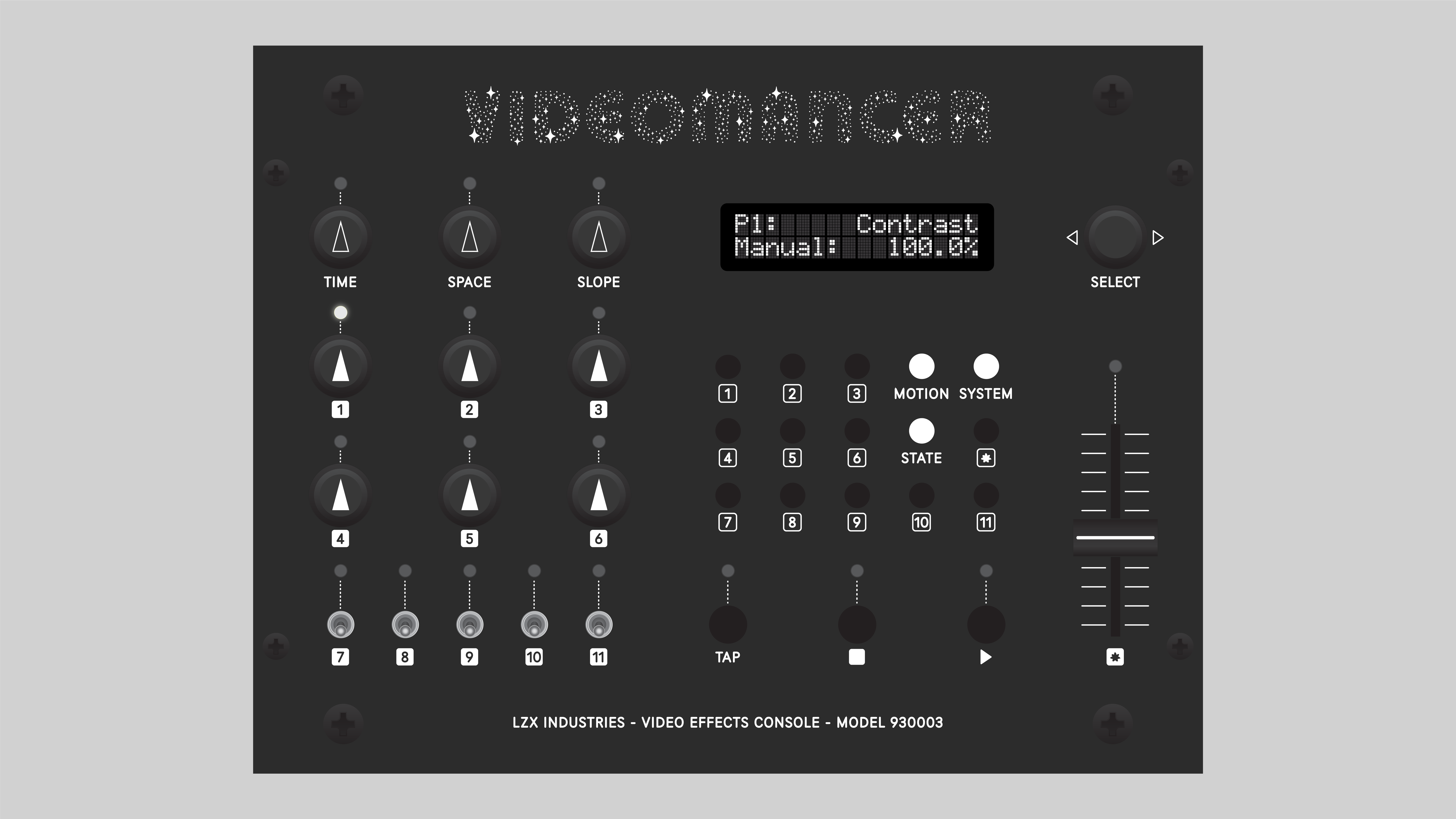

Before You Begin
This guide gets you up and running with Videomancer in minutes. For complete documentation on all features, connections, and capabilities, see the **[User Manual](/docs/instruments/videomancer/user-manual)**.
Videomancer front panel

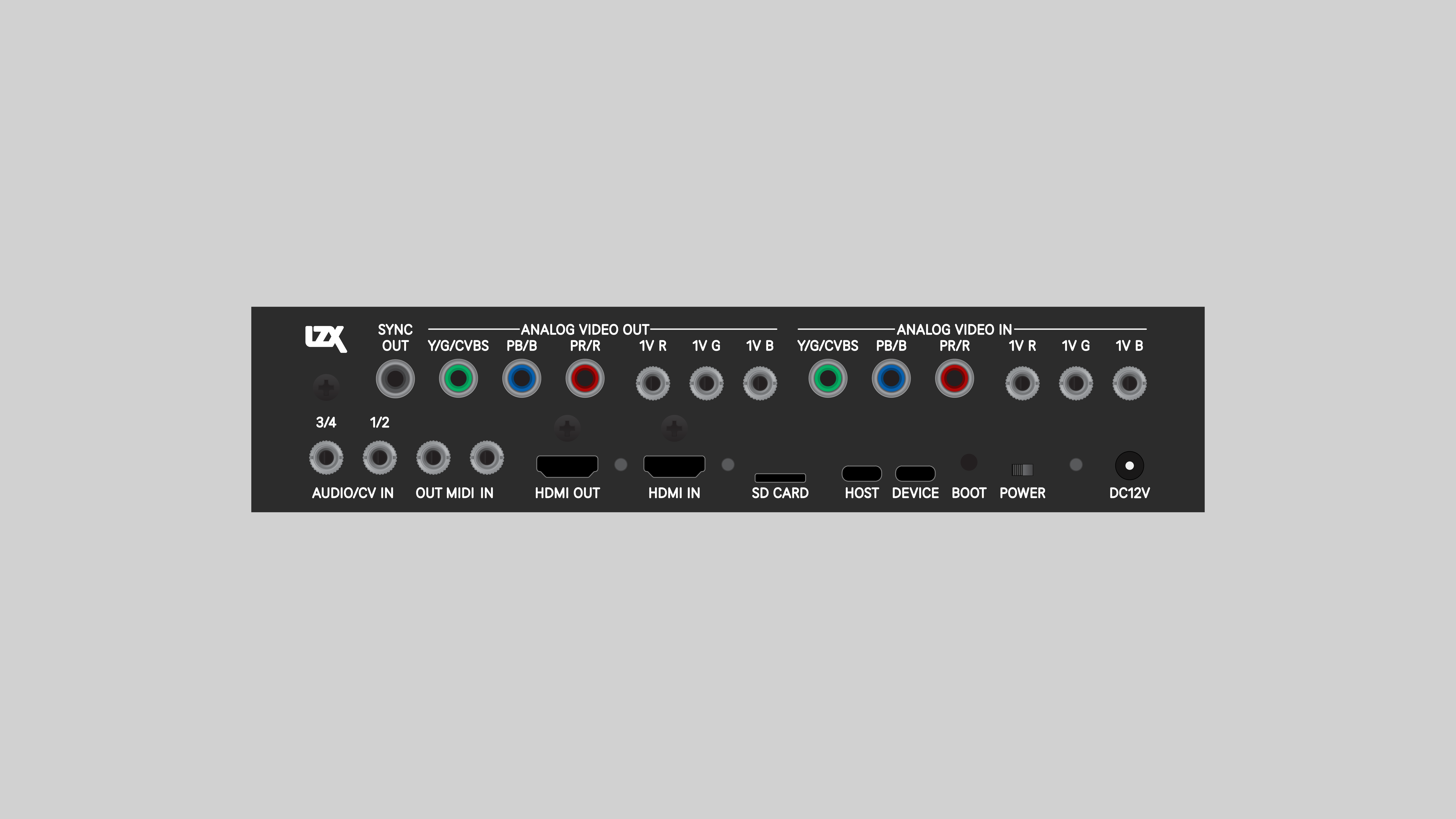

Step 1: Connect Power
Plug the included 12V DC power supply into the barrel jack on the rear panel. Leave the power switch in the OFF position for now.
Videomancer rear panel connections
Step 2: Connect HDMI
  1. Connect your HDMI source device to the HDMI IN jack on the rear panel
  2. Connect the HDMI OUT jack on the rear panel to your display
Both HDMI jacks are full-size connectors. No adapters are required for standard HDMI cables.

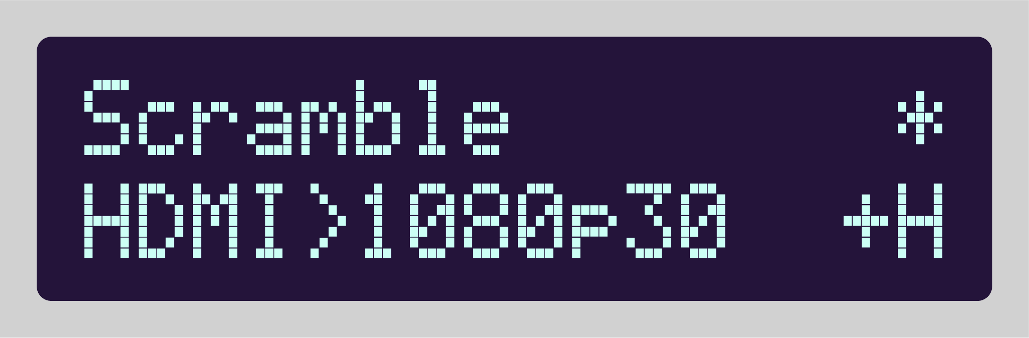

Step 3: Power On
Switch the rear panel power switch to the ON position. Videomancer boots up. Press the SYSTEM button (white, top left of front panel) to display the system status screen on the LCD.
Videomancer system status display showing current program and video input
The rear panel HDMI LED lights illuminate when a valid HDMI connection is detected on each port.

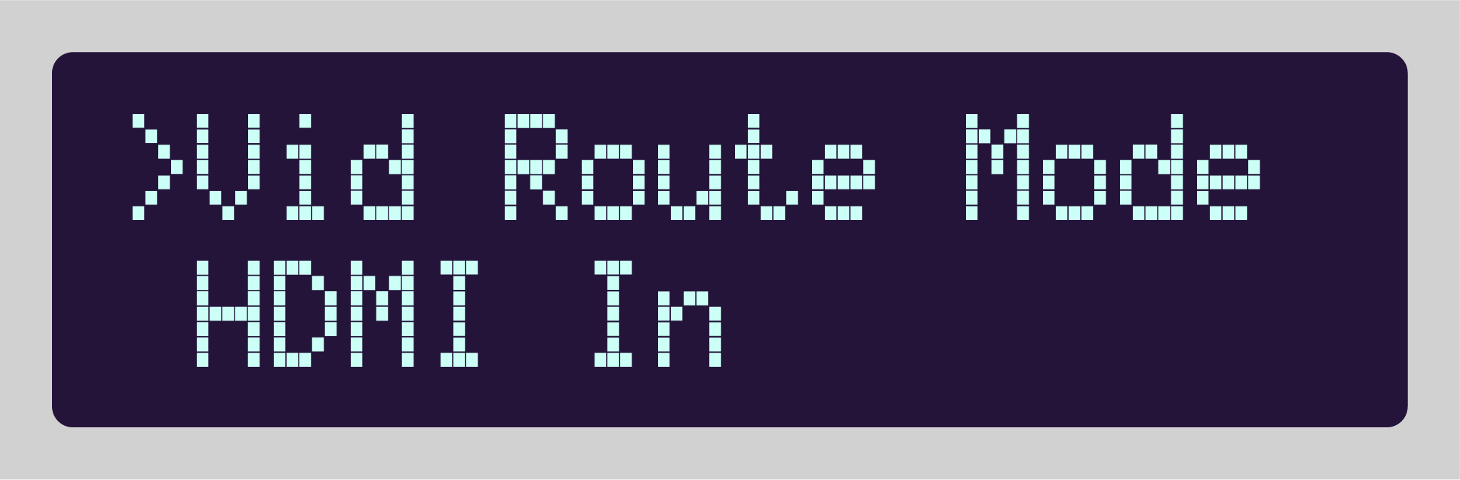

Step 4: Set the Video Route
Tell Videomancer to process your HDMI input. From the system status screen:
  1. Turn the Rotary Encoder to select Vid Route Mode
  2. Press the Rotary Encoder to edit the setting
  3. Turn the Rotary Encoder to select HDMI In
  4. Press the Rotary Encoder to confirm
Videomancer display showing HDMI Video Route Mode selection
Your source video now passes through Videomancer's processor and out to your display.
Videomancer remembers this setting. You only need to set the Video Route Mode once.

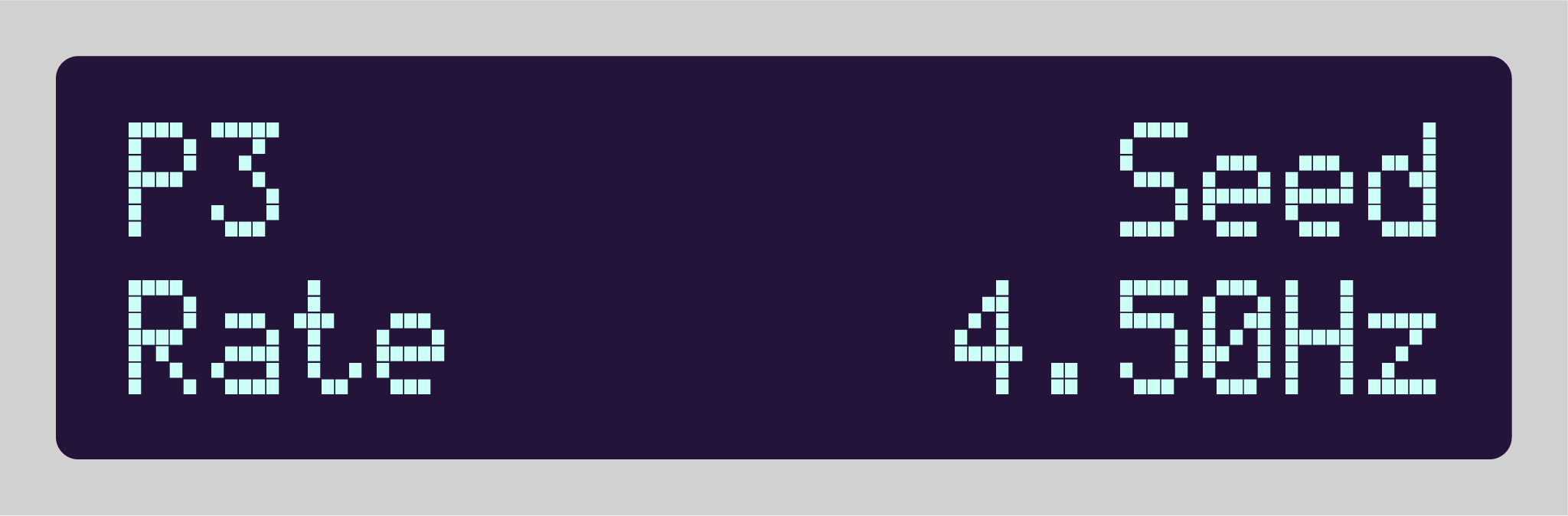

Press any Parameter button (labeled 1 through ) to see that Parameter's name and current value on the LCD display.
Videomancer LCD showing Parameter name and value
Every Program responds differently. Turn knobs, flip switches, and move the slider to discover what each Parameter does. The LCD display shows you the name and value of whatever you're adjusting.
