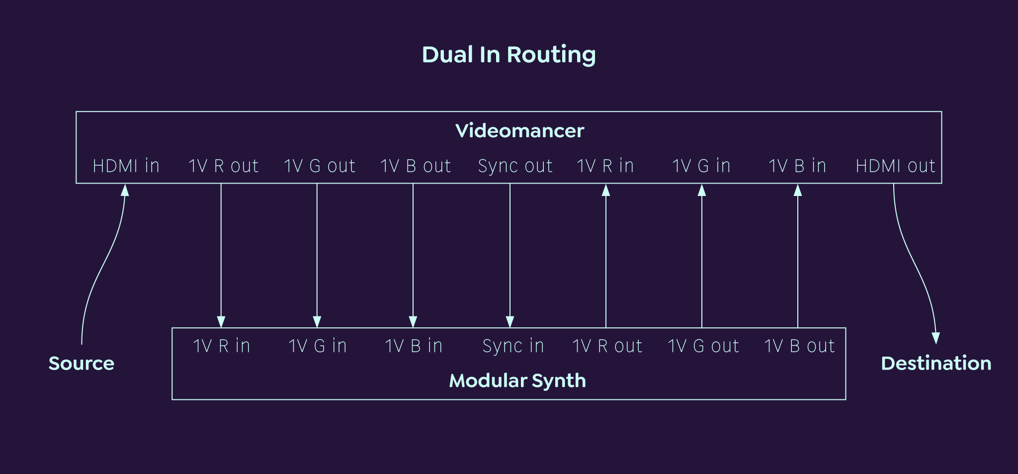

Dual In Route Mode
Integrate Videomancer with analog devices such as a modular synthesizer with Dual In Mode. Videomancer routes incoming HDMI video to the active analog output. Process video with an external device, or chain of devices. Video connected to Videomancer's active analog input is routed to the processor.
Videomancer Dual In routing diagram showing connections to a modular synth *Dual In routing diagram showing connections to a modular synth*
Dual In setup procedure:
  1. Connect Videomancer's analog output to the input of another device.
  2. Choose the output signal type from SYSTEM → Analog Out Mode.
  3. Connect the analog output of another device to Videomancer's analog input.
  4. Choose the input signal type from the SYSTEM → Analog In Mode menu.
There's no law that says Videomancer's analog inputs and outputs have to form a single circuit with some other system. A signal can loop through something as an “effects send” and back to Videomancer, but it doesn't ***have to***. You can connect whatever you want to the analog inputs. That signal can be completely independent of the ***HDMI input → analog output*** chain, giving you a high quality digital to analog converter for free.

Videomancer automatically syncs to any conventional video signal patched to the HDMI or RCA inputs. However, it is not a frame store like TBC2. To use Videomancer as a decoder to convert to 1v modular video, patch the Videomancer Sync output to the sync input of the modular system.
Warning
Videomancer is an ultra-low latency digital signal processing device, but it can never be as fast as a dedicated analog circuit.
Horizontal Phase Delay
Any video going through Videomancer is delayed slightly. If Videomancer is patched into the middle of a modular system, between the modular decoder and the modular encoder, Videomancer's output will be shifted to the right relative to the rest of the modular system. The amount of horizontal shift depends on video resolution, frame rate, and the particular program loaded into Videomancer.
Therefore, inserting Videomancer between a modular decoder and encoder is not a recommended configuration. Using Videomancer as an “effects send” may be possible in exotic scenarios where the modular decoder, encoder, and/or sync generator are not sharing the same sync reference, but that would be a non-standard, advanced, experimental configuration.
On the other hand, there's no issue at all when integrating a modular system using Dual Mode. As long as the modular is receiving sync from Videomancer, the only phase delay will be from the analog patch.

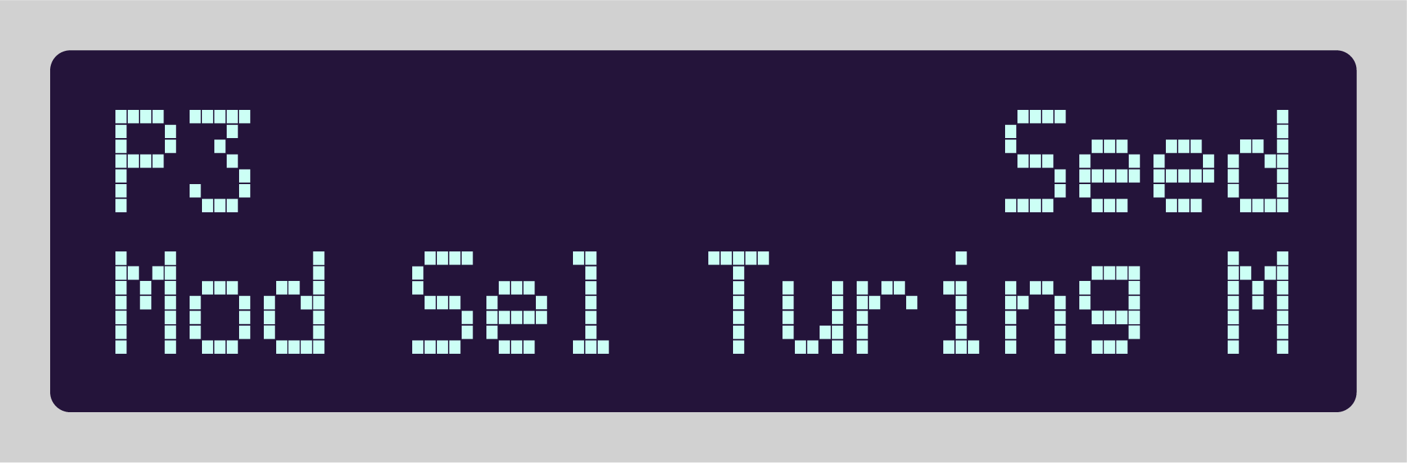

Videomancer Modulation Selection display *Modulation Selection*
Modulation Operator selection procedure:
  • Give focus to the desired Parameter by pressing its button, or by adjusting its physical Knob, Switch, or Fader
  • Press the Rotary Encoder, or turn it by one increment, to display the current Modulation Operator
  • Turn the Rotary Encoder to cycle through the available Modulation Operators
Selection of a Modulation Operator takes place immediately. If the name of a Modulation Operator is displayed, it's active.
The **MOTION** button doesn't choose Modulation operators. Pressing the MOTION button displays the current **Timecode** and **BPM** (beats per minute).

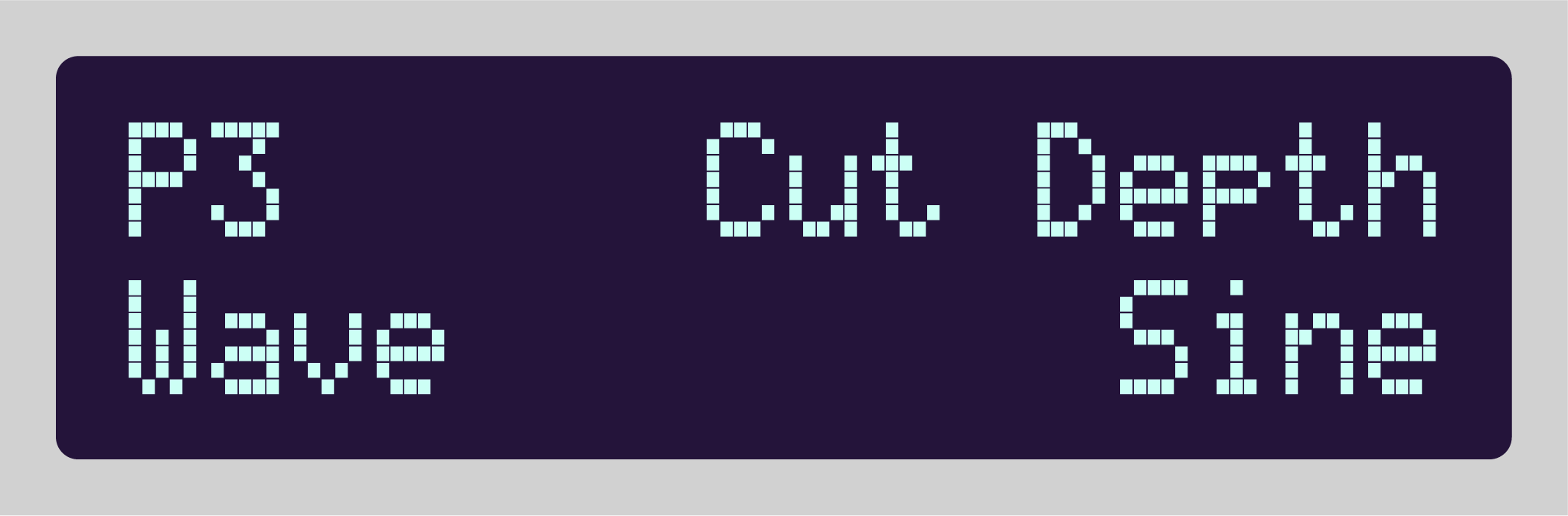

Modulation Control Knobs
Modulation Operator properties are adjusted with the Time, Space, and Slope knobs. Adjusting one of those knobs brings the associated property into focus, and the property's value is displayed onscreen. The values can also be displayed without changing them by repeatedly pressing the desired Parameter button.
Space controls the Gain or amplitude of modulation. The range of the Gain property depends on the current Modulation Operator. For example, LFO modulators have a maximum Gain of 100%. CV and Audio modulators have a maximum Gain of 400% to accommodate sources with different voltage ranges.
Time and Slope knobs perform different functions depending on the active Modulation Operator, as described in the Modulation Guide. For example, Time adjusts the period of an oscillator, and Slope chooses the waveform type.
Videomancer Slope display *Slope display showing Sine LFO waveform selection*

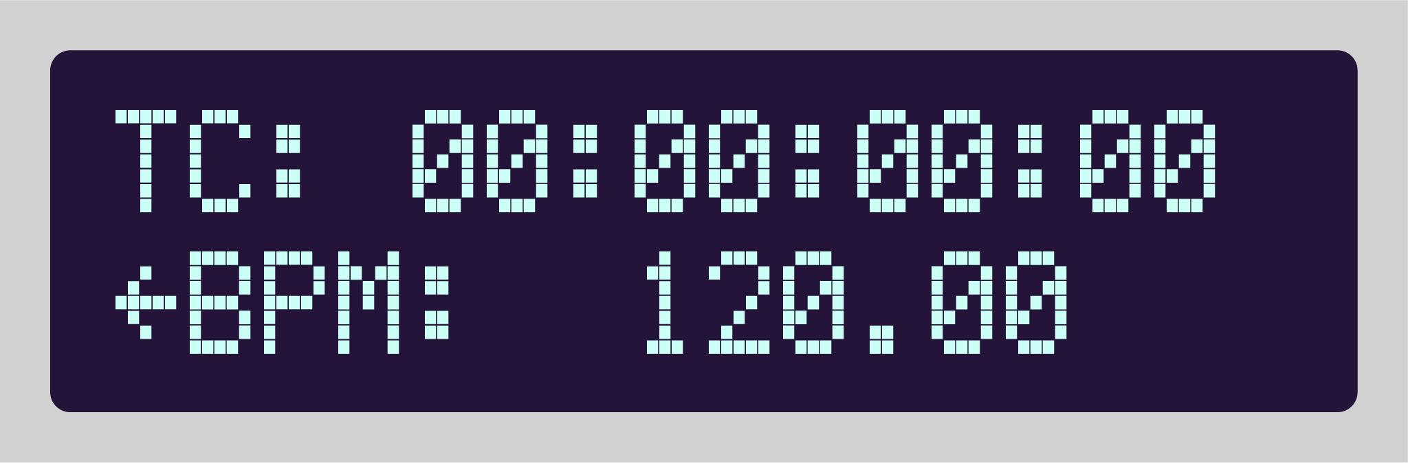

MOTION
Press the MOTION button to display the current values of Timecode (TC) and Beats Per Minute (BPM).
Videomancer Timecode and BPM display *Timecode and Beats Per Minute*
Modulation within Videomancer is usually linked to the Timecode displayed in MOTION mode. Videomancer can generate timecode internally, or synchronize to MIDI.
Modulation is deterministic based on Videomancer's timecode. For example, oscillators begin with a phase of zero at timecode value 00:00:00:00. If the Time properties of Modulation Operators don't change, then the exact same Modulation patterns are generated each time playback begins from zero.
Internal Synchronization
Press the START button to activate playback of internal Timecode.
Press the STOP button to deactivate playback of internal Timecode. The time index is reset to 00:00:00:00.
When the transport is stopped, a left arrow ( )appears on the lower left of the display. When the transport is running, a right arrow ( ) is displayed.
Videomancer does not have a manual pause button. Stopping playback sends the timecode value to zero, resetting all modulation. Use [MIDI Timecode](/docs/instruments/videomancer/user-manual#midi-synchronization) if you wish to pause and resume playback.
Internal BPM Tempo
To change the BPM value numerically: - Press the MOTION button - Turn the Rotary Encoder
To change the BPM value rhythmically while playback is stopped: - Press the MOTION button - Press the TAP button once to begin sampling the tempo - Press the TAP button again to finish sampling the tempo
To change the BPM value rhythmically during playback: - Press the TAP button once to begin sampling the tempo - Press the TAP button again to finish sampling the tempo
The new tempo takes effect immediately.

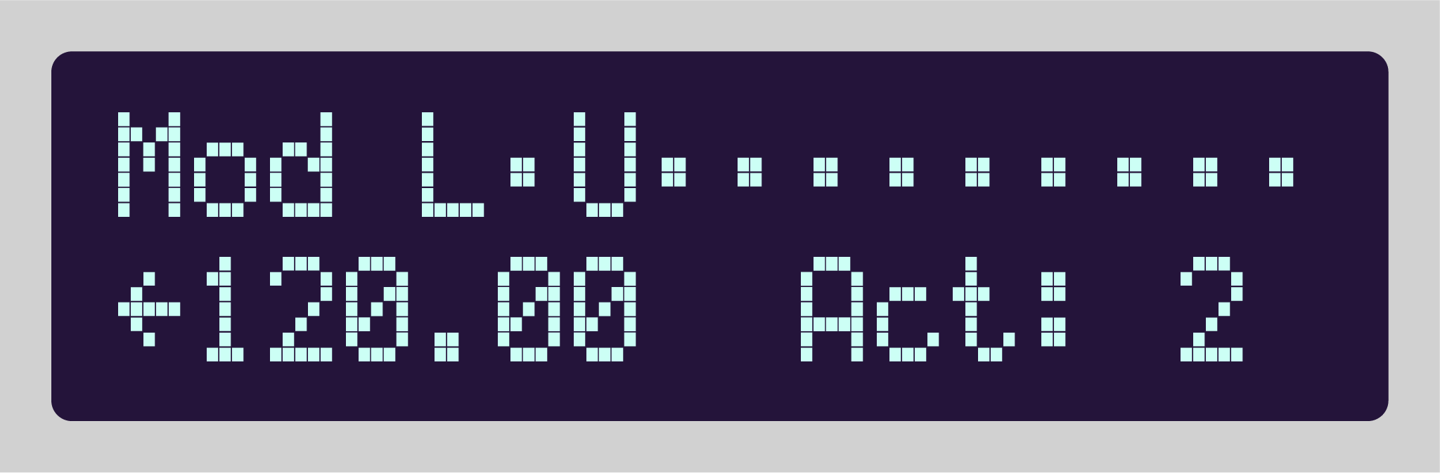

MOTION Overview
Pressing the MOTION button a second time brings up the Motion Overview display.
Videomancer Motion Overview display *Motion Overview*
The illustration above indicates the following:
  • Parameter 1 Modulation Operator is Free LFO
  • Parameter 3 Modulation Operator is Turing Machine
  • Playback is stopped
  • Beats Per Minute is 120.00
  • Two Modulation Operators are active
The top row lists all active Modulation Operators. Each character or symbol to the right of the word Mod represents one of the 12 Parameters, in numerical order from left to right. The first place is Parameter 1, the second is Parameter 2, etc. The table below lists which Modulation Operator is signified by each symbol.
SymbolModulation OperatorSymbolModulation Operator
DisabledKComparator
LFree LFONPendulum
SSync LFOWDrift
CCV Input*Ring Mod
AAudio Input#Cellular
RRandomPPulse Width
EEnvelopeJPeak Hold
HSample & HoldIField Accum
TTrigger Envelope/Slew Limiter
QStep Sequencer~Perlin Noise
FFFT BandZWavefolder
DH DisplaceVClock Div
UTuring Machine?Prob Gate
BBouncing BallOQuantizer
XLogistic MapmMouse
YEuclidean RhythmkKeyboard
MMotion LFOgGamepad
GV GradienttTablet
The second row of the Motion Overview displays the state of the MOTION transport and the current Beats Per Minute. A left-facing arrow indicates that the transport is stopped, a right-facing arrow indicates that the transport is playing. To the right of the arrow, the current BPM value is displayed.
Also on the second row, the total number of active Modulation Operators is indicated by the word Act: followed by a number.

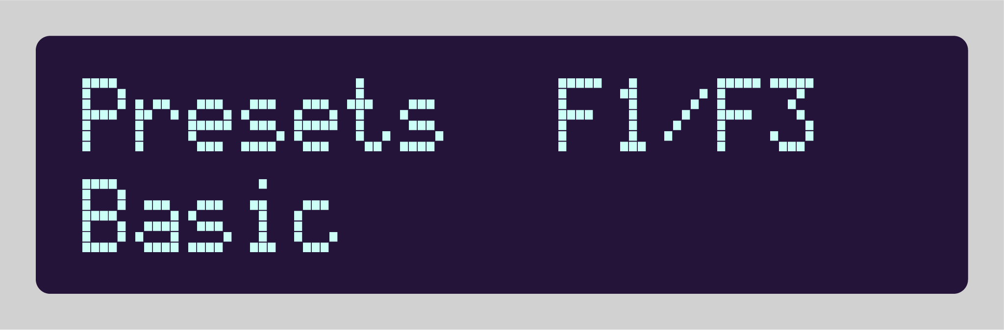

STATE Presets
The STATE button accesses factory or user-defined Presets for a particular Program. All Modulation and Parameter values are stored in non-volatile internal flash memory. Videomancer will commit your spell to memory, and recall it even after a power failure or reboot.
Programs can include up to eight Factory Presets, indicated by the letter F. User Presets are signified by the letter U. The currently loaded Preset number is followed by a slash, then by the total number of Presets, either Factory or User. Internal storage provides a total of 32 Preset registers.
Videomancer Preset Selection display *Preset Selection display*
To load a Preset:
  • Press the STATE button
  • Turn the Rotary Encoder to select a Preset number
  • Press the Rotary Encoder to confirm the load operation
