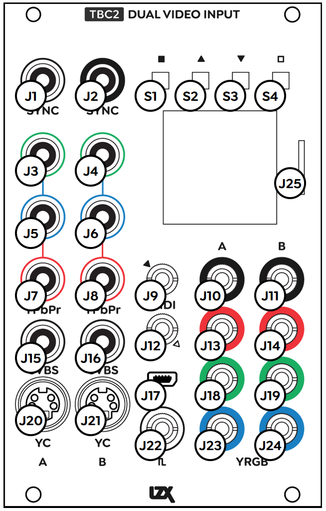

The TBC2 front panel essentially breaks down to inputs on the left, and outputs on the right.
Decoder Inputs
The two left-most columns of jacks are labeled A and B, corresponding to the two Decoder submodule inputs, described in the Decoder section below. For each Decoder you wish to use, patch a video source into the three RCA component inputs, an RCA composite input, or an S-Video input. Only one of those three inputs can be active at a time.
Front Panel Sync In and Out
At the top left are RCA jacks for video Sync Input and Sync Output. As explained in the Genlock section below, TBC2 is not designed as the ultimate source of sync in a modular system. It should receive sync from a dedicated sync generator module via the rear RCA connections. Alternatively, the TBC2 front panel sync input enables it to be installed in a different enclosure than the sync generator. More commonly, TBC2's front panel sync output is useful to send sync to another enclosure.
MIDI In and Out
In the center of the front panel are two mini jacks for MIDI In and MIDI Out. TBC2 is not capable of generating MIDI on its own, so the MIDI Out jack is actually a MIDI Through that buffers and echoes any MIDI messages received by the MIDI In jack.
The TBC2 MIDI jacks use the Type B TRS standard: a three-conductor tip-ring-sleeve (stereo) mini jack. The tip is the "source" conductor (+5v static), the ring is the "sink" or signal conductor, and the sleeve is the shield or ground.
Warning
The official MIDI standard is **Type A**, but this was adopted long after hardware manufacturers started using mini jacks. If you wish to interface TBC2 MIDI with other Eurorack modules, consult their hardware documentation. You may need an adapter. For example, Expert Sleepers modules use a tip-ring (mono) jack, called **Type C**. The shield conductor is omitted because over short patch cable runs there is no practical need for shielding from radio frequency interference.
TBC2 accepts MIDI Continuous Controller messages to remotely control the Encoder crossfader and SD color correction parameters listed in the MIDI Implementation section below.
Micro-USB
Directly below the MIDI jacks is a Micro-USB port. The current firmware does not provide any user functions for the USB port, it is solely for manufacturer development and testing.
Trigger In
At the bottom center of the front panel is a Trigger In mini-jack. This is not yet implemented.
1v Video Outputs
On the right side of the front panel are eight jacks for 0 to +1v patchable video outputs: four for each of the A and B Encoder submodules, described below.
The bottom pair of three video output jacks are color-coded to Red, Green and Blue, corresponding to the RGB color components of each Encoder channel. But the individual RGB jacks can also be assigned to internally-generated horizontal and vertical ramps, described in the Ramp Generator section below.
The top video output jacks are dedicated to luminance signals, also known as Y. The RGB components of the Decoder or Media submodules are summed. However, the RGB components do not contribute to luminance in equal amounts. RGB components are weighted according to the formula set by the CCIR-601 video standard. This unequal weighting accounts for the human perception of brightness as a function of hue. Green looks brighter than red, red looks brighter than blue. The result of the RGB summing formula is that a black and white luminance image appears to have the same approximate value tones as a full color image.
Y=0.299R+0.587G+0.114BY = 0.299R + 0.587G + 0.114B
Button Switches and Display Screen
At the top right of the front panel is a row of four buttons. These are momentary switches enabling the artist to navigate through menu pages and choose parameter options from the OLED display screen.
The left-most, red button will Cancel the current operation. The middle, gray buttons, Up and Down, navigate through menu pages and parameters. The right-most, yellow button will Confirm the current choice, executing the change to a parameter value or option.

 ConnectorsConnectors and Controls
TBC2: labeled front panel controls
JackFunction
J1RCA sync in
J2RCA sync out
J3Decoder A:
Y or
Green+sync in
J4Decoder B:
Y or
Green+sync in
J5Decoder A:
Pb or Blue in
J6Decoder B:
Pb or Blue in
J7Decoder A:
Pr or Red in
J8Decoder B:
Pr or Red in
J9MIDI in
J10Encoder A:
Y out
J11Encoder B:
Y out
J12MIDI out
JackFunction
J13Encoder A:
Red out
J14Encoder B:
Red out
J15Decoder A:
CVBS in
J16Decoder B:
CVBS in
J17Micro-USB
J18Encoder A:
Green out
J19Encoder B:
Green out
J20Decoder A:
S-Video in
J21Decoder A:
S-Video in
J22Trigger in
J23Encoder A:
Blue out
J24Encoder B:
Blue out
J25MicroSD card slot
SwitchFunction
S1Cancel
S2Up
S3Down
S4Confirm
Technical Data
