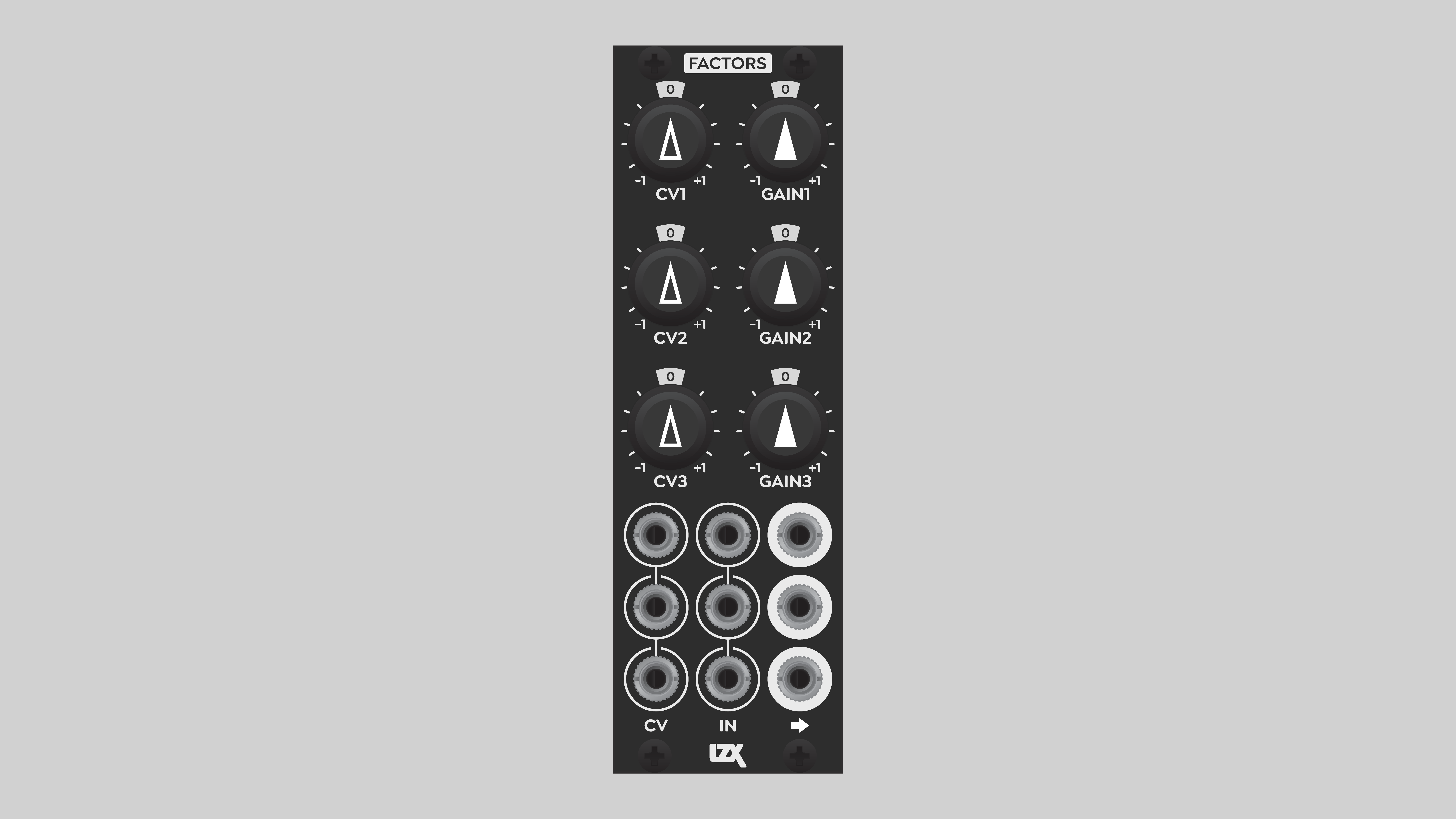

Factors has three discrete multipliers, labeled 1, 2, and 3. As described below, they are internally normalled in series, so you can produce two or three variations on a single pair of sources.
Each multiplier has two inputs, labeled CV and In. These inputs are actually identical, and the labeling is merely conventional. It may help the artist to keep track of which signals are which. For example, if you wanted to modulate the amplitude of a high frequency video oscillator with a low frequency control signal, it would make sense to think of the high frequency oscillator as the "signal", and the low frequency oscillator as the "modulator". But technically, it doesn't matter which of the pair of signal factors goes into which CV or In jack.
Each input signal goes through an attenuverter before the multiplication operation. These are the knobs labeled CV1 through CV3, and Gain1 through Gain3 for the CV and In jacks, respectively. This makes it easy to dial down or invert the individual signal factors.
Factors controls and connectors

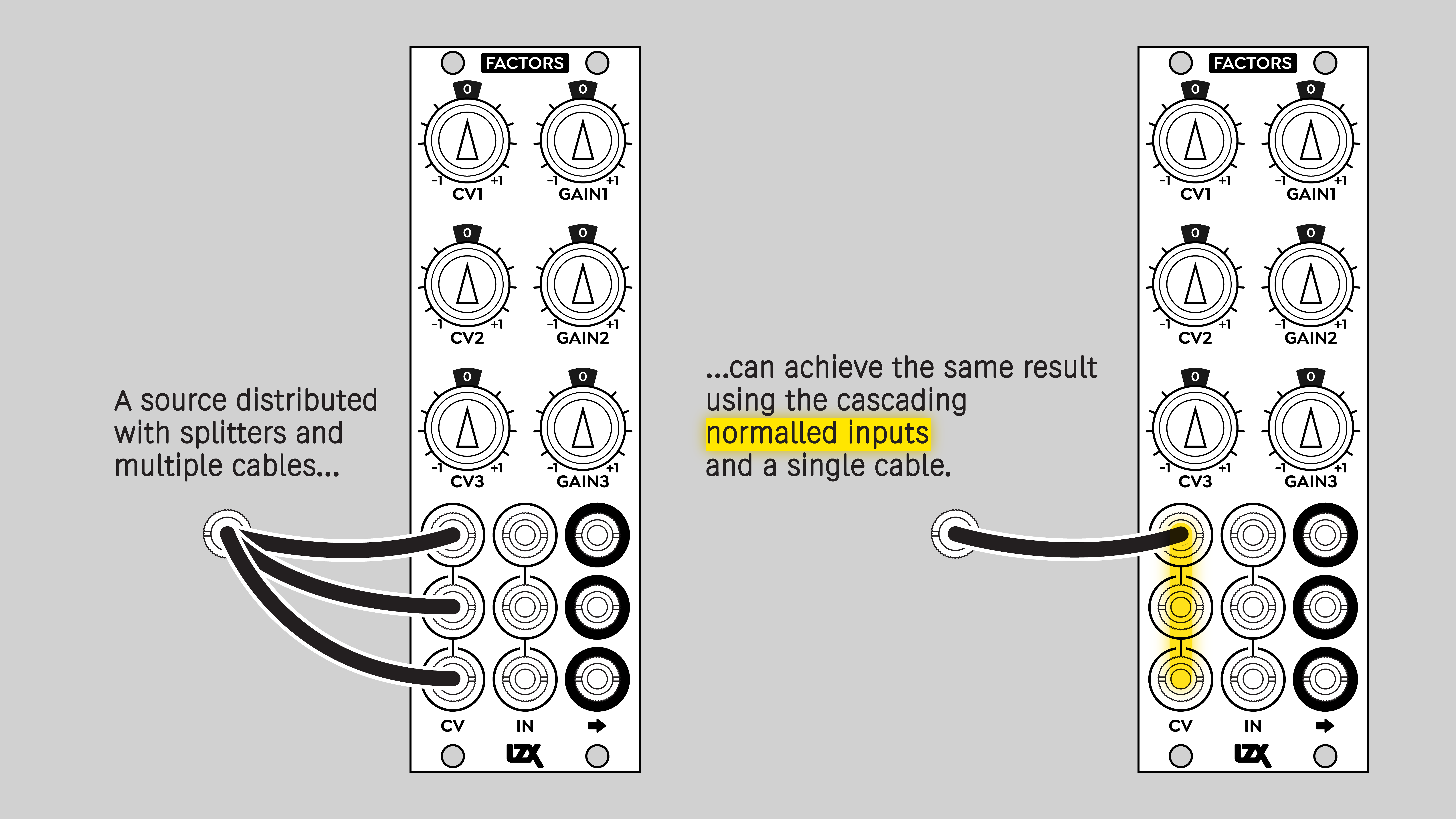

The inputs are internally self-normalled to cascade from top to bottom. A signal patched into a top row input flows to the other inputs in that column.
Factors normalled connections

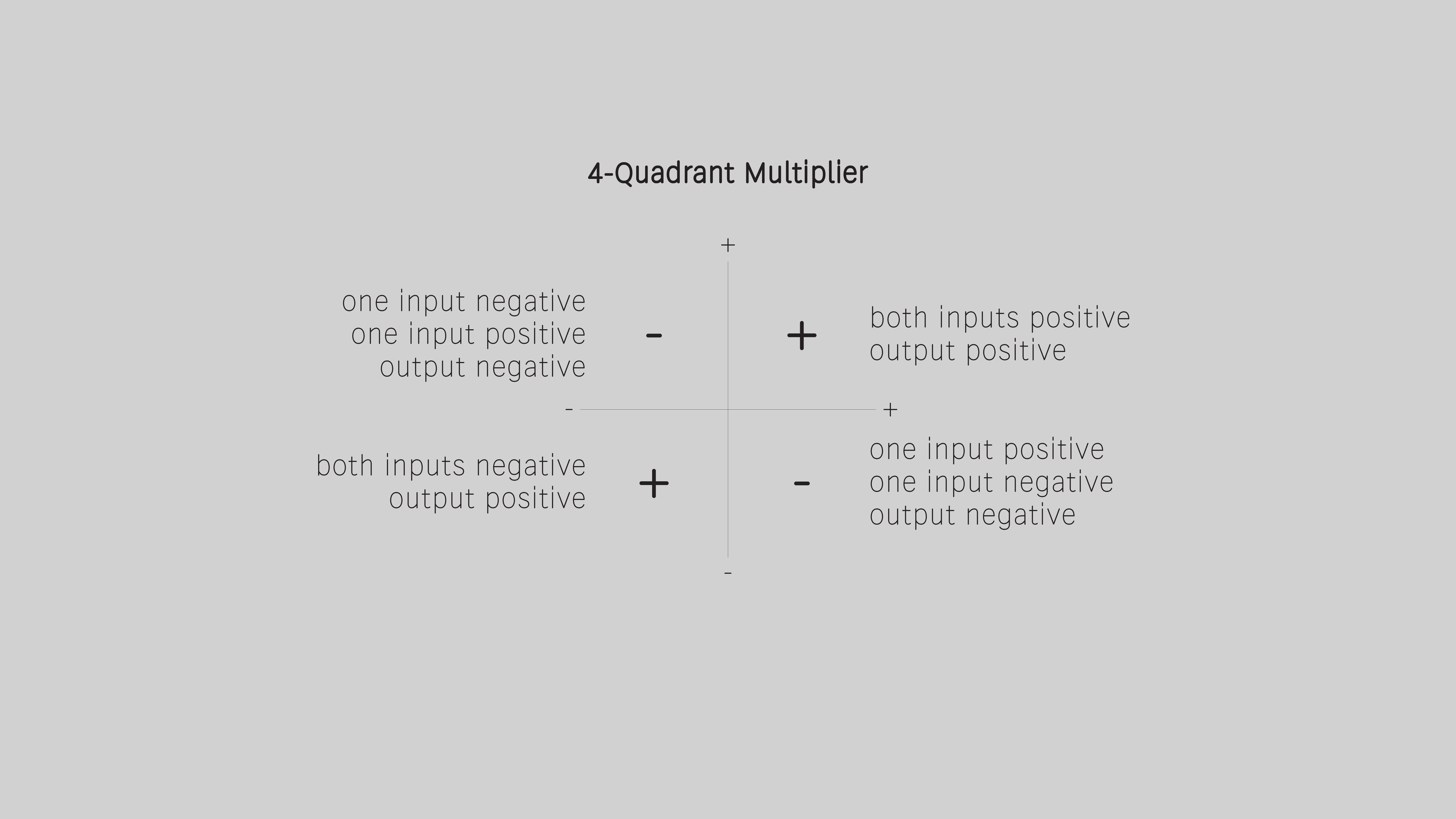

A conventional four-quadrant multiplier (4QM) is designed to operate on bipolar signals: values that are signed positive or negative. The center of the multiplication operation is at a value of zero. This doesn't work very well in the context of video signals that are always positive. It's also not optimized for XY vector graphics. A conventional 4QM places the origin or pivot point of vector transforms at a corner of the figure rather than in the center. The figure would scale or rotate around a corner point.

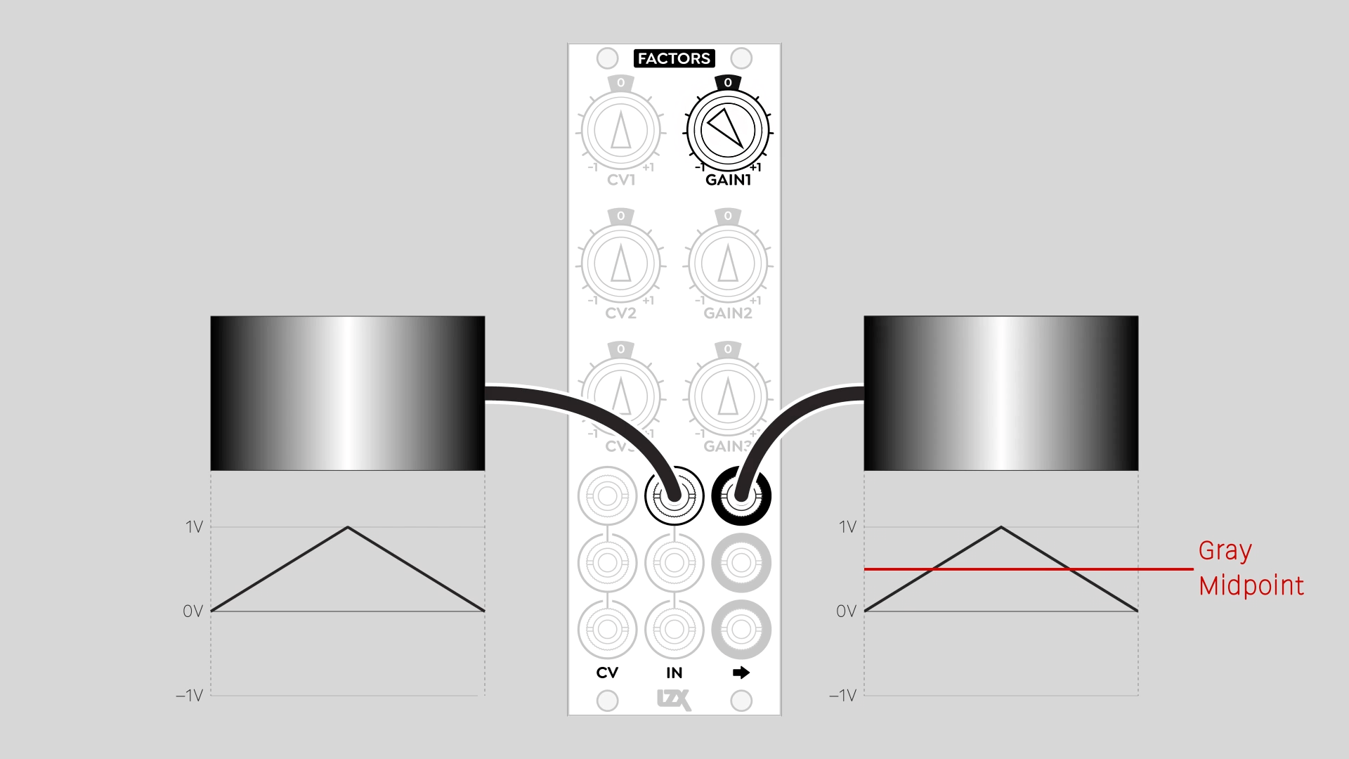

Inversion Around Middle Gray
Factors inversion around middle gray

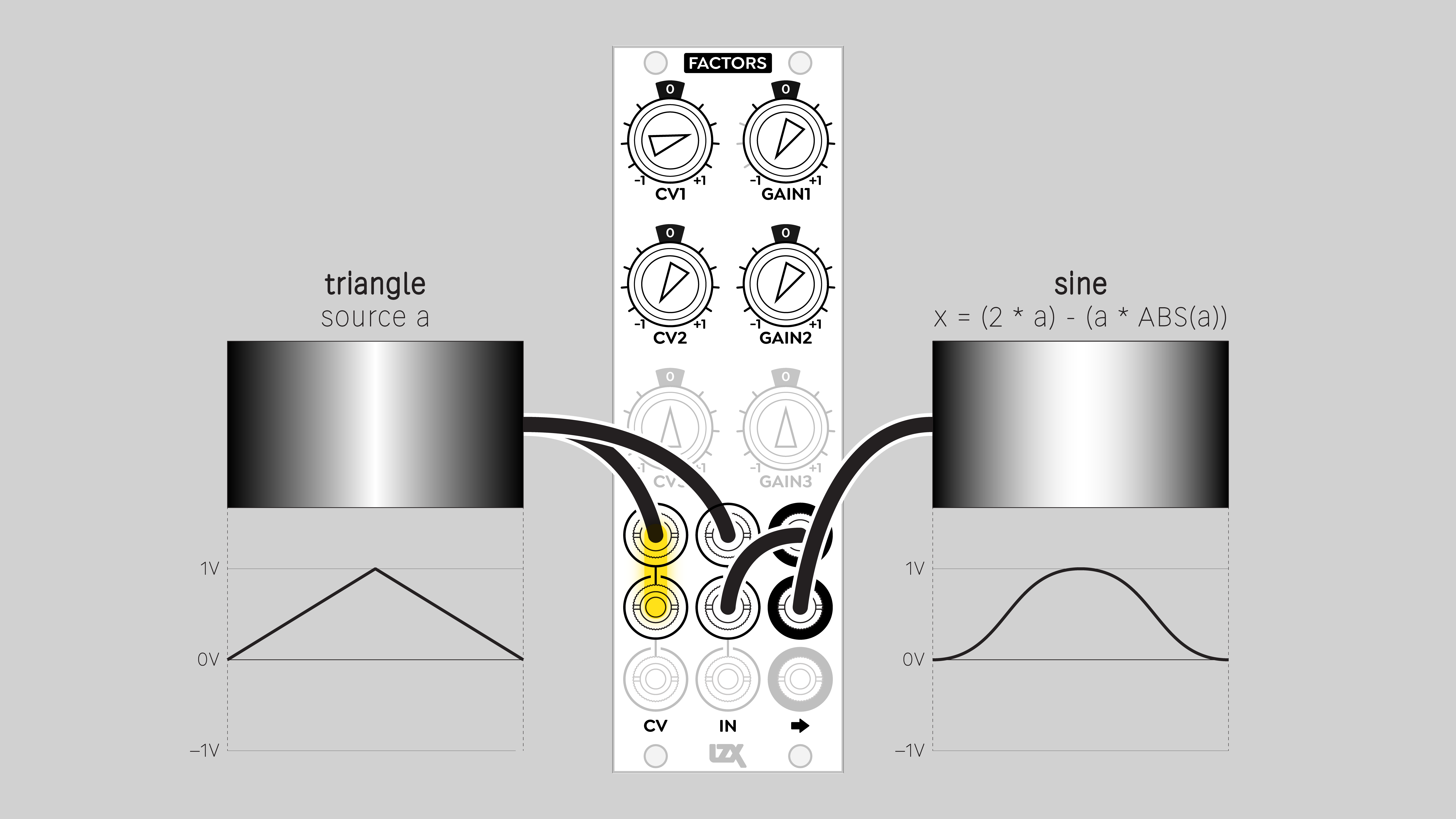

Sine Shaping
Factors sine shaping

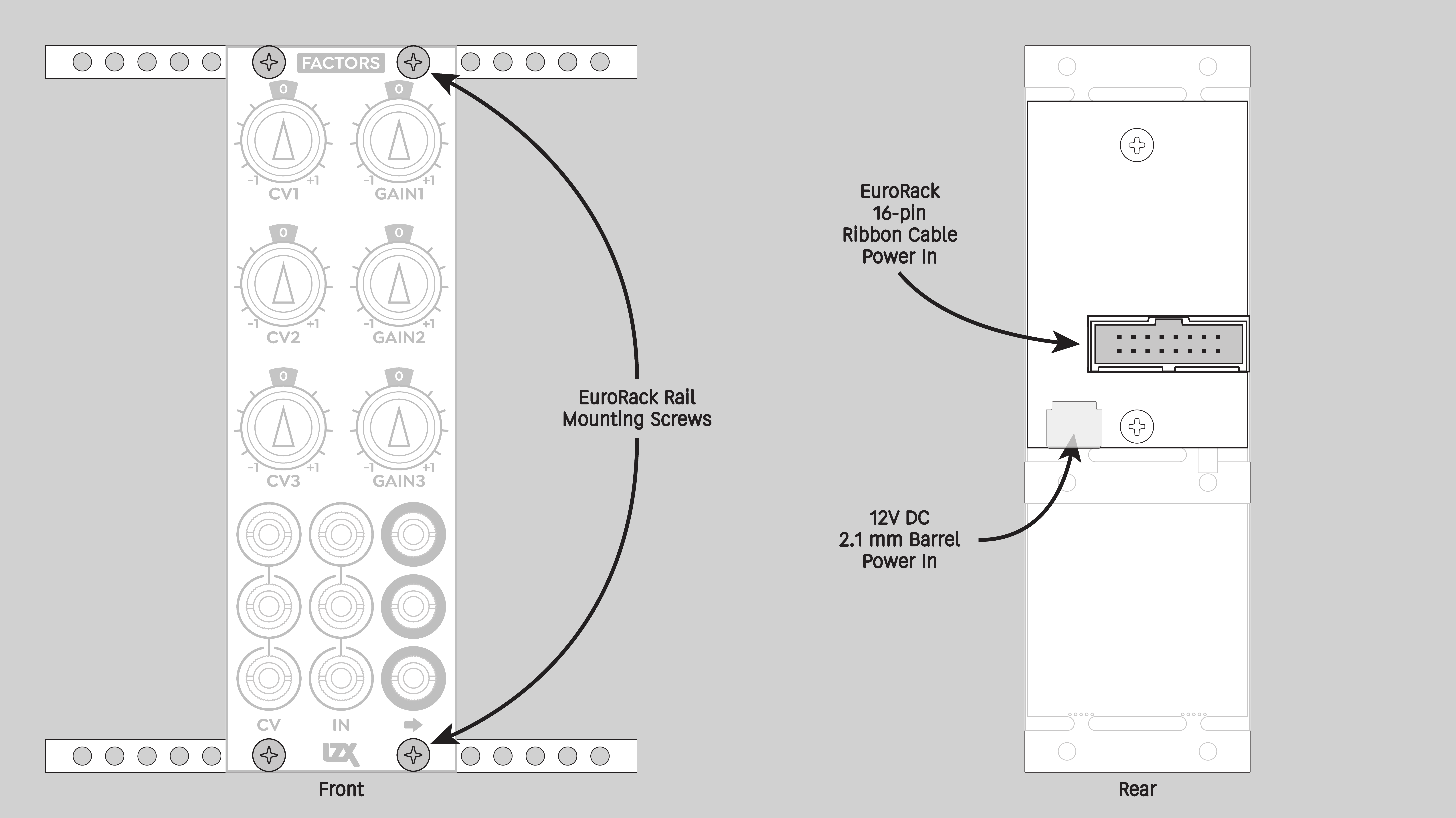

Installation
Factors installation
Requirements
  • EuroRack enclosure
Procedure
