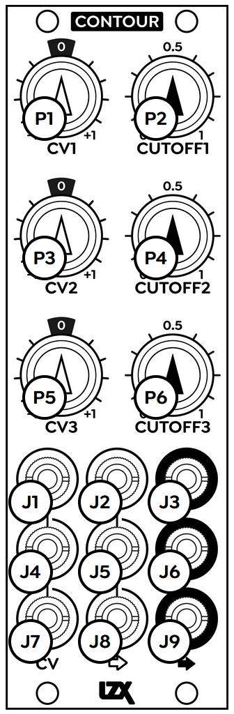

Contour: labeled front panel controls
JackFunction
J1Filter 1 Cutoff
CV in
J2Filter 1 in
J3Filter 1 out
J4Filter 2 Cutoff
CV in
J5Filter 2 in
J6Filter 2 out
J7Filter 3 Cutoff
CV in
J8Filter 3 in
J9Filter 3 out
PotentiometerFunction
P1Filter 1 Cutoff
CV Depth
P2Filter 1 Cutoff
P3Filter 2 Cutoff
CV Depth
P4Filter 2 Cutoff
P5Filter 3 Cutoff
CV Depth
P6Filter 3 Cutoff
