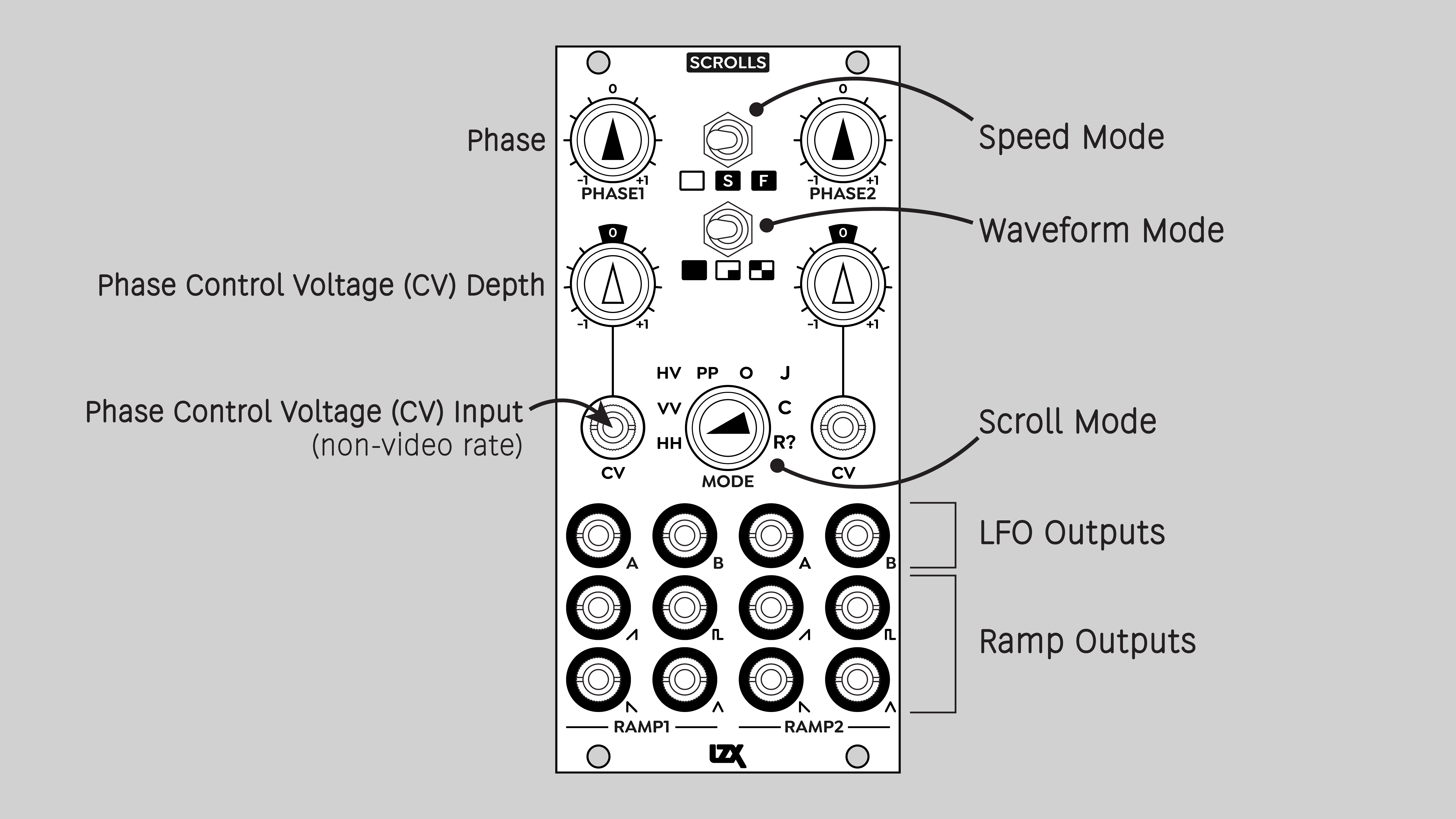

Scrolls is a rhythm source, almost like the visual version of a drum machine. It packs a great deal of functionality into a small package of 12 HP, with no menu diving.
Two identical submodules, Ramp 1 and Ramp 2, provide independent inputs and outputs.
The primary global Mode of Scrolls is chosen from the eight-position rotary switch in the center of the panel. This selects whether H or V signals are available from the video generator jacks, and how all motion is controlled.
Two three-position toggle switches choose other global options. The top switch selects the Speed mode. The switch directly below that selects the Waveform mode.

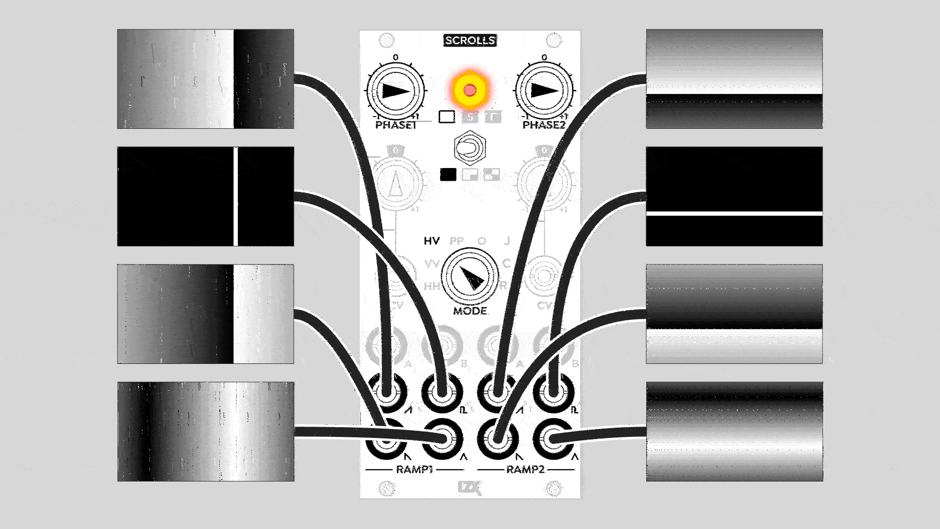

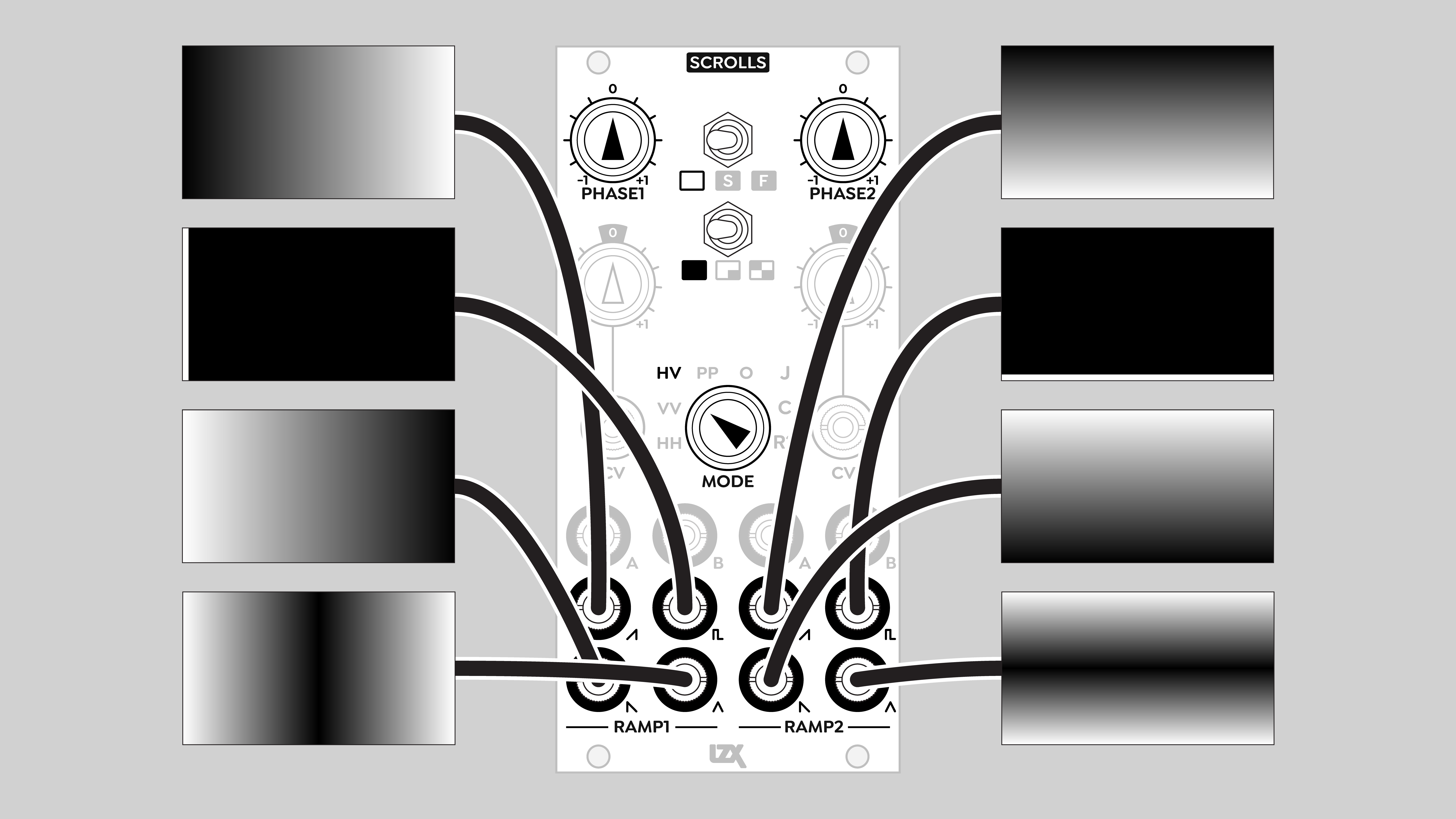

As the primary driver of a generative video patch, Scrolls features numerous outputs. The two bottom rows of jacks are the video waveform generators. Each Ramp submodule provides the following outputs: Ramp (rising), Pulse, Sawtooth (falling), and Sine.
Above the video outputs is a row of low frequency control voltage outputs. Each Ramp submodule features two LFO outputs, labeled A and B.
Per each Ramp Submodule, a bipolar Phase potentiometer shifts the position of the generator, or controls the motion in some other way. The Phase value can be driven by a control voltage supplied to the CV jack. The incoming phase CV is multiplied by the value set with the Phase CV Depth attenuverter potentiometer.

Choose from three ranges of motion speeds. The top toggle switch selects one of three modes, from left to right: Motion Disabled, Slow Range, and Fast Range.
Scrolls: Speed range
Motion Control Disabled
When Speed is set to Motion Disabled, the Phase1 and Phase2 knobs directly control the phase of the video waveforms. They also set the speed of the LFOs. In this mode, the LFOs run at the same frequencies as in Slow Range. However, the LFOs do not affect the video waveforms.
In Motion Disabled mode, the effect of turning Phase1 and Phase2 knobs is to offset the video waveforms. Horizontal ramps are shifted side-to-side, vertical ramps are shifted up and down.

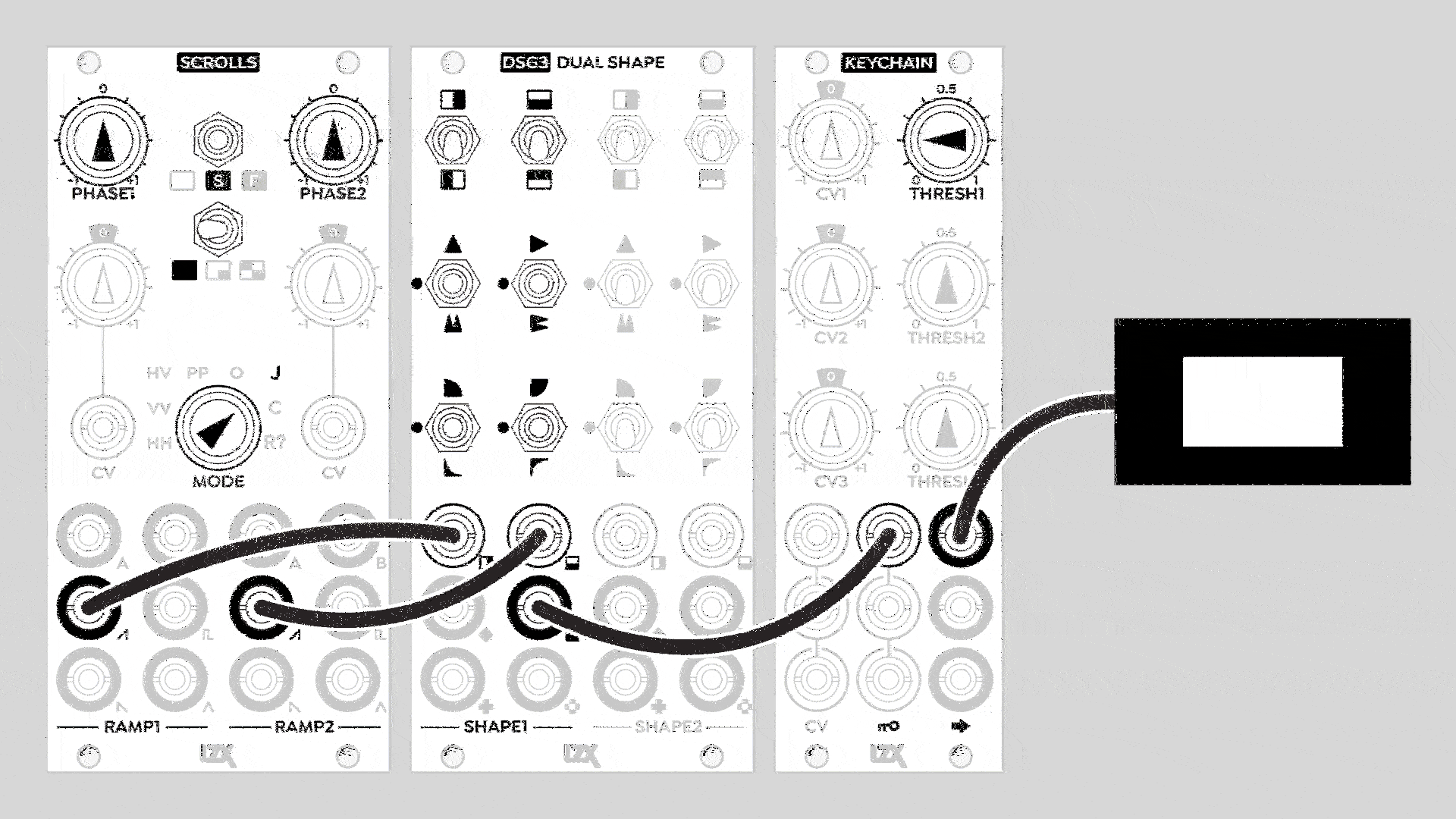

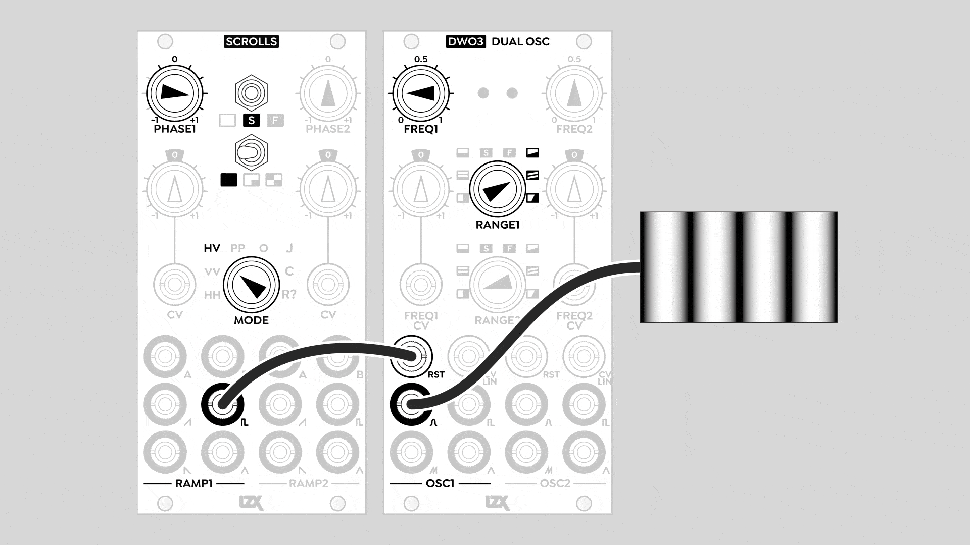

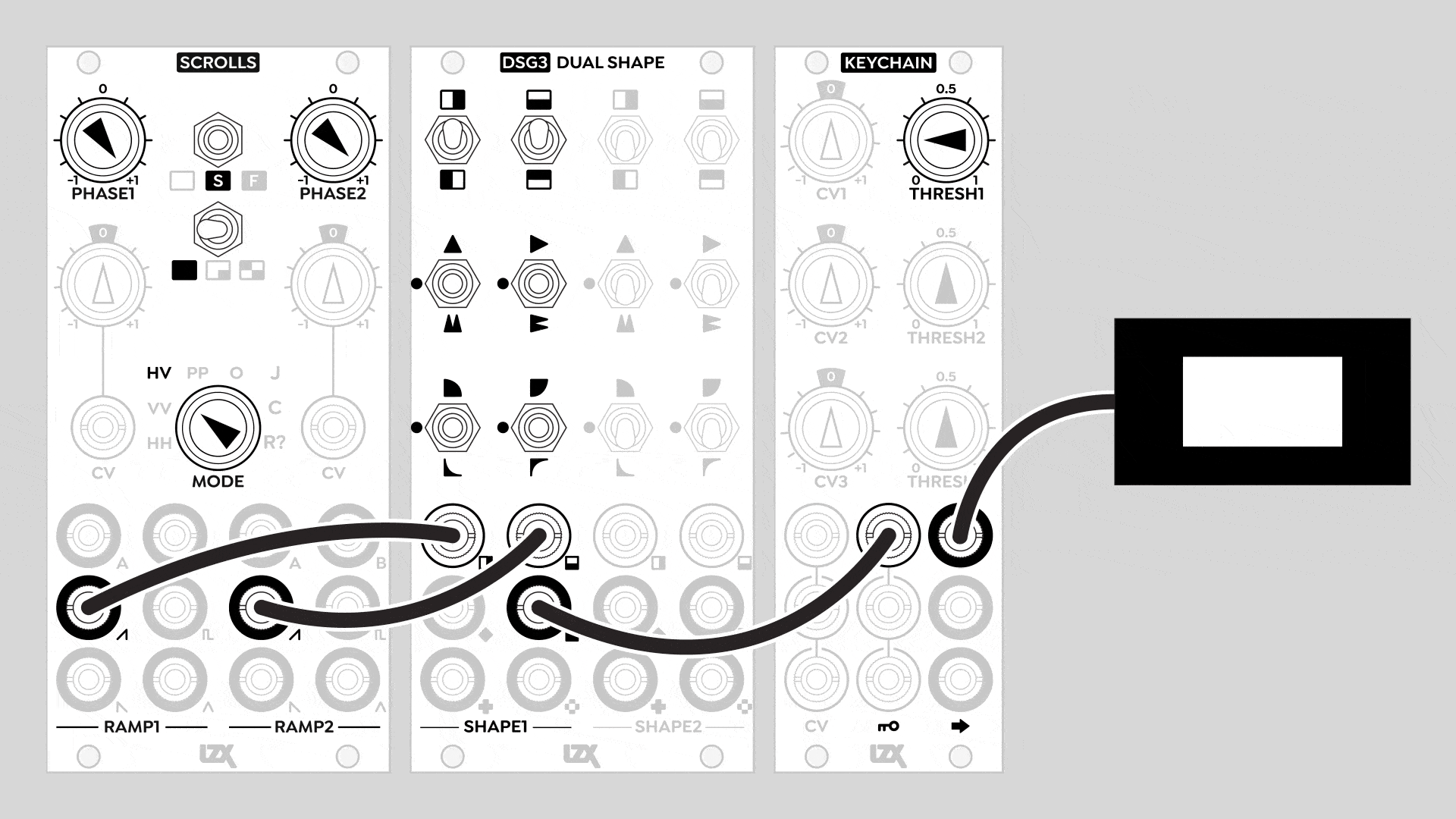

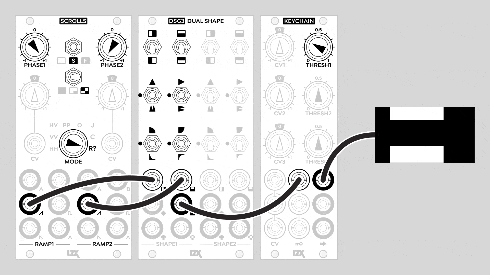

Example Patches
Reset DWO3
Scrolls patch: DWO3 reset

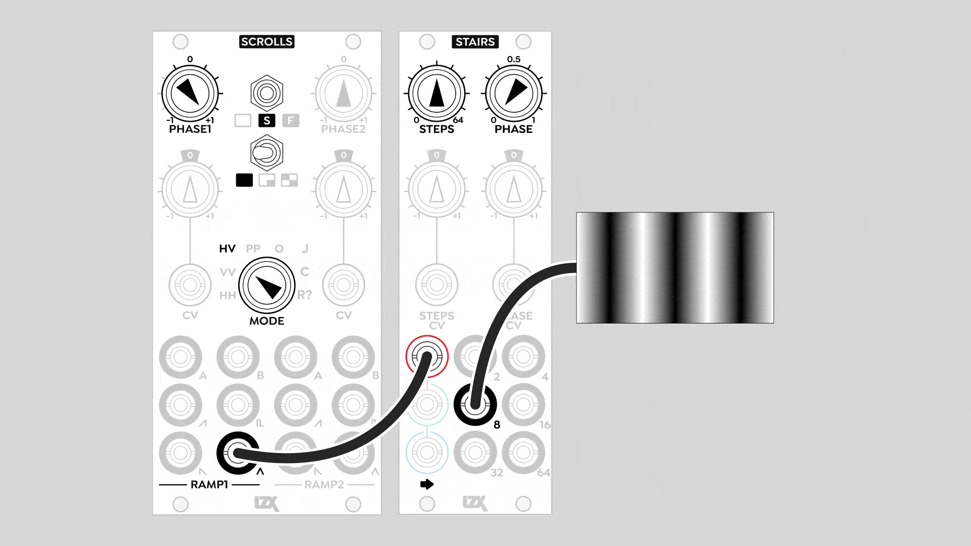

Stairs
Scrolls patch: Stairs

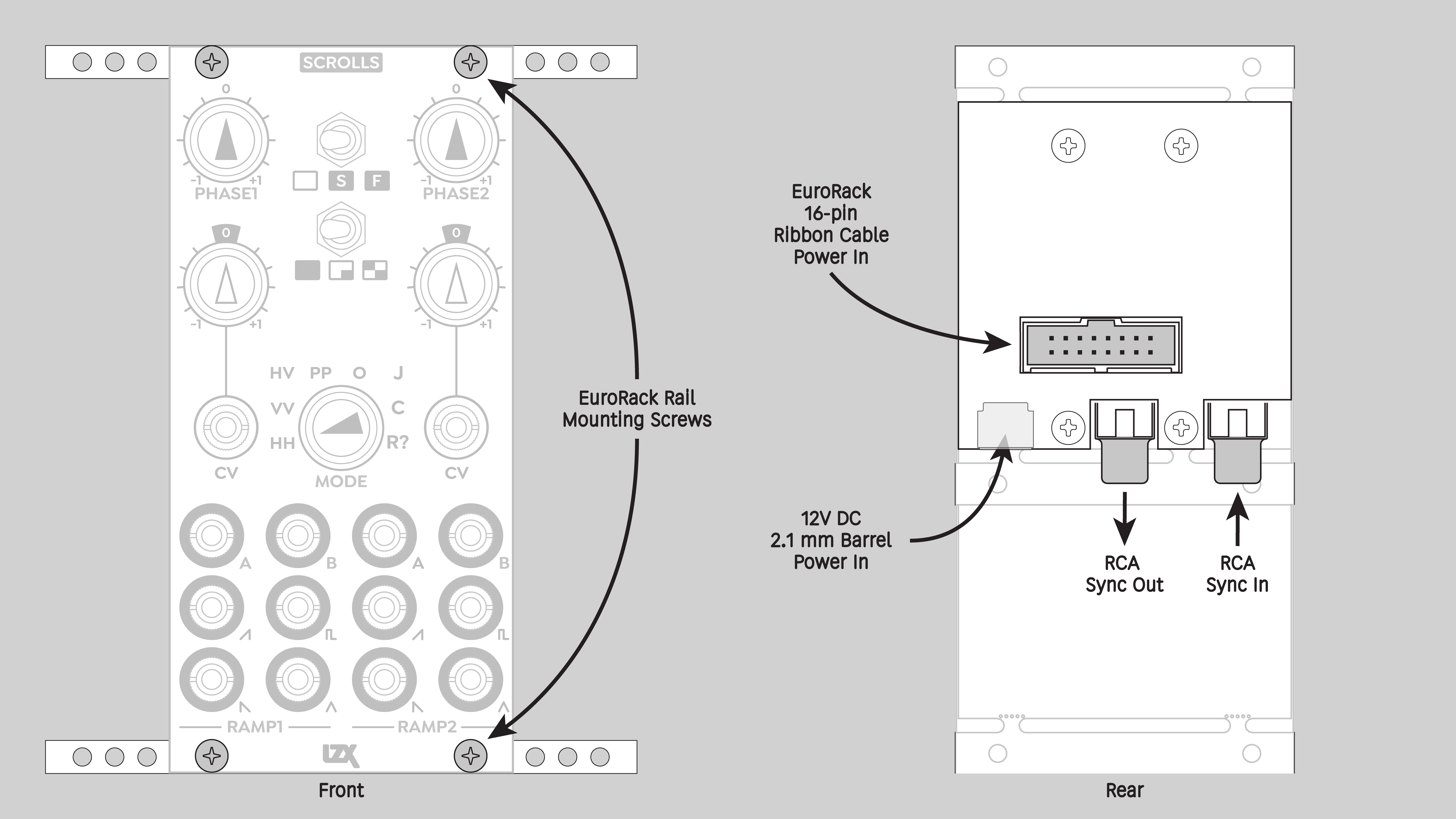

Installation
Scrolls installation
Requirements
  • EuroRack enclosure
Procedure

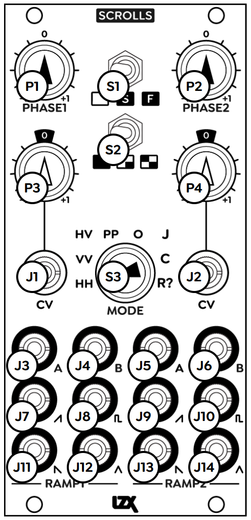

 ConnectorsControls
Scrolls: labeled front panel controls
JackFunction
J1Phase 1 CV in
J2Phase 2 CV in
J3LFO 1A out
J4LFO 1B out
J5LFO 2A out
J6LFO 2B out
J7Ramp 1 out
J8Pulse 1 out
J9Ramp 2 out
J10Pulse 2 out
J11Saw 1 out
J12Tri 1 out
J13Saw 2 out
J14Tri 2 out
ControlFunction
S1Speed
S2Waveform
S3Mode
P1Phase 1
P2Phase 2
P3Phase 1 CV Depth
P4Phase 2 CV Depth
