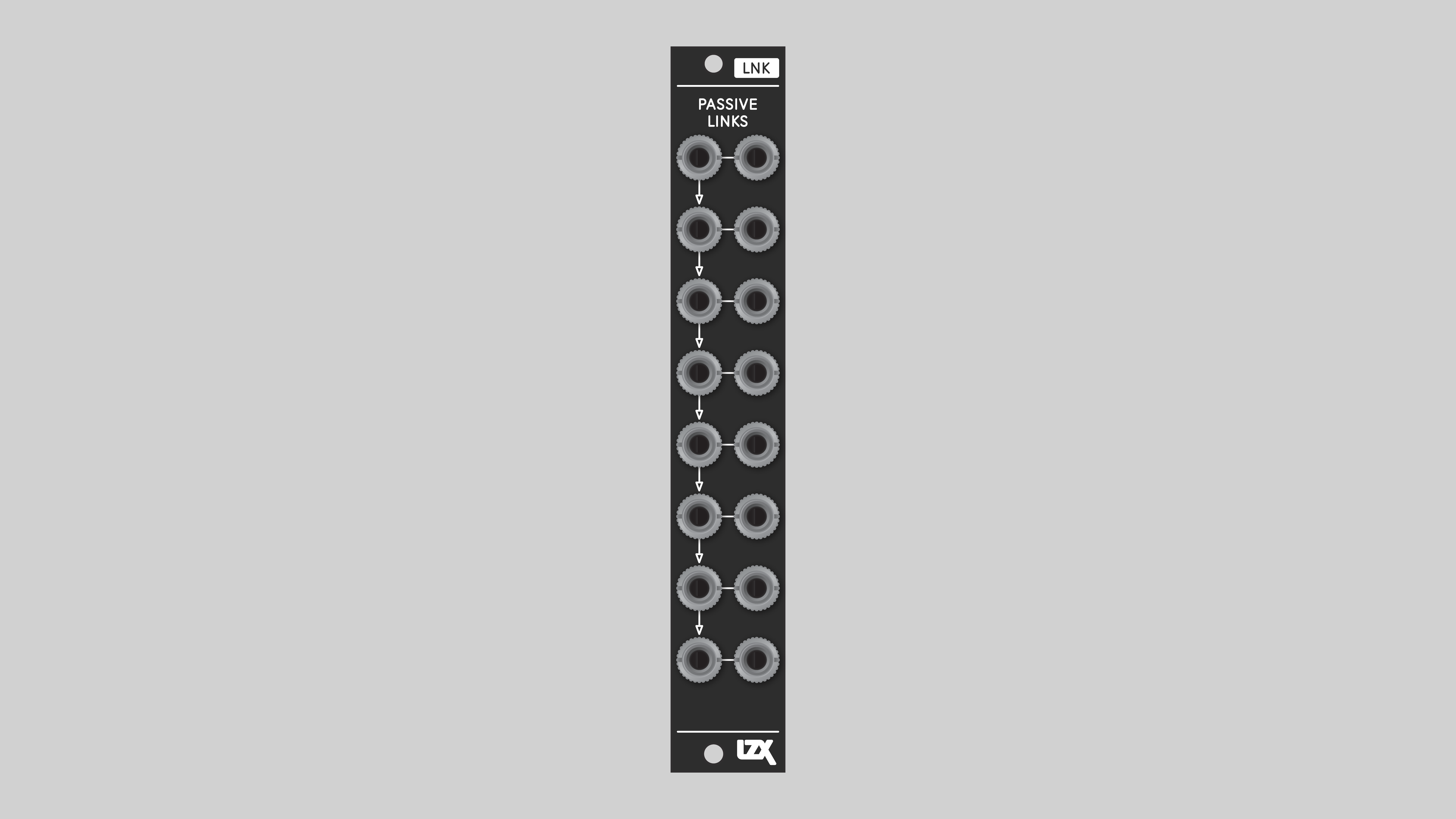

lnk_front_panel

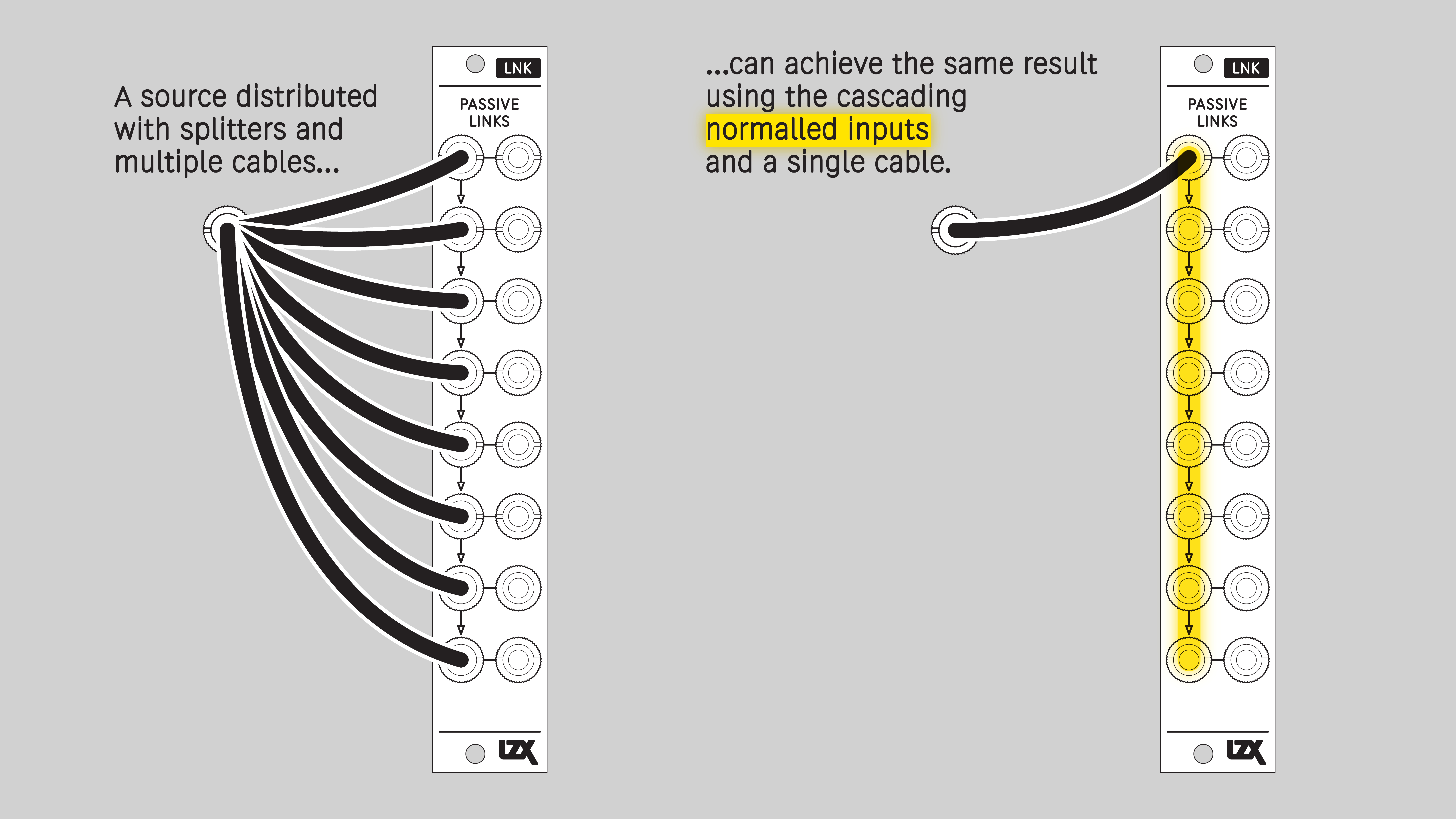

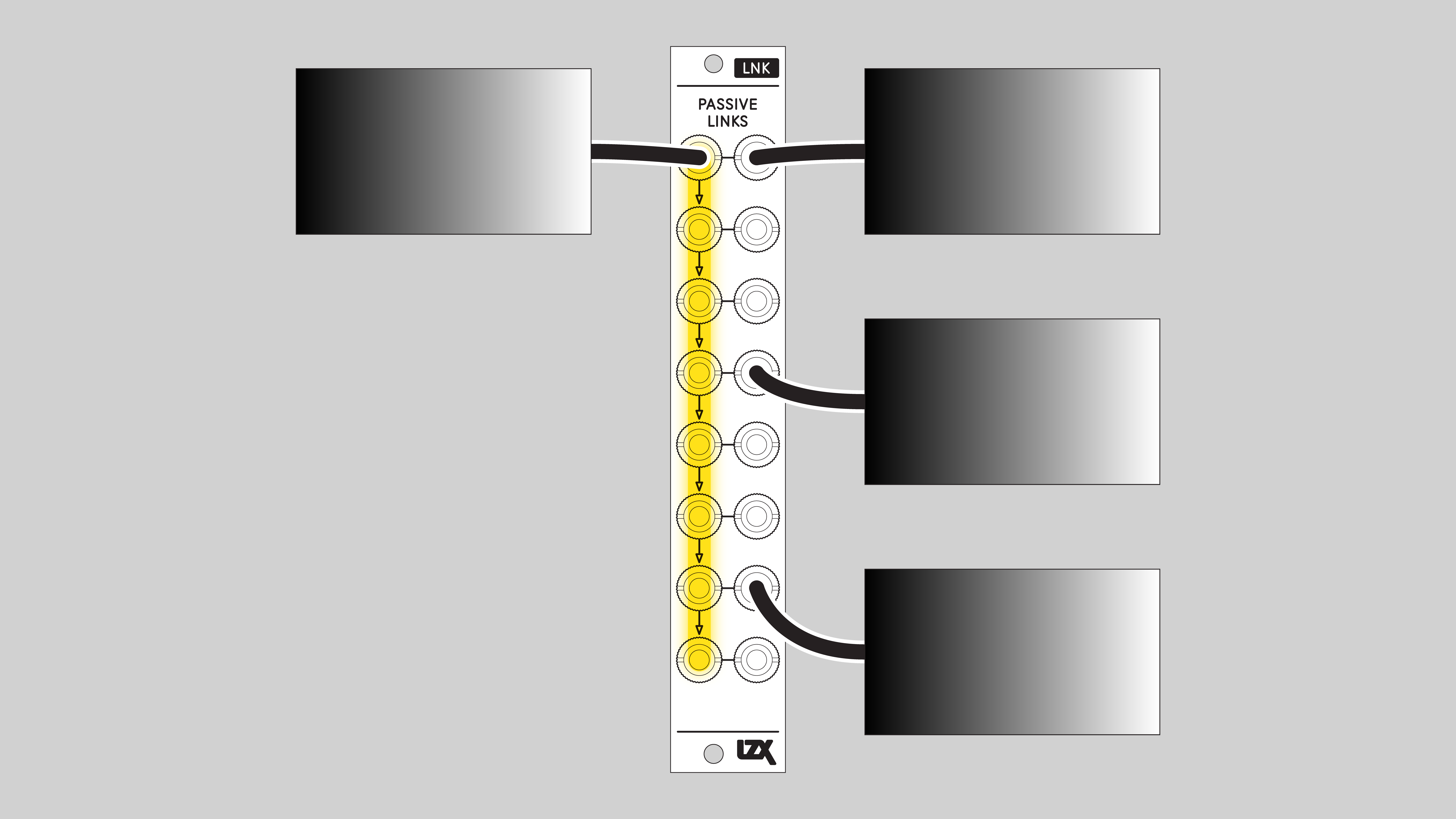

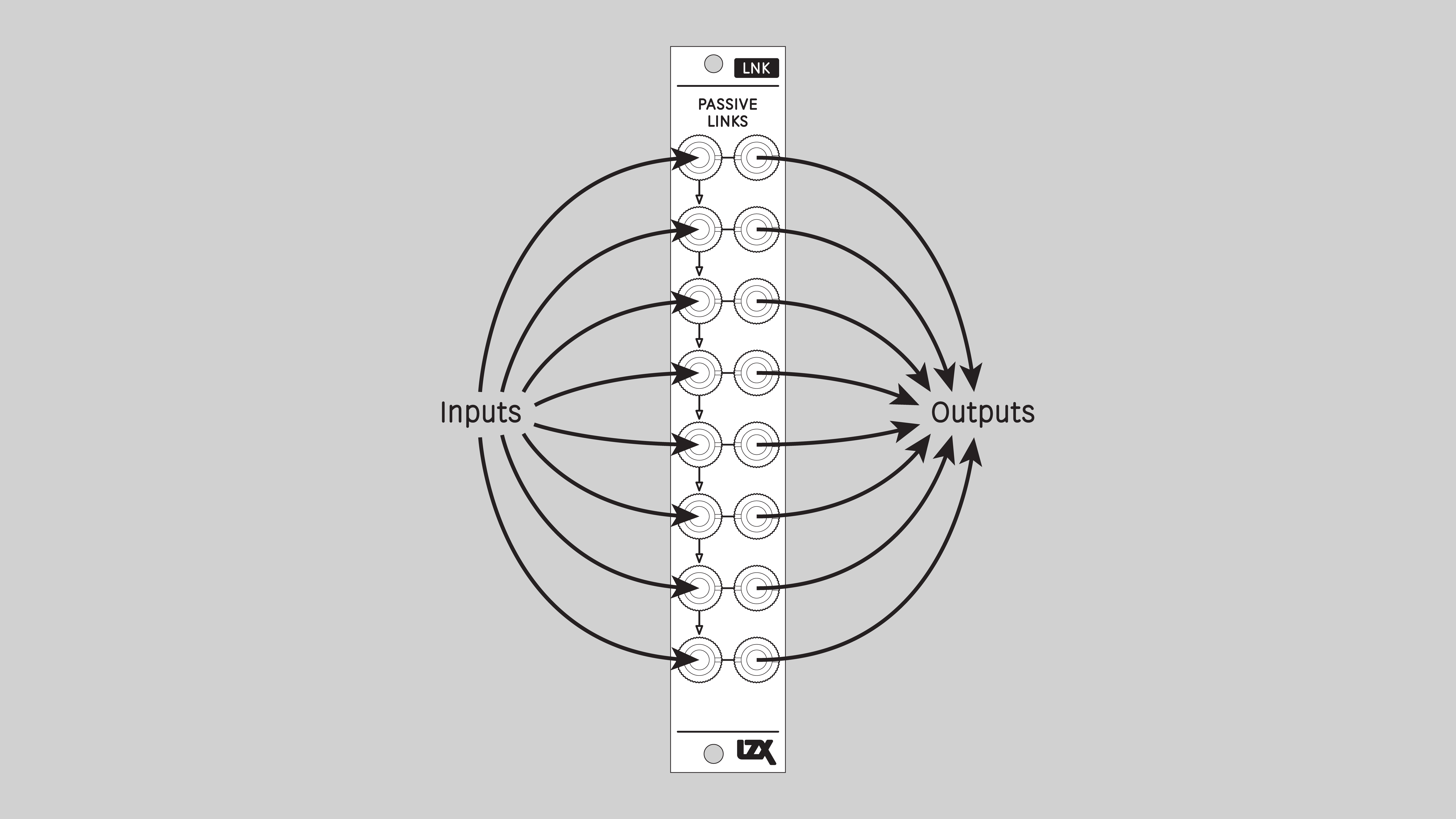

Understanding Cascading Input Jacks
LNK uses switched, or normalled, connections between its input jacks. With no cable inserted, a signal flows down from one input jack to another. This connection is overridden when a cable is inserted. Normalled inputs are indicated on the front panel with arrows.

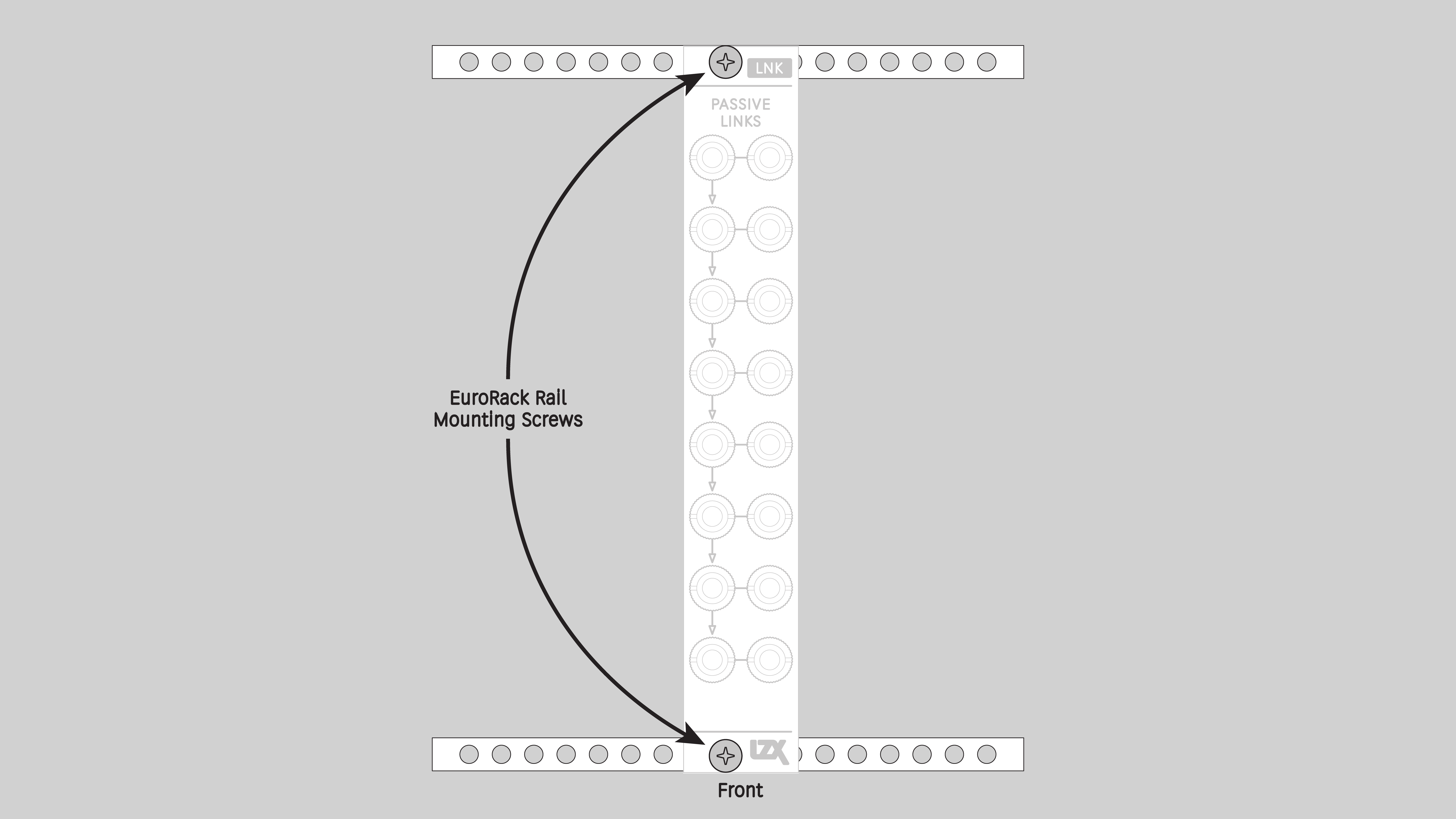

  • EuroRack enclosure.
  • Two M2.5 x 6mm mounting screws, or screws provided or specified by the enclosure manufacturer.
  • #1 Phillips head screwdriver, or hand tool provided or specified by the enclosure manufacturer.
Procedure
  • Carefully test fit the module in the open space in the EuroRack enclosure. If it is obstructed by the enclosure or any internal assemblies, abort this procedure.
