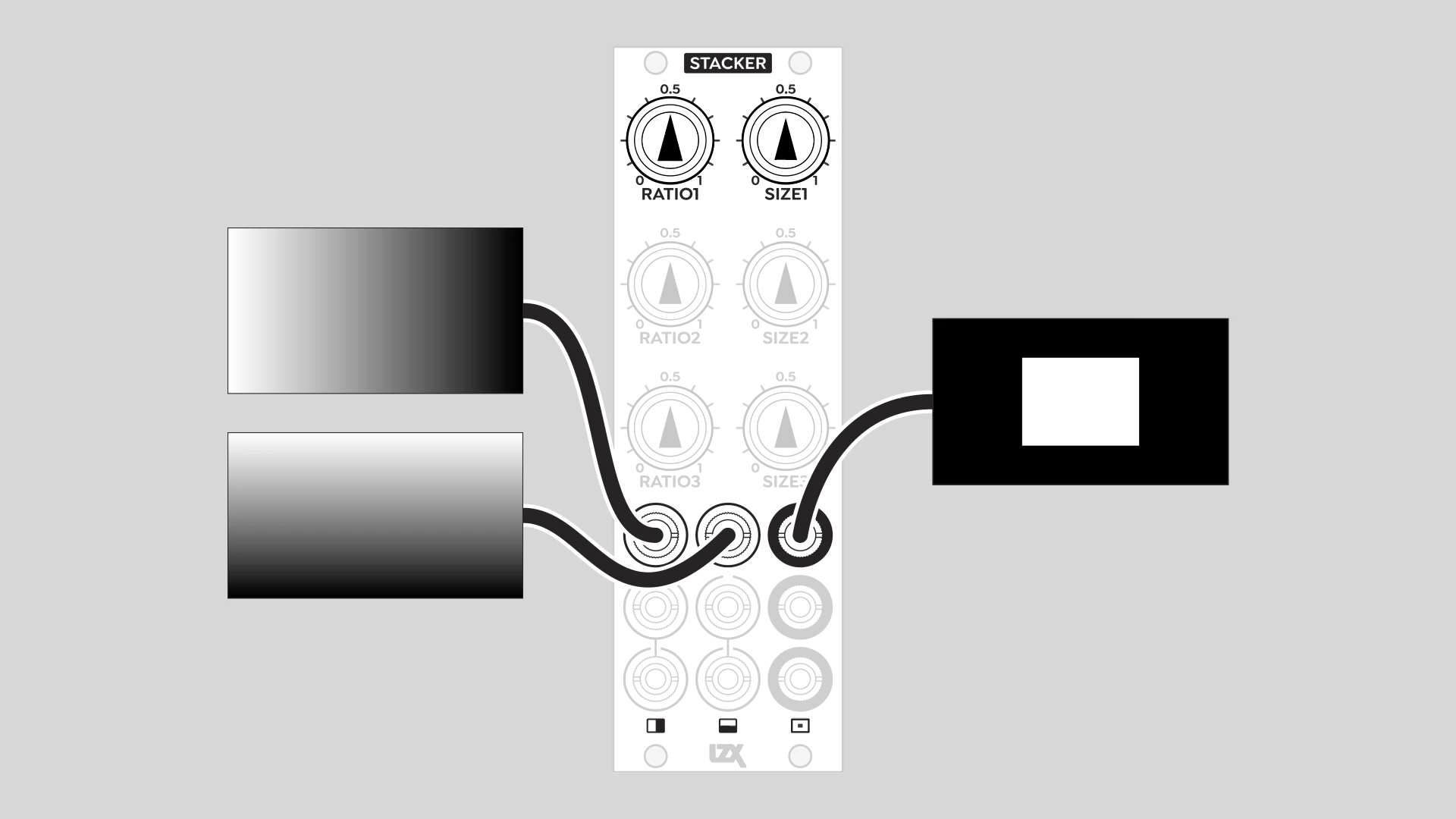

Each Stacker channel has two inputs, nominally horizontal and vertical waveforms. Each input's keyer has two thresholds, totaling four thresholds per channel. For a four-sided shape, these thresholds define the top, bottom, left, and right borders. Ratio and Size controls provide simultaneous, intuitive control of all four thresholds.

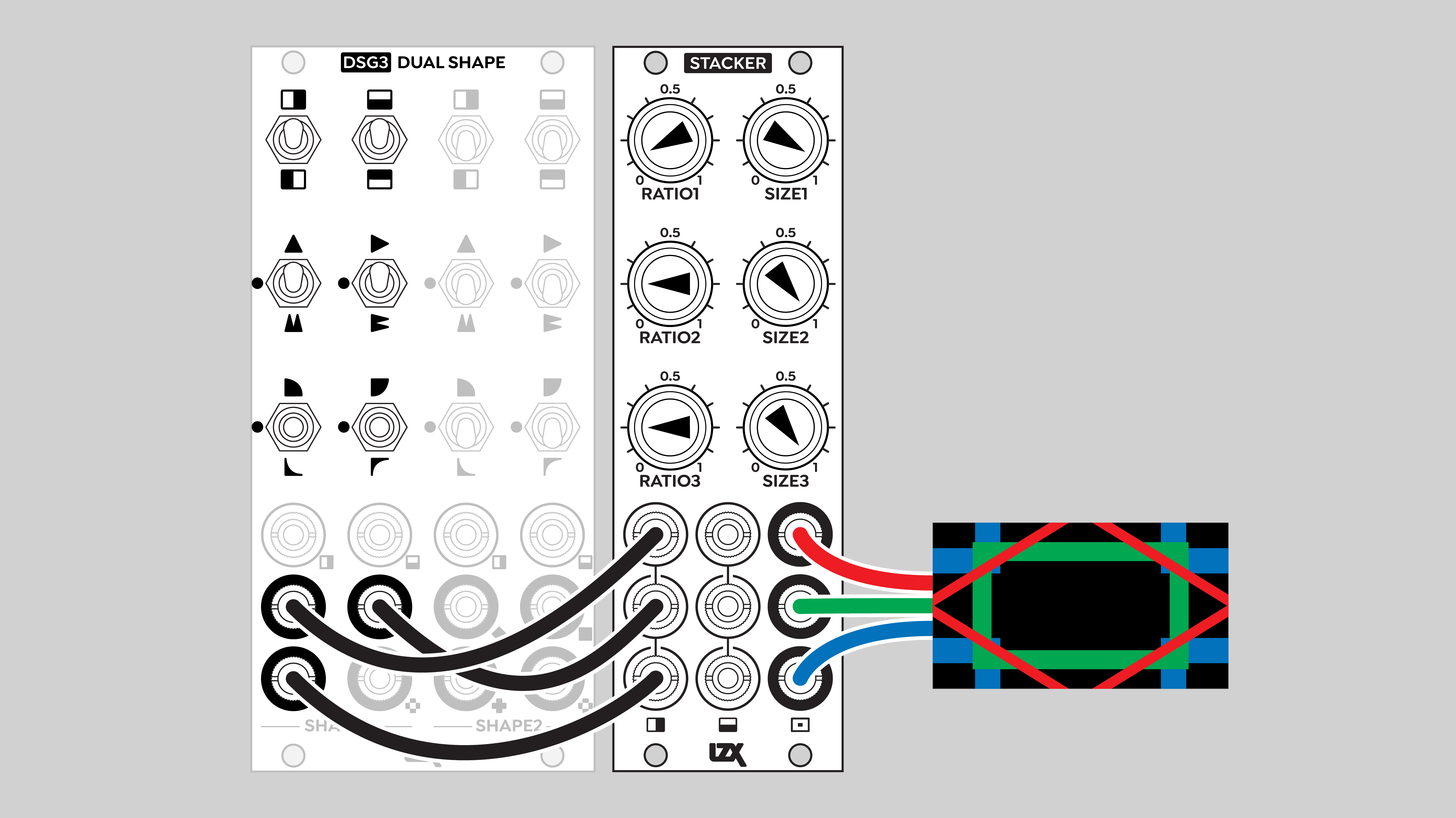

Pairs of complementary waveforms from DWO3, DSG3 or Angles result in three stacked, interlocking shapes. Or send complex images into Stacker to separate and composite different value ranges. Extract specific details from video images, gradients, precomposed patterns, etc. to construct more complex imagery.

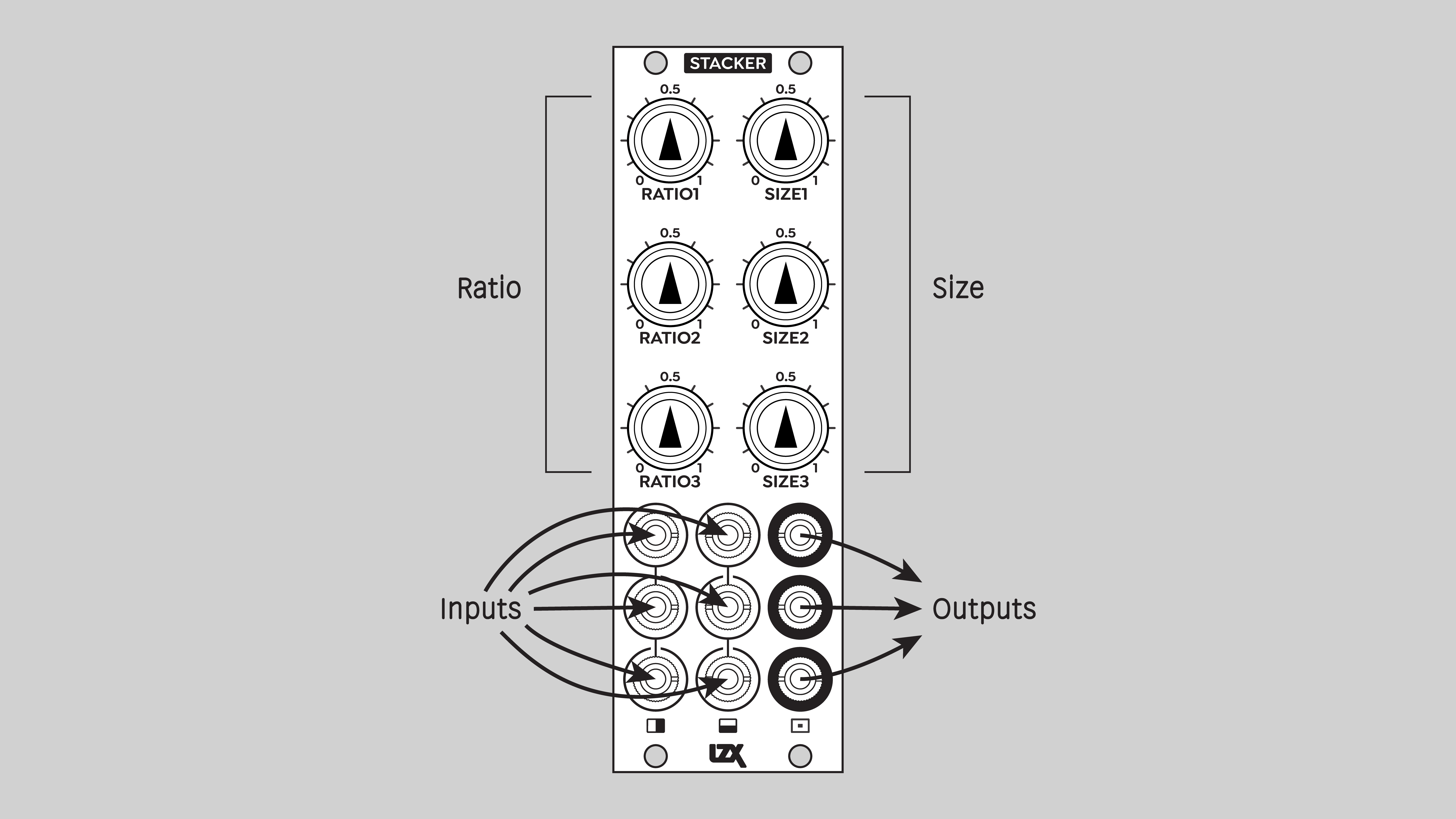

Controls & Connectors
Stacker has independent three channels, 1, 2, and 3. Each channel has two inputs, H and V, indicated by horizontal and vertical icons. Just like DSG3, the inputs are labeled with the assumption of horizontal and vertical waveforms, but this is merely a suggestion. You can plug whatever you want into the inputs, including various gradients, video images, and low frequency control signals.
Each channel has two potentiometer knobs, Ratio and Size. These knobs provide quick and easy adjustment of the four thresholds of each channel's window key generator. Ratio adjusts the shape of the window, Size adjusts the scale.
Stacker controls and connections

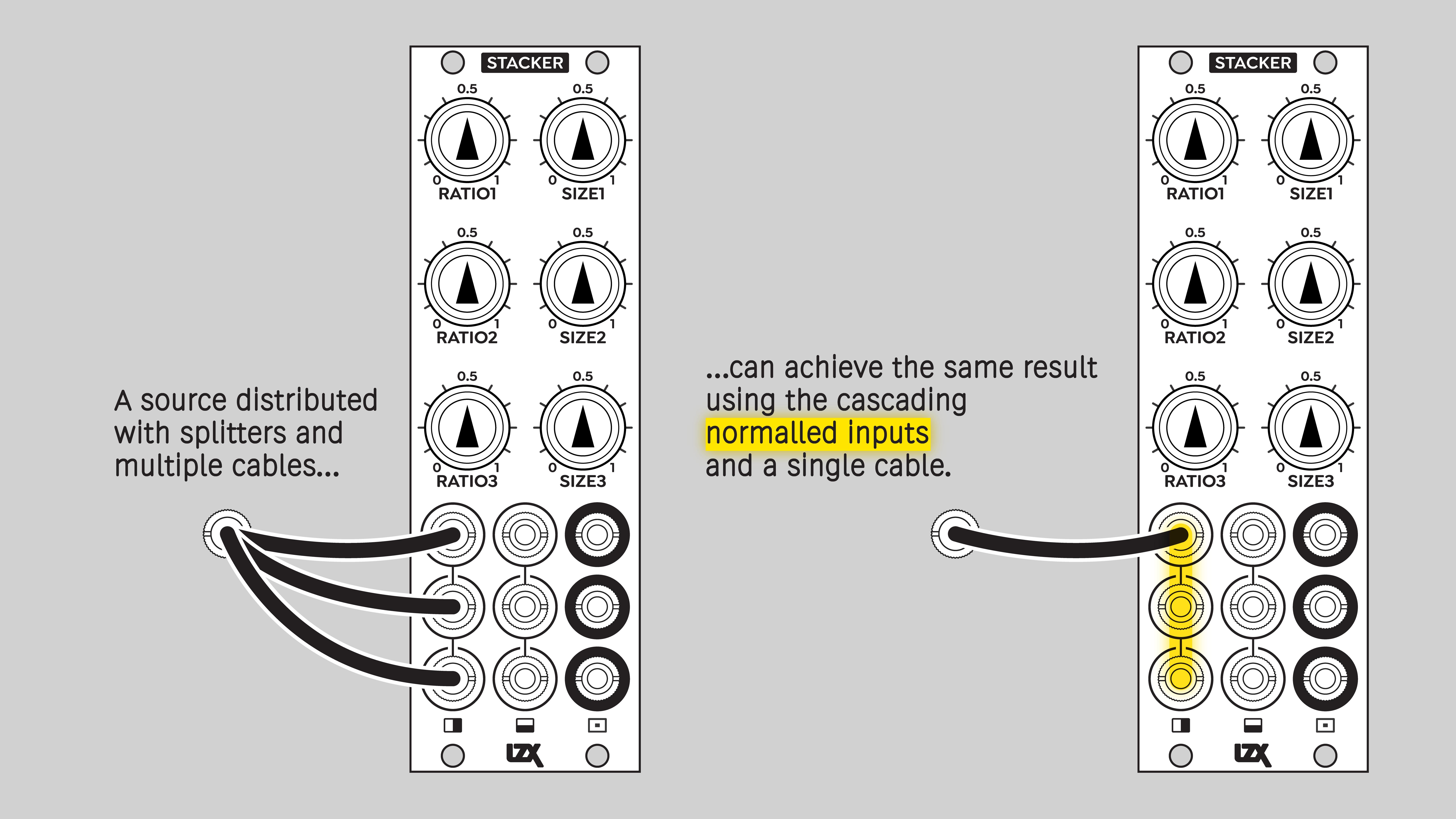

Each set of inputs is internally normalled in series from top to bottom. A signal sent to a top row input will flow to all three channels unless another signal is patched to interrupt the normalling.
Stacker normalled connections

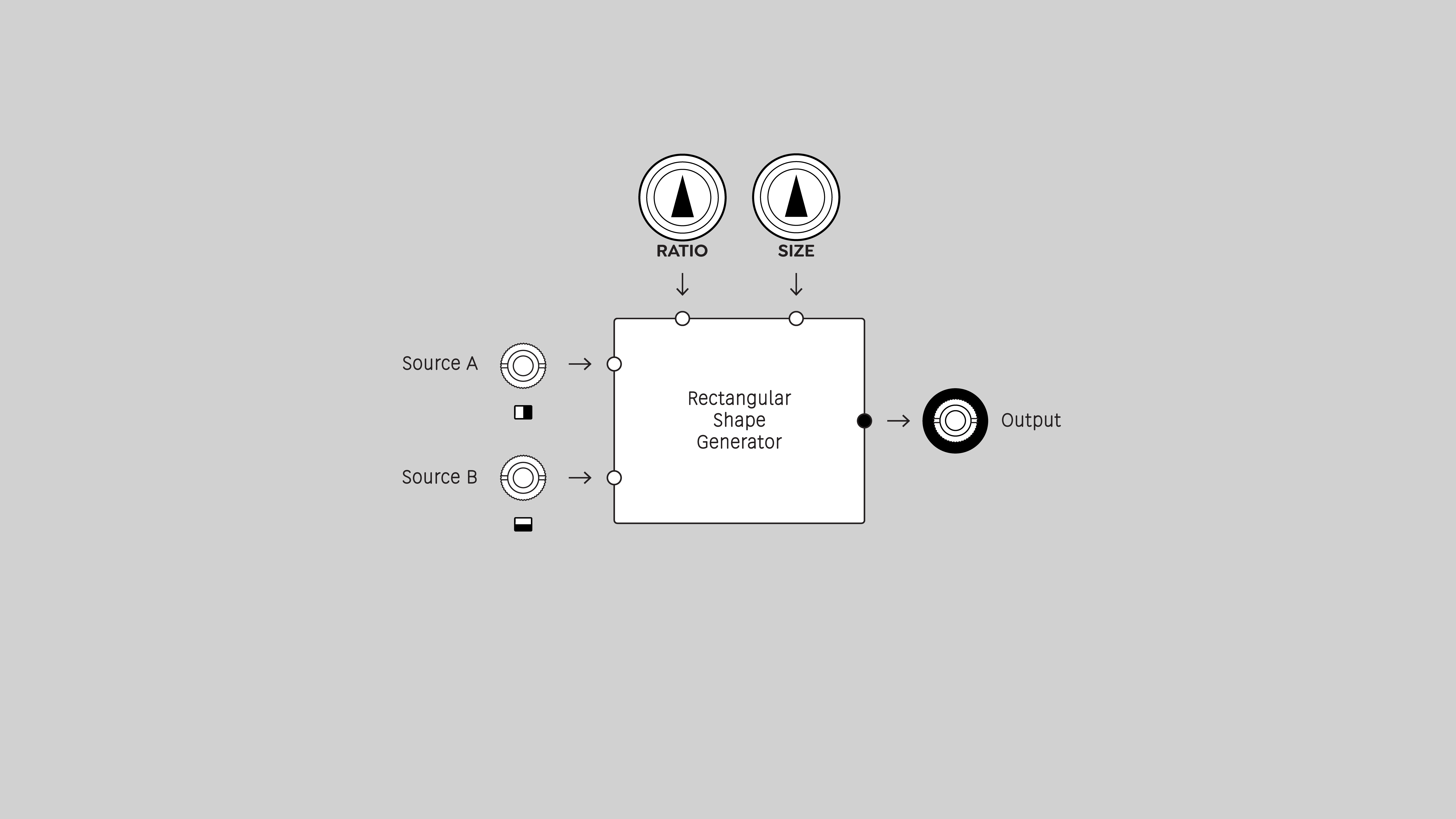

Per channel, the H and V inputs are processed according to the states of the Ratio and Size potentiometers, resulting in an intersection of two window keys.
Both Ratio and Size knobs affect all four thresholds per channel. The adjustments are symmetrical, centered on a voltage of 0.5, or middle gray. For each input, the two threshold values are equally different from the center reference point. The high threshold is above 0.5 and the low threshold is below 0.5 by the same amount.
The Ratio knob adjusts the shape of the window. It sets thresholds for the two inputs in inverse proportion. As the H window size increases, the V window size decreases. This changes the window's aspect ratio. At extreme settings, only one of the two inputs is applied.
The Size knob adjusts the thresholds for the two inputs equally. Both windows increase or decrease proportionally, according to the interaction with the Ratio parameter. This preserves the shape of the window.
Stacker ratio and size controls

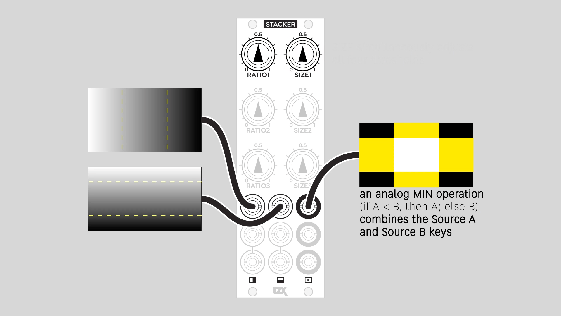

Minimum / Logical AND
To create the full window, the results of the H and V window keys are composited with a mathematical Minimum operation. The lower of the two key values takes priority. Geometrically, this is the intersection, or overlapping area. And since the key signals are binary, this is also a Boolean logic AND operation. To output a value of one, both H and V keyers must have a value of one.
min{H,V}\min\{H, V\} HVH \cap V HVH \land V If H<V, then H, else V\text{If } H < V, \text{ then } H, \text{ else } V Stacker ratio and size operations
Because the output of each channel is the minimum value of its H and V inputs, if nothing is patched into one of those inputs, the output will be black.

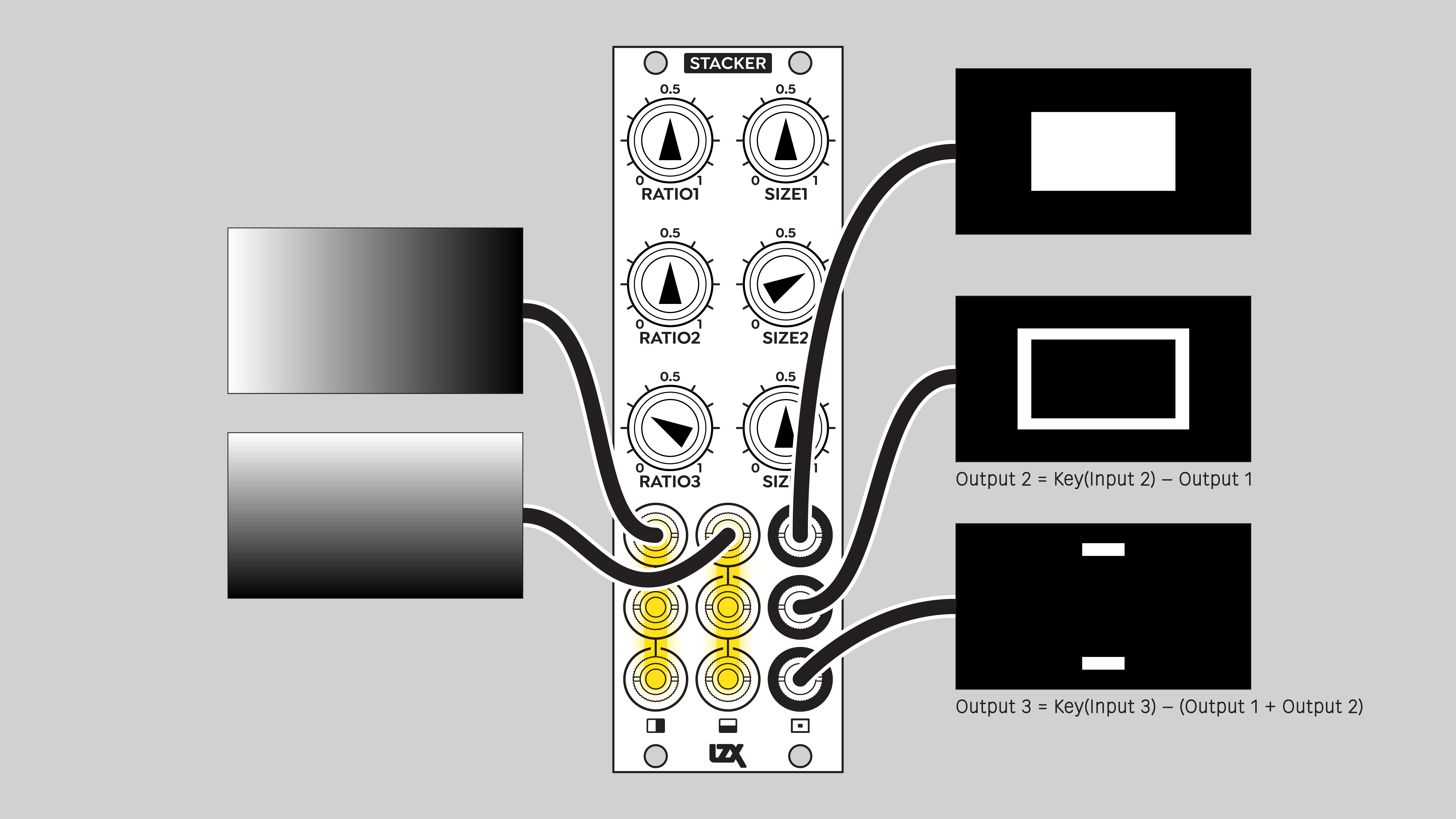

Layer Subtraction
The channel outputs are also internally connected in series, from top to bottom. Each output subtracts the ones above it, resulting in complementary keys that "knock out" the other channels. The resulting shapes never overlap or blend in any way. Stacker is a multi-stage one-bit compositor, not a mixer.
out 1=keyer 1\text{out 1} = \text{keyer 1} out 2=keyer 2out 1\text{out 2} = \text{keyer 2} - \text{out 1} out 3=keyer 3(out 1+out 2)\text{out 3} = \text{keyer 3} - (\text{out 1} + \text{out 2}) Stacker channel compositing

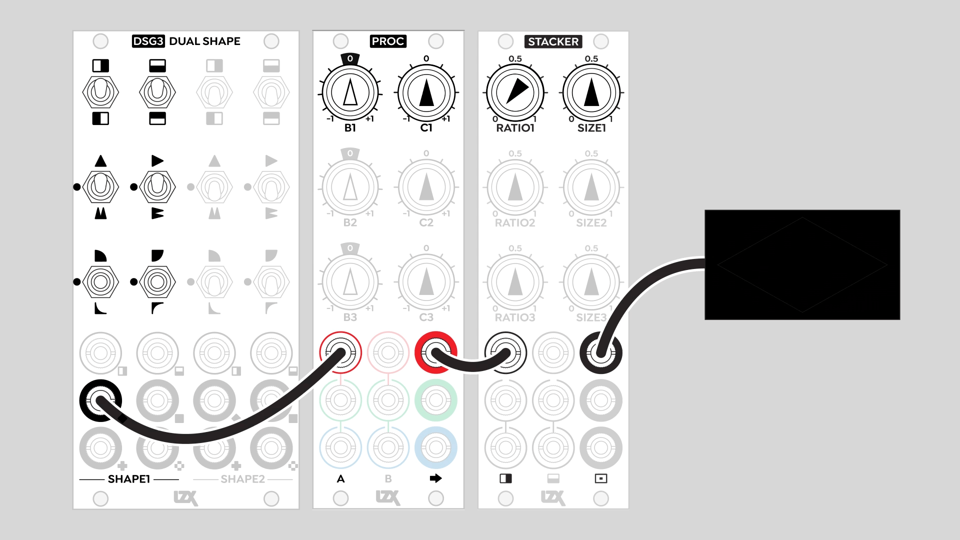

If you're not able to isolate the value range you want, then bias the signal up or down before sending it to Stacker. The ideal module for this is Proc.

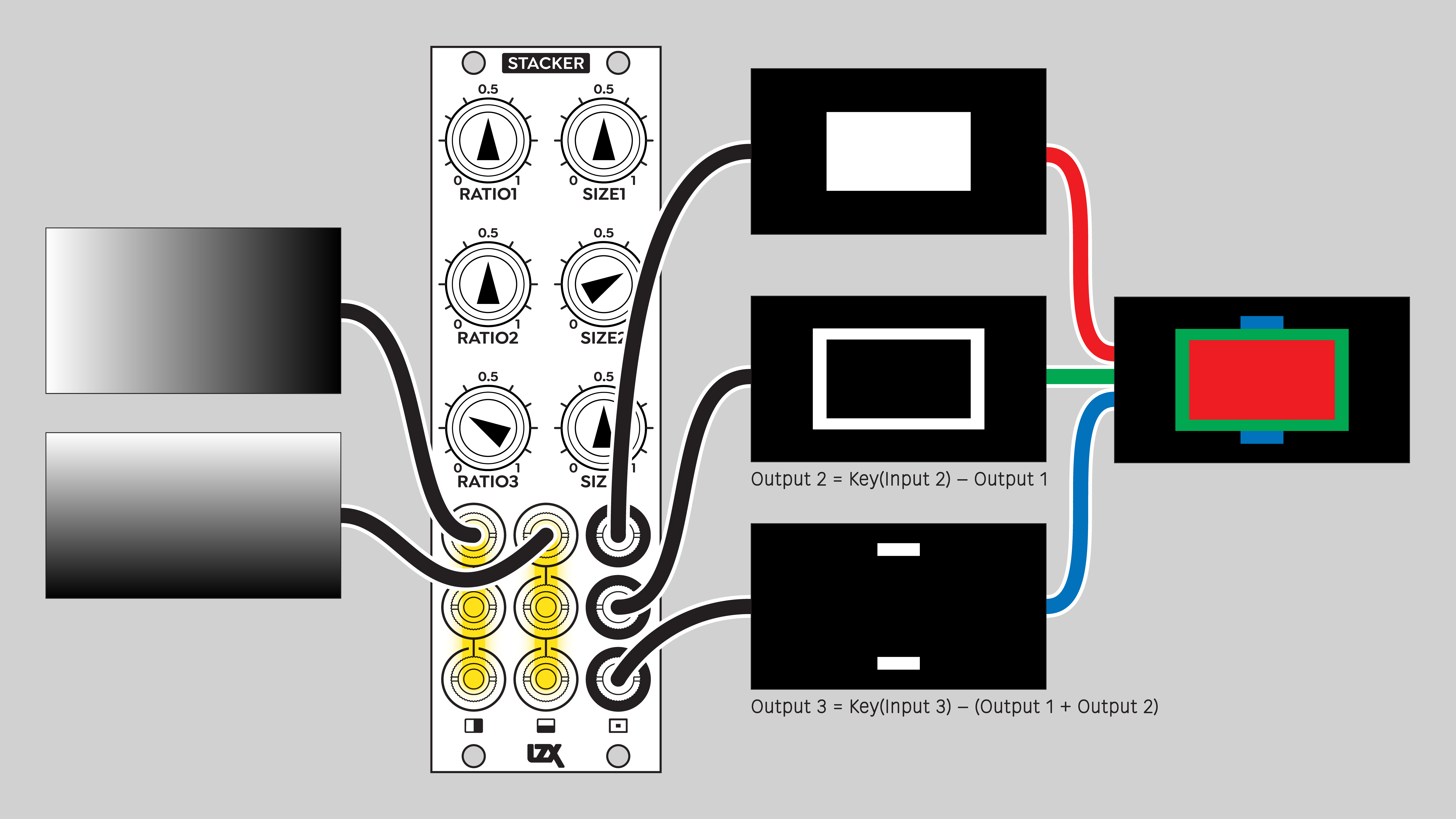

Priority Layering
{/* Stacker patch: priority layering */}

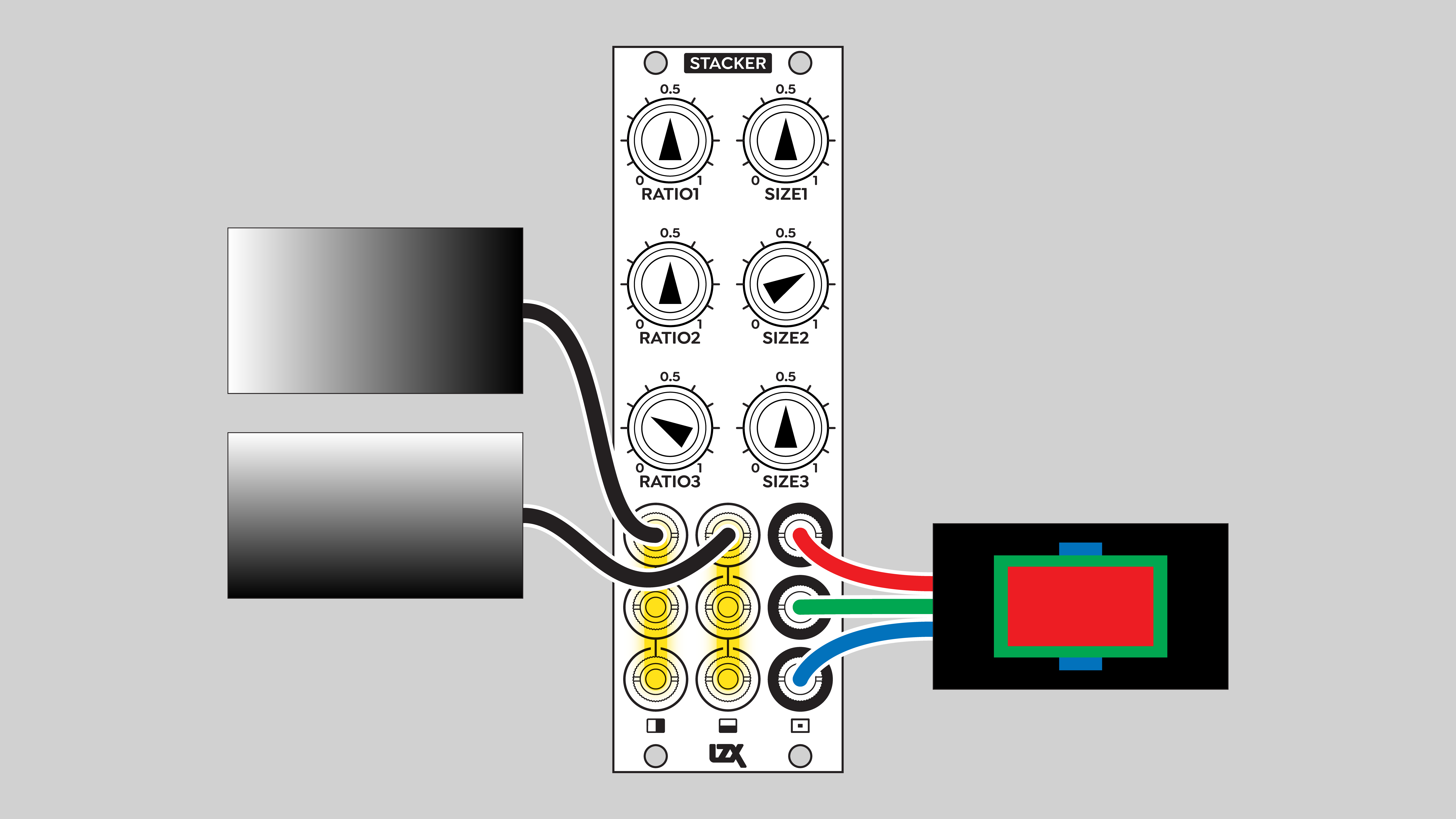

Shape Outlines
Stacker patch: DSG3 & Proc
Complementary Analog Logic
Stacker patch: three outputs of DSG3

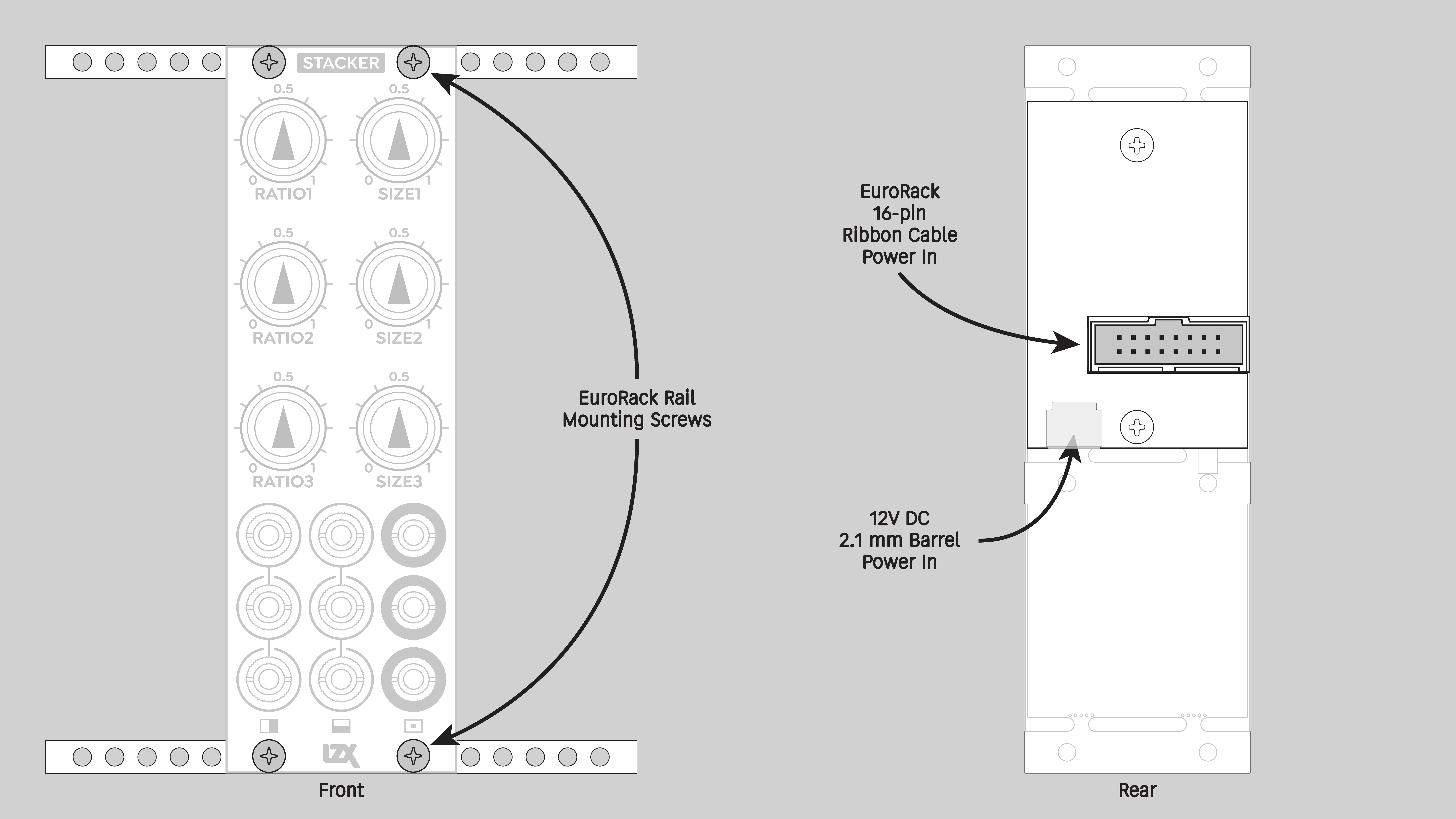

Installation
Stacker installation
Requirements
  • EuroRack enclosure

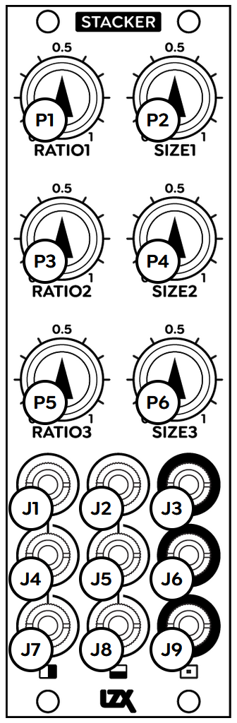

 ConnectorsControls
Stacker: labeled front panel controls
JackFunction
J1H1 in
J2V1 in
J3Channel 1 out
J4H2 in
J5V2 in
J6Channel 2 out
J7H3 in
J8B3 in
J9Channel 3 out
PotentiometerFunction
P1Ratio 1
P2Size 1
P3Ratio 2
P4Size 2
P5Ratio 3
P6Size 3
