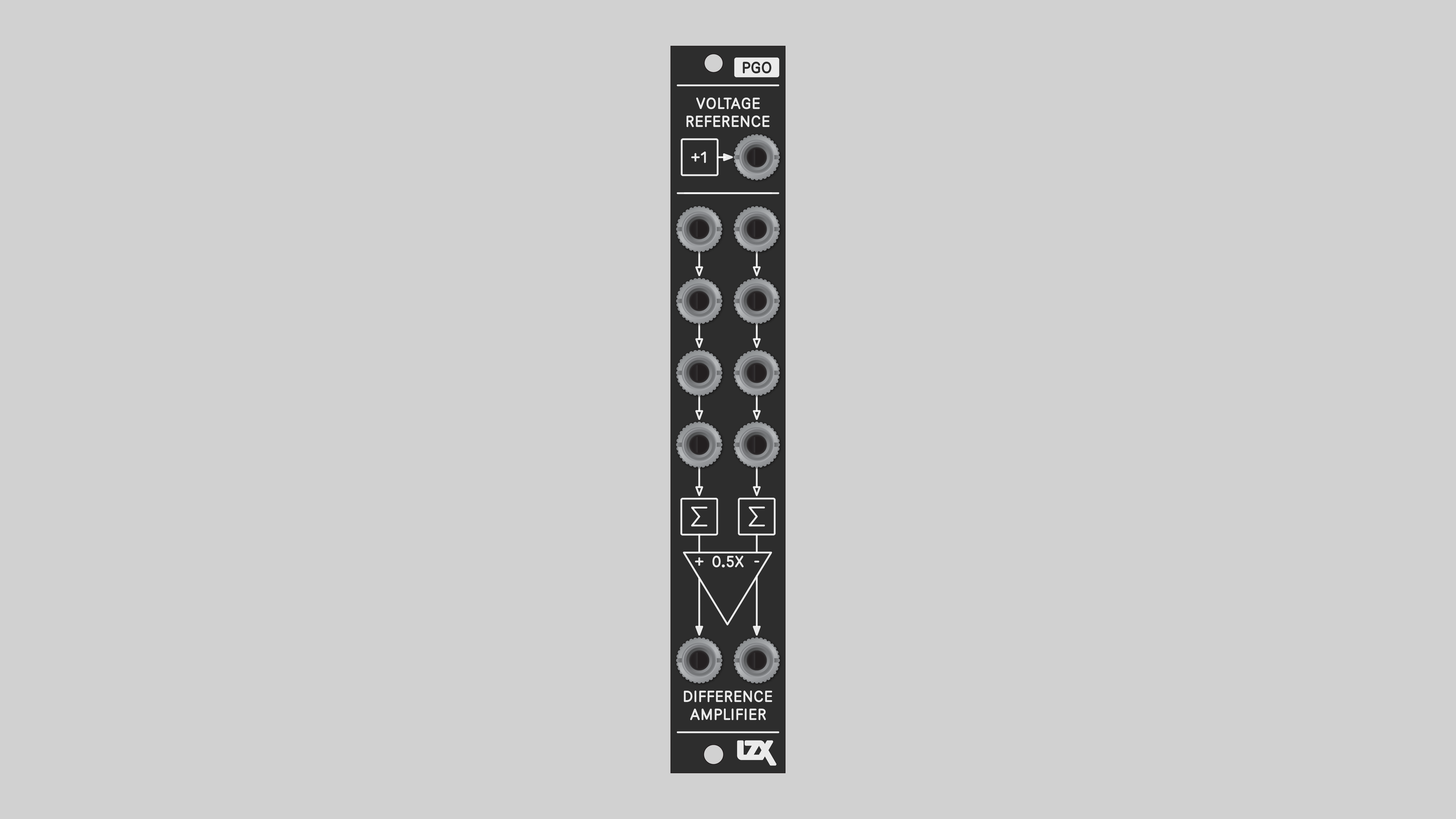

Front Panel Options
PGO ships with a black front panel installed. Red, green and blue panels are also included.
All PGO front panels
All front panels are printed on both sides, allowing a choice of top-to-bottom or bottom-to-top signal flow. This gives great flexibility in designing modular systems.

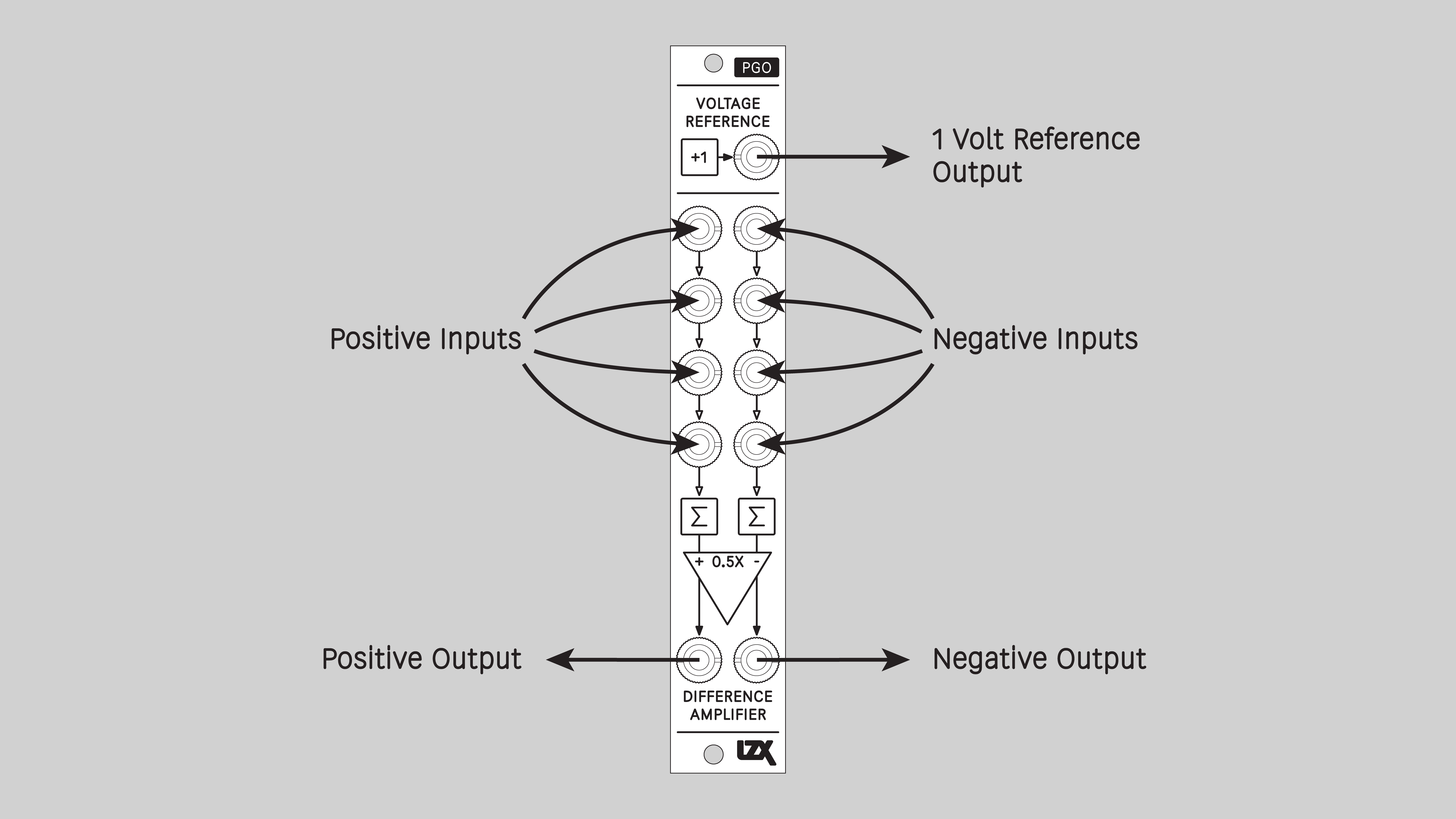

Connectors
The PGO design was informed by years of studying interfaces common to the building blocks of analog computers and video processing equipment.
Controls Connectors And Indicators

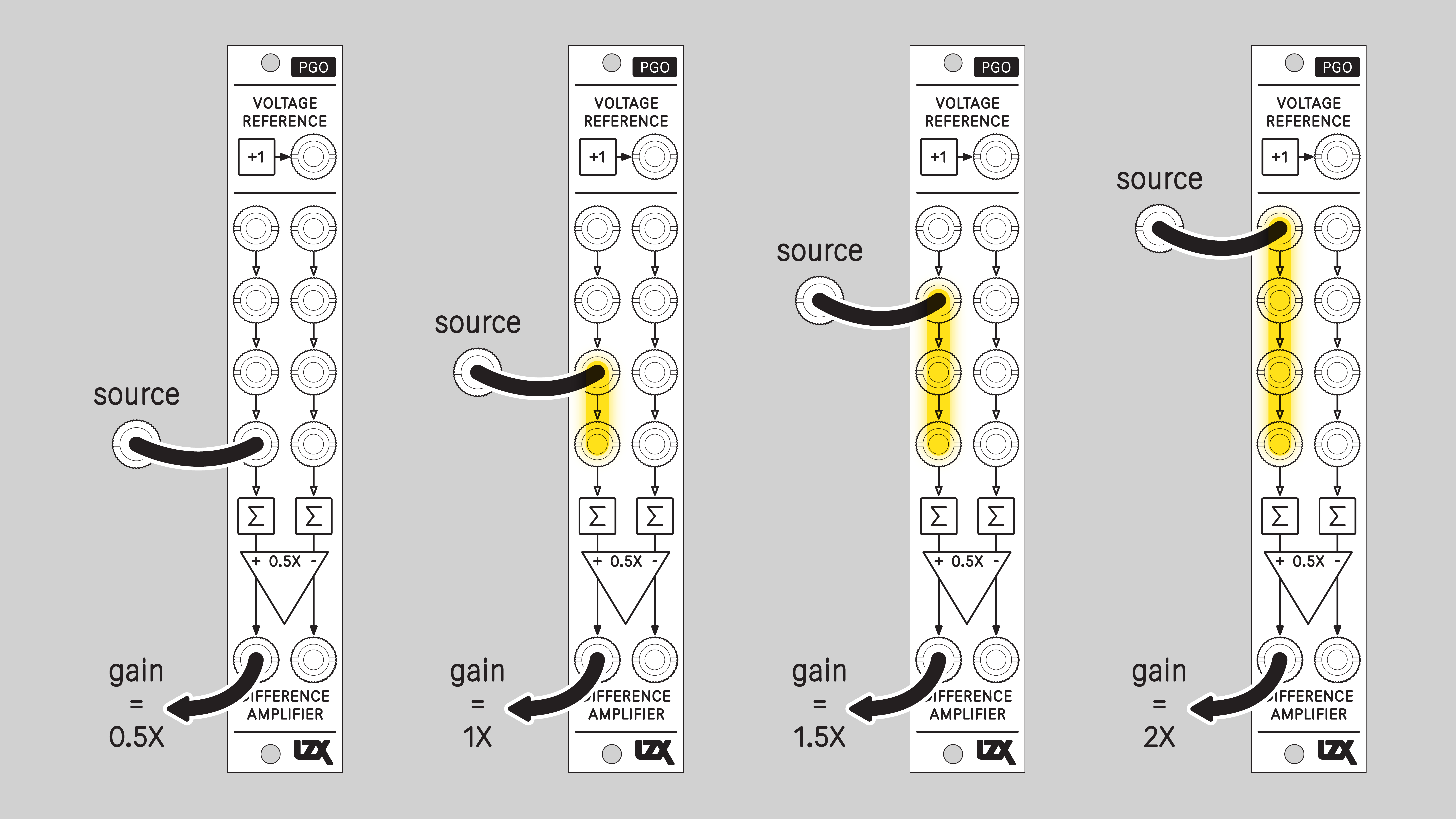

PGO is a patch-programmable operator. Its overall function is determined by patch connections rather than switch positions or variable voltages. Connections to specific input and output jacks define operations at different mixing ratios and amounts of gain.

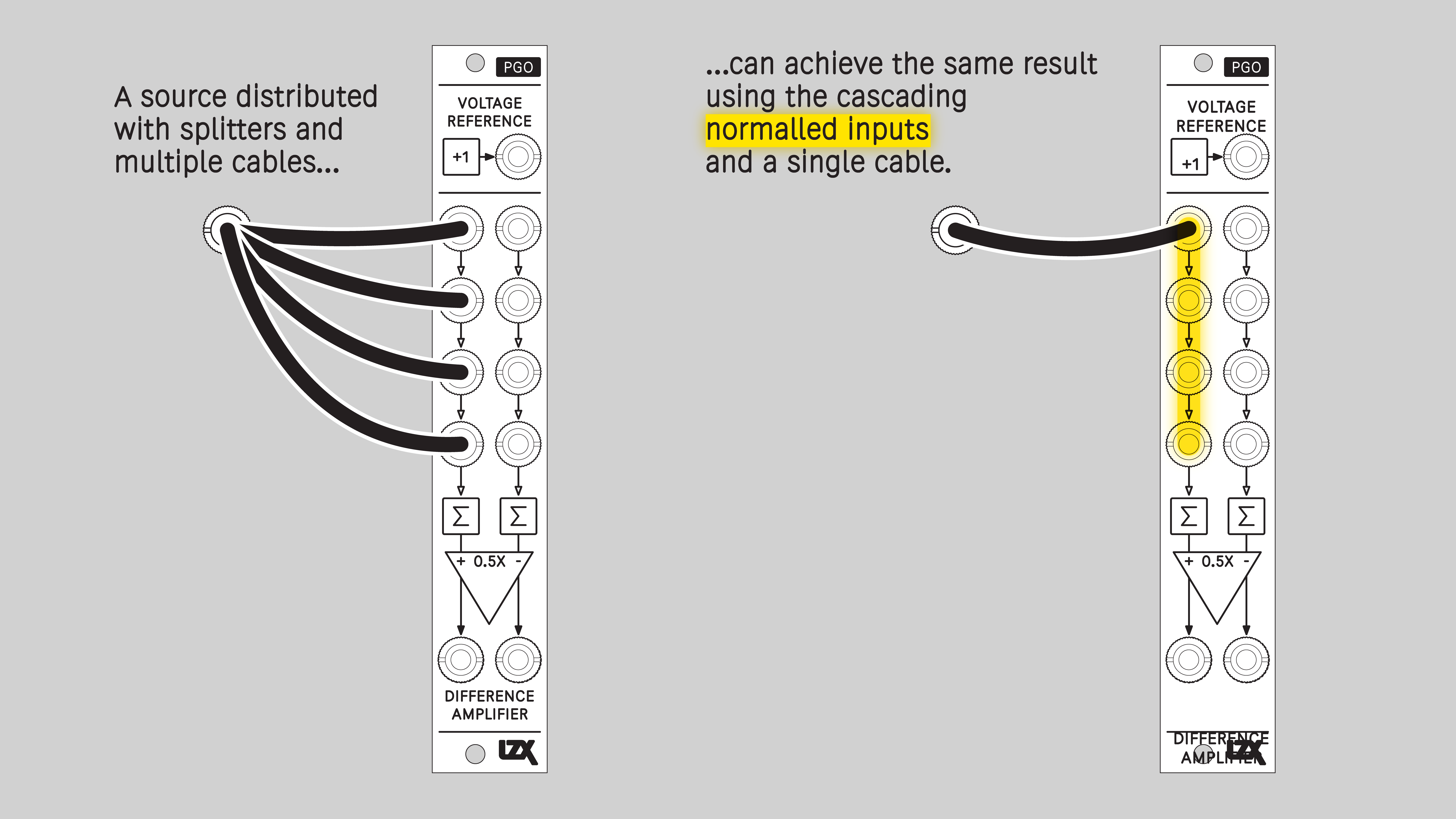

Understanding Cascading Input Jacks
PGO uses switched, or normalled, connections between some of its input jacks. With no cable inserted, a signal flows from one input jack to another. This connection is overridden when a cable is inserted. Normalled inputs are indicated on the front panel with arrows.
Normalled Connections

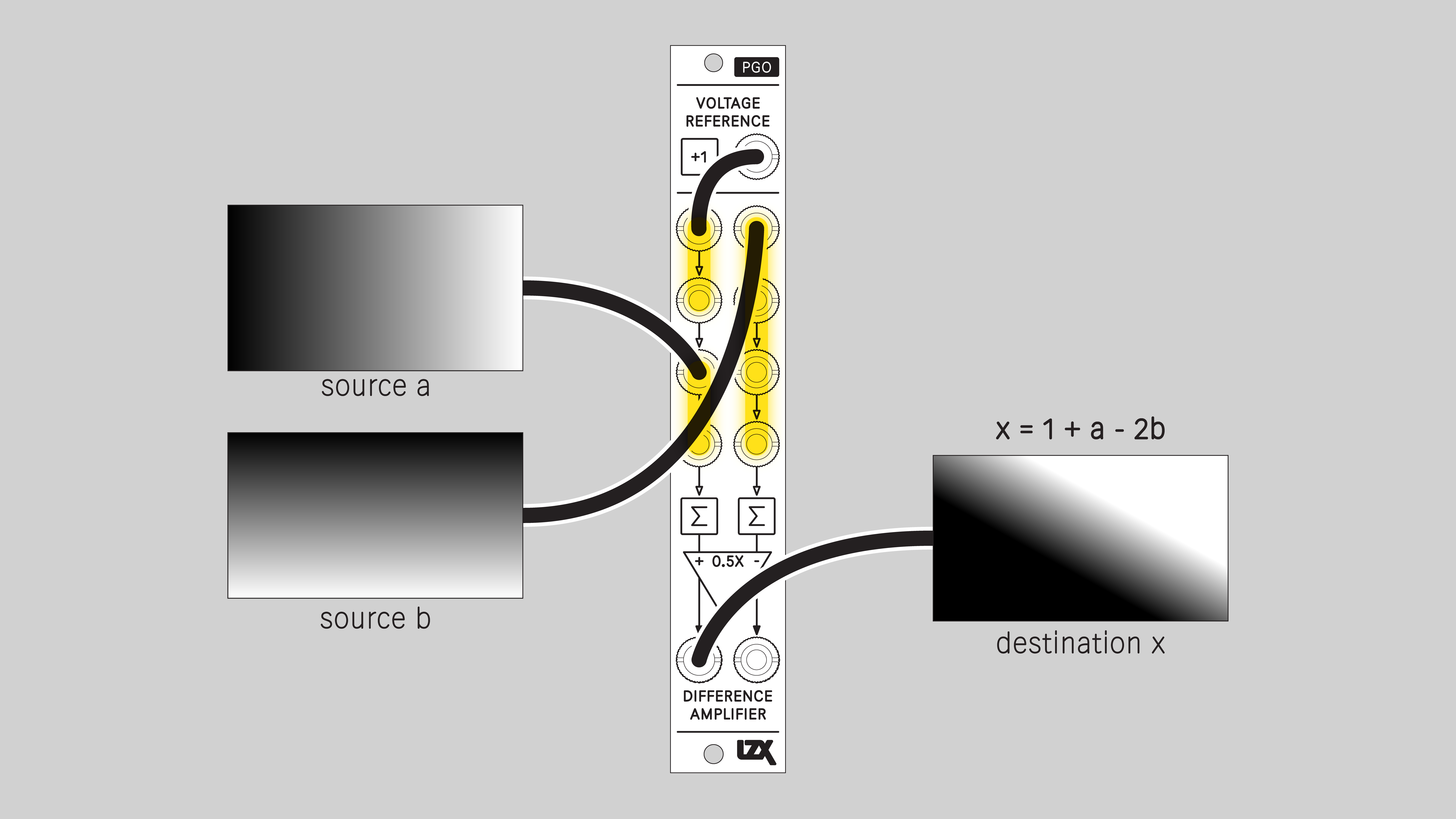

Difference Amplifier
A difference amplifier subtracts one voltage from another. It is similar to a differential amplifier, but is specifically optimized to subtract one voltage from another with accuracy.  PGO's amplifier is fully differential, meaning that it has both positive and negative outputs.
In PGO's implementation, the positive input and negative input of the difference amplifier are each preceded by a four-input summing amplifier stage. This configuration allows the user to simultaneously add and subtract multiple signals. Due to the cascading input switches, the gain of each side of the difference amplifier may be programmed by which jacks are patched and which jacks are left open.
Programming Gain
Voltage Reference
PGO provides a static voltage reference of 1V at its output jack. This level corresponds to a luminance value of white, or to the 100% brightness level of an RGB channel. This reference voltage may be patched anywhere in your system, or to the inputs on PGO.

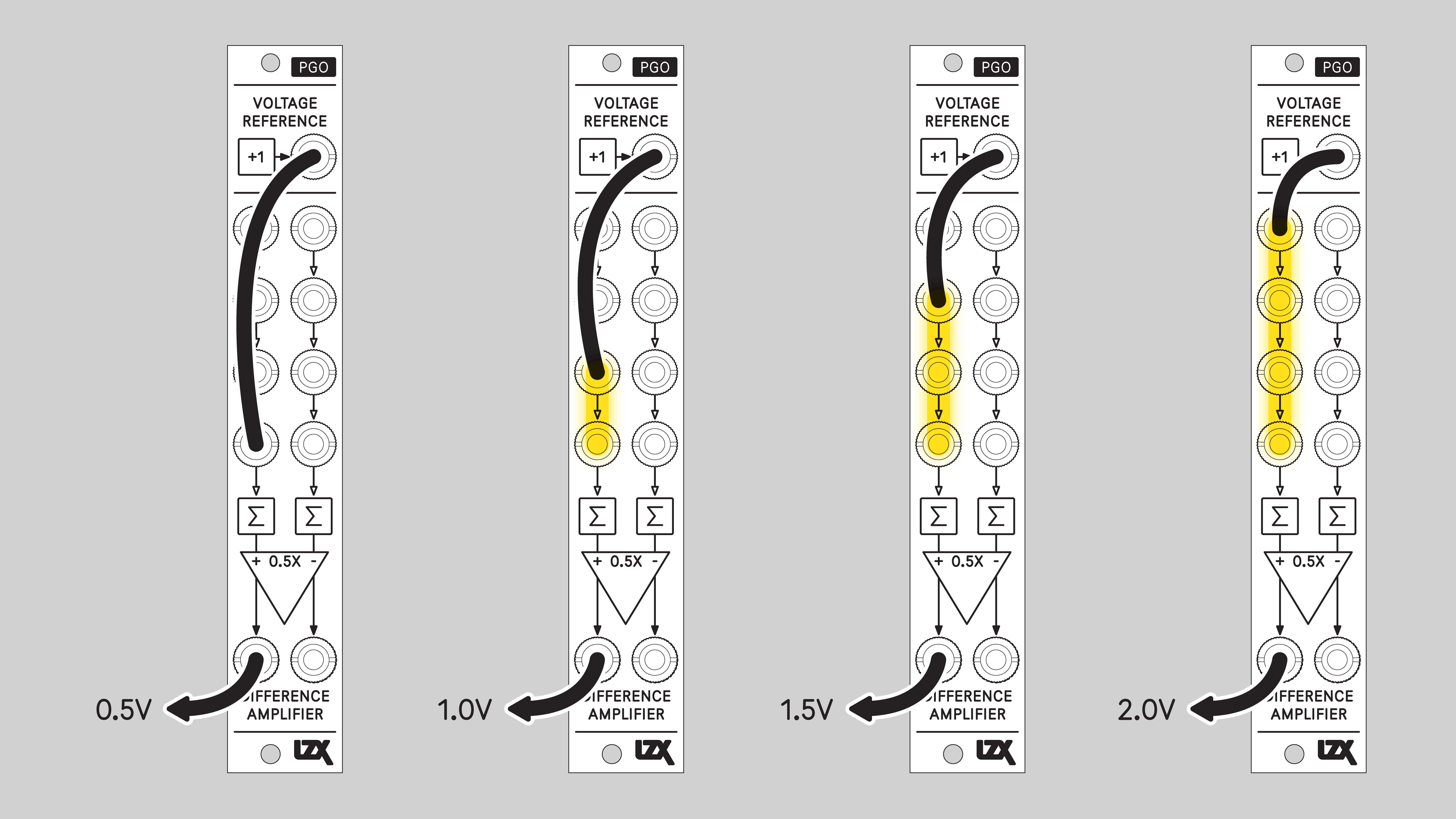

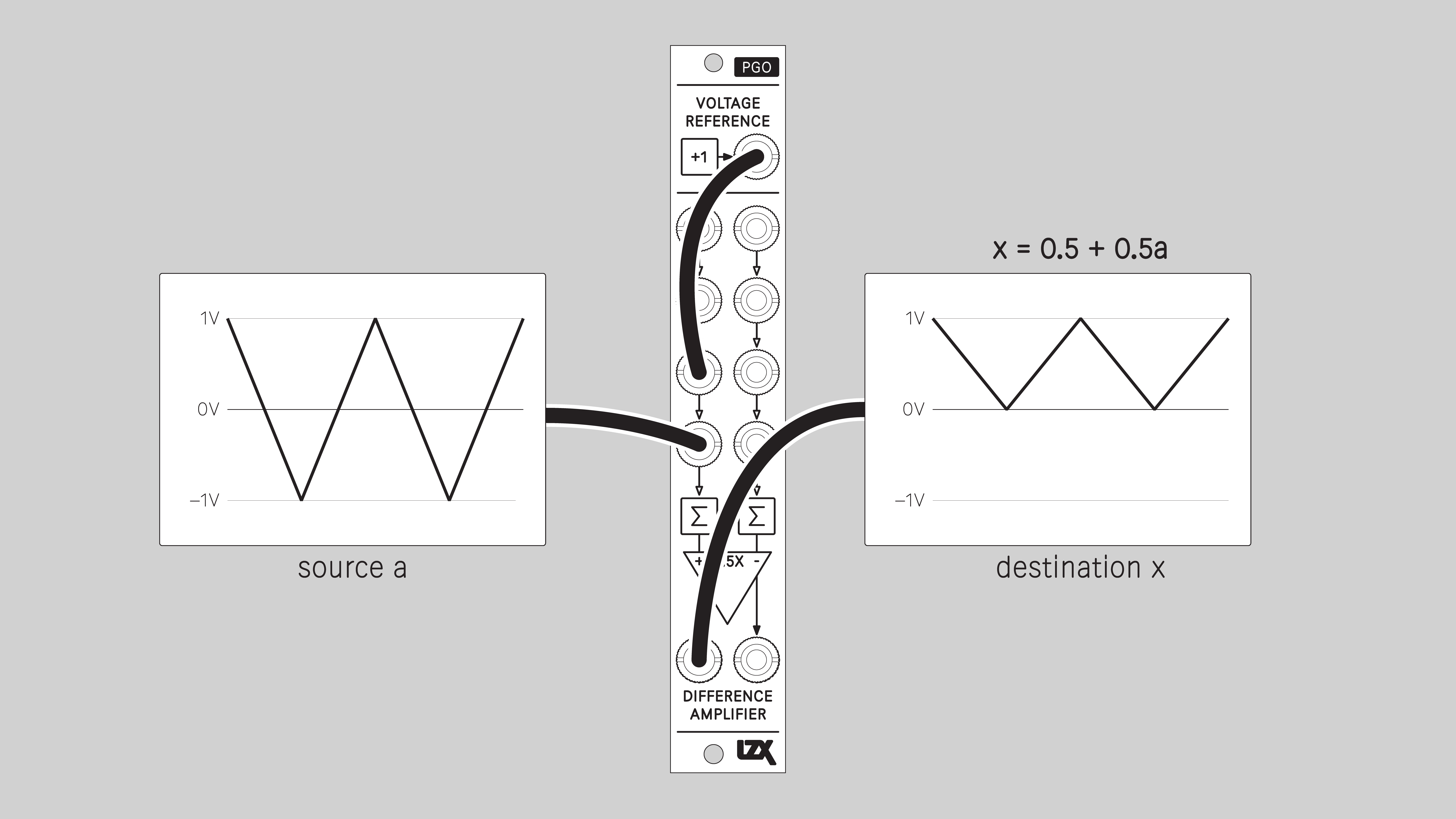

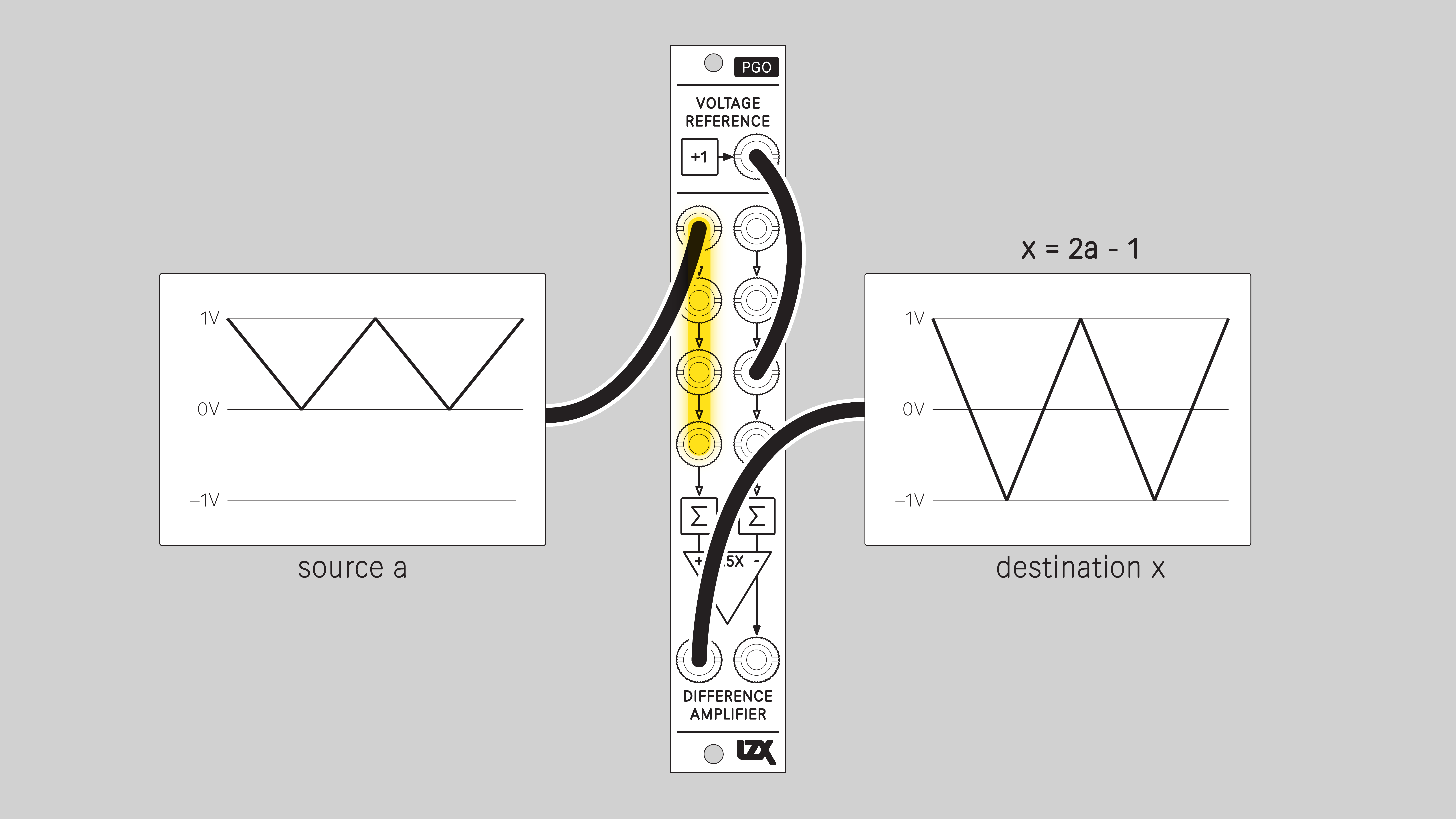

Programming Offset

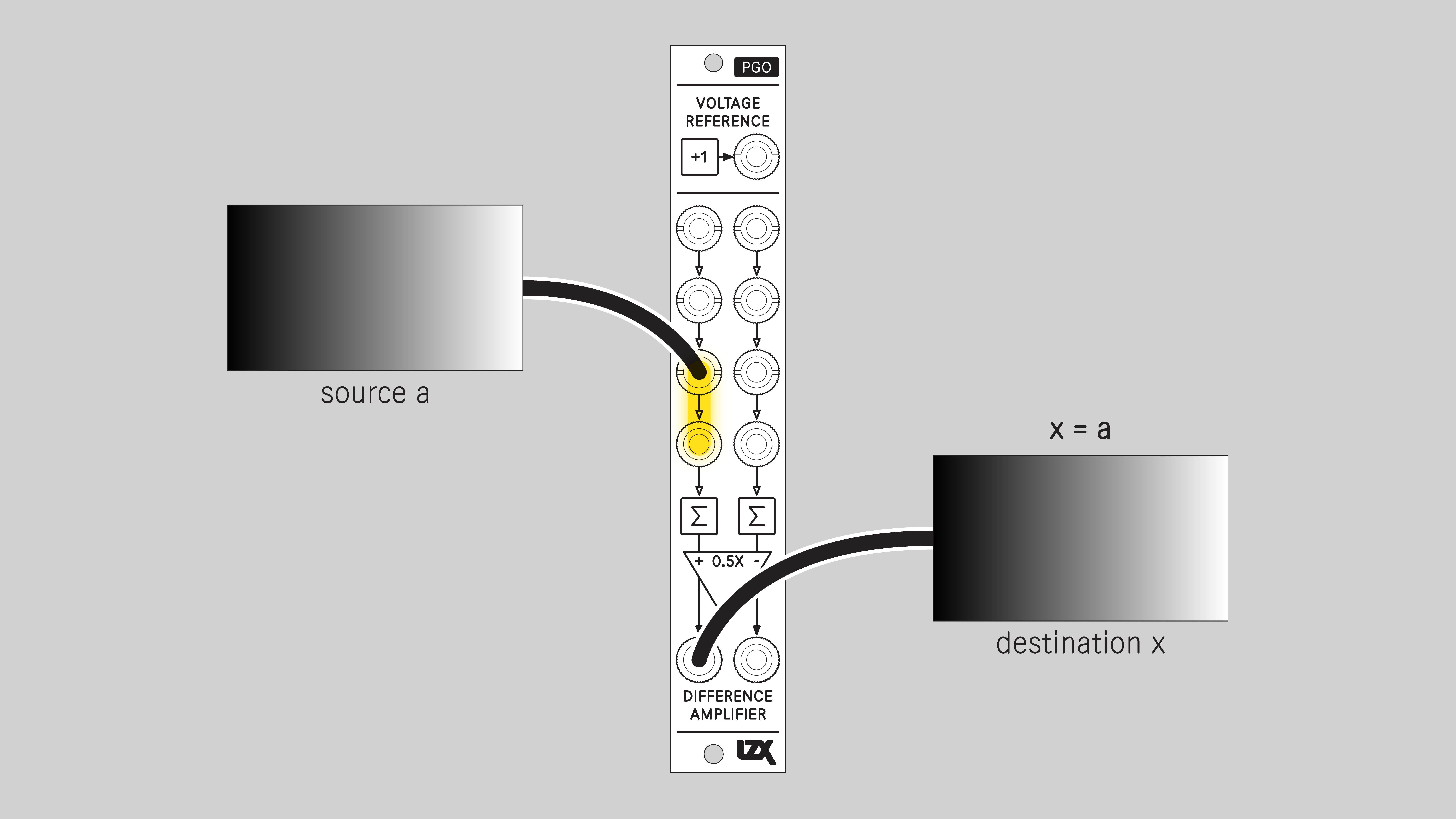

Buffer
Buffer the input signal with a unity gain of 1.0. Due to the module's propagation delay, it can be used to add slight delays in the video processing path, resulting in the picture shifting slightly to the right.
Buffer

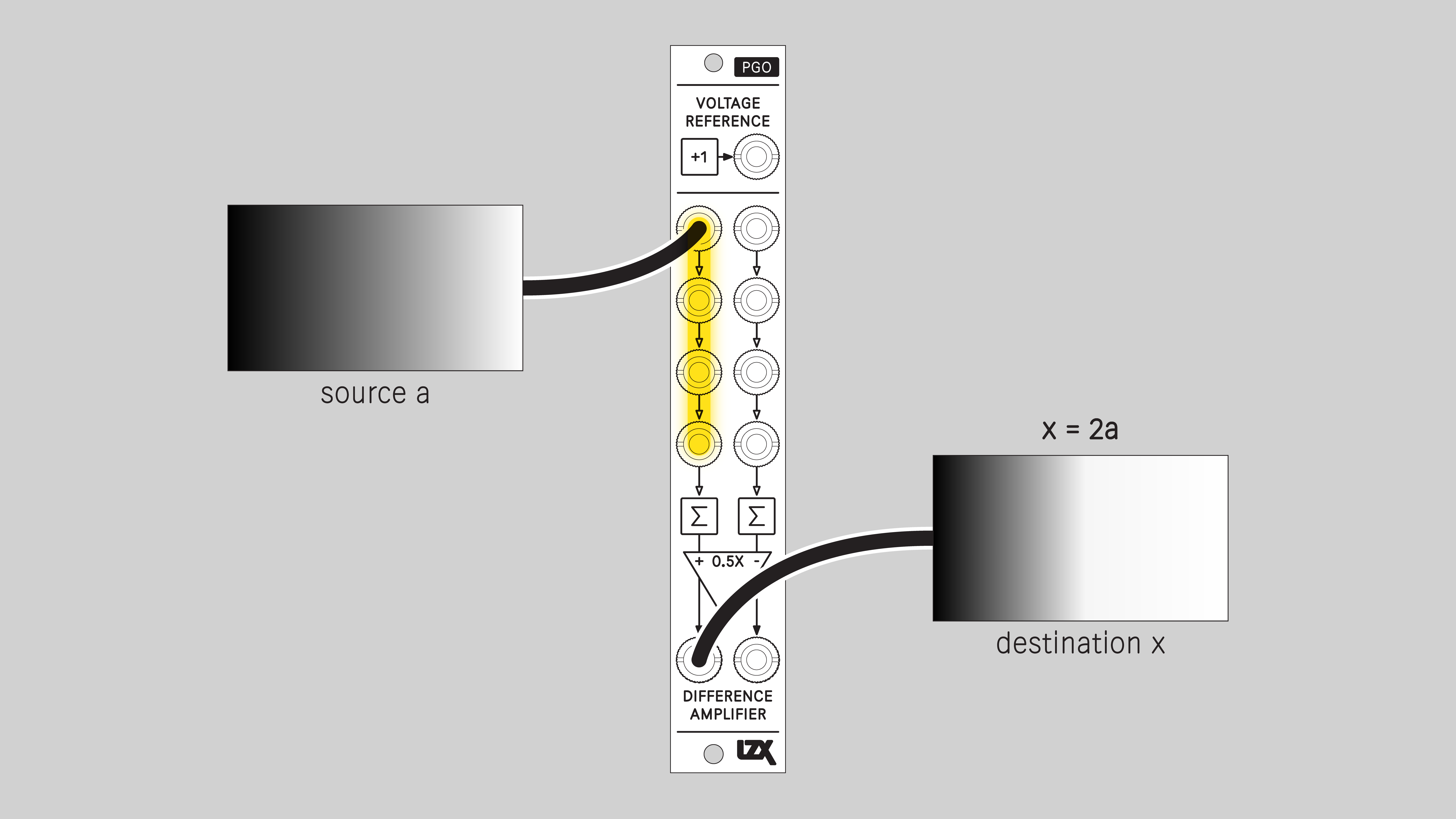

Amplifiy
Amplify the input signal with a gain of 2.
Amplifier

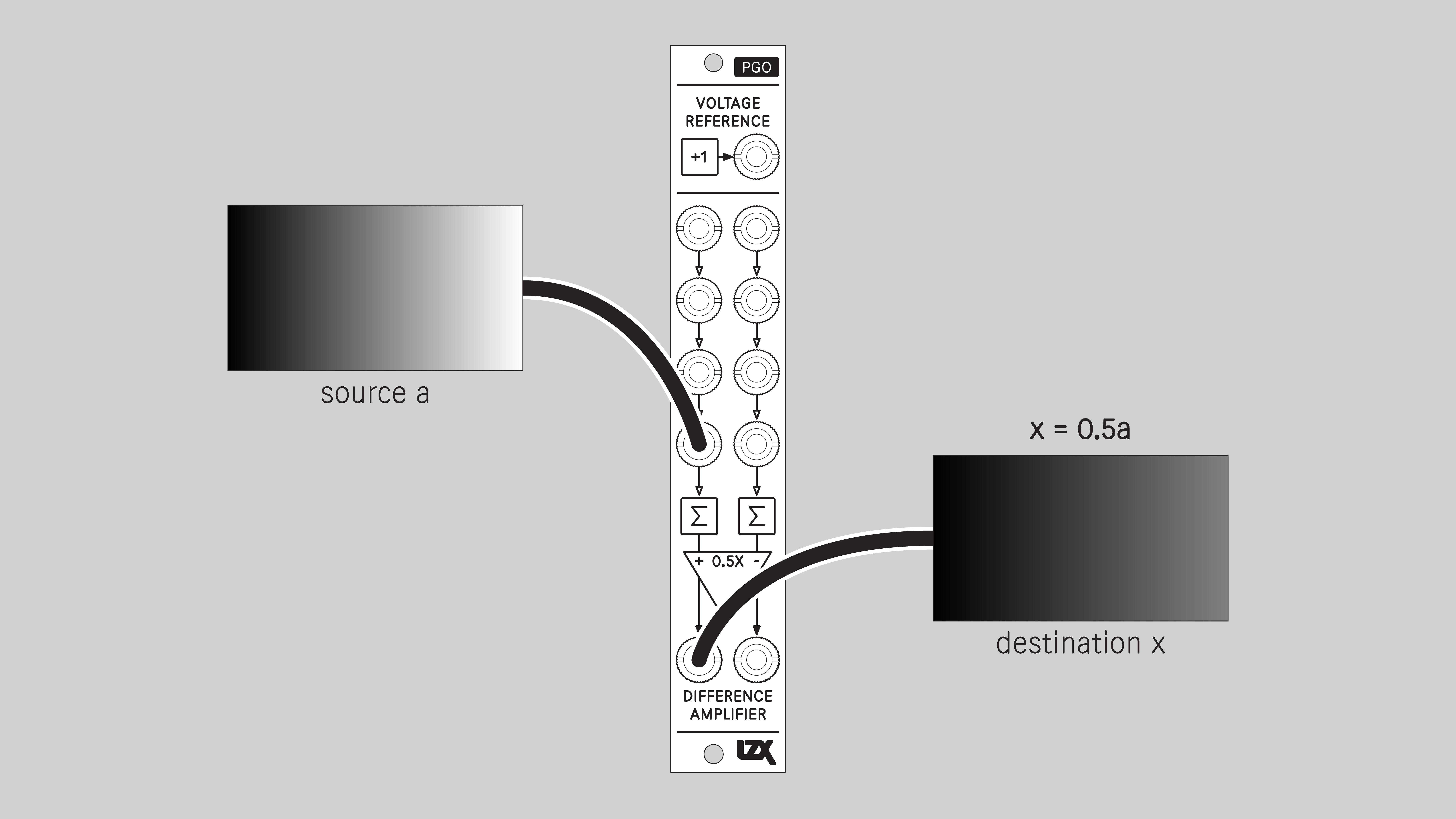

Attenuate
Attenuate the input signal with a gain of 0.5.
Attenuator

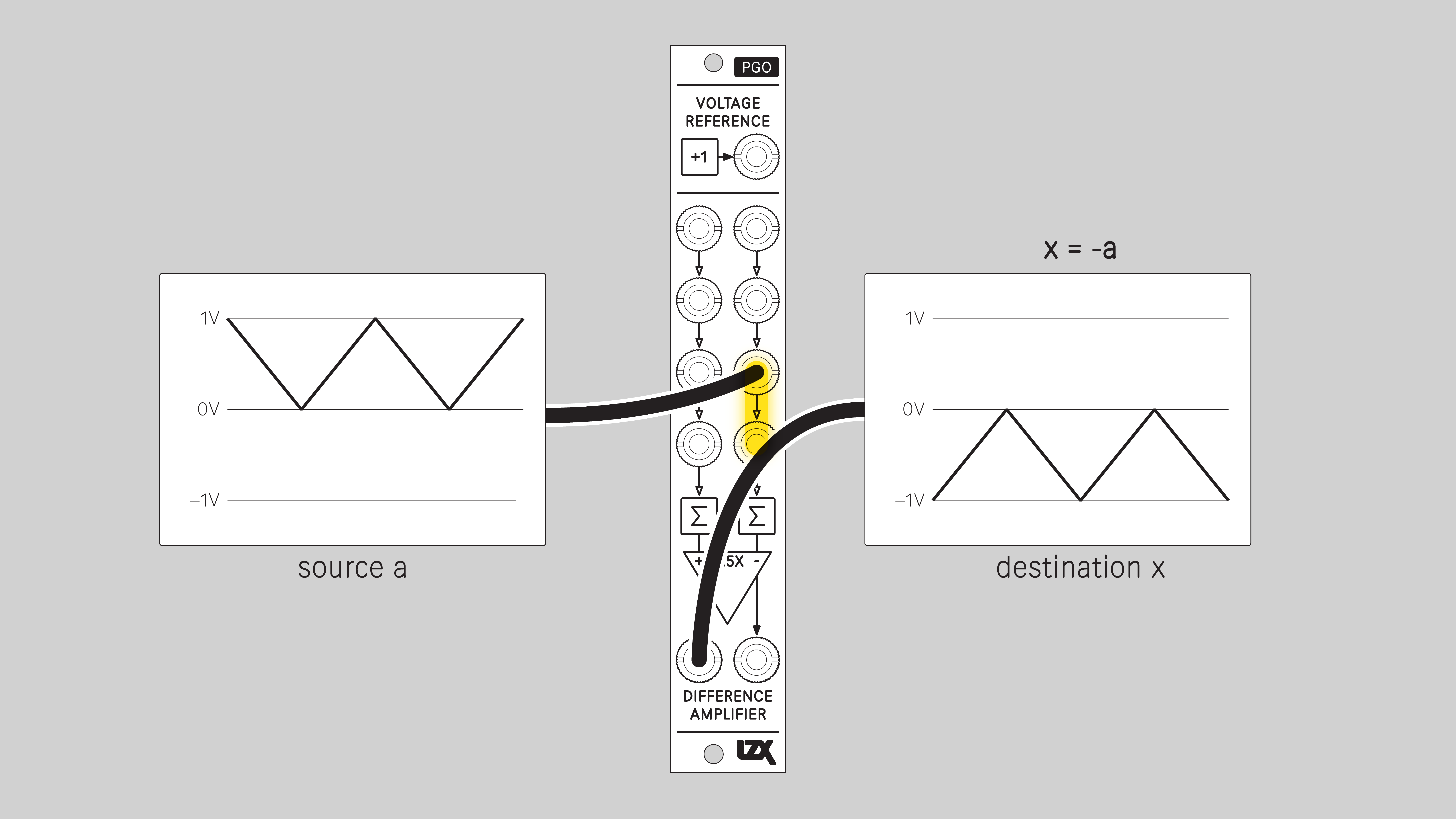

Invert
Invert the arithmetic sign of the input signal. Positive voltages are converted to negative voltages, or vice versa.
Inverter

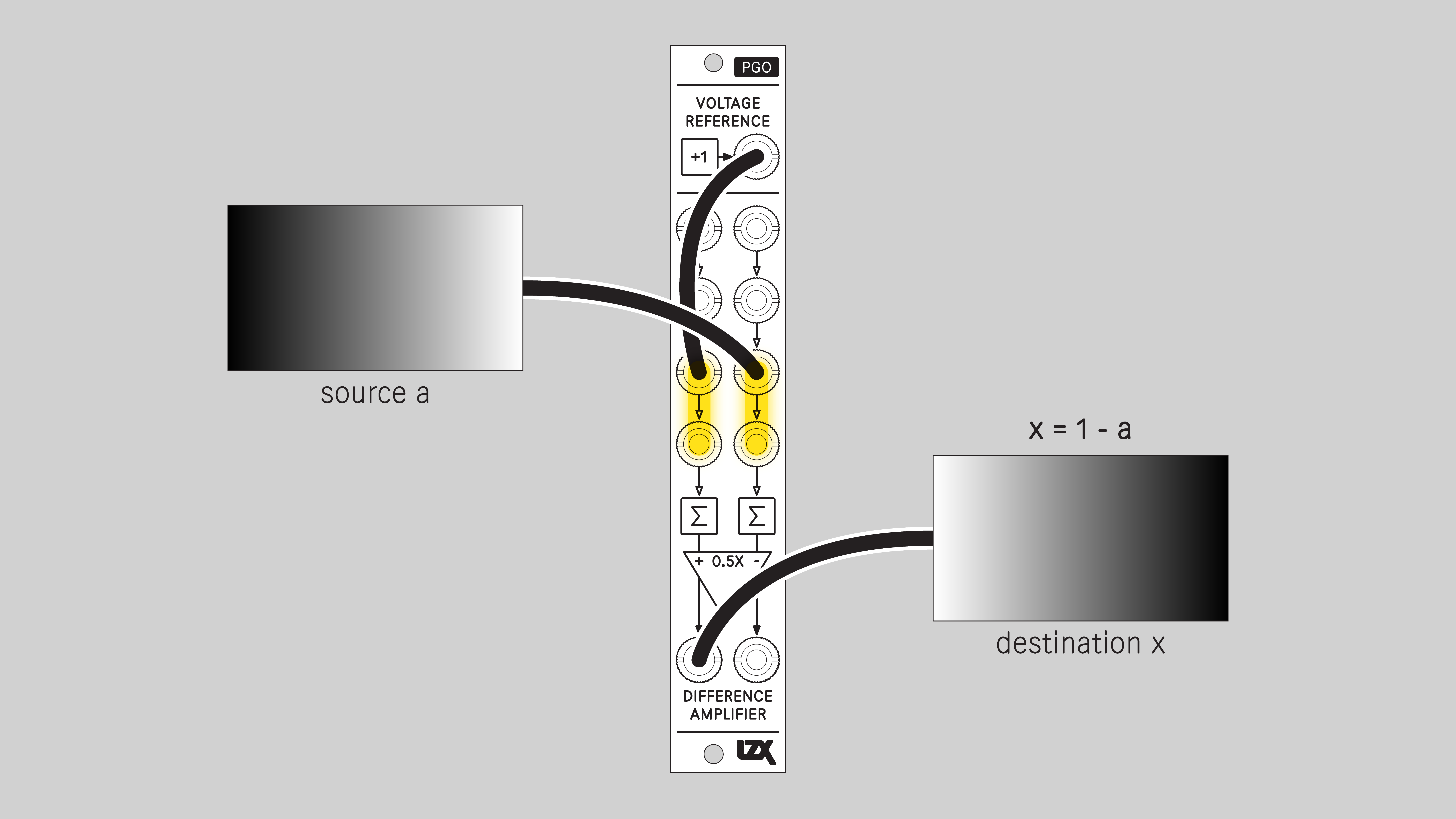

Negative
Convert a unipolar signal to negative by subtracting it from 1V. Useful for inverting keys, logic and RGB channels. An input signal ranging from zero to one results in an inverted output ranging from one to zero.
Negative

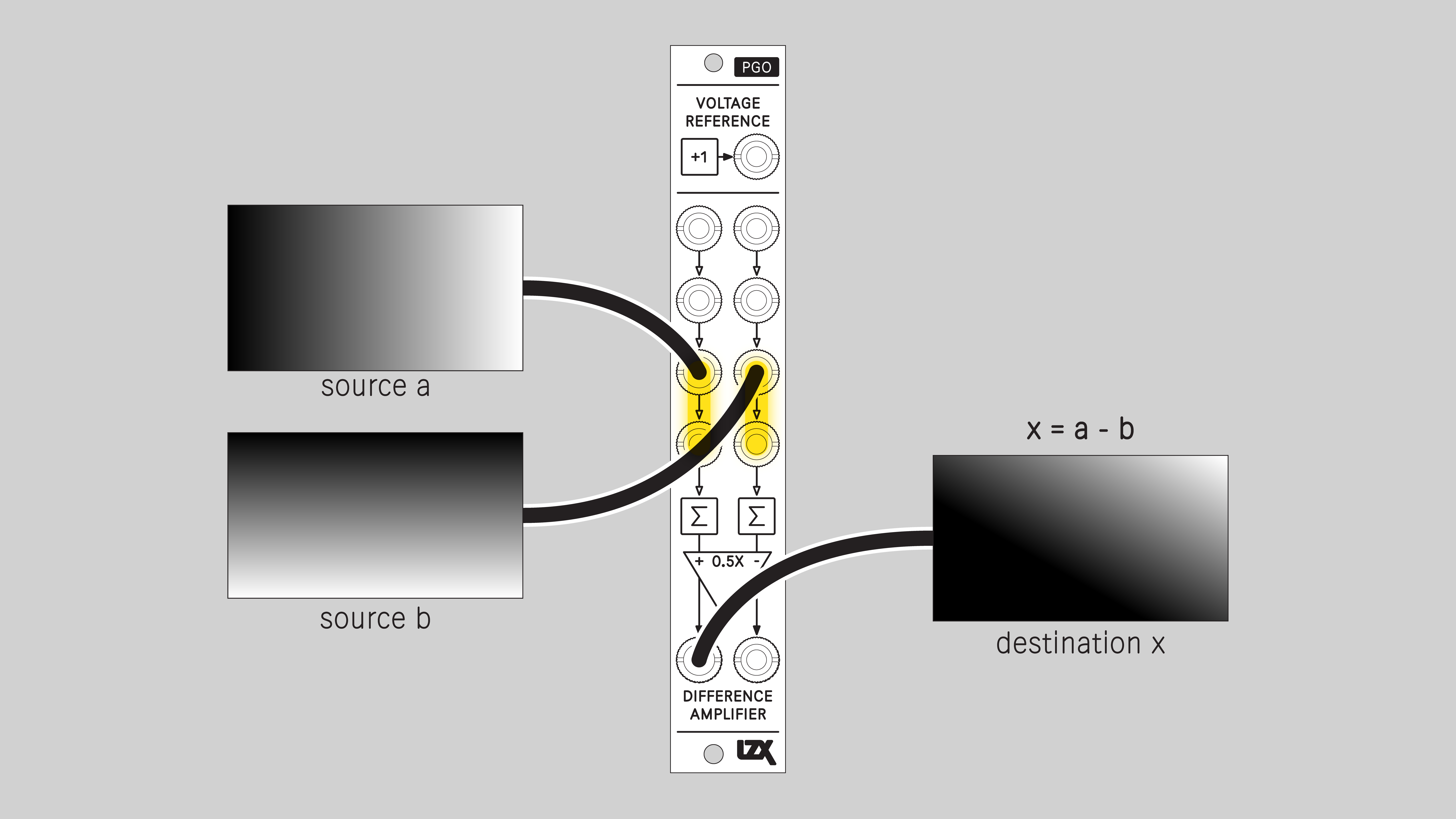

Subtract
Subtract one input from another.
Subtractor

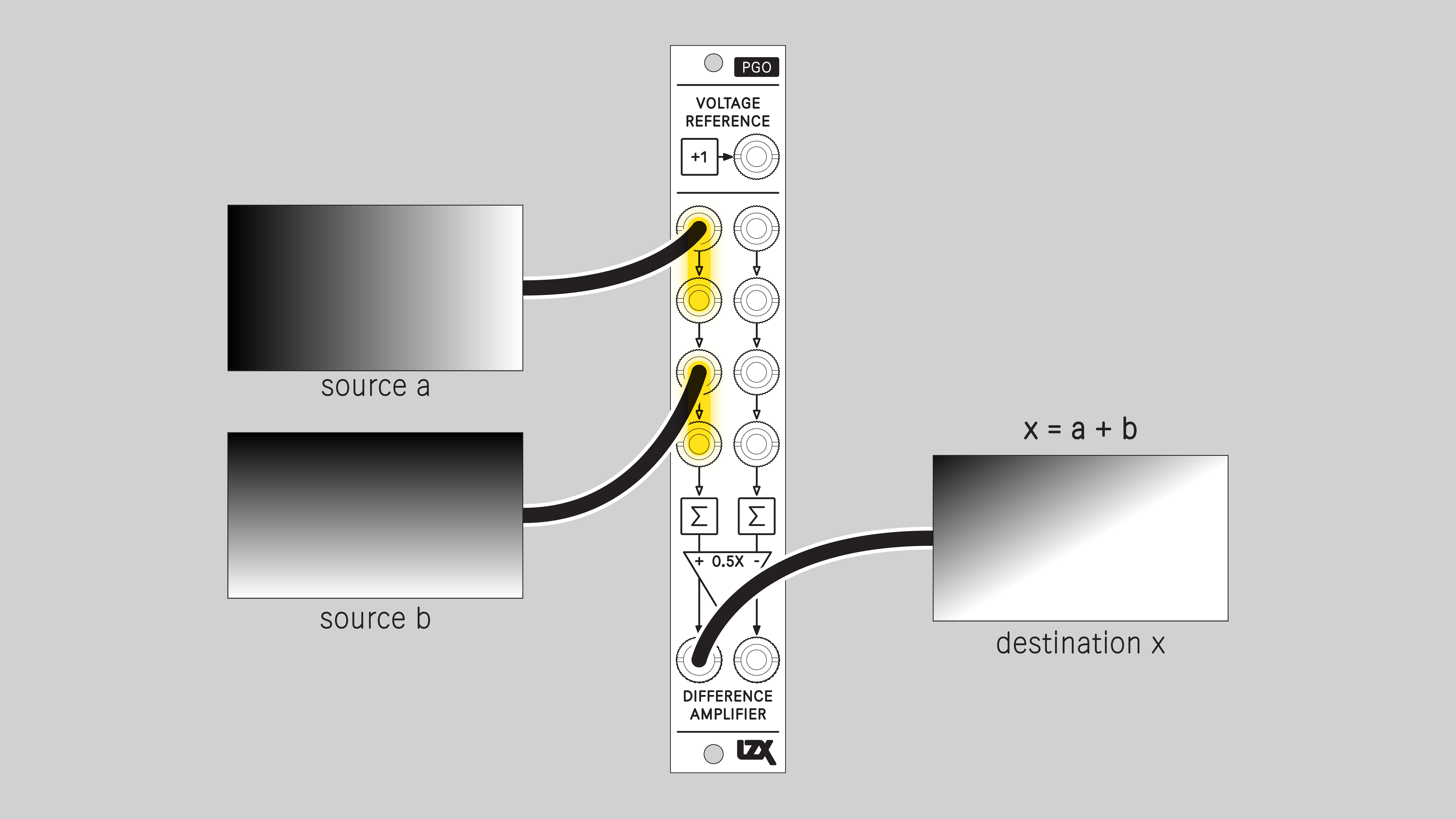

Add
Calculate the sum of two input signals.
Adder

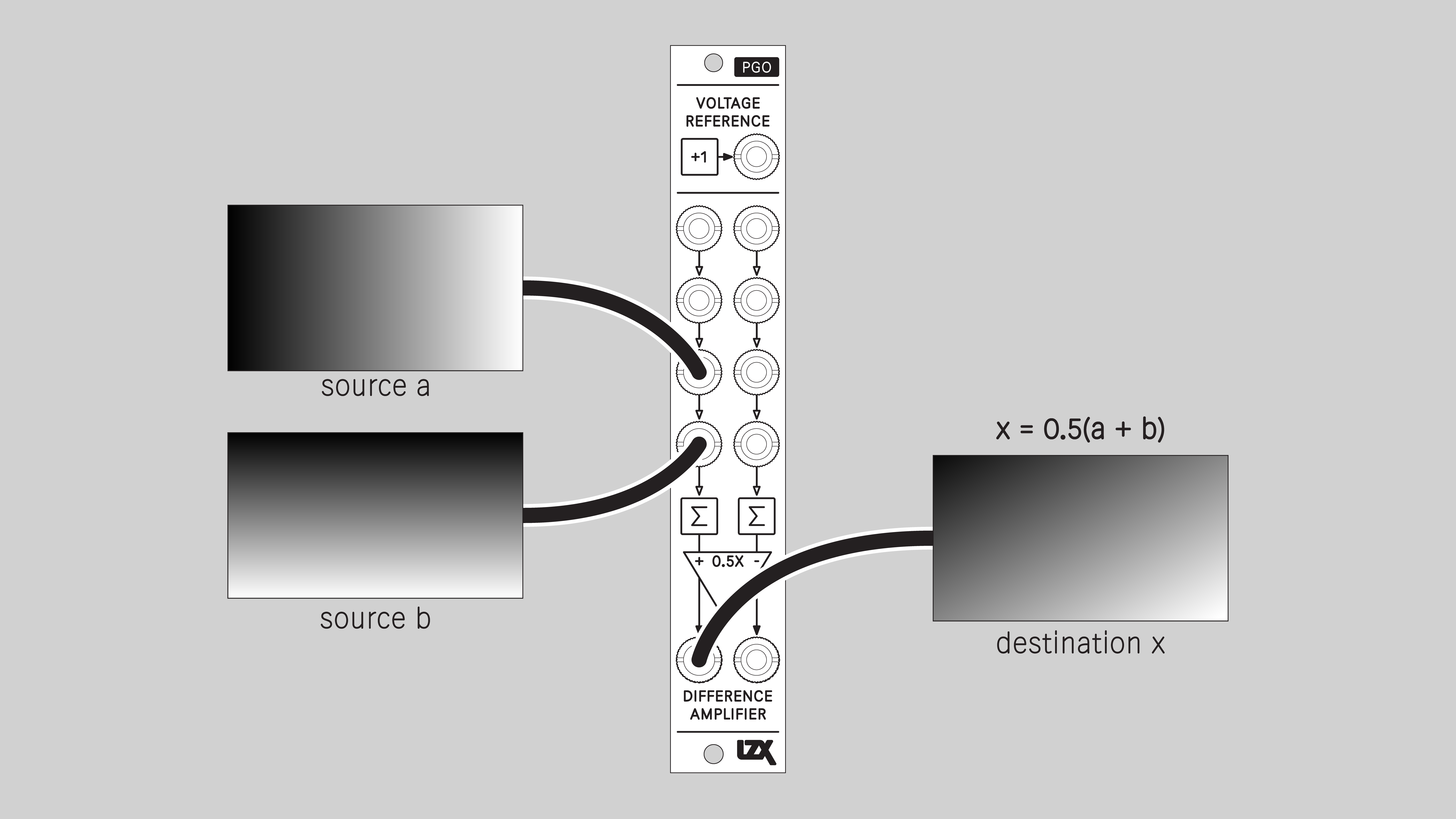

Average
Calculate the average of two input signals.
Average

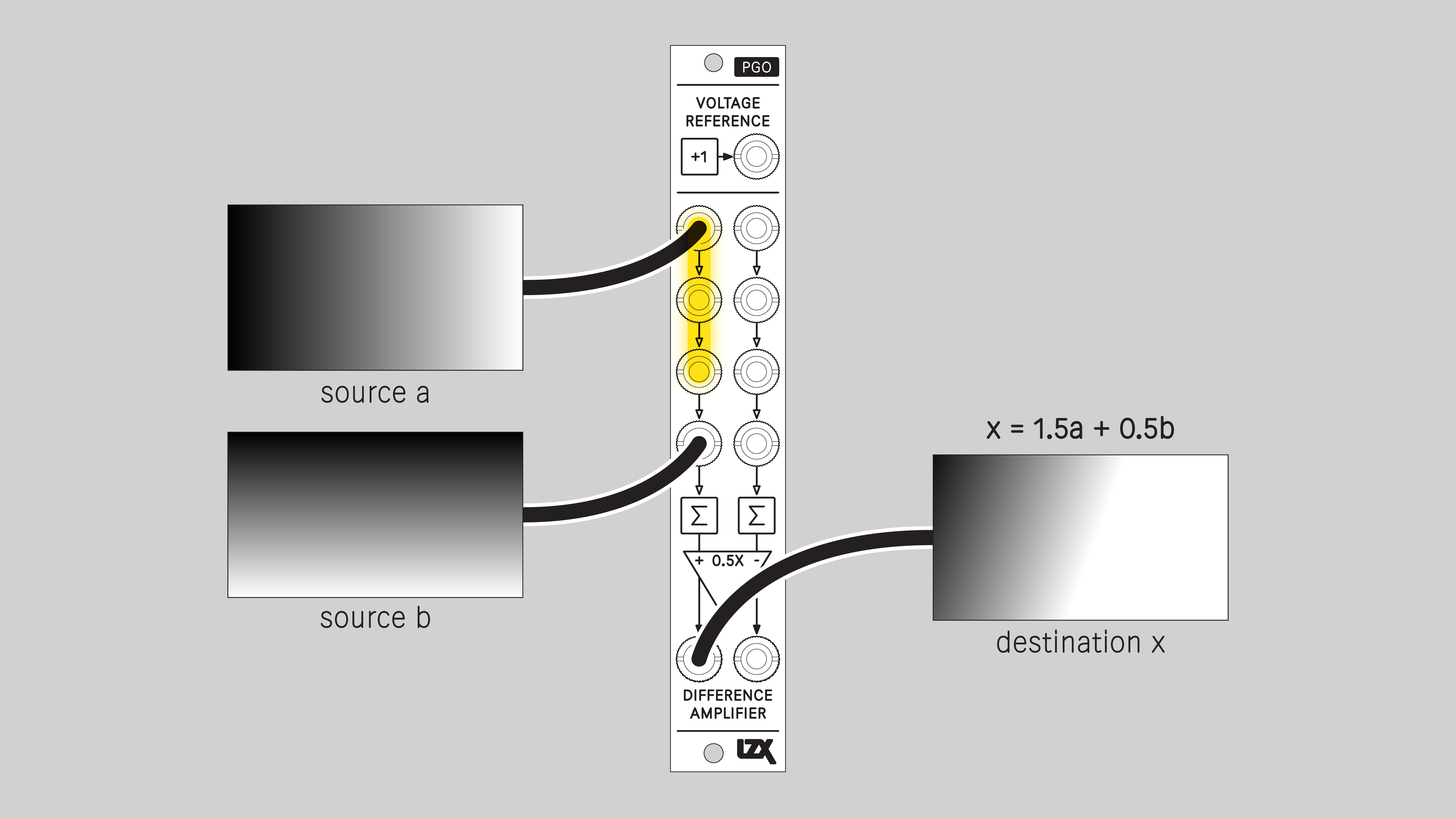

Weighted Mixer
Calculate a 3:1 weighted sum of two inputs, with 3 parts of source a for every 1 part of source b.
Weighted Mixer

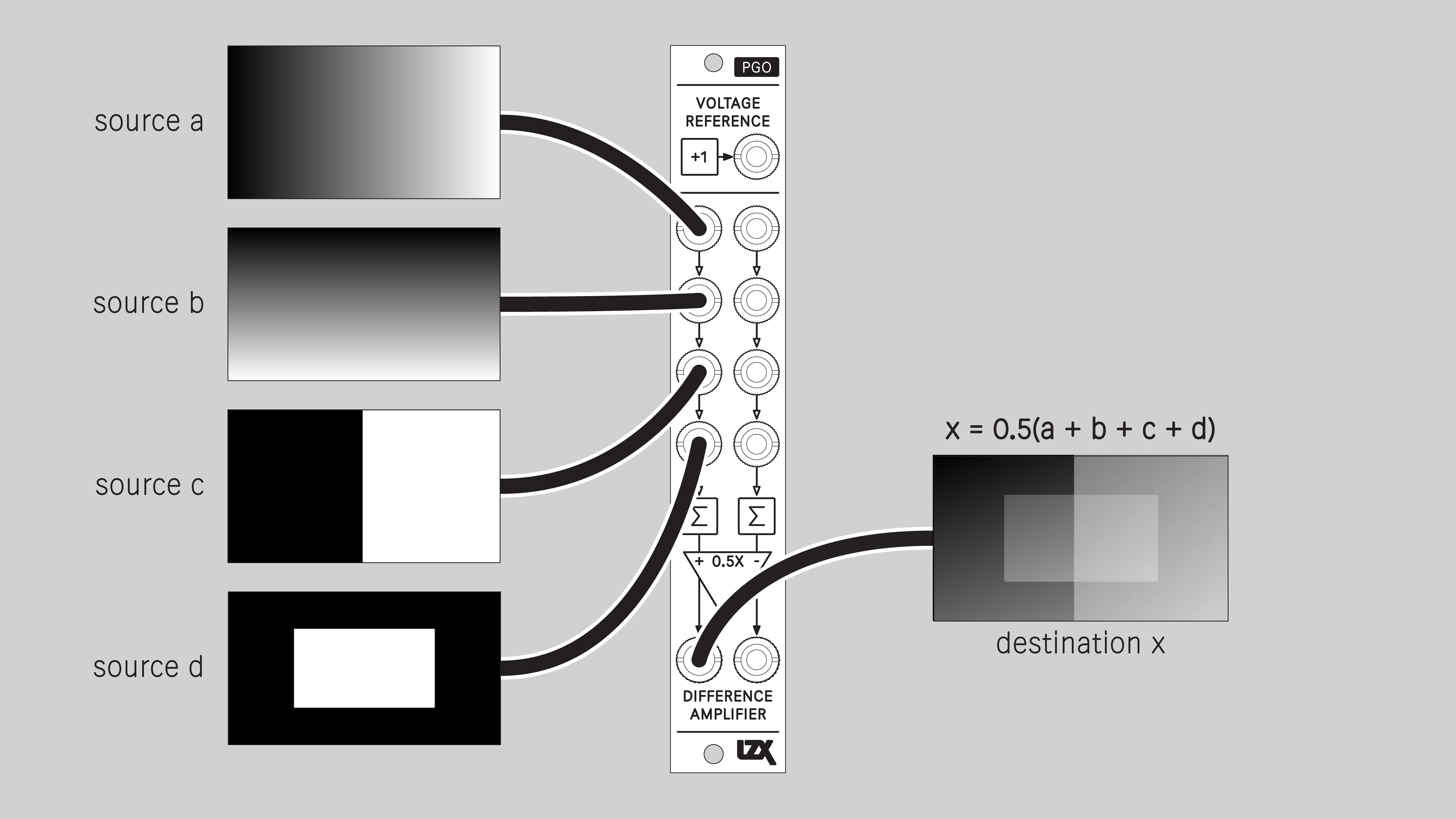

Compressed Mixer
Calculate the sum of four input signals and attenuate the mix to a value of one half. This is a common scenario to prevent clipping when mixing more than two input signals.
Compressed Mixer
