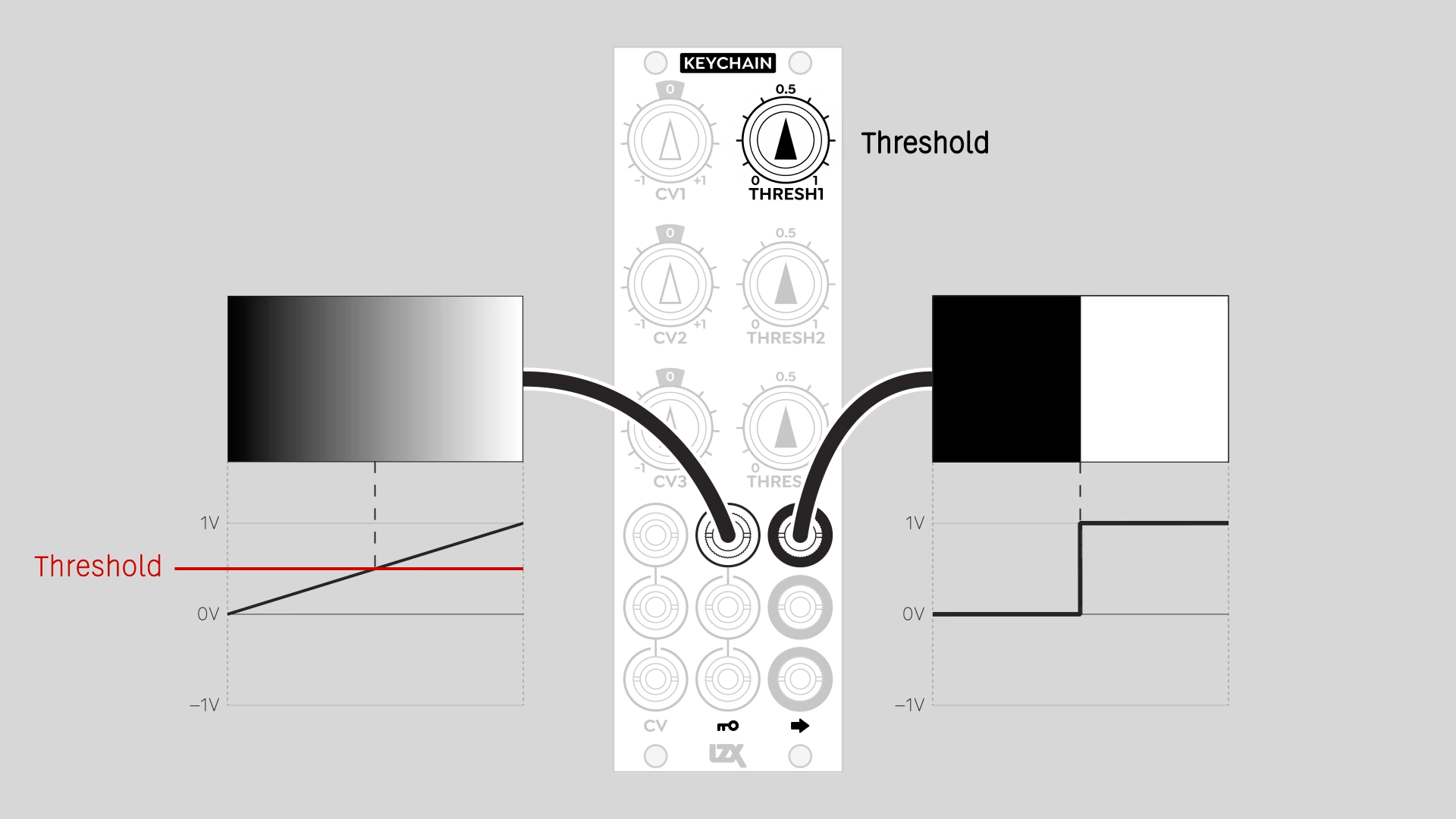

Each channel has two inputs, one labeled CV and one with a Key icon. The threshold of the key is set by the combination of the inputs and the Thresh potentiometer knob.

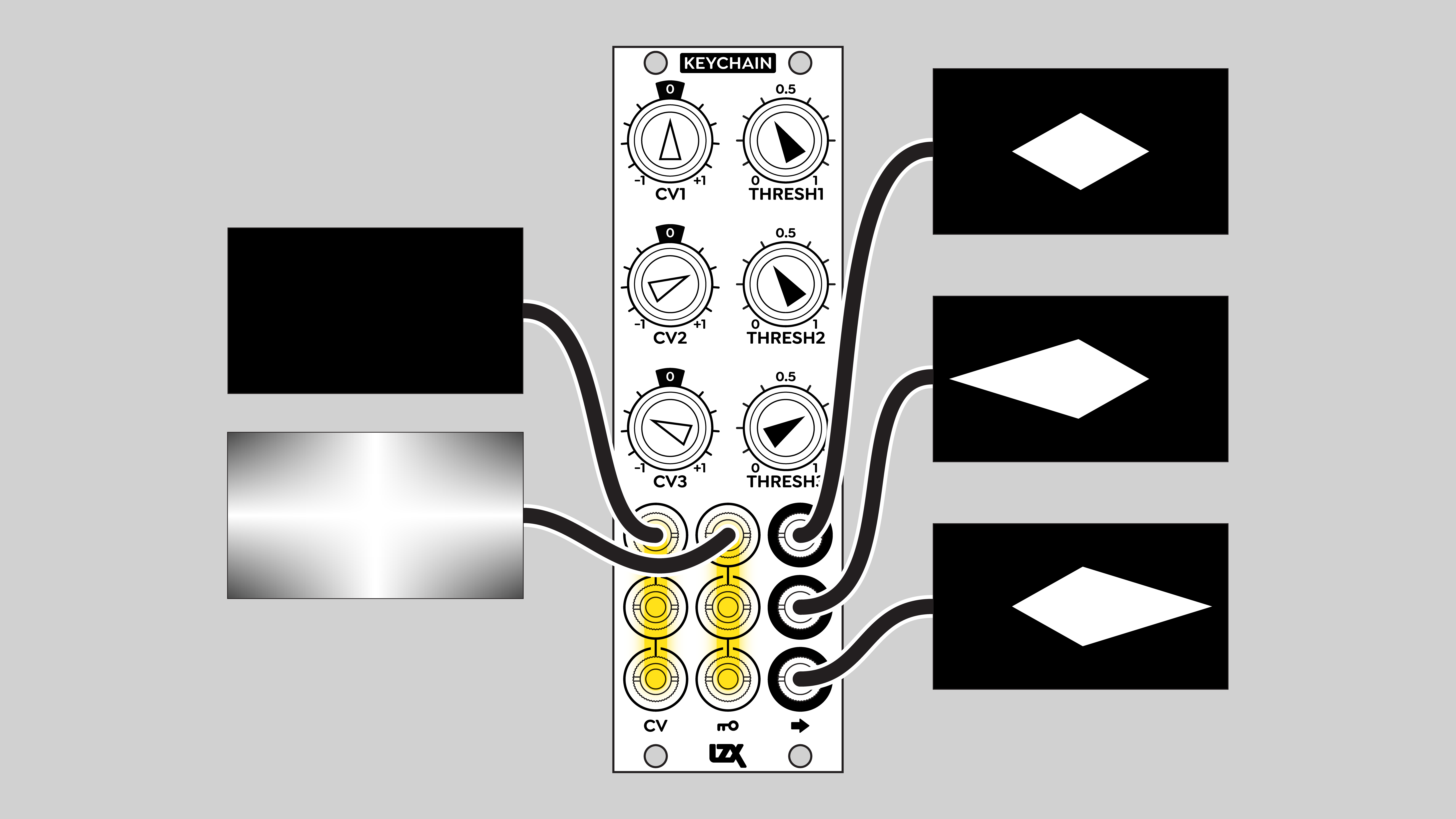

Both sets of inputs are internally self-normalled, allowing a signal patched into a channel 1 input to flow to the corresponding inputs of the other channels.
Keychain normalled inputs

Internally, each Keychain channel consists of a mixer and a comparator. The mixer architecture is similar to Proc. A signal patched into a Key input is passed to the mixer without adjustment. A signal patched into a CV input is multiplied by its attenuverter potentiometer before being passed to the mixer. These two inputs are summed along with a third signal: a static voltage controlled by the Thresh potentiometer knob. Unlike the Bias control on Proc, the Threshold control is unipolar, ranging from zero to +1 volts.
jKey+(jCVpCV)+pThreshjKey + (jCV \cdot pCV) + pThresh Keychain function blocks

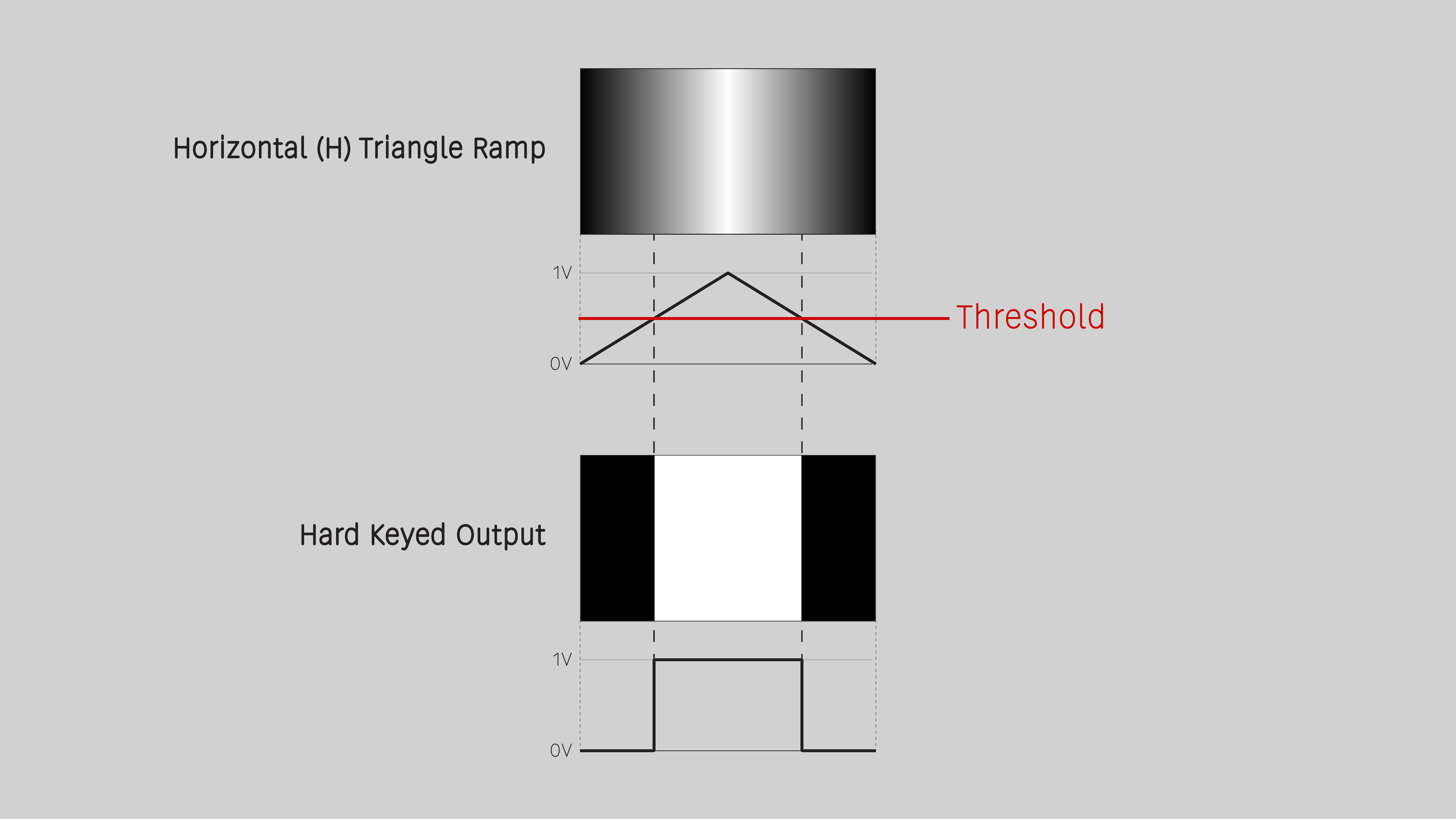

The output of the mixer goes into a lightning-fast comparator that slices the signal into two states, on or off. For video signals, this means different areas of the frame are rendered as matte values of zero or one volt. For low frequency signals, it means sudden transitions between black and white.
Keychain threshold

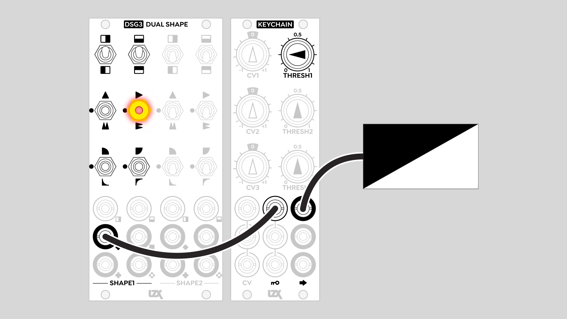

For a hard key composite of two sources, send a Keychain output to the CV input of a crossfade module, such as Bridge or VH.S Crossfade.
Sending a Keychain output to PGO gives perfectly phase-aligned positive and negative alpha channels. This unlocks new achievements with mixers such as Proc and SMX3, turning them into hard keyers!
Since Keychain's inputs are internally normalled, it can generate three keys of different thresholds from the same source. One application, a three-level posterizer, uses the ABS outputs of DSG3 to create discrete, non-overlapping bands of values. Each band goes to a top row input of SMX3, giving independent control of RGB or YIQ colors.
Linear wipe
Keychain linear wipe

Multiple thresholds
Keychain input mult

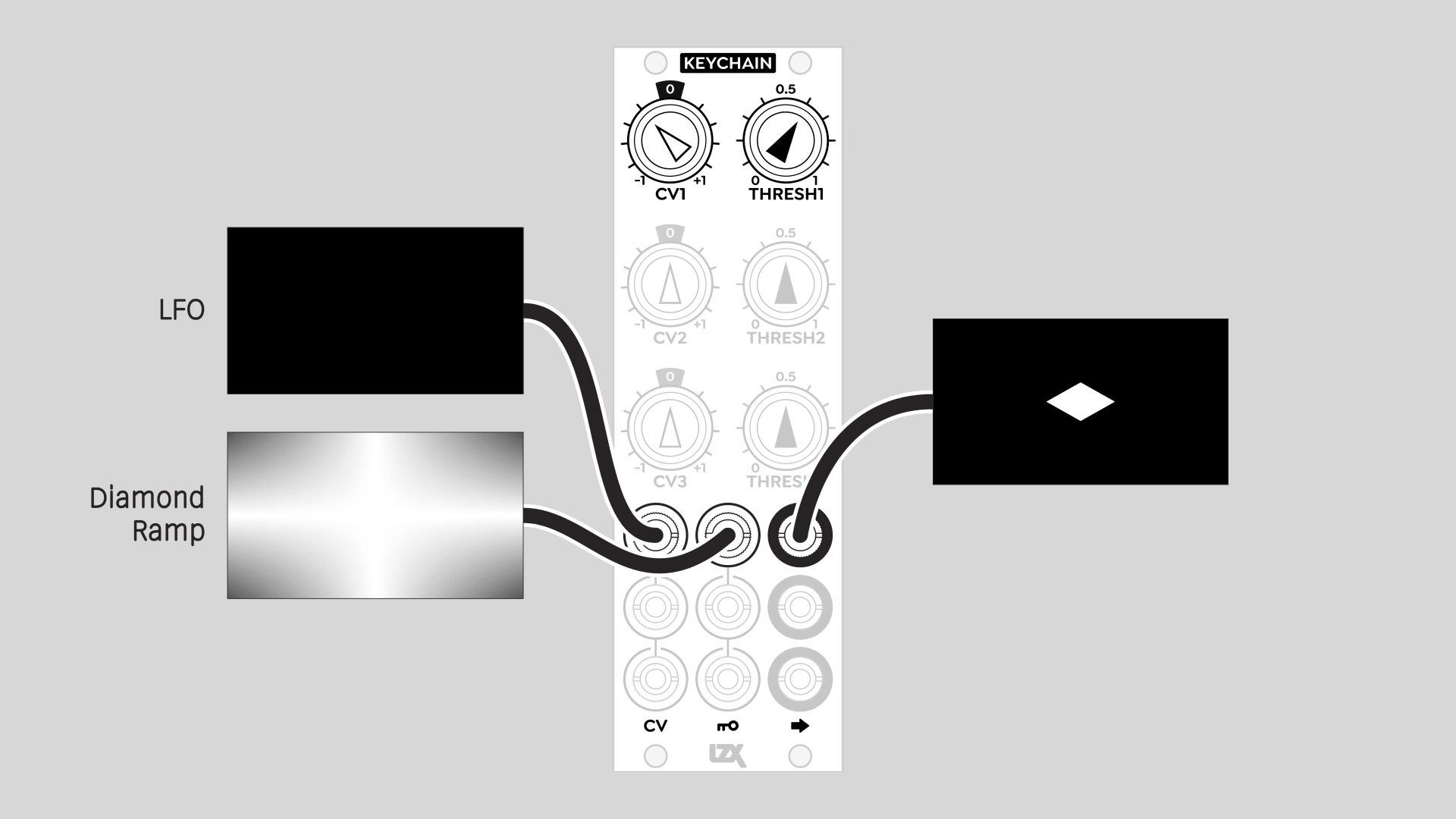

Animated figure / wipe
Keychain LFO threshold

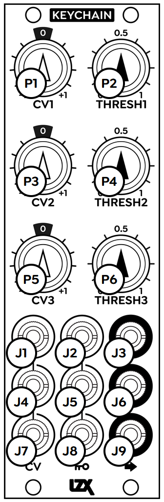

 ConnectorsControls
Keychain: labeled front panel controls
JackFunction
J1CV 1 in
J2Key 1 in
J3Channel 1 out
J4CV 2 in
J5Key 2 in
J6Channel 2 out
J7CV 3 in
J8Key 3 in
J9Channel 3 out
PotentiometerFunction
P1CV 1 attenuvert (gain)
P2Threshold 1 (bias)
P3CV 2 attenuvert (gain)
P4Threshold 2 (bias)
P5CV 3 attenuvert (gain)
P6Threshold 3 (bias)
