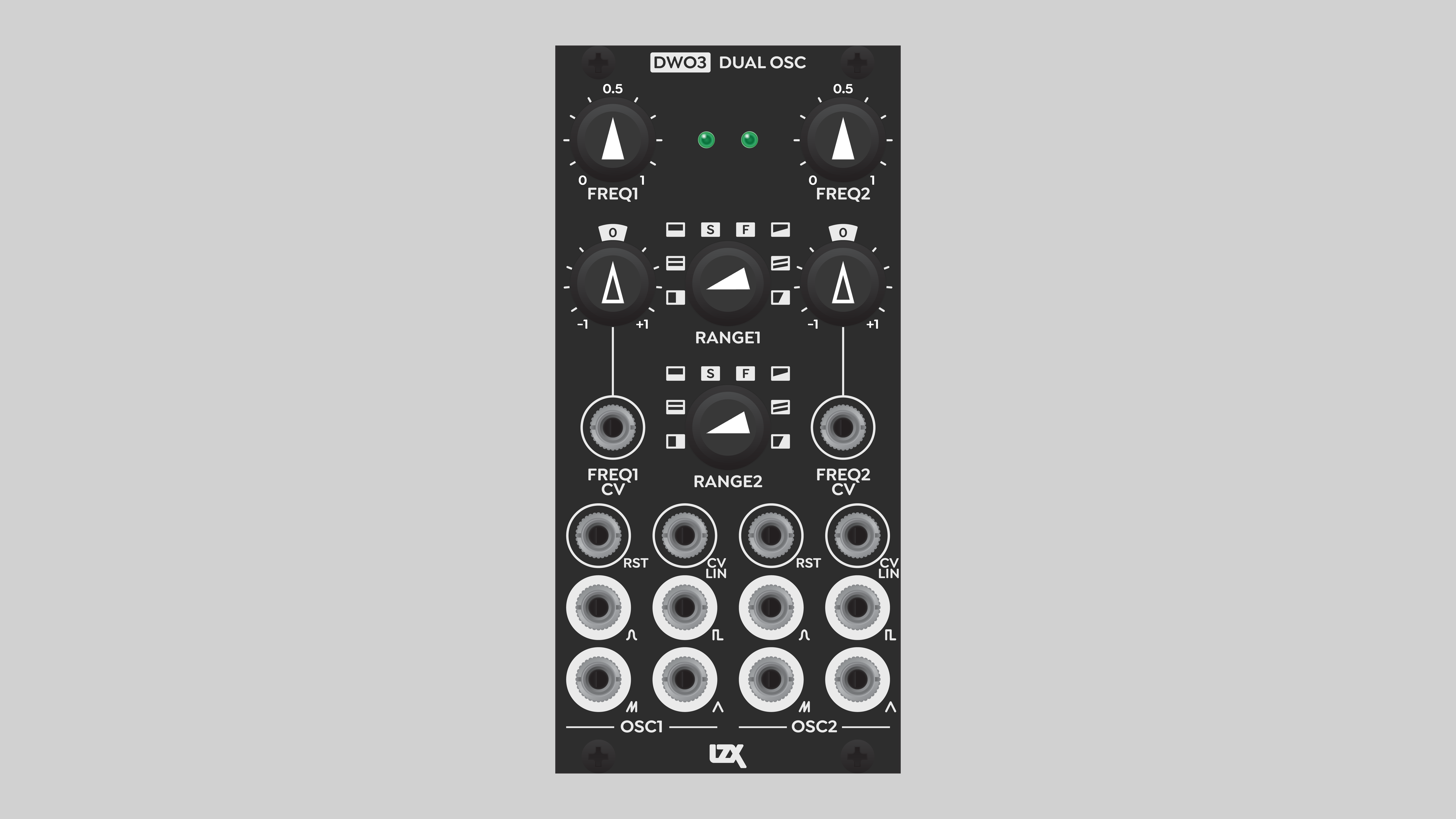

DWO3 front panel
Capable of an exceptionally wide range of frequencies and precision modulation, DWO3 is the most advanced analog video oscillator available. It's capable of generating high frequency waveforms for SD and HD video pattern generation, or low frequencies for animation control. High frequency oscillation modes can run freely, or lock to incoming video sync.
DWO3 features two independent oscillators, each with four different simultaneous waveform outputs. Each oscillator can be frequency modulated with a linear input, an exponential input with an attenuverter, or both. A gate supplied to the Reset input blanks off the oscillator output and resets the phase, starting a new cycle.

DWO3 is divided into two identical submodules, labeled OSC1 and OSC2. Inputs and outputs of OSC1 are on the left, inputs and outputs of OSC are on the right.
At the top of each submodule, the base frequency of the oscillator is adjusted via the potentiometer labeled FREQ.
The frequency range for each oscillator is set with an eight-position rotary switch in the center of the module, labeled RANGE. Oscillator 1 range is on top, Oscillator 2 range is below.
Four simultaneous waveform outputs are available at the bottom of each submodule. All outputs of a single oscillator are at the same phase-aligned frequency. The waveforms are Sine, Square, rising Sawtooth, and Triangle.

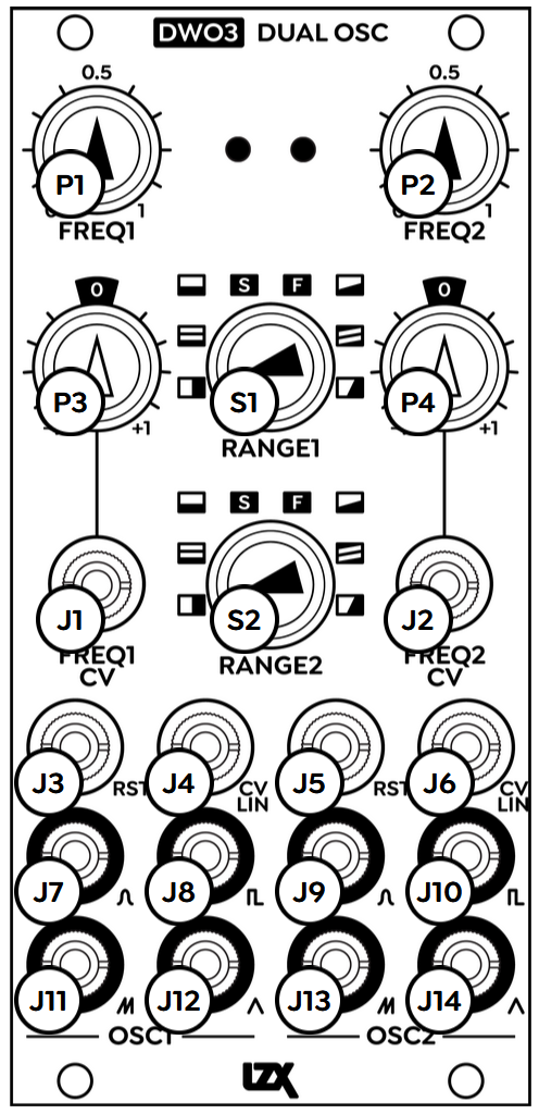

DWO3: labeled front panel controls
JackFunction
J1Osc 1 Exponential Frequency CV in
J2Osc 2 Exponential Frequency CV in
J3Osc 1 Reset in
J4Osc 1 Linear
Frequency CV in
J5Osc 2 Reset in
J6Osc 2 Linear
Frequency CV in
J7Osc 1 Sine out
J8Osc 1 Square out
J9Osc 1 Sine out
J10Osc 2 Square out
J11Osc 1 Sawtooth out
(rising ramp)
J12Osc 1 Triangle out
J13Osc 1 Sawtooth out
(rising ramp)
J14Osc 1 Triangle out
SwitchFunction
S1Osc 1 Range
S2Osc 2 Range
PotFunction
P1Osc 1 Frequency
P2Osc 2 Frequency
P3Osc 1 Exponential Frequency CV Depth
P4Osc 2 Exponential Frequency CV Depth
