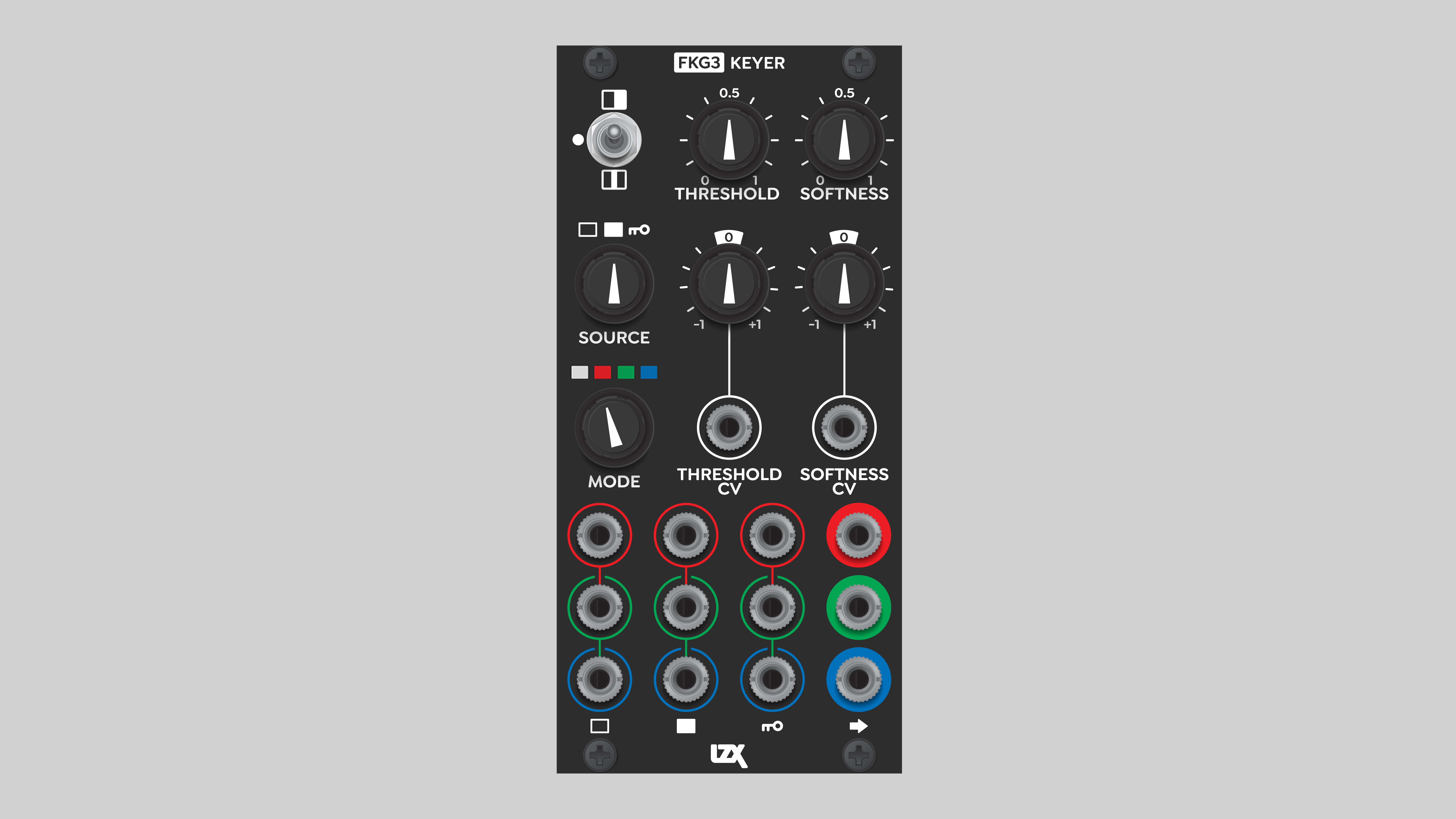

FKG3 front panel
FKG3 serves a wide range of creative image compositing functions. It's a key generator and RGB fader in one, allowing two RGB triplets to be layered with an internal or external key. Keys can be cut based upon luminance, or any one of the RGB color components. The edge of the key can range from hard to soft. The key softness can be increased so much that FKG3 becomes a crossfader with no key edge at all. Threshold and Softness can be voltage controlled with video rate signals. RGB and monochrome sources can be freely composited thanks to internally self-normalled input jacks.
Keying is based on analog logic. This is what allows FKG3 to perform a variety of fades, hard keys, and soft keys. It's also the "key" to controlling how chroma keys are cut. The individual RGB inputs open up creative possibilites that aren't possible with the conventional key bus of an ordinary video mixer.
The analog logic of FKG3 can be applied to any signal, not just a video image. Low frequency control voltages can also be processed.
FKG3 has a bonus feature: Edge outline mode. Edge mode cuts a narrow window key, knocking out values above and below the key threshold. All of these features take FKG3 far beyond what a plain vanilla mixer can do.

FKG3 has three sets of RGB inputs and one set of RGB outputs. Like all Gen3 modules, the inputs are internally self-normalled, so that a signal patched into an input jack cascades downward to the inputs below it.
The RGB input triplets, from left to right, are Background, Foreground, and Key. Background is indicated by a black rectangle, Foreground is a white rectangle, and the Key input is signified by a skeleton key icon.
Background and Foreground are merely convenient labels for the inputs. The priority of layering is not fixed. Either the Background and Foreground can be assigned as the visually "top" or "front" layer, depending on the settings of the Key Source and Key Invert switches, described below.
The Key input triplet allows an external source to define the key. Any image, gradient, or low frequency signal can provide the basis for the mask. The behavior of the Key inputs is different depending on the Key Mode setting, as explained in the Operation section below.
Key Threshold and Softness can be modulated by video-rate control voltages supplied to the Threshold CV and Softness CV inputs.
All RGB inputs and outputs of FKG3 are constrained to the unipolar range of 0 to 1 volt. FKG3 cannot pass a negative voltage; any input below zero is clipped to a value of zero.
Threshold and Softness CV inputs can accept negative voltages.
Potentiometer knobs
FKG3 has two sets of pots controlling the key Threshold and Softness, and their respective CV Depth amounts. Threshold is the value at which the key is cut, Softness is the width of the gradient at the key threshold. With a very low Softness, that gradient width is reduced to near zero, for a hard key.
For an extremely sharp-edged hard key, a comparator module such as Keychain, Stacker, or Ribbons may give better results. Cut the key using the comparator module, and send its output to the external Key input of FKG3.
The Threshold and Softness pots range from 0 to 1. However, these are not the full extents of the parameters. We can "push" the Threshold or Softness beyond the range of the pots by supplying a voltage to the CV input. In this way, we can, for example, key the Foreground or Background completely out, making it fully transparent.
The CV Depth pots are attenuverters, ranging from -1 to +1. An incoming control voltage is multiplied by the value of the attenuverter before being added to the Threshold or Softness.
Switches
Two rotary switches and one toggle switch define the settings for the key polarity, edge mode, key source, and key color mode.
The most important control is the Key Source rotary switch. This chooses which set of inputs is sent to the key generator to cut the stencil. It's labeled with three icons: a black rectangle for the Background inputs, a white rectangle for the Foreground inputs, and a skeleton key for the external Key inputs.
The other rotary switch chooses the Key Mode, determining which color channel(s) are used to cut the key. The white rectangle chooses Luminance Key mode. In this mode, the RGB channels of the Key Source are summed according to the luminance formula described in the Operation section below. The summed luminance value is sent to the key generator.
The Red, Green, and Blue settings of the Key Mode switch choose the color channel for Chroma Key mode. A key is cut based on the values of the RGB primaries. A detailed explanation follows in the Operation section. The short version is that the chosen color primary is knocked out. The key generator sets the key to a low value wherever that primary is pure. The compositor then makes that area transparent.
The toggle switch at the upper left has three positions. In the center, default position, the key is not inverted. The key is cut based on the brightest values of the Key Source. When the switch is set to its upper position, the polarity is inverted, and the key is cut based on the darker values of the Key Source. By adjusting both the Key Source and the polarity, we can achieve the visual effect of placing the Foreground input "on top" or "in front" of the Background input, or vice versa.
In the lower position, the toggle switch enables Edge mode. This is not an edge detector like the Contour module. It's a type of window key, where the key has two thresholds instead of one. Values slightly above and slightly below the Threshold are knocked out. The "top" or "front" input becomes an "edge" with variable Softness, superimposed over the "bottom" or "back" input.

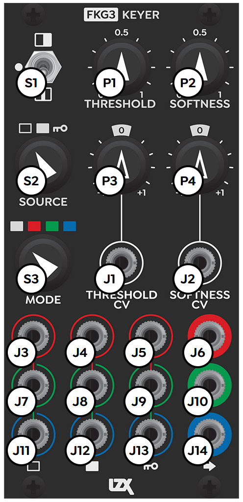

FKG3: labeled front panel controls
JackFunction
J1Threshold CV in
J2Softness CV in
J3Red Background in
J4Red Foreground in
J5Red Key in
J6Red out
J7Green Background in
J8Green Foreground in
J9Green Key in
J10Green out
J11Blue Background in
J12Blue Foreground in
J13Blue Key in
J14Blue out
SwitchFunction
S1Edge / Invert
S2Key Source
S3Key color mode
PotFunction
P1Threshold
P2Softness
P3Threshold CV Depth
P4Softness CV Depth
