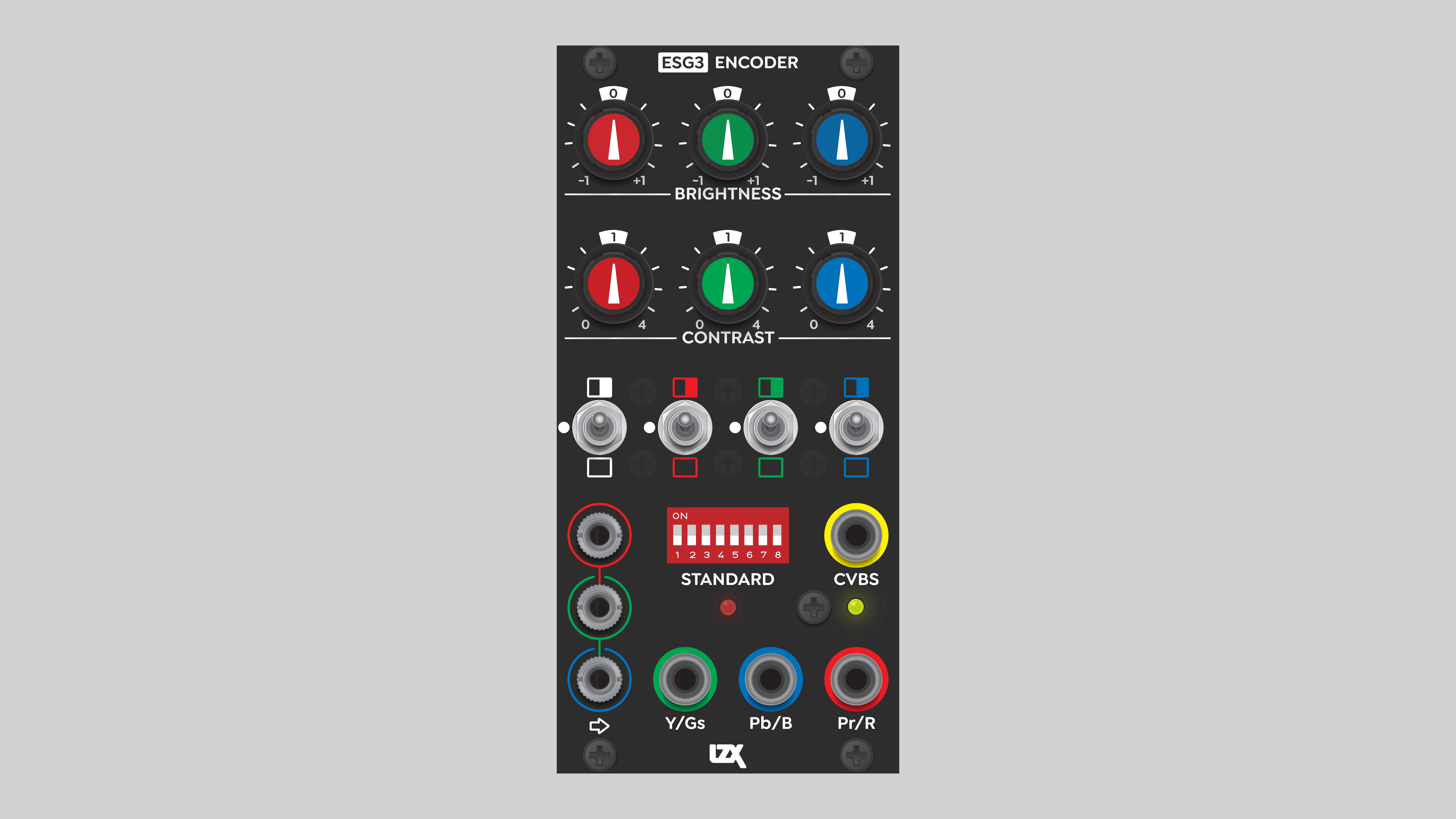

Status of video sync is indicated by the LED light directly below the Standard DIP switches. When ESG3 is genlocked to external sync, the LED glows green. When ESG3 is in internal sync mode, not genlocked to external sync, the light glows amber.
Status of composite video output is indicated by the LED light directly below the CVBS output. When ESG3 is set to a standard that supports composite video (NTSC/PAL), the light glows green, and composite video appears at the CVBS output jack. When ESG3 is set to a video standard that does not support composite video (all HD formats), the light glows amber, and no signal appears at the CVBS output jack.
Jacks, pots, and switches
On the bottom left of the module are three input jacks to accept 1v LZX modular video. They are color-coded to accept red, green, and blue color components. Anything patched into a Red, Green, or Blue input is converted to the corresponding color component of a video image.
Inputs are internally normalled, allowing signals to cascade down to the inputs below. Patching a signal into only the top (Red) input sends that signal to all three inputs. If the Contrast and Brightness controls are set to unity gain and bias, then patching into only the Red input results in a grayscale output.
ESG3 only accepts signals in the unipolar range of 0 to 1 volts. Any signal below 0v or above 1v is discarded.
Component video outputs appear at RCA jacks at the bottom right of the module. In YPbPr modes, the order of outputs from left to right is Y, Pb (Blue minus Y), and Pr (Red minus Y). In RGB modes, the order of outputs from left to right is Green, Blue, and Red.
In standard definition modes, composite video output is available from the RCA jack labeled CVBS, color-coded with a yellow insulator inside the jack.
In standard definition modes, both composite and component outputs are simultaneously active. In high definition modes, the composite output is not active.
ESG3 features four toggle switches, each with three positions, to invert or mute individual RGB components, or the global outputs.
At the top of the module are six potentiometer knobs, controlling the Contrast and Brightness of each RGB channel.
To the left of each RGB switch are two small recessed trim potentiometers. These are calibration controls. Their usage is described in the Calibration section below.
Early production units of ESG3 featured detent knob positions. For those units, calibration is more important because the knobs "want" to go to a center, default value. If the unit isn't calibrated, those default positions result in outputs that aren't at unity gain relative to the signal inputs.

At the left is the global switch for All Outputs. In the center position, the video outputs operate normally. In the upper position, all outputs are inverted. In the down position, all outputs are disabled or "muted". Flip the left-most switch down to immediately cut to black.
The remaining three switches control the Red, Green, and Blue components, and are color-coded accordingly. In the center position, the RGB component operates normally. In the upper position, the component is inverted, and in the lower position, the component is disabled or "muted".
Different combinations of switch positions result in various forms of colorization based on the video primaries of red, green, blue, and the secondary colors of cyan, magenta, and yellow. For example, if a signal is patched into the Red input only, and all switches and knobs are in the center positions, the output will be grayscale. Flipping the Blue switch down disables that component, resulting in the mixing of only red and green, which produces a yellow color at the output. Flipping the Blue switch up inverts the blue channel, colorizing the grayscale input to a complementary yellow-blue color palette.
Potentiometer knobs
Various Contrast and Brightness settings can yield results ranging from delicate color correction to extreme posterization effects.
Each of the red, green, and blue color components can be adjusted independently. For each component, ESG3 provides a potentiometer to adjust the Contrast (amplitude/gain) and Brightness (bias/offset). For a properly calibrated ESG3, setting all six knobs to the center, 12 o'clock position results in a setting of unity gain. ESG3 transparently transcodes the input signals to legal video, without adjustment. This is what we need if we wish to preserve the colors of an external video source.
A Contrast pot controls the amplitude or gain of its color component. The scaling operation is centered on a voltage of 0.5, or middle gray. When a Contrast pot is turned fully counterclockwise, the amplitude is zero. If the component's Brightness knob and toggle switch are set to their center, neutral positions, then a static voltage of 0.5 for that color component is sent to the encoding circuit. If all Contrast pots are turned fully counterclocwise, and all other settings are neutral, the output of the encoder is middle gray.
ESG3 can produce interesting posterization effects, similar to a key generator. Increasing Contrast eventually results in soft clipping. If the amplitude of the input signal is pushed beyond the 0 to 1 range, picture information at the top and bottom of the range is discarded. Highlights are blasted out, blacks are crushed.
A Brightness pot sets the bias or offset of its color component. The signal value is shifted up or down. Again, if the resulting signal goes outside of the 0 to 1 range, soft clipping occurs.

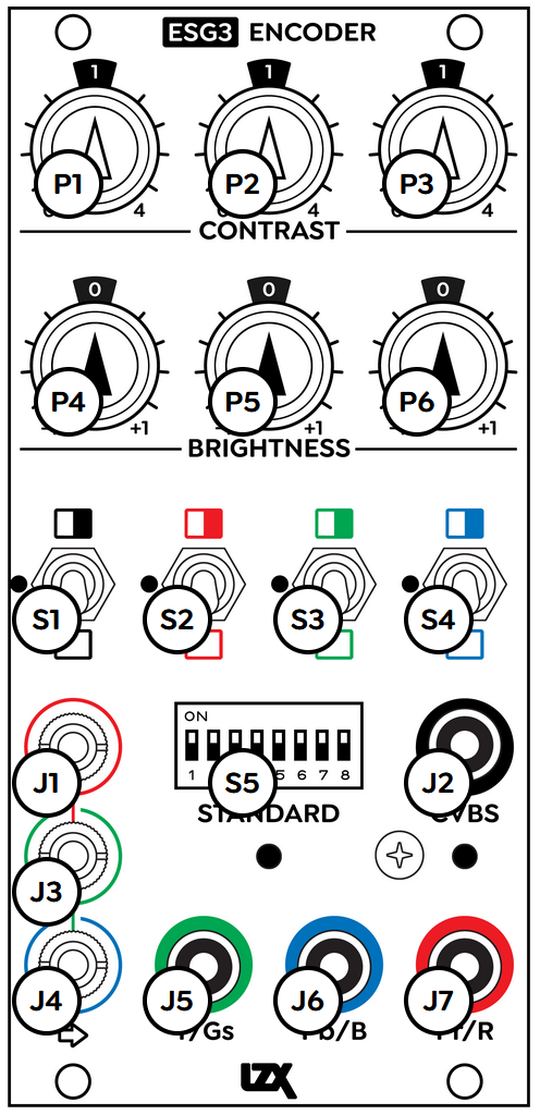

 ConnectorsControls
DWO3: labeled front panel controls
JackFunction
J1Red in
J2RCA Composite video out
J3Green in
J4Blue in
J5RCA Y or Green+Sync video out
J6RCA Pb or Blue video out
J7RCA Pr or Red video out
SwitchFunction
S1All Outputs
Invert/Mute
S2Red
Invert/Mute
S3Green
Invert/Mute
S4Blue
Invert/Mute
S5Video Standard
DIP switches
PotFunction
P1Red Contrast
P2Green Contrast
P3Blue Contrast
P4Red Brightness
P5Green Brightness
P6Blue Brightness
