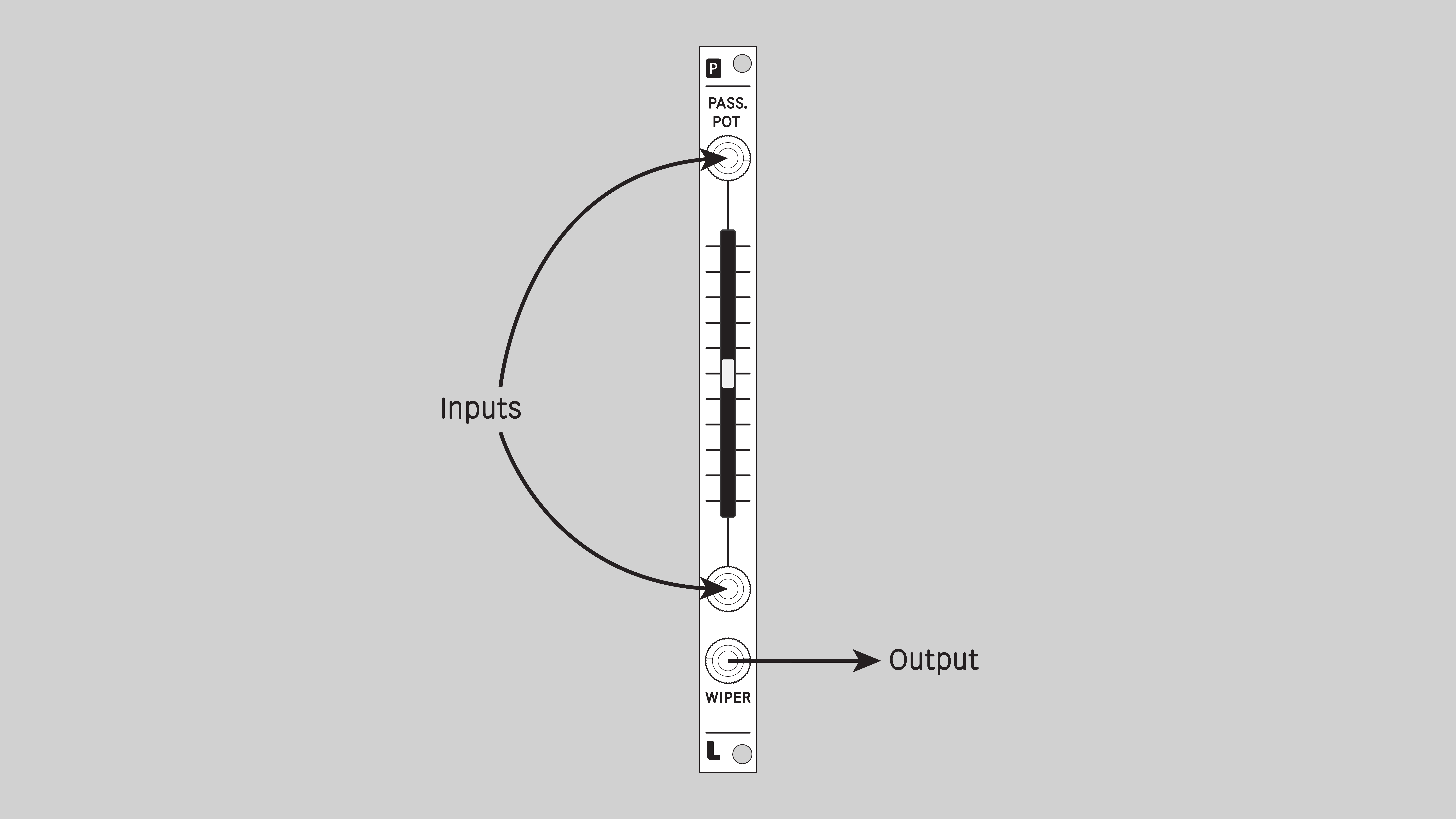

Controls & Connectors
Operation

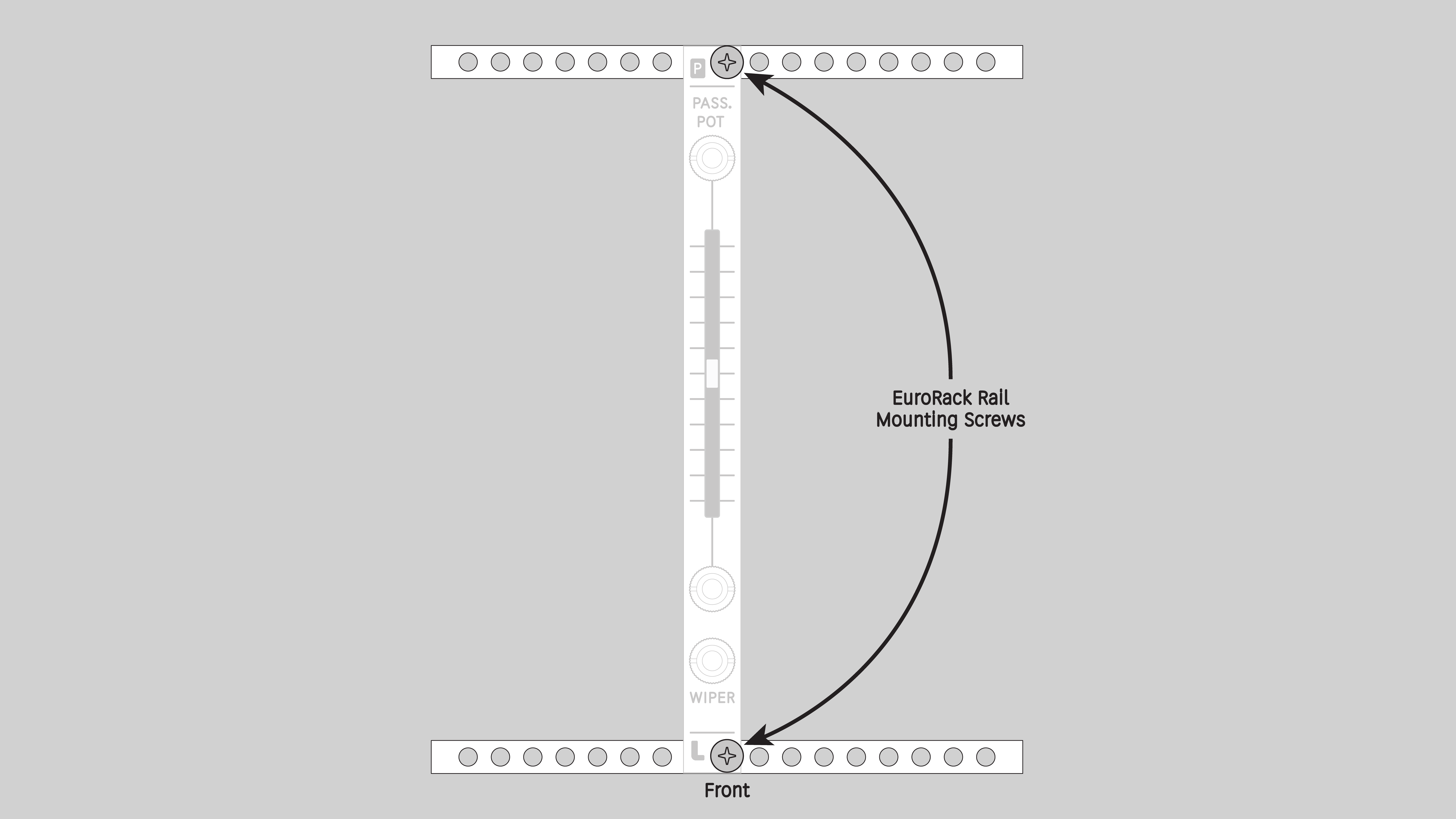

- EuroRack enclosure.
- Two M2.5 x 6mm mounting screws, or screws provided or specified by the enclosure manufacturer.
- #1 Phillips head screwdriver, or hand tool provided or specified by the enclosure manufacturer.
Procedure
- Power off and disconnect the EuroRack enclosure's power supply and any attached DC adapters.
- Ensure that no mounting screws are in any holes in the area where you wish to mount the module.
- Carefully test fit the module in the open space in the EuroRack enclosure. If it is obstructed by the enclosure or any internal assemblies, abort this procedure.
- Mount the module to the EuroRack rails using all mounting holes.
- Power on the EuroRack enclosure and start patching.
