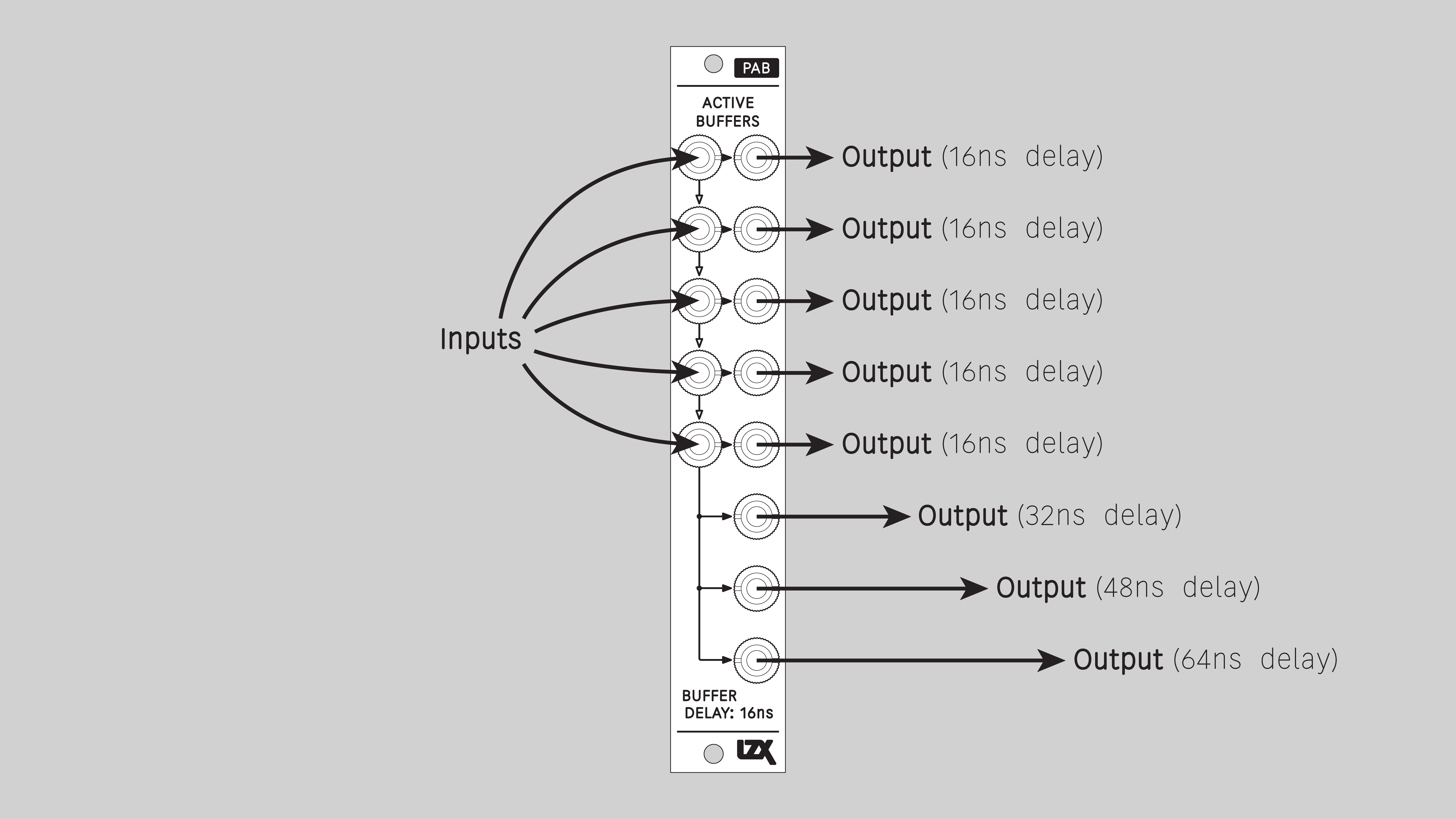

PAB is a utility for distributing and delaying signals. Duplicate a clean copy of a signal, or delay it in increments of 16 nanoseconds.
With delay times in the range of tens of nanoseconds, the result is an image shifted slightly to the right. Different modules delay signals by different amounts. In complex patches, this can be a problem. When signals are combined, they may be out of horizontal registration. PAB addresses this by inserting strategic delays to make everything line up.

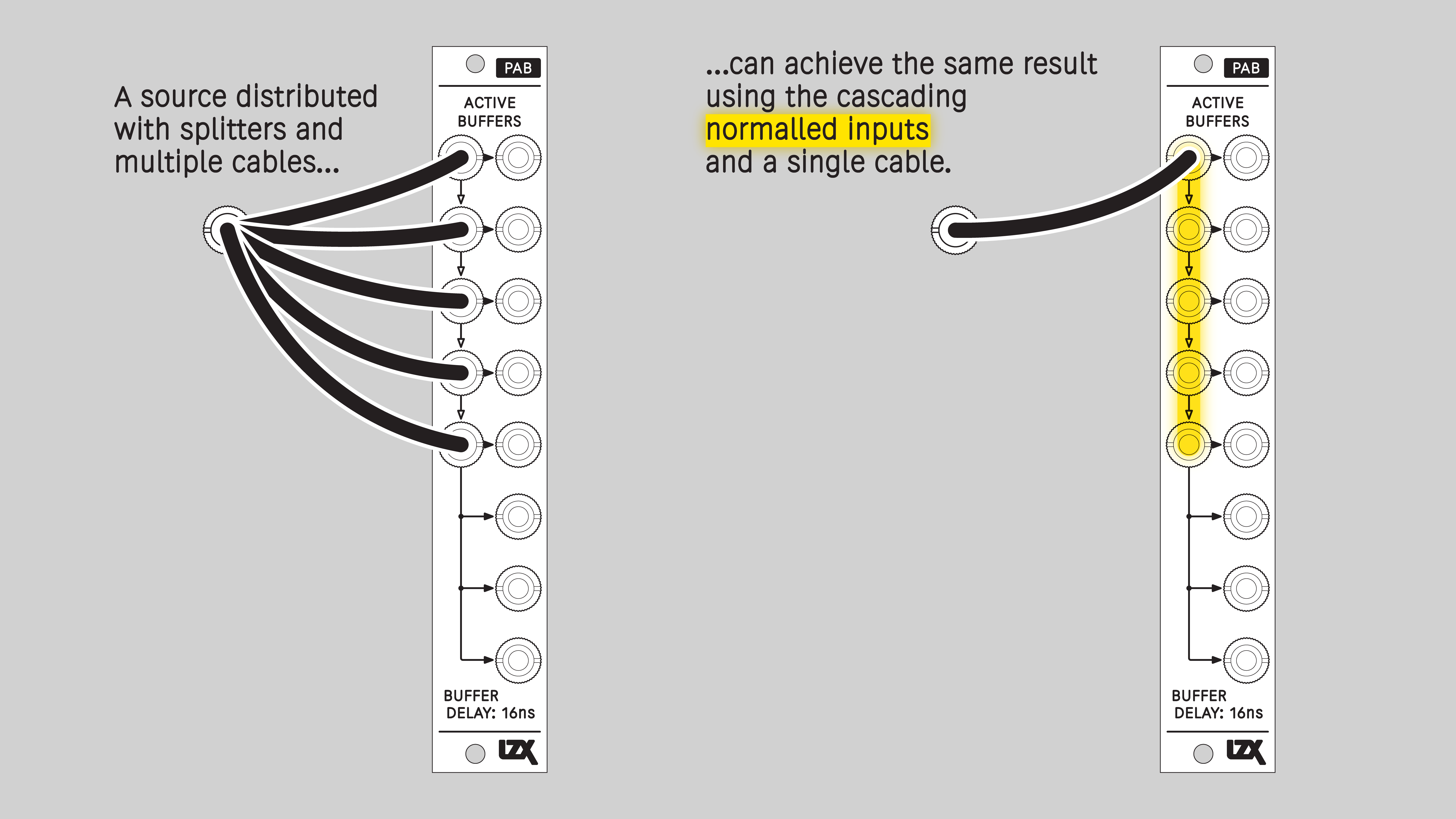

Understanding Cascading Input Jacks
PAB uses switched, or normalled, connections between its input jacks. With no cable inserted, a signal flows down from one input jack to another. This connection is overridden when a cable is inserted. Normalled inputs are indicated on the front panel with arrows.

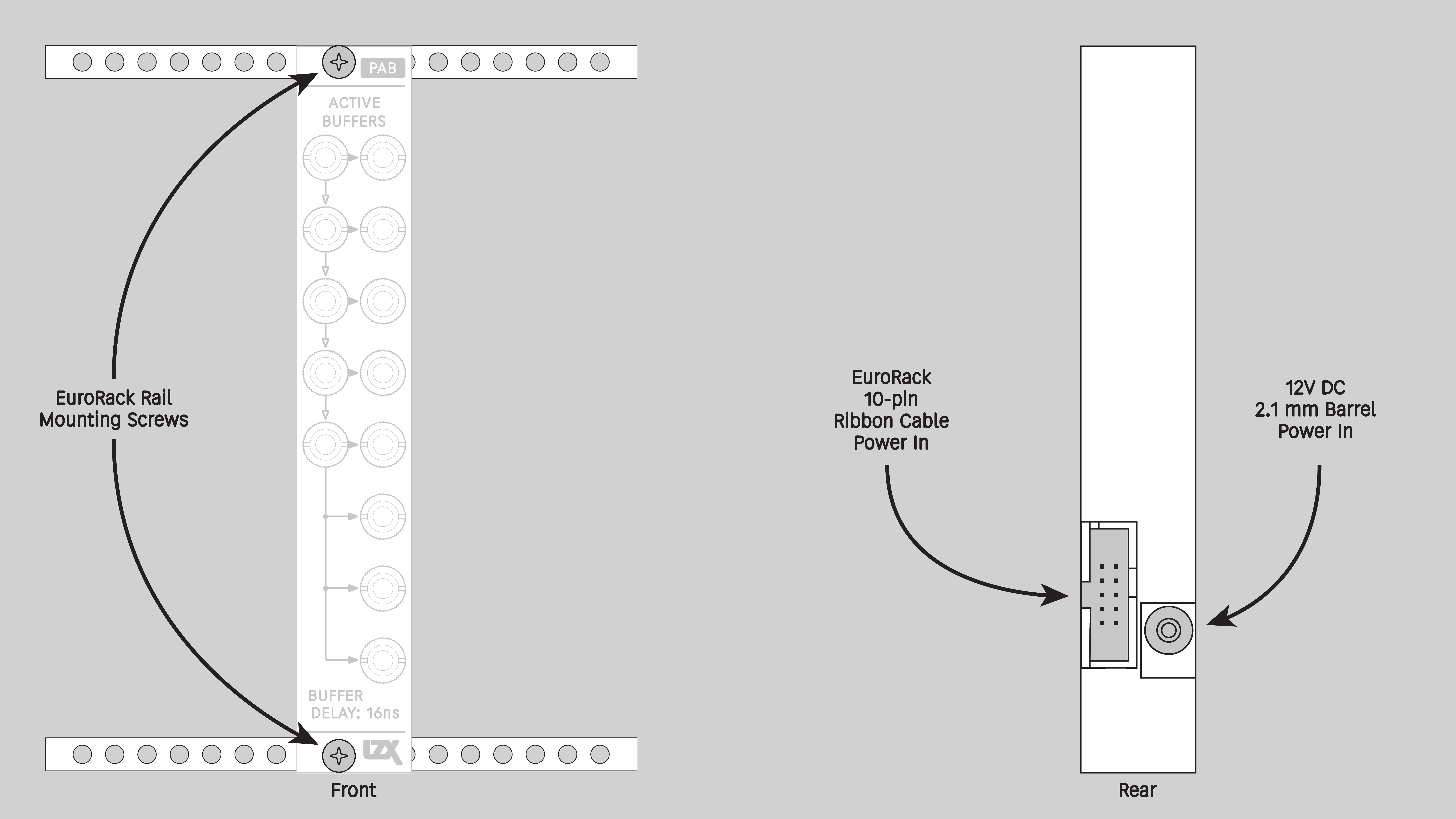

- Power off and disconnect the EuroRack enclosure's power supply and any attached DC adapters.
- Connect either the EuroRack Power Cable or the DC Barrel Power Cable to the module. Do not connect both Eurorack and DC Barrel power.
- Ensure that no mounting screws are in any holes in the area where you wish to mount the module.
- Carefully test fit the module with its attached power cable in the open space in the EuroRack enclosure. If it is obstructed by the enclosure or any internal assemblies, abort this procedure.
- Connect the disconnected end of the power cable to the power supply.
- Mount the module to the EuroRack rails using all mounting holes.

| Propagation Delay | 16ns |
