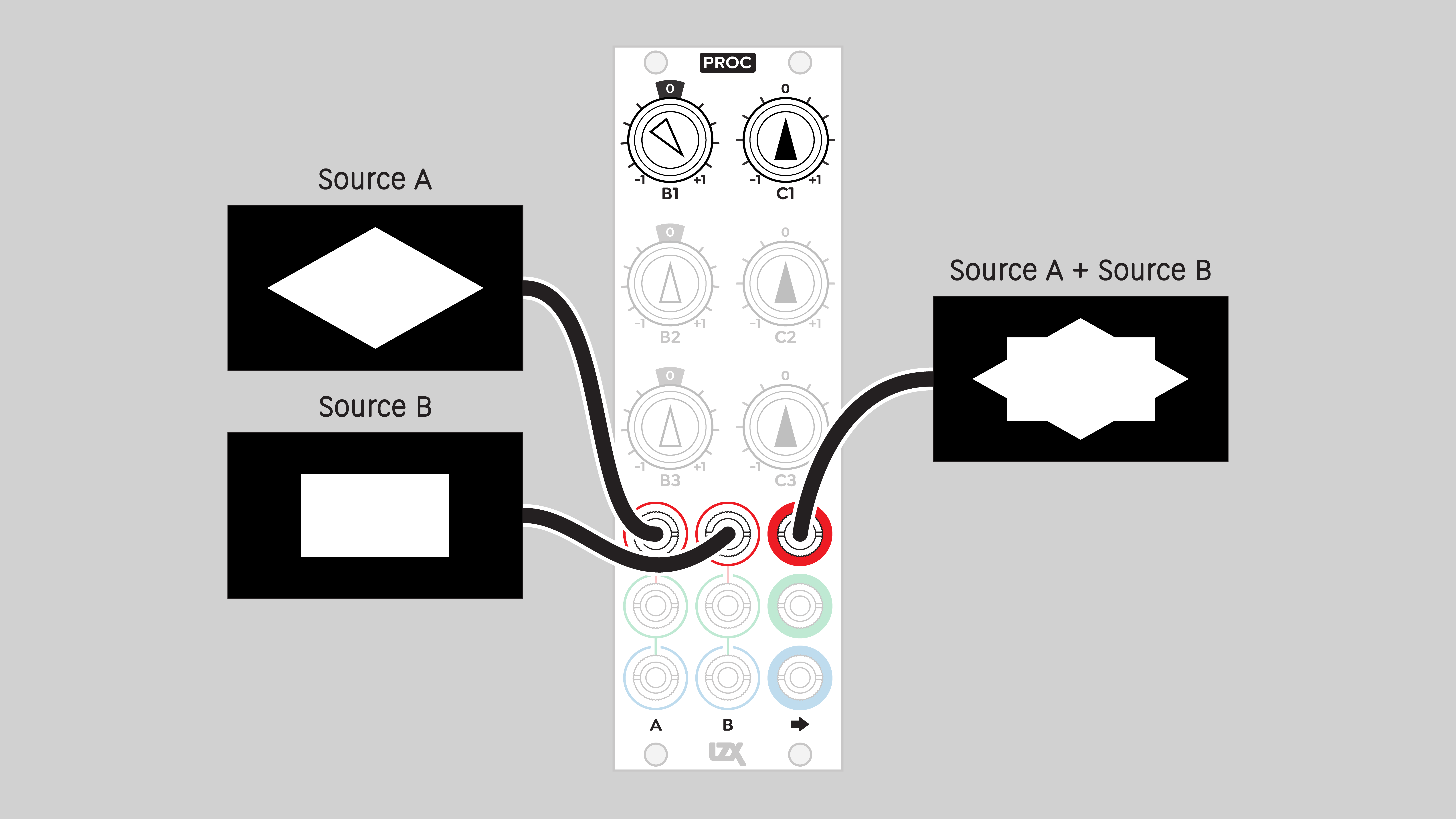

  • Add
  • Subtract
  • Mix

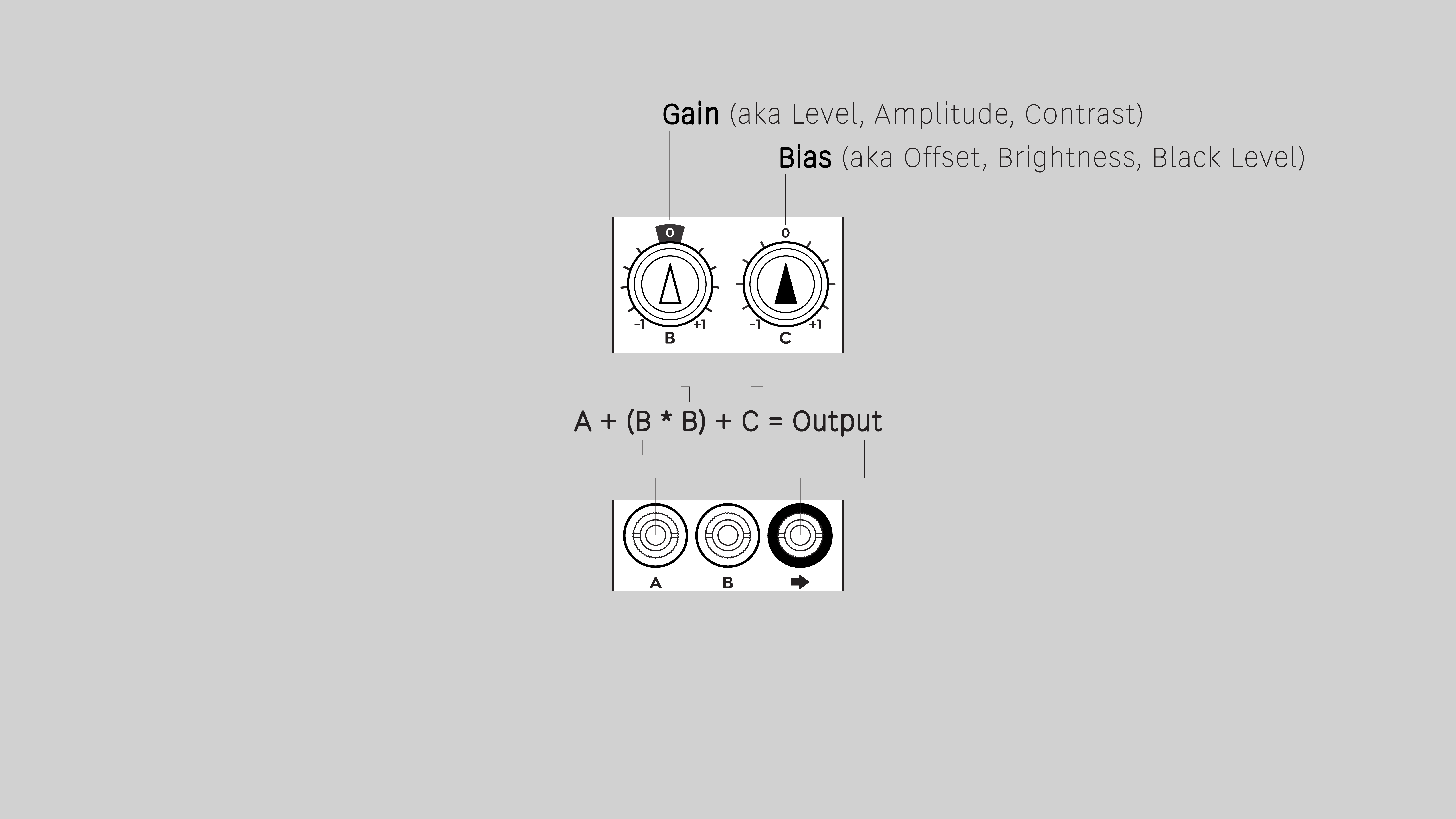

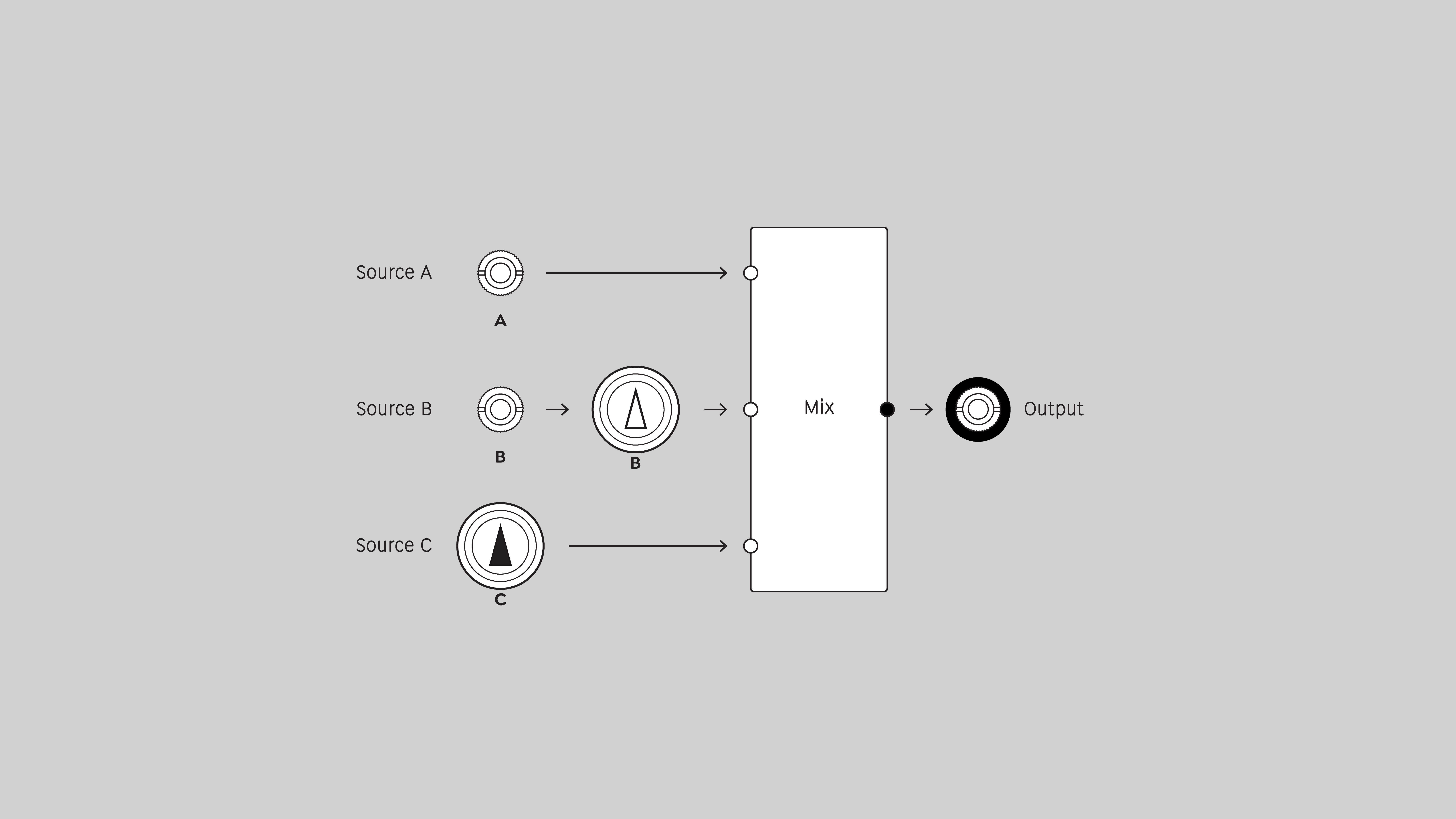

Each channel sums the A and B inputs, plus an internally generated static voltage C. Input A is added without alteration, so it's also known as the Thru input. Input B is multiplied by its corresponding Gain knob before being added. It's also known as the In input.
Proc block diagram Function block per channel
The output can be expressed the sum of jack A, plus the product of jack B and potentiometer B, plus potentiometer C.
jA+(jBpB)+pCjA + (jB \cdot pB) + pC Proc formula

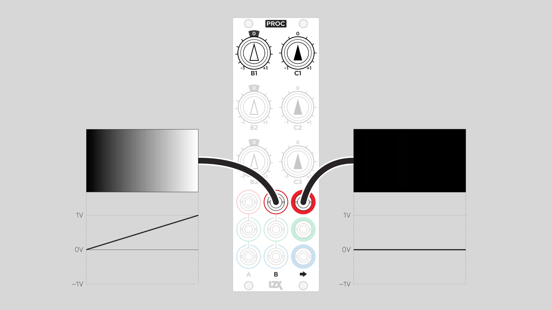

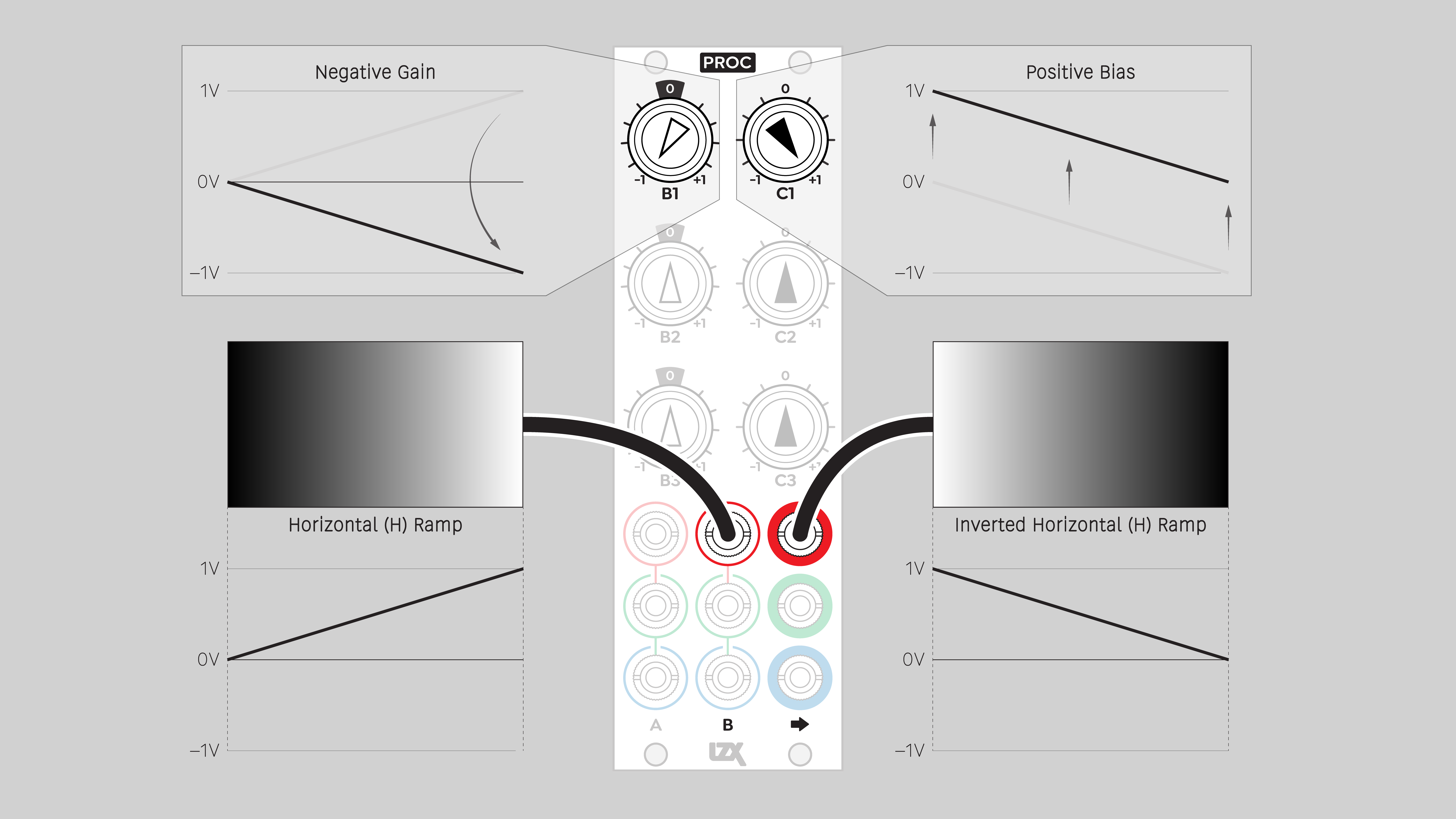

Gain
Each Gain potentiometer, labeled B, can attenuate or invert the value of the signal at the channel's B input. At the 12 o'clock position, the signal is multiplied by zero, so none of the B input signal is added to the output. Turning the knob clockwise to the right of 12 o'clock increases the amplitude up to the full value of the input signal. Turning the knob counterclockwise to the left of 12 o'clock inverts the signal, sending it into the negative voltage range.

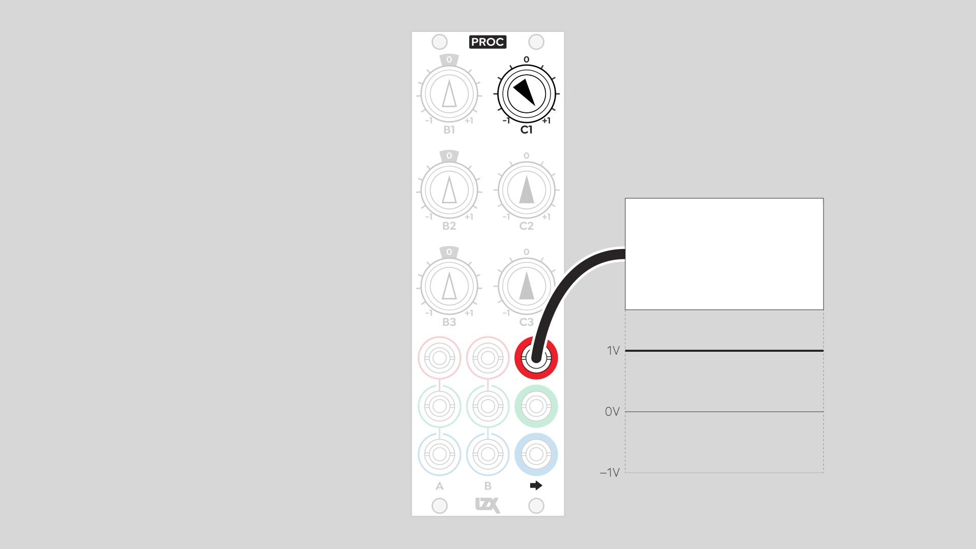

Bias
Each Bias potentiometer, labeled C, adds a static voltage to the output. At the 12 o'clock position, the voltage is zero, so no offset is added to the output. Clockwise rotation to the right of 12 o'clock adds a voltage, biasing the output up. Counterclockwise rotation to the left of 12 o'clock subtracts a voltage, biasing the output down.
Proc gain and bias
Voltage range
Proc can handle input signals that add up to a value range from -2 to +2 volts without distortion. Note that the internally generated bias voltage C is also an input signal, even though there's no C input jack.
Proc can also output signals in that same range, -2 to +2 volts. This allows for bidirectional conversion between unipolar signals that are only positive, and bipolar signals that can be positive or negative.
As the animation above illustrates, negative voltages are outside the visible range of LZX video. Some modules can handle bipolar signals with negative voltages, but an encoder such as ESG3 can only accept values in the range from 0 to +1 volts. Any value below zero will simply be ignored by the encoder.
