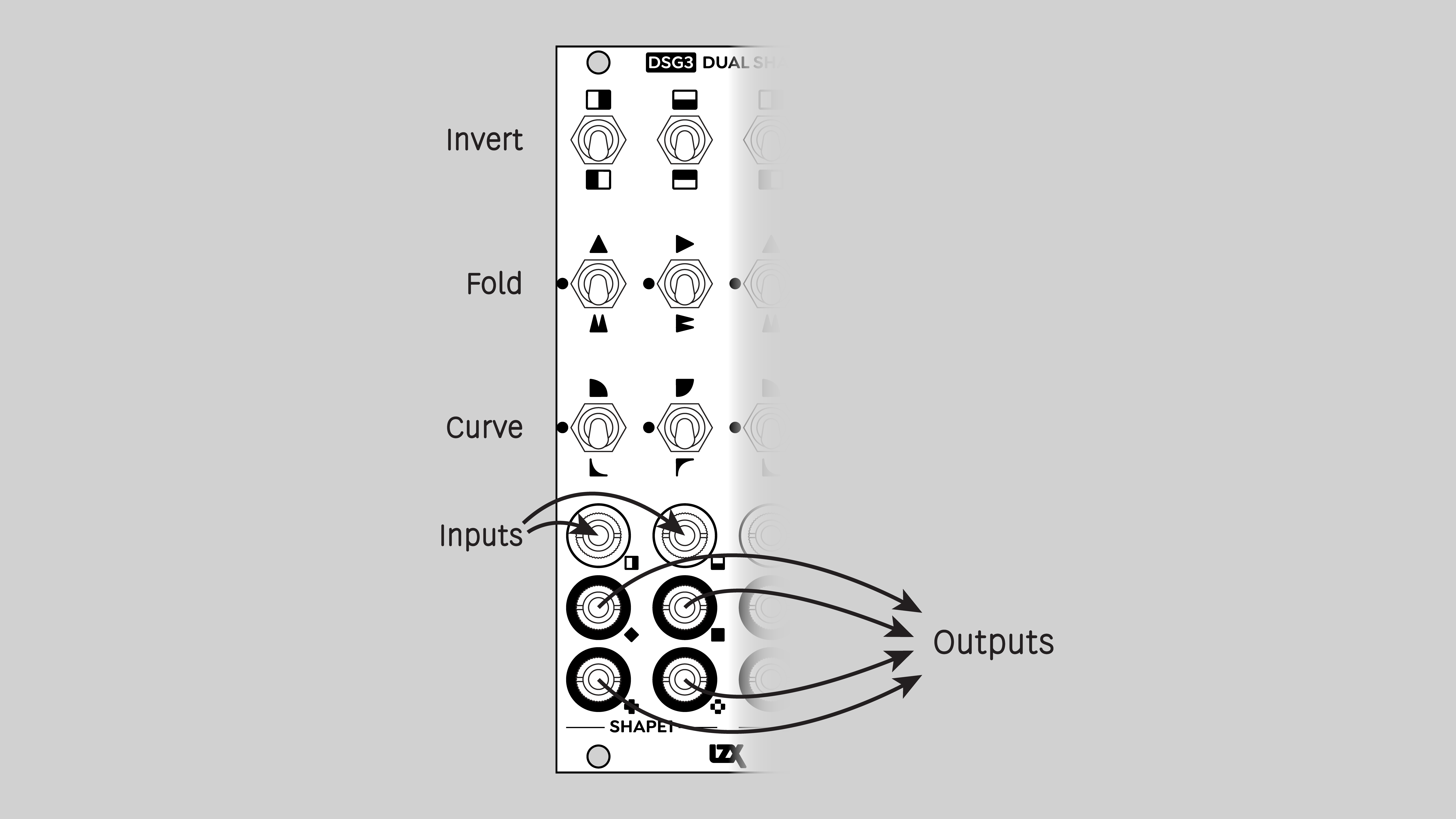

Controls & Connectors
DSG3 consists of two identical submodules, Shape 1 and Shape 2. Each Shape has two inputs, H and V, and four outputs: Average, Minimum, Maximum, and Absolute. Toggle switches enable the various functions: Invert, Fold, and Curve.

Inputs
Each input provides a signal to an identical chain of function blocks. The inputs are referred to as H and V, because horizontal and vertical ramps are internally normalled to the inputs. If nothing is patched to an input jack, then an internal H or V ramp provides the signal to the function block chain.
DSG3 internal normalling **Normalled H and V ramps**
DSG3 can accept both positive and negative voltages. This allows for an even wider range of creative effects! The SUM, MIN, and MAX outputs can send positive and negative voltages, but the ABS output is always positive. Some modules, such as encoders, will ignore anything outside the positive unipolar range of zero to +1 volts.
Outputs
Each Shape submodule has four outputs. Each output combines the results of the H and V function block chains. These are sometimes referred to as analog logic due to their similarity to logical functions such as XOR. Unlike Boolean logic, analog logic operates on continuously variable values in addition to binary on/off values.

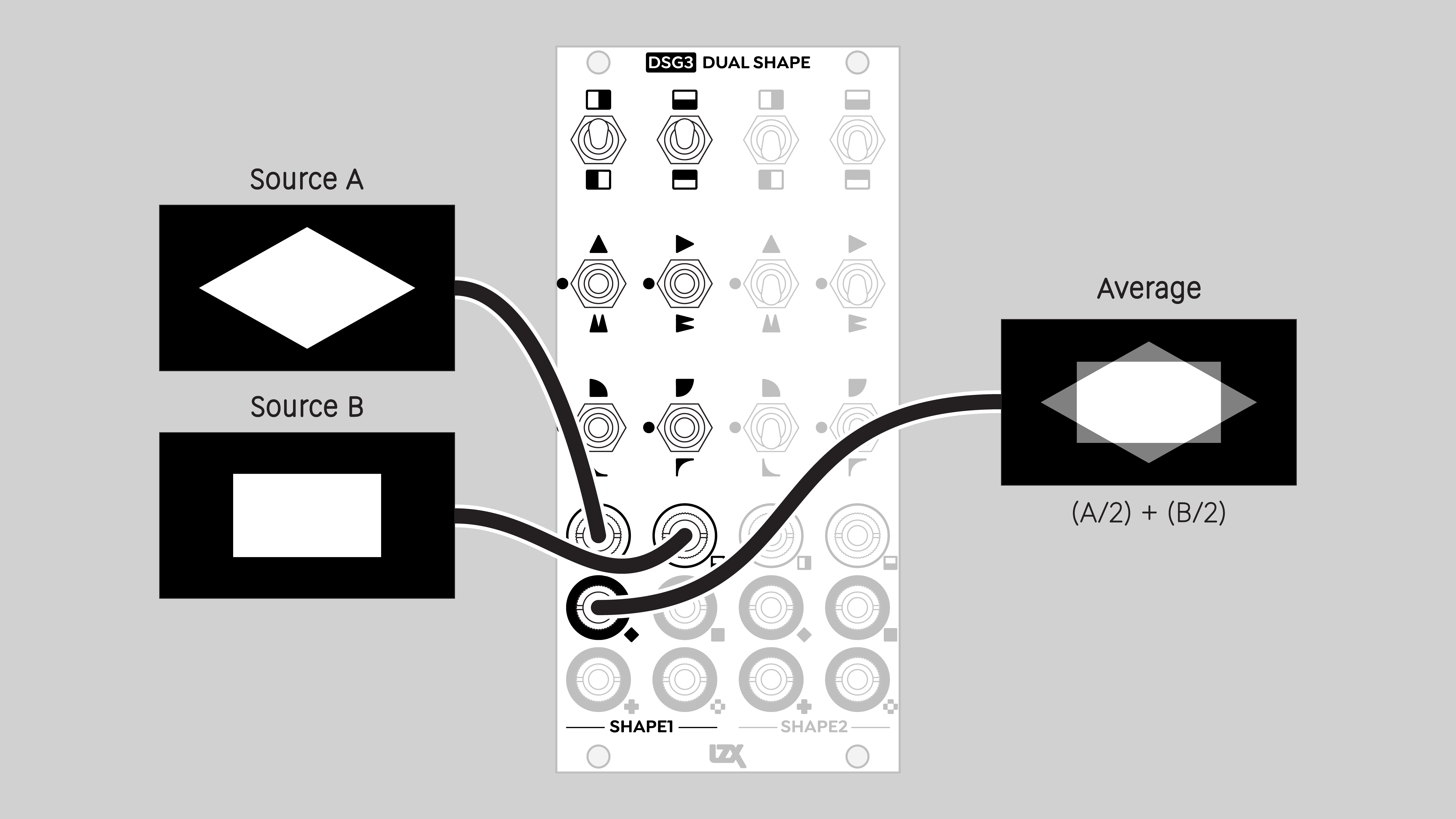

Average
The weighted sum of two input values.
H and V inputs are each divided by two, and the results are summed.
H2+V2\frac{H}{2} + \frac{V}{2}
Blend mode: Add
DSG3 Average output

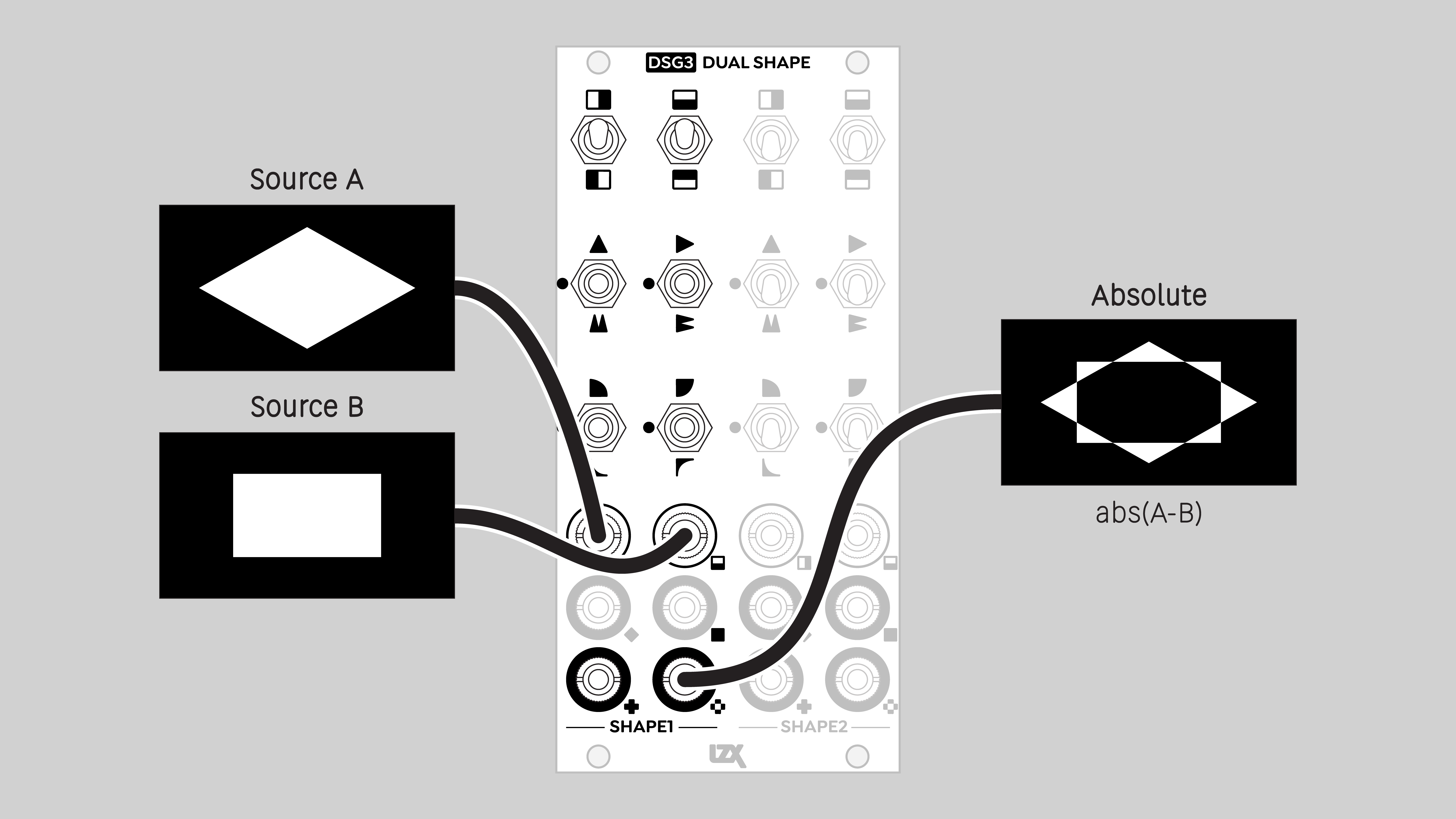

Absolute
The absolute value of the difference between two input values. Corresponds to a logical XOR operation.
An output value will be high if the difference between H and V inputs is large. An output value will be low if the difference is small.
ABS=HV\text{ABS} = |H - V| If H>V, then HV, else VH\text{If } H > V, \text{ then } H - V, \text{ else } V - H
Blend mode: Difference
DSG3 Absolute output

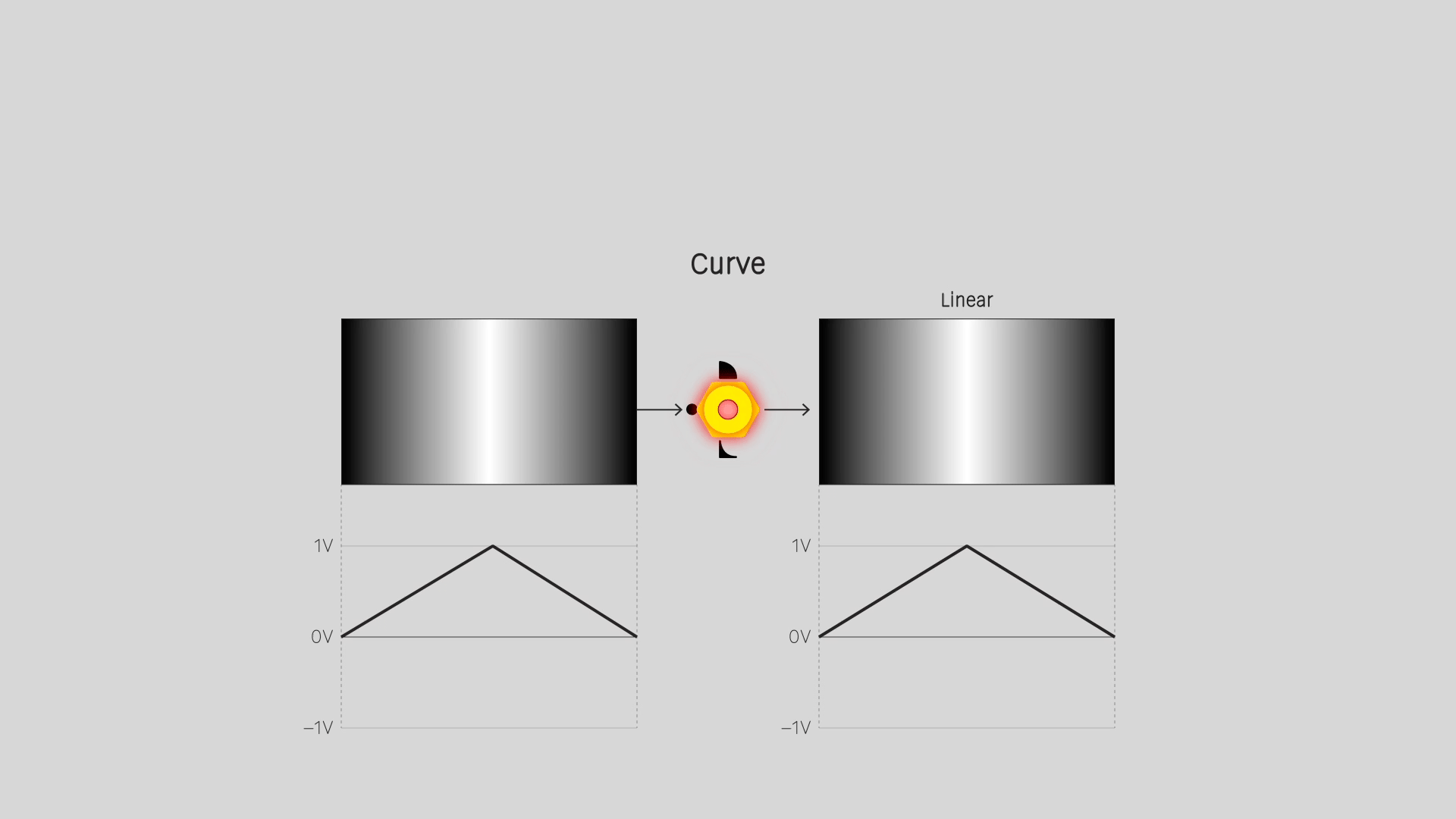

Curve
Apply a logarithmic or exponential function. For a video image, this means changing the contrast curve, emphasizing the light or dark values. That's also known as a gamma adjustment. Values of 0 and 1 are not affected.
For a low frequency control signal, logarithmic or exponential curves cause animation to speed up or slow down in the low or high value ranges.

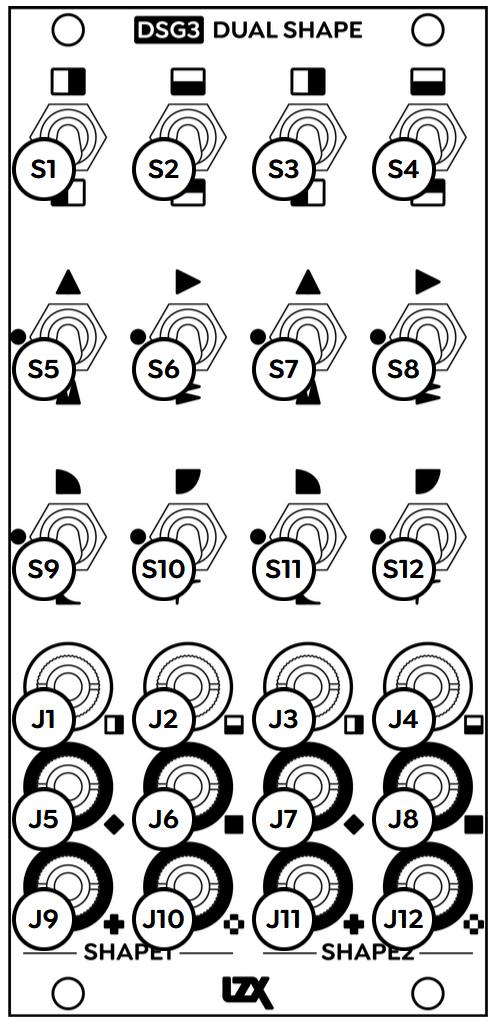

 ConnectorsControls
DSG3: labeled front panel controls
JackFunction
J1Shape 1 H in
J2Shape 1 V in
J3Shape 2 H in
J4Shape 2 V in
J5Shape 1 Average
J6Shape 1 Minimum
J7Shape 2 Average
J8Shape 2 Minimum
J9Shape 1 Maximum
J10Shape 1 Absolute
J11Shape 2 Maximum
J12Shape 2 Absolute
SwitchFunction
S1Shape 1 H Invert
S2Shape 1 V Invert
S3Shape 2 H Invert
S4Shape 2 V Invert
S5Shape 1 H Fold
S6Shape 1 V Fold
S7Shape 2 H Fold
S8Shape 2 V Fold
S9Shape 1 H Curve
S10Shape 1 V Curve
S11Shape 2 H Curve
S12Shape 2 V Curve
