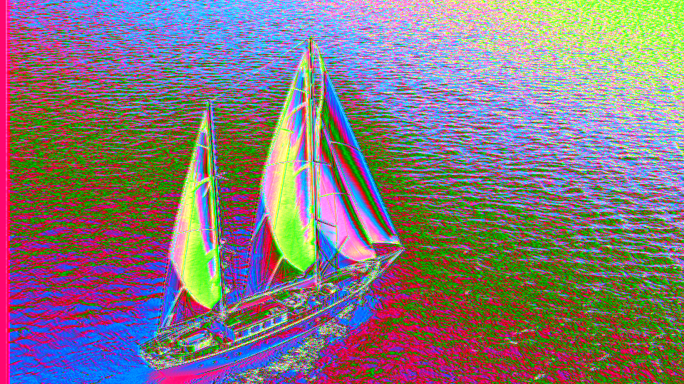

These exercises explore the harmonic layers of Corollas, building from simple luminance folding to full-spectrum petal patterns.
Exercise 1: Triangle Wave Folding
Triangle Wave Folding — simulated result across source images.
Exercise Illustration
Learning Outcomes
Understand how frequency doubling creates symmetrical fold patterns from input luminance.
Key Concepts
- Frequency doubling folds a ramp at the midpoint, creating a triangle
- Cascading doublers multiplies the frequency geometrically (2×, 4×, 8×, 16×)
- The proc amp controls how much of the input range passes through the folding stages
Video Source
A gradient test pattern or any footage with smooth tonal transitions such as skies or slow camera pans.
Steps
- Baseline: Set Span (Knob 4) to about 100.0%. Set Offset (Knob 1) to center (0.0%). All Hue knobs to 0.0%. All toggles Off. Threshold at 0.0.
- Fold pattern: With a gradient input, the smooth ramp transforms into a symmetrical triangle pattern. Bright and dark regions fold into mirrored peaks.
- Increase Span: Slowly turn Span clockwise past 100%. The signal drives harder into the folding stages. More peaks appear as the harmonics grow stronger.
- Sweep Offset: Move Offset across its full range. The entire fold pattern slides through the brightness content like a kaleidoscope.
- Invert: Toggle Invert Span (Switch 7). The fold pattern complements (peaks become valleys and valleys become peaks.)
Settings
| Control | Value |
| Offset | 0.0% |
| Hue 1 | 0.0% |
| Hue 2 | 0.0% |
| Span | ~150.0% |
| Hue 3 | 0.0% |
| Hue 4 | 0.0% |
| Invert Span | Off |
| Invert Hue 1 | Off |
| Invert Hue 2 | Off |
| Invert Hue 3 | Off |
| Invert Hue 4 | Off |
| Threshold | 0.0 |

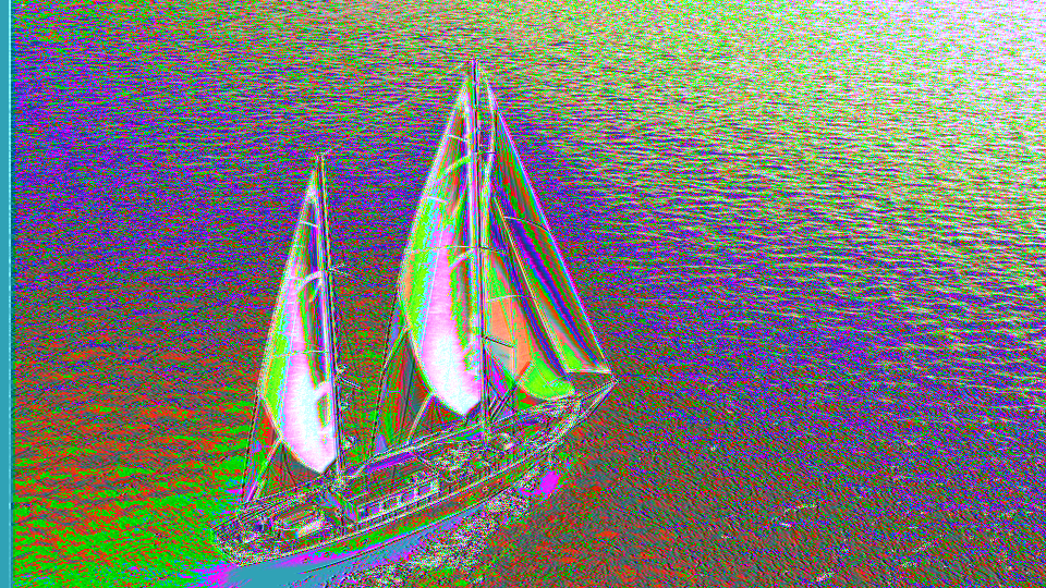

Exercise 2: Chroma Petals
Chroma Petals — simulated result across source images.
Learning Outcomes
Explore how harmonic offsets create color from luminance.
Key Concepts
- The 8× and 16× harmonics generate the U and V chroma channels
- Hue offsets push chroma away from neutral, introducing visible color
- Different offset combinations create different hues
Video Source
A camera feed with recognizable subjects and moderate contrast.
Steps
- Prepare: Begin with the settings from Exercise 1.
- Add U color: Turn Hue 3 (Knob 5) clockwise to about 50.0%. Color appears as the 8× harmonic pattern drives the U channel.
- Add V color: Turn Hue 4 (Knob 6) clockwise to about 50.0%. A second color component emerges as the 16× harmonic drives the V channel.
- Invert one chroma: Toggle Invert Hue 3 (Switch 10). The U channel color flips polarity, shifting the overall hue dramatically.
- Balance: Experiment with different Hue 3 and Hue 4 ratios. Equal values create one palette; unequal values create another.
Settings
| Control | Value |
| Offset | 0.0% |
| Hue 1 | 0.0% |
| Hue 2 | 0.0% |
| Span | ~150.0% |
| Hue 3 | ~50.0% |
| Hue 4 | ~50.0% |
| Invert Span | Off |
| Invert Hue 3 | On |
| Threshold | 0.0 |

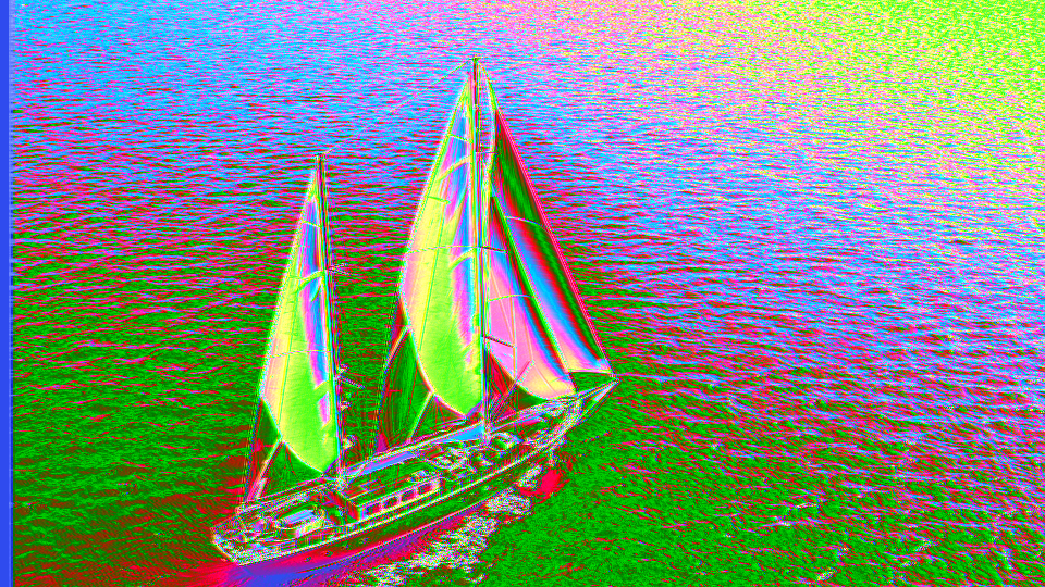

Exercise 3: Petal Isolation
Petal Isolation — simulated result across source images.
Learning Outcomes
Combine all controls to isolate specific harmonic layers and carve petal silhouettes.
Key Concepts
- Threshold keys out dark areas, isolating bright harmonic peaks
- Per-harmonic inversion creates complex interference between layers
- The full parameter set works together as a single sculptural instrument
Video Source
High-contrast footage or a black-and-white test pattern with sharp edges.
Steps
- Prepare: Set Span to ~180.0%, Offset near center.
- Color the petals: Set Hue 3 to ~70.0% and Hue 4 to ~30.0% for asymmetric coloring.
- Shift luminance balance: Increase Hue 1 to ~40.0% and leave Hue 2 at 0.0%. The 2× harmonic brightens while 4× stays dark, creating uneven luminance layering.
- Invert for interference: Toggle Invert Hue 2 (Switch 9). The 4× layer flips, creating constructive and destructive interference with the 2× layer in the luminance channel.
- Key the petals: Slowly raise Threshold (Fader 12) until only the brightest harmonic peaks survive. The output becomes sharp petal shapes against black.
- Flip the base: Toggle Invert Span (Switch 7) to produce the complementary petal arrangement.
Settings
| Control | Value |
| Offset | 0.0% |
| Hue 1 | ~40.0% |
| Hue 2 | 0.0% |
| Span | ~180.0% |
| Hue 3 | ~70.0% |
| Hue 4 | ~30.0% |
| Invert Span | Off |
| Invert Hue 2 | On |
| Threshold | ~50.0 |
