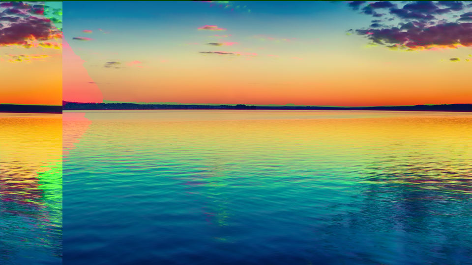

Exercise 1: Prismatic Split
Prismatic Split — simulated result across source images.
Exercise Illustration
Learning Outcomes
Create a classic chromatic-aberration look by offsetting the color channels.
Key Concepts
- Phase controls produce fixed horizontal displacement per channel
- Displacing U and V while leaving Y centered creates color fringes
- Opposite offsets create a symmetric rainbow split
Video Source
A live camera feed or recorded footage with strong vertical edges and contrasting colors.
Steps
- Single channel offset: Turn U Phase (Knob 2) to about 30%. Observe blue-yellow fringes appearing along vertical edges.
- Opposite split: Turn V Phase (Knob 3) to about 30% as well. Now red-cyan fringes appear on the opposite side of edges, creating a full prismatic look.
- Luma offset: Add a small amount of Y Phase (Knob 1), around 10%. The brightness layer shifts, creating a ghostly double-exposure alongside the color fringes.
- Compare: Toggle Bypass (Switch 11) to see the raw input, then toggle back to appreciate the effect.

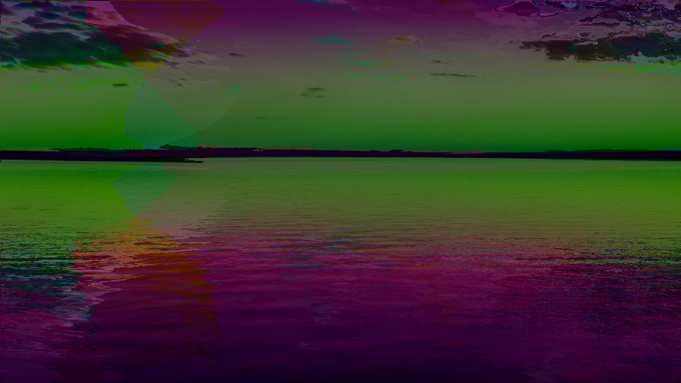

Exercise 2: Content-Dependent Warping
Content-Dependent Warping — simulated result across source images.
Learning Outcomes
Use the Displace controls to create image-driven spatial distortion.
Key Concepts
- Displace adds pixel-value-based modulation to the delay
- Bright areas shift further than dark areas
- Different Displace values per channel create per-color warping
Video Source
Footage with a range of tonal values (faces, landscapes, or text overlays work well.)
Steps
- Prepare: Set U Phase to ~20% and V Phase to ~20% for a slight base offset.
- Add displacement: Increase Y Displace (Knob 4) to about 100%. Bright areas of the luminance channel stretch and smear sideways.
- Chroma displacement: Now increase U Displace (Knob 5) to about 80% and V Displace (Knob 6) to about 120%. Each color channel warps differently based on its own content, creating fluid, multicolored distortion.
- Animate: Slowly sweep Y Displace from minimum to maximum. The distortion flows organically through the image, following brightness contours.
- Invert and compare: Toggle Y Flip (Switch 7). The brightness inverts but the displacement pattern stays the same (note the visual difference.)

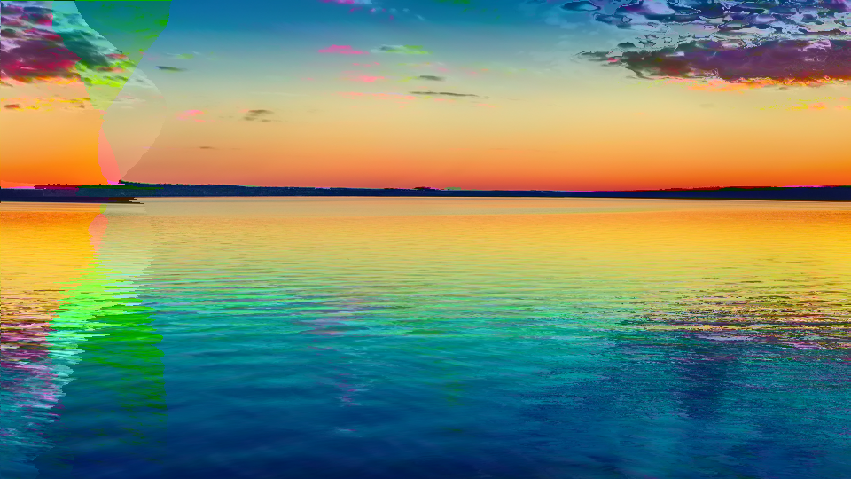

Exercise 3: Color Negative Fade
Color Negative Fade — simulated result across source images.
Learning Outcomes
Combine channel inversion with the fade stage for surreal color-negative compositions.
Key Concepts
- Flip toggles invert individual channels before processing
- Inverting U and V together creates a chroma negative
- The fade stage desaturates toward neutral, blending processed and target colors
Video Source
High-saturation footage (flowers, neon signs, or colorful graphics.)
Steps
- Chroma negative: Enable U Flip (Switch 8) and V Flip (Switch 9). Colors swap to their complements (reds become cyan, blues become yellow.)
- Add displacement: Set U Phase to ~15% and V Phase to ~15% for a subtle offset. The inverted color fringes create an eerie, otherworldly split.
- Fade toward white: Set Fade Color (Switch 10) to White. Pull Fade Amount (Fader 12) down to about 60%. The image begins to wash out toward white, with the inverted colors blending into a high-key pastel palette.
- Full negative: Now enable Y Flip (Switch 7) as well. The entire image is color-inverted and partially faded, creating a dreamy photographic-negative composition.
- Sweep the fade: Slowly move the Fade Amount fader from 100% down to 0%. The displaced, inverted image dissolves into pure white.
