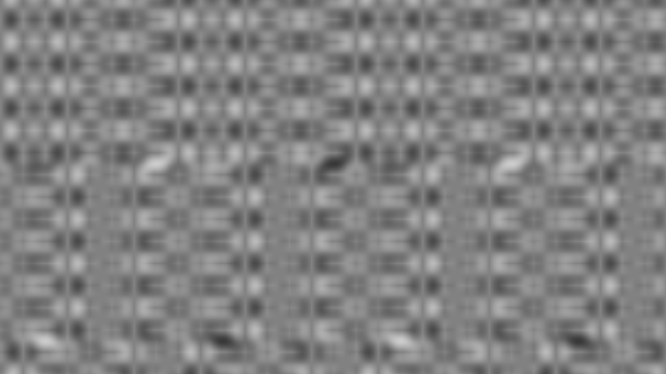

Exercise 1: Scrolling Marble Terrain
Scrolling Marble Terrain — simulated result across source images.
Exercise Illustration
Learning Outcomes
Understand the relationship between scale, scroll, and the raw noise field.
Key Concepts
- Gradient noise is an infinite, seamless procedural pattern
- Scale controls lattice cell size
- Scroll velocity sweeps through the infinite noise space
Steps
- Set the zoom: Set Scale (Knob 2) to step 3 or 4. You should see a gentle marble-like pattern of light and dark bands.
- Hold position: Centre Scroll X (Knob 1) and Scroll Y (Knob 3) so the pattern is stationary.
- Horizontal drift: Slowly turn Scroll X clockwise. The landscape drifts horizontally. Return to centre to stop.
- Diagonal motion: Now combine both: set Scroll X and Scroll Y slightly off-centre for slow diagonal motion through the noise field.
- Zoom through scales: Sweep Scale through all 8 steps while scrolling. Zooming in reveals a different scale of the same infinite texture.
Settings
| Control | Value |
| Scroll X | ~60% |
| Scale | 4 |
| Scroll Y | ~55% |
| Warp | 0% |
| Palette Shift | 0% |
| Palette Speed | 0% |
| Texture | Gradient |
| Palette | A |
| Color | Warm |
| Video | Noise |
| Octave | 1x |
| Mix | 100% |
