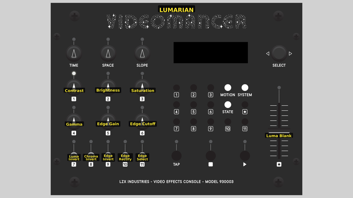

Videomancer's front panel with Lumarian active. Knobs 1–6 (top two rows of left cluster), Toggle switches 7–11 (bottom row of left cluster), Fader 12 (right side).

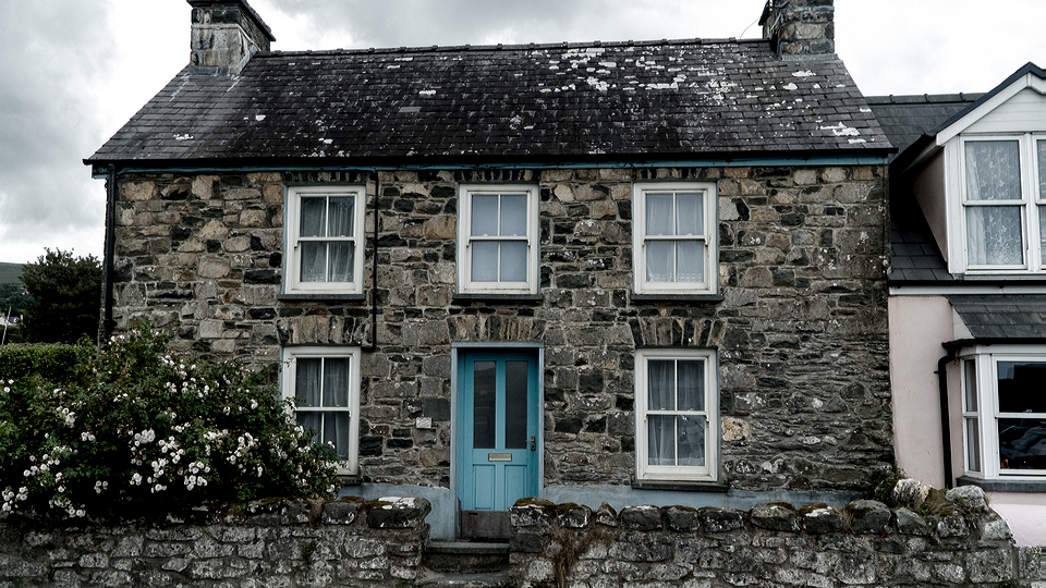

Exercise 1: Classical Color Correction
Classical Color Correction — simulated result across source images.
Exercise Illustration
Learning Outcomes
Learn how the proc amp and gamma stages interact to achieve balanced color correction.
Key Concepts
- Contrast scales the tonal range; brightness shifts it
- Gamma reshapes the midtone distribution without clipping
- Saturation controls color intensity independently of luminance
Video Source
A live camera feed or recorded footage with a mix of shadow, midtone, and highlight areas.
Steps
- Boost contrast: Turn Contrast (Knob 1) clockwise to about 130%. The image gains dynamic range (shadows darken, highlights brighten.)
- Compensate brightness: Adjust Brightness (Knob 2) slightly counterclockwise to bring the overall level back to a natural balance.
- Lift midtones: Turn Gamma (Knob 4) slightly clockwise (above center). Notice how shadow detail becomes visible without blowing out highlights.
- Desaturate gently: Reduce Saturation (Knob 3) to about 80%. Colors become more muted and filmic.
- Compare: Toggle each control back to its default position one at a time to hear the difference each correction makes.
Settings

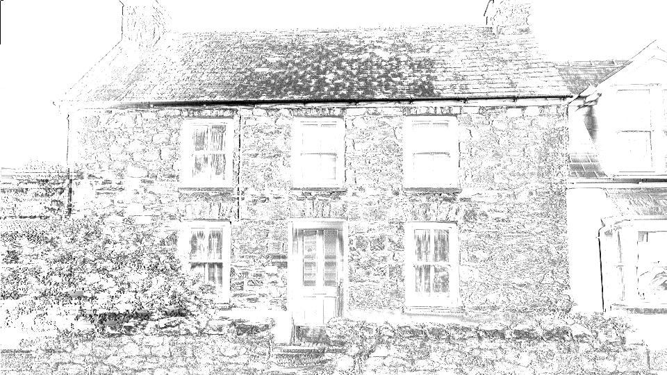

Exercise 2: Edge Sculpting
Edge Sculpting — simulated result across source images.
Learning Outcomes
Explore the edge enhancement chain and its rectifier modes to create dramatic edge outlines.
Key Concepts
- The high-pass filter extracts edges; cutoff controls their scale
- The rectifier shapes edge polarity; three toggles yield eight combinations
- Edge gain blends enhanced edges back into the image
Video Source
Footage with strong contours: architectural shapes, faces, or high-contrast graphic patterns.
Steps
- Apply moderate contrast: Set Contrast to about 120% and Gamma slightly above center to establish a clean tonal base.
- Reveal edges: Turn Edge Gain (Knob 5) to about 100%. Turn Edge Cutoff (Knob 6) to about 50%. Bright halos appear along contours.
- Rectify edges: Toggle Edge Rectify (Switch 10) to On. Both sides of each contour now glow, doubling the edge lines.
- Select both edges: Toggle Edge Select (Switch 11) to Both. The edge response becomes more symmetrical and pronounced.
- Invert edge polarity: Toggle Edge Invert (Switch 9) to On. Edge halos become dark grooves. Toggle it back off and notice the difference.
- Threshold carve: Slowly increase Luma Blank (Fader 12) to about 40%. Only the brightest edge-enhanced regions survive, creating glowing outlines on black.
Settings

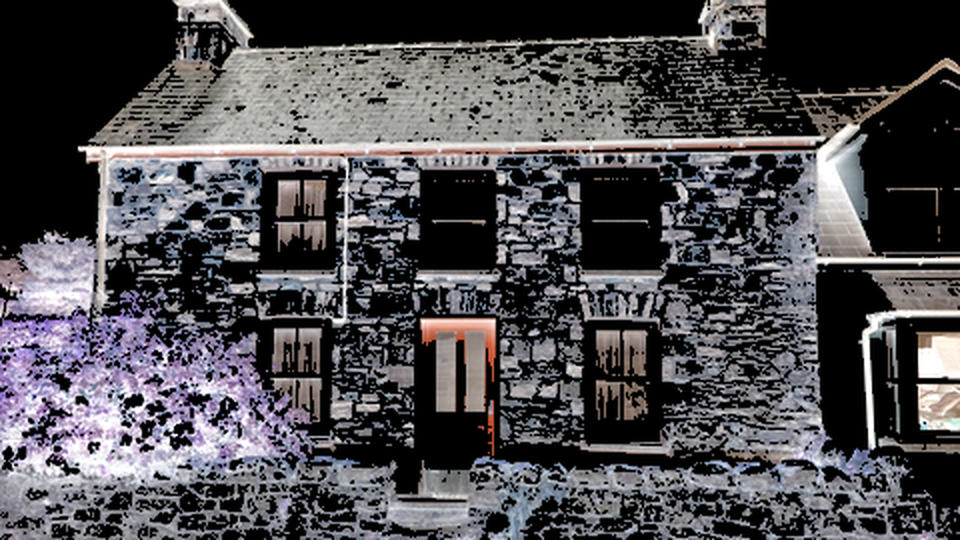

Exercise 3: Inverted Luminance Key
Inverted Luminance Key — simulated result across source images.
Learning Outcomes
Combine gamma curves, inversion, and threshold keying to create a luminance key mask.
Key Concepts
- Gamma extremes create dramatic contrast curves
- Luma Invert flips the tonal map, changing what the threshold keeps
- Chroma Invert shifts hues to their complements
Video Source
High-contrast footage such as silhouettes, text on a background, or stage lighting.
Steps
- Crush with gamma: Turn Gamma (Knob 4) fully counterclockwise. Midtones collapse into shadows, leaving only the brightest highlights.
- Boost contrast: Set Contrast (Knob 1) to about 160% to amplify the stark gamma curve.
- Add edge detail: Set Edge Gain (Knob 5) to about 60% and Edge Cutoff (Knob 6) to about 30%. Edges appear as thin bright lines in the gamma-crushed image.
- Invert luminance: Toggle Luma Invert (Switch 7) to On. The crushed shadows become bright fields; the surviving highlights become dark. The edge lines also invert.
- Invert chroma: Toggle Chroma Invert (Switch 8) to On. Colors shift to complementary hues.
- Key threshold: Increase Luma Blank (Fader 12) until only the desired tonal regions remain. With both inversions active, the threshold carves into the flipped image.
- Adjust saturation: Sweep Saturation (Knob 3) to tint the remaining key regions.
Settings
